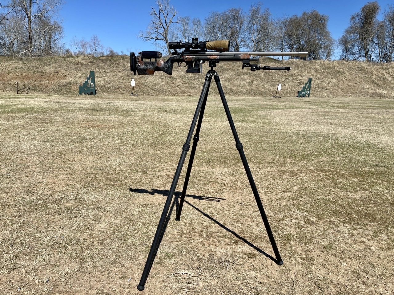

Is it stable when fully extended? I’m 6’2” and want to be able to use it while standing.
If you are worried about that and are OK with the weight/bulk get the CS90C.

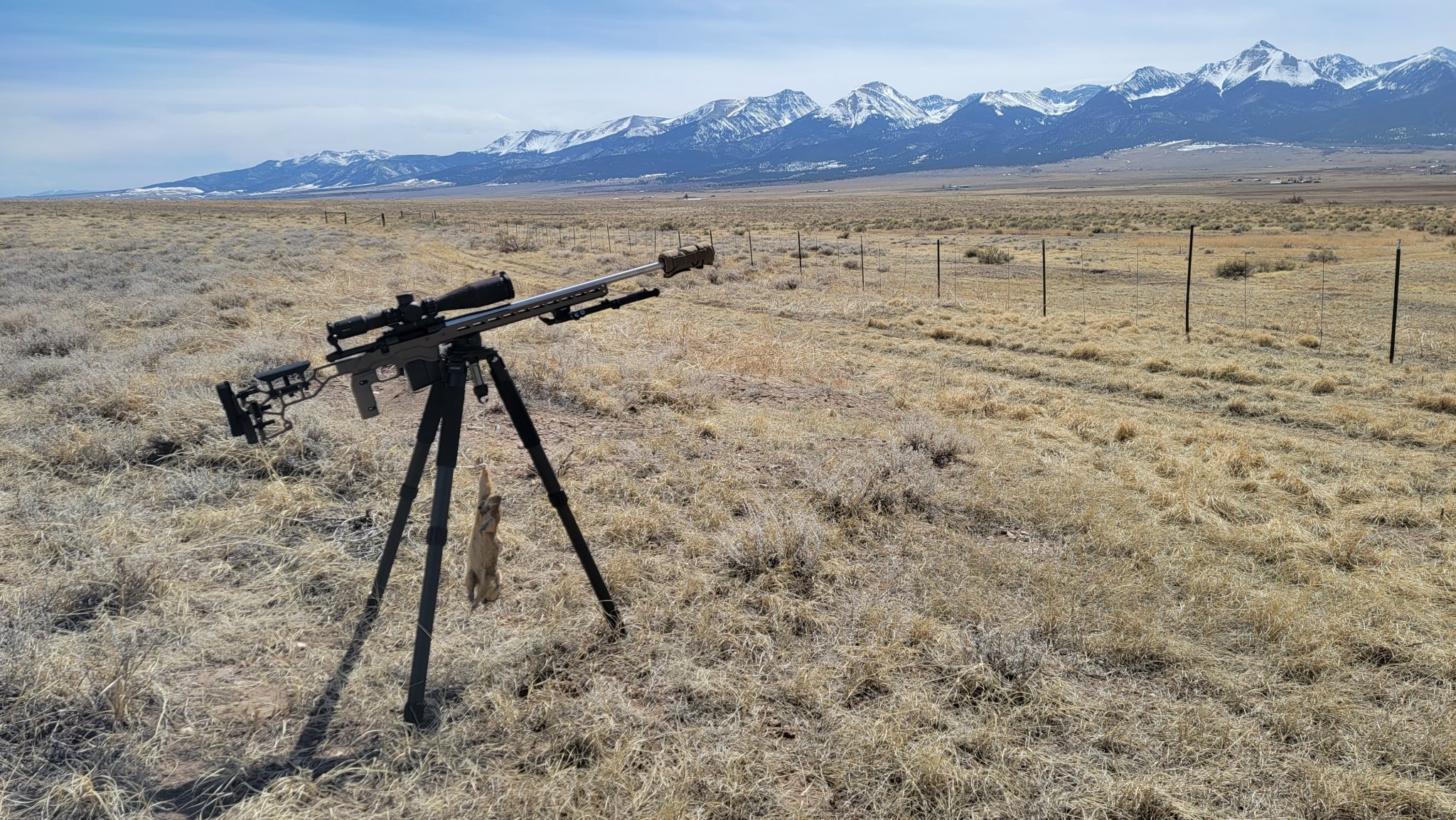

This holds my 23lb rifle fine and is practically free, but 99% of the time it holds binos. If it breaks I can buy 14 more until someone can say "you should've got an Anvil" lol!

If one really plans on shooting off it a bunch and is serious about that, you should probably just buy an Anvil, or something cooler, and a more upscale tripod too; this stuff is just for dicking around IMHO...

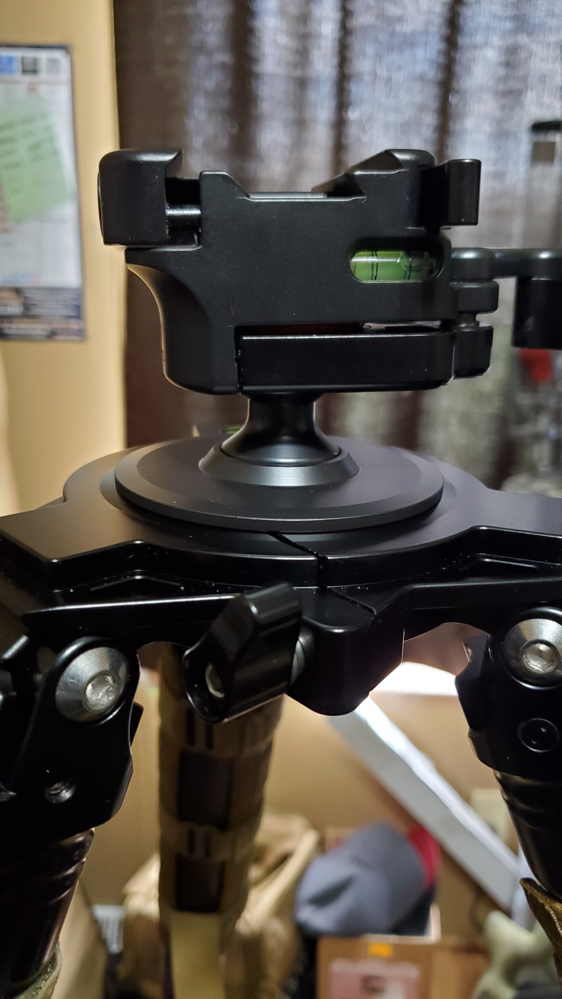

I run an Anvil off my import RT90c. I don't think the carbon legs actually have any real complaint when comparing to RRS legs, yeh they're heavier and beefier, but the RT90c is damn sturdy, albeit it's 6lbs vs 4lbs on an RRS. The Anvil-30 head is superb for all its uses so I think it was well worth the investment on that. And worse case, if I really want RRS legs in the future, the Anvil-30 will just move over to it.

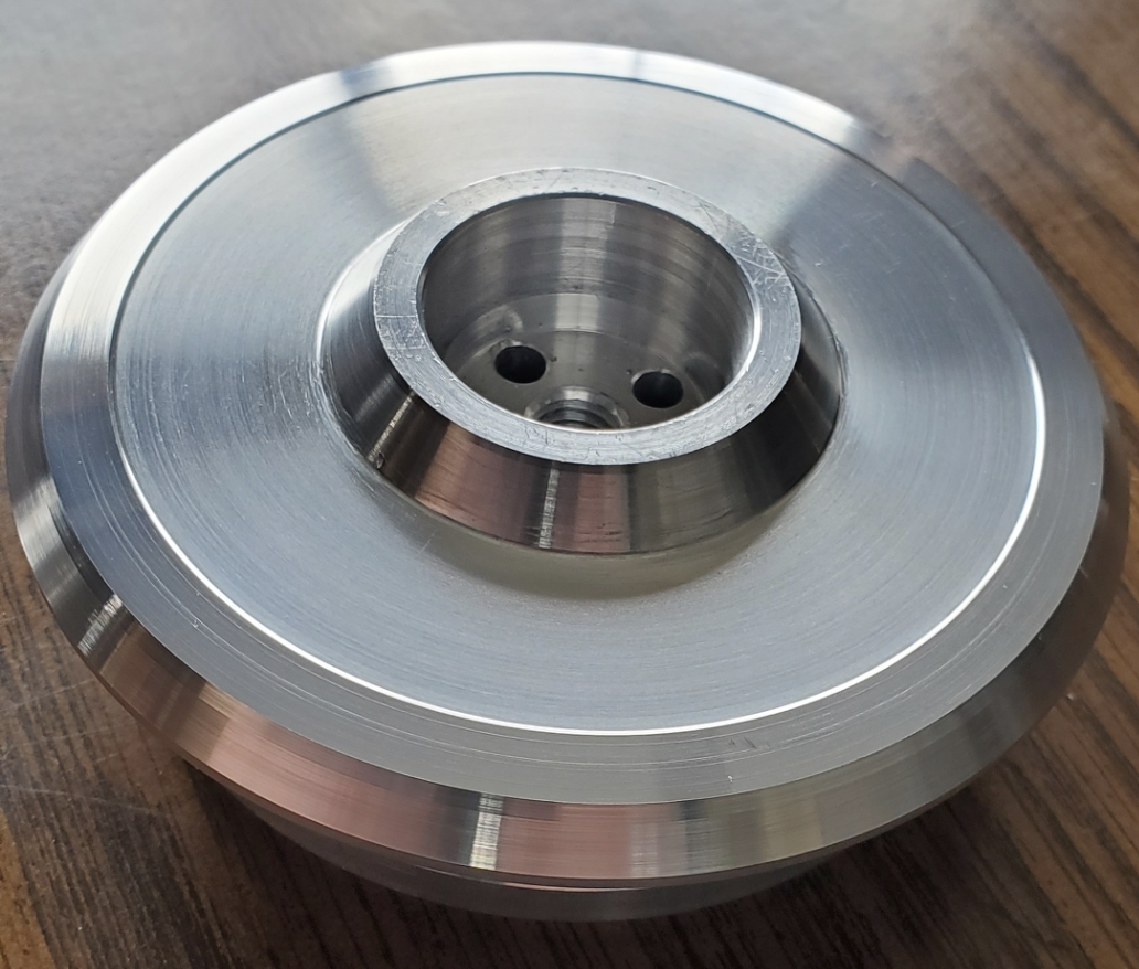

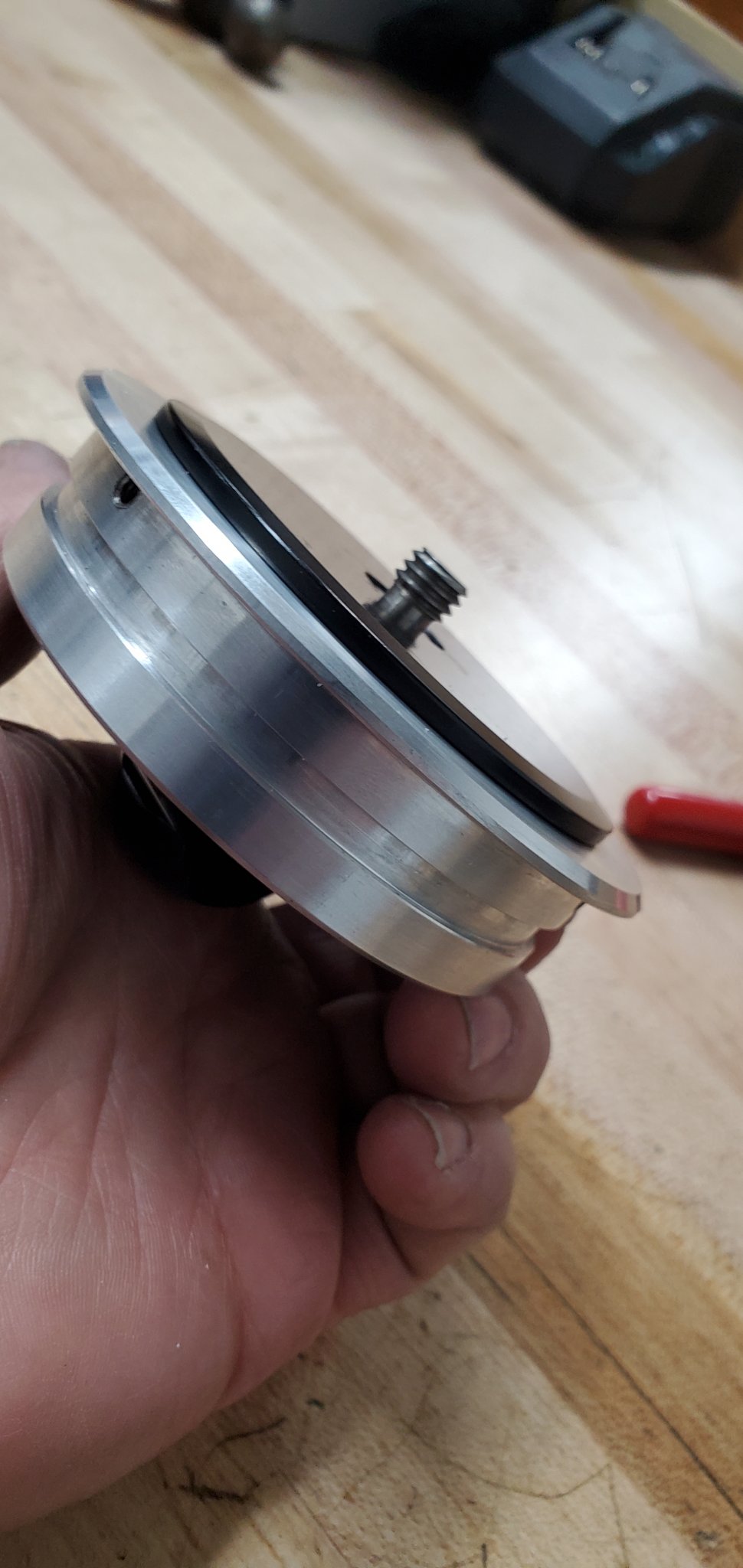

Nobody drifted. It was asked specifically how the Anvil 30 worked with a spotting scope. Also, many here, including myself, use(d) an anvil 30 with the RT90. One member makes an adapter plate specially for the RT90 to mate with an Anvil 30.
Have the RT-90 + Anvil. Used to have the Desmond ball head on there.

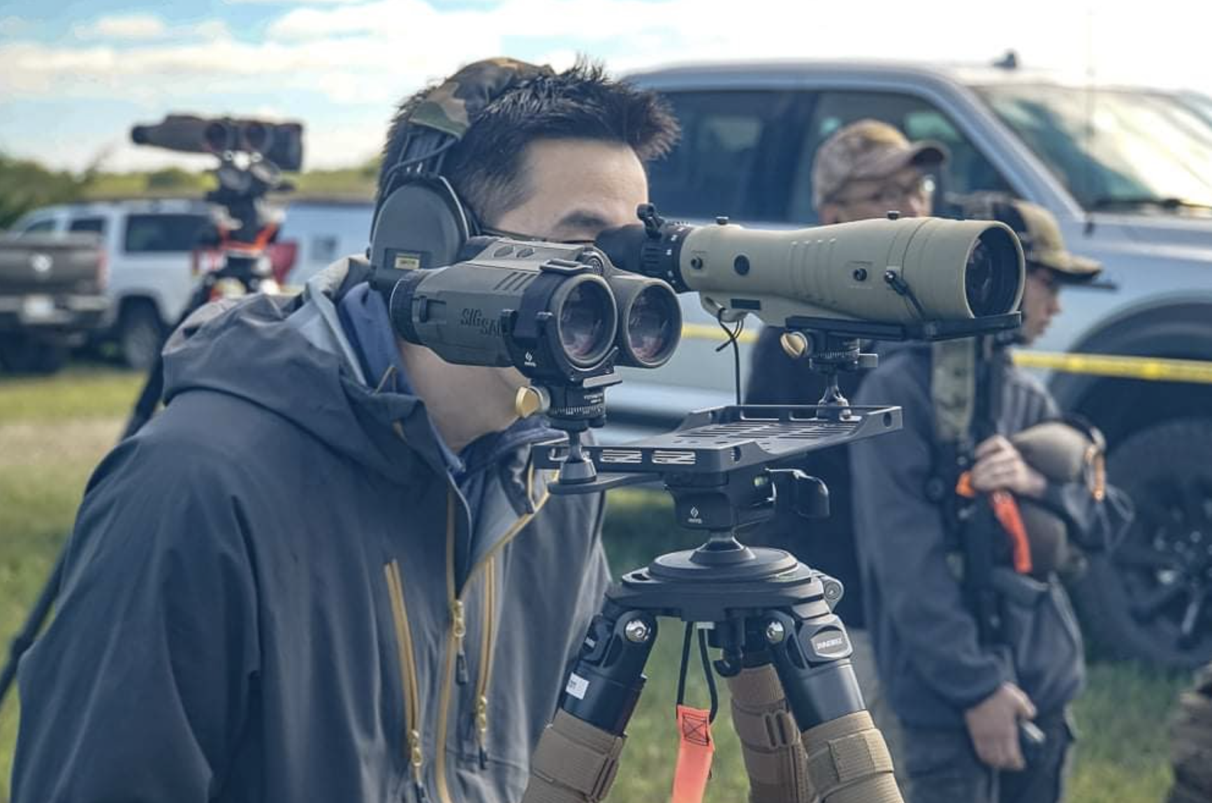

For shooting, the Anvil is fantastic. The giant 40mm legs make it pretty stable, and the Anvil ergonomics allow you to quickly adjust the lever to get the tension you want. For spotting (or binos), it's a compromise. The anvil works fine, it's just harder to set up and move. A ballhead is easier to transition targets with. The RRS bino mount is the shit though, if you are going direct-mount. I don't usually start cussing my Anvil unless I'm spotting all day for a match that requires a lot of distance between targets per stage.
Truth be told, I think direct mount table + bag + binos setup might be the way to go if you are talking range day (IE: PRS or field shooting match) spotting. I never run an actual spotter anymore, and lust after a set of 15X NL Pures w/ a mil reticle.

I found a hack that I love now. There's a tension lever for the bowl. So with the anvil adapter if I loosen that tension I now have panning. I did it the match this weekend and it was awesome.
Yep I've been doing that. For years even with the standard ball head. It was easier to pan the plate vs the ball head.

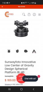

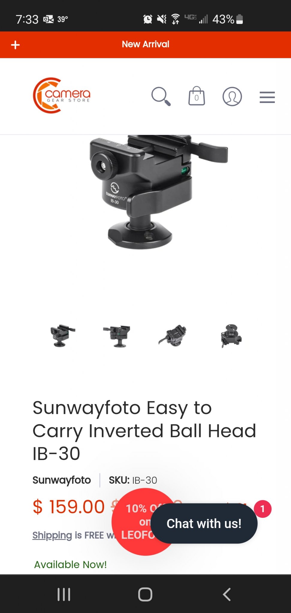

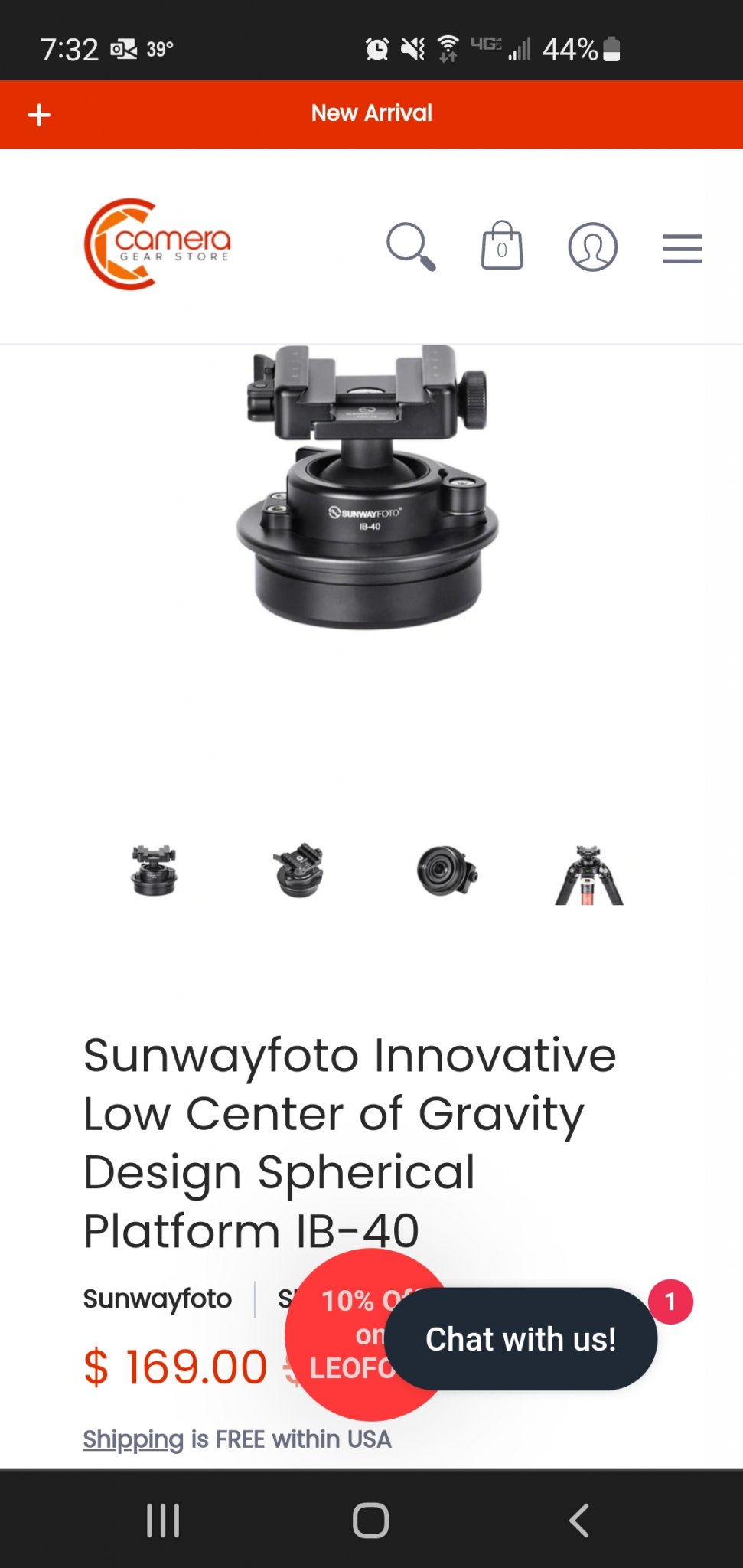

For anyone interested -
I can completely understand why the sunwayfoto IB-30 is now harder to find stateside then hens teeth. It’s a complete ripoff of the anvil-30 and RRS sent out a cease and desist letter for US distribution

How does the anvil 30 mount to the RT90c
