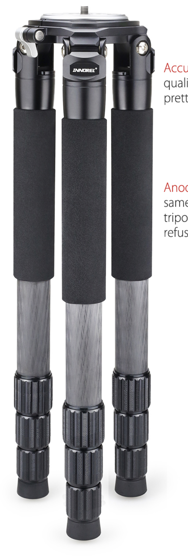

Imported carbon fiber tripod (RT90C)
To the folks running the RT90C with Anvil 30 and @midwestoffroad adapter plate, is "head only" the one to order?
That’s the one I ordered to save about $20.
It comes like this in the padded bag and a set of spike feet.

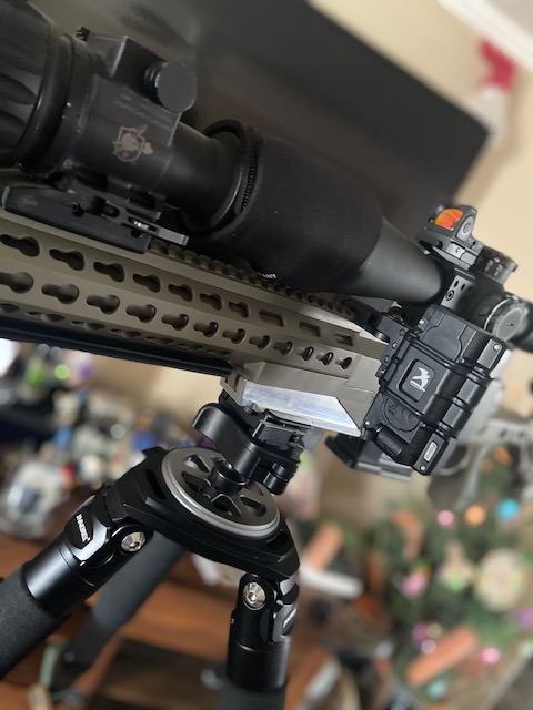

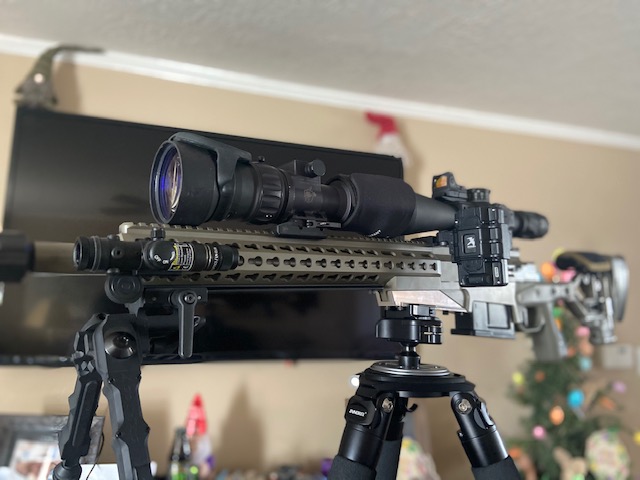

Gotta say I'm pretty impressed with the rt90c so far. I can't wait for the midwest plate for the anvil 30 to show up and give a full range report.
What is the thing on the side of your rifle?
Have you gotten a plate for the 80 series to measure yet? I've been using the leveling base on mine and not very happy. Feels steady in the house then I get to the range and not so much
Looks like a laser indicator and a Kestrel e-dope card
