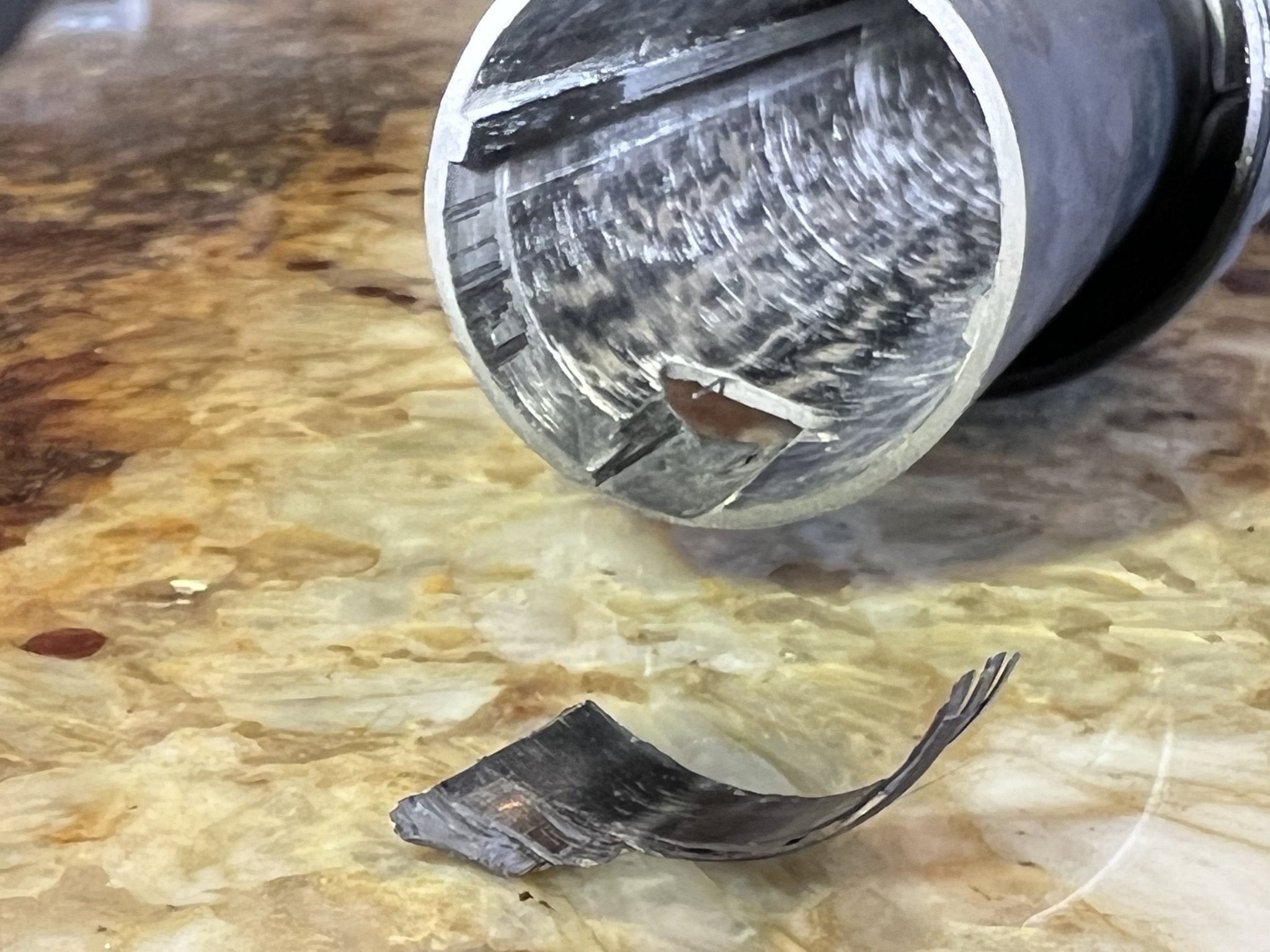

Is there a link to where someone had problems with a leg coming out and repairs? I had one pop out and was looking to see what the deal on fixing was.
I had one leg go bad on me. The locking mechanism failed and the leg wouldn't come out. I reached out to them through Amazon. They replaced the leg no questions asked.
Reactions: CK1.0 and padom
They all will eventually have issues with leg locks if used in severe enough conditions. A lot obviously has to do with how you care for them, the materials used, but also the ability of each carbon leg to be a consistent diameter, smooth, and the wiper quality.

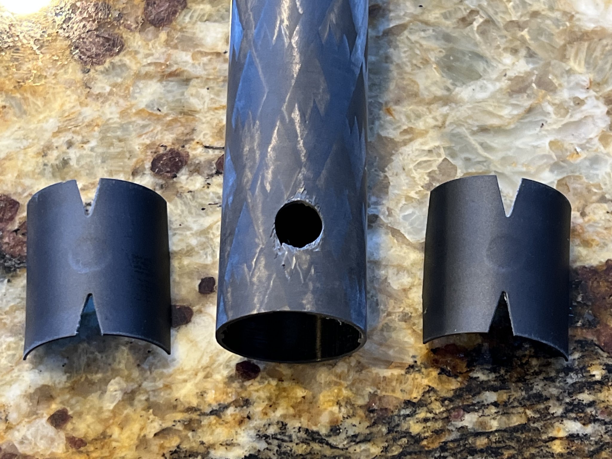

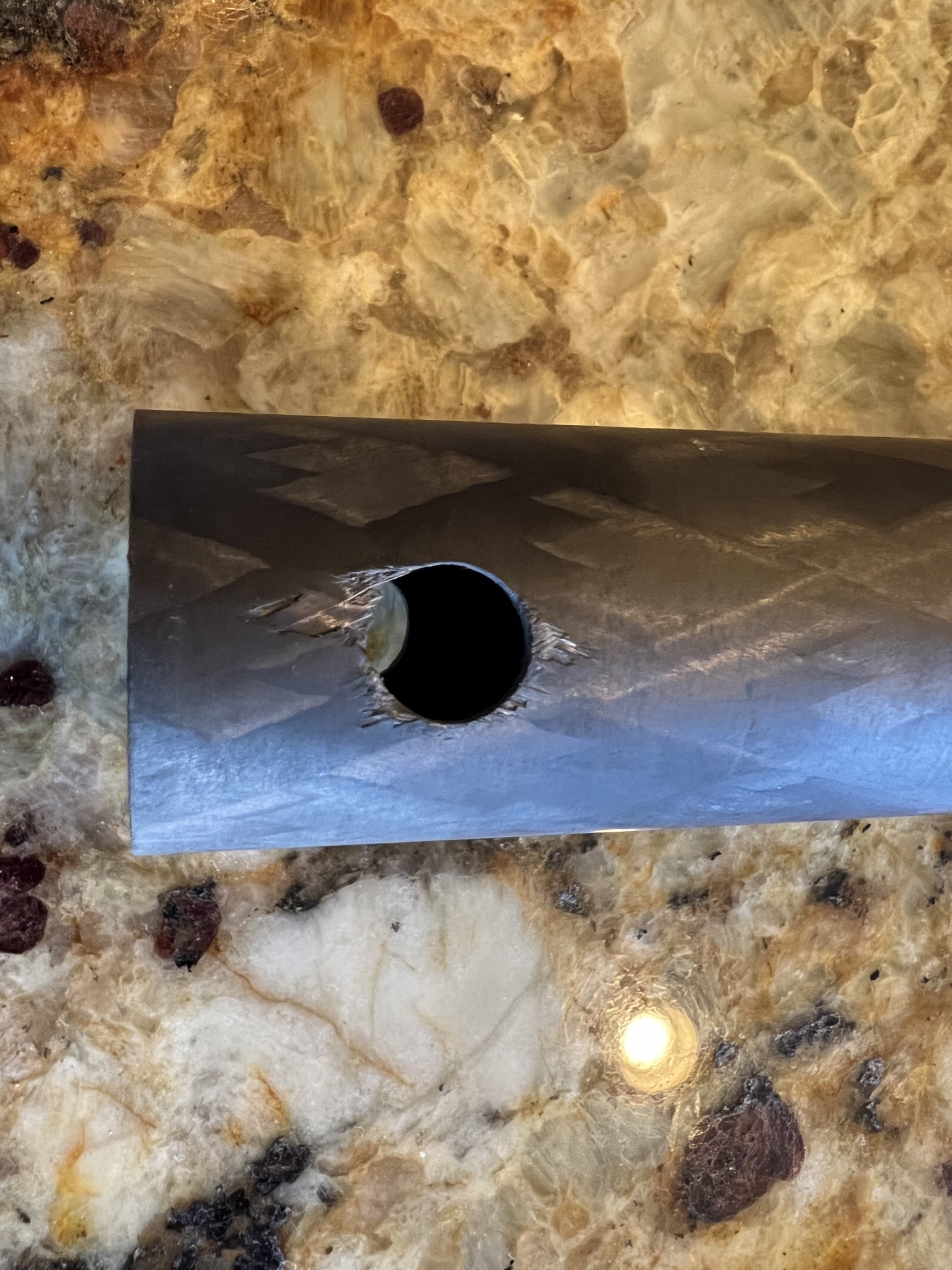

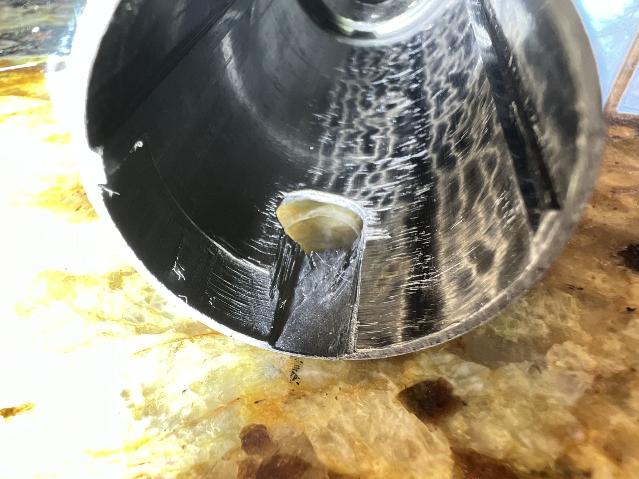

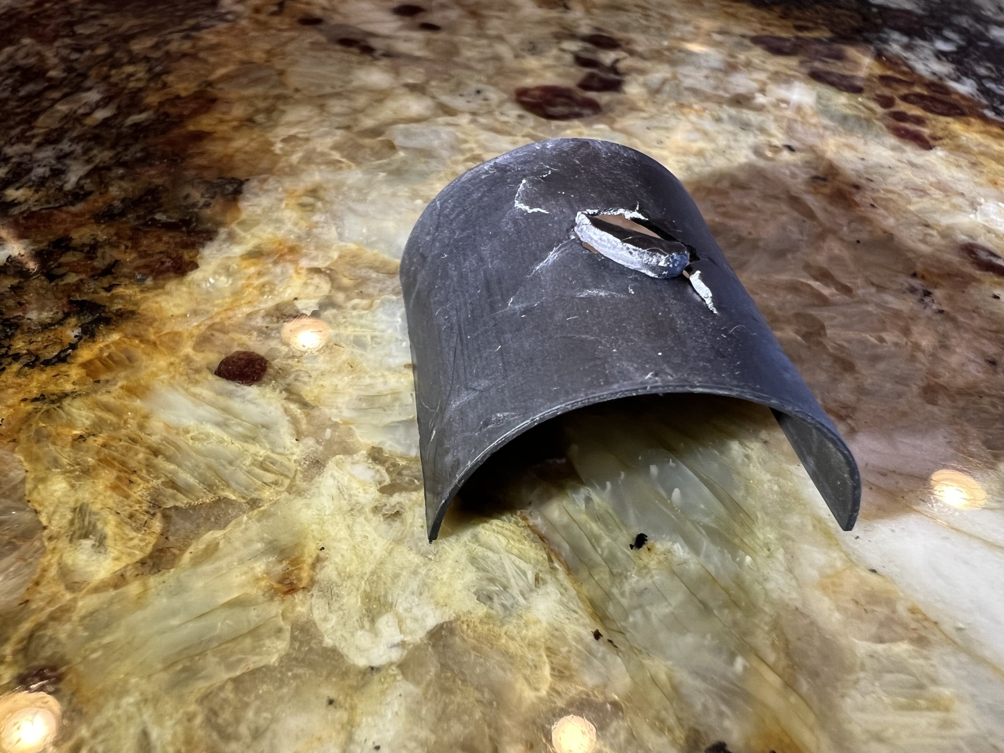

Even RRS fails.
Sent it in for warranty repair.
RRS doesn't consider the flaking CF around the hole to be in need of repair. They did replace all the inner guides with new ones. But I have two wipers failing as well. They're supposed to send me a new one, they don't know about he second one as I didn't know until I looked closer at the picture, hopefully two or three.
Returned from warranty with new inner guides.

@Jefe's Dope i can’t speak for what was said to you from our customer service. I know those red circled pieces where from a batch we found out needed replacement. We are sending everyone with that issue we find out a full replacement twist lock with the internals included. The sealed ring was mainly a design for salt water photography. For now just remove those extra pieces and it’ll run fine and let us know and we will send them out. Running it without the doesn’t hurt anything, just to keep you going.
As far as better warranty service you can say what you want, I won’t compare it to another company. For us, we will fix or replace at our discretion for 5 years to make sure it’s back to operable and not fail. If that is what the engineer and assembly directors said was the case I can’t argue their decision but I will inquire. Apologies we didn’t meet your expectations.
One question I have, was that same carbon leg returned to you with that groove missing under the anti-twist flange? (The missing rectangle shaped carbon).

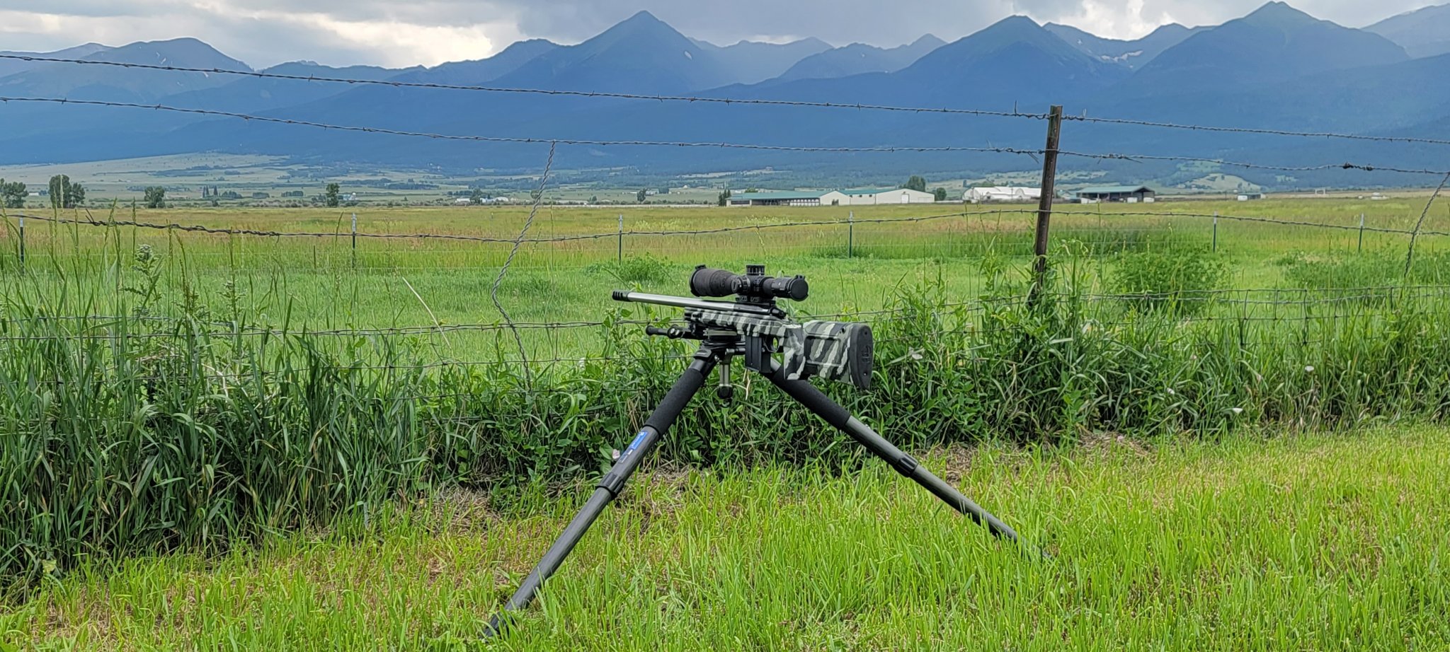

Yeah, my budget tripod setup is pretty nice, I was surprised how decent it was when it showed up and how well it's held up and performed (kind of expected it to be shitty, but it's not, and not just "for the money"). If I was going on expensive hunting trips, hell yeah I'd pony up for the legit RRS stuff... but for what mine cost it's absolutely fine for my needs.
The Harris adapter is an RRS HC-Pro, I dig it and think it's great that it works with both ARCA and pic rail too (wish more stuff was like that).

Even RRS fails.
Appreciate the reply.
Good to know the wipers aren't necessary.
Everything returned is the same with the exception of the replacement inner guide bushings (that's what I refer to them. The ones with the triangle shaped openings vs. the original parallel version). And appeared to have been "refreshed" with some new grease on the twist locks.

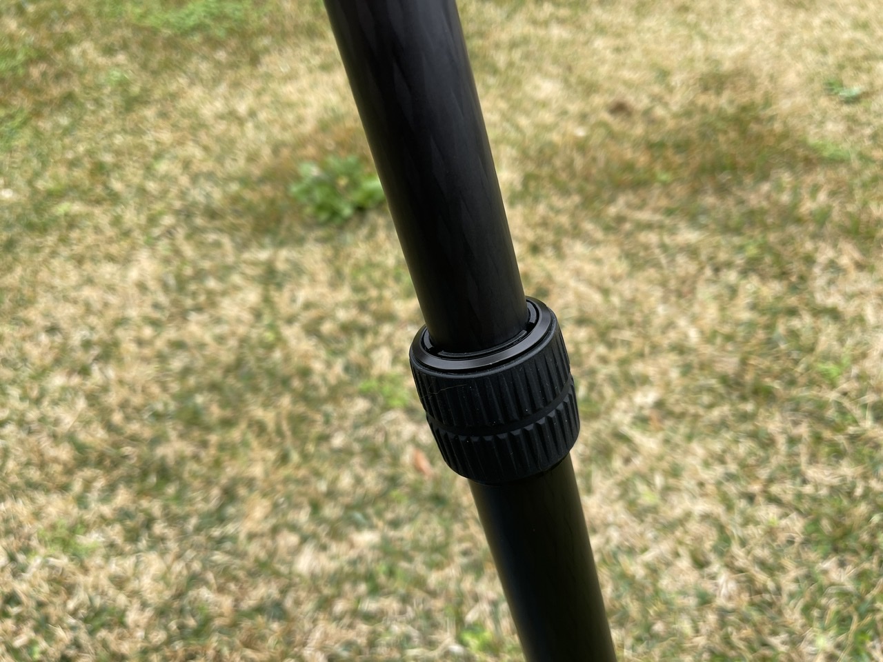

*All photos below "Returned from warranty with new inner guides." in my post above are after I received it back.
1. The tripod works as expected with the exception of the wipers coming loose. I inquired as to what I was doing wrong that makes these come loose in my most recent reply to your warranty department. But it seems you've answered the question here with bad batch.
2. Your warranty dept. has been excellent with me and has been fast to reply and both send a shipping label and return my tripod to me. Again, in prefect working order. I only knew the hole in the leg remained un repaired because I look it apart to see what became of the hole.
3. I've edited my post above due to the fact that I don't think I fairly portrayed your warranty dept. vs. others. I was wrong.
*TO BE CRYSTAL CLEAR*
I very much like my RRS tripod. It has worked for everything I've used it for even when one of the inner guide bushings was damaged. This only caused the leg section to have a bit more resistance and not pull as smoothly as the other two. Which prompted me to disassemble and inspect.
When the tripod was returned from warranty repair, it worked as good as new. I only knew the hole had not been repaired when I disassembled to see what was done to repair the hole.
I did have expectations that the hole would either be repaired in some manner or that leg section would be replaced. I'm a bit disappointed that the hole was not at least repaired in some manner. When I contacted customer service about the hole not being repaired, I received a similar response to yours in regards to what the engineer's decision was.
My concern in not that it is in working order today, but six years from now when I'm out of warranty and the hole fails.
I have and will continue to recommend an RRS tripod to anyone asking. But I will also relay my experience as it is not a trivial purchase. Even in this sport.

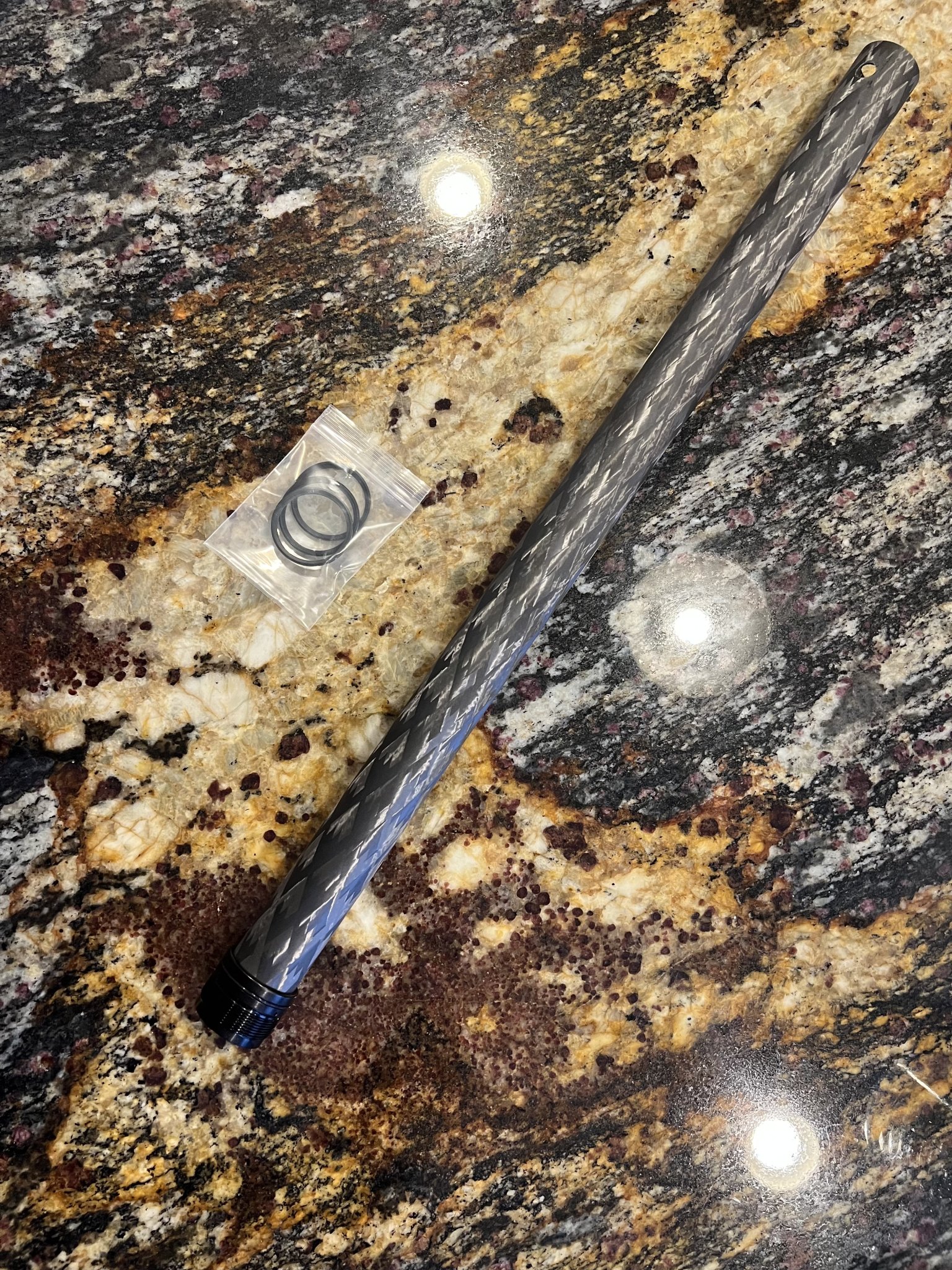

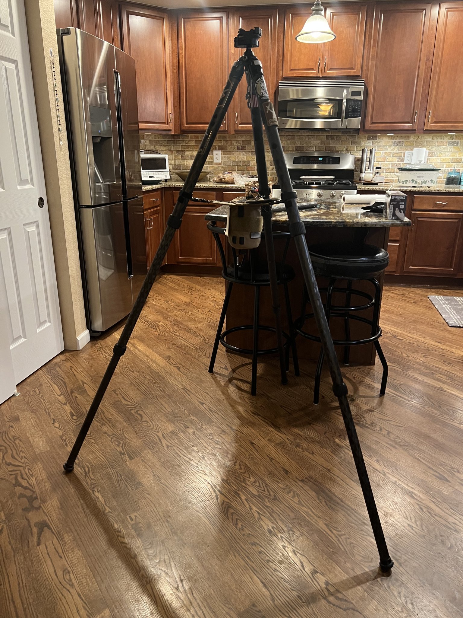

I wanted to post an update to my experience with RRS. Everything is on this page if you're unclear.

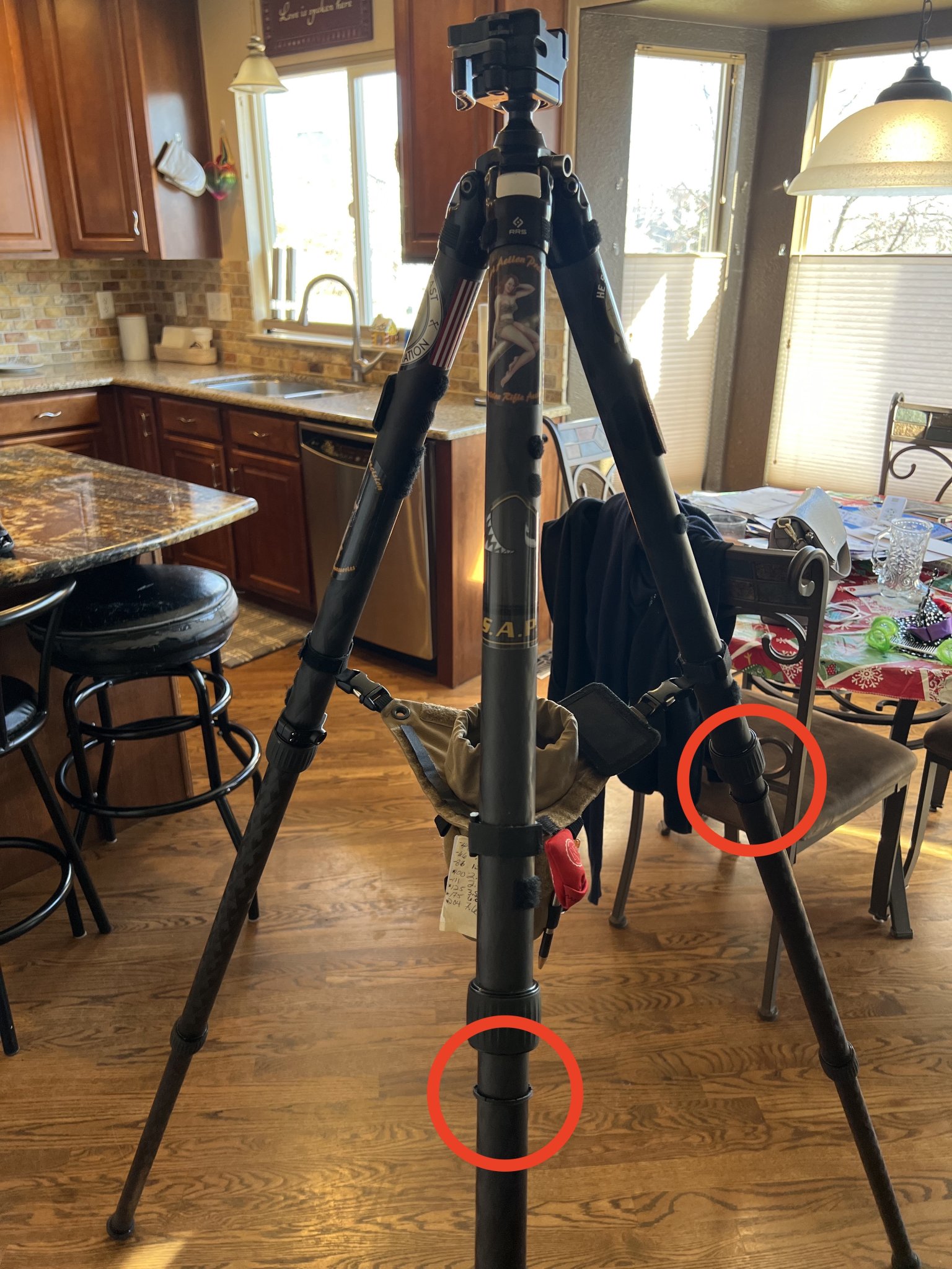

I received my new leg section today and installed it with the three new wipers I'd received a few weeks ago.
I'd like to give a shout-out to @MPHReallyRightStuff for seeing my post and acting. I did not PM him for help. He stepped up and advocated for me with their warranty department and as a result, they've changed the way they review incoming products. This is how good great companies respond.
Thanks MPHReallyRightStuff and Chris in warranty at RRS.
In all its glory. :D

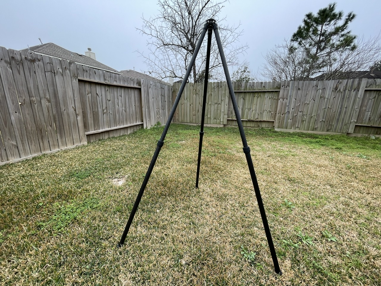

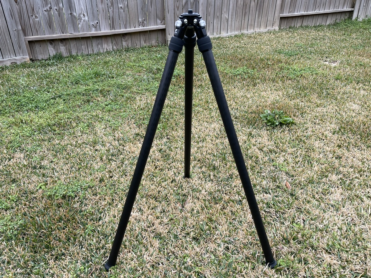

I have a Leofoto SO-282C arriving today that I plan on utilizing predominately for rear support. Of their three models, the 282C is the smaller one with 32mm outer legs. It should be arriving later today. I’ll give my thoughts on it. Two Vets got some more IB-30 in so one should be arriving to me next week.

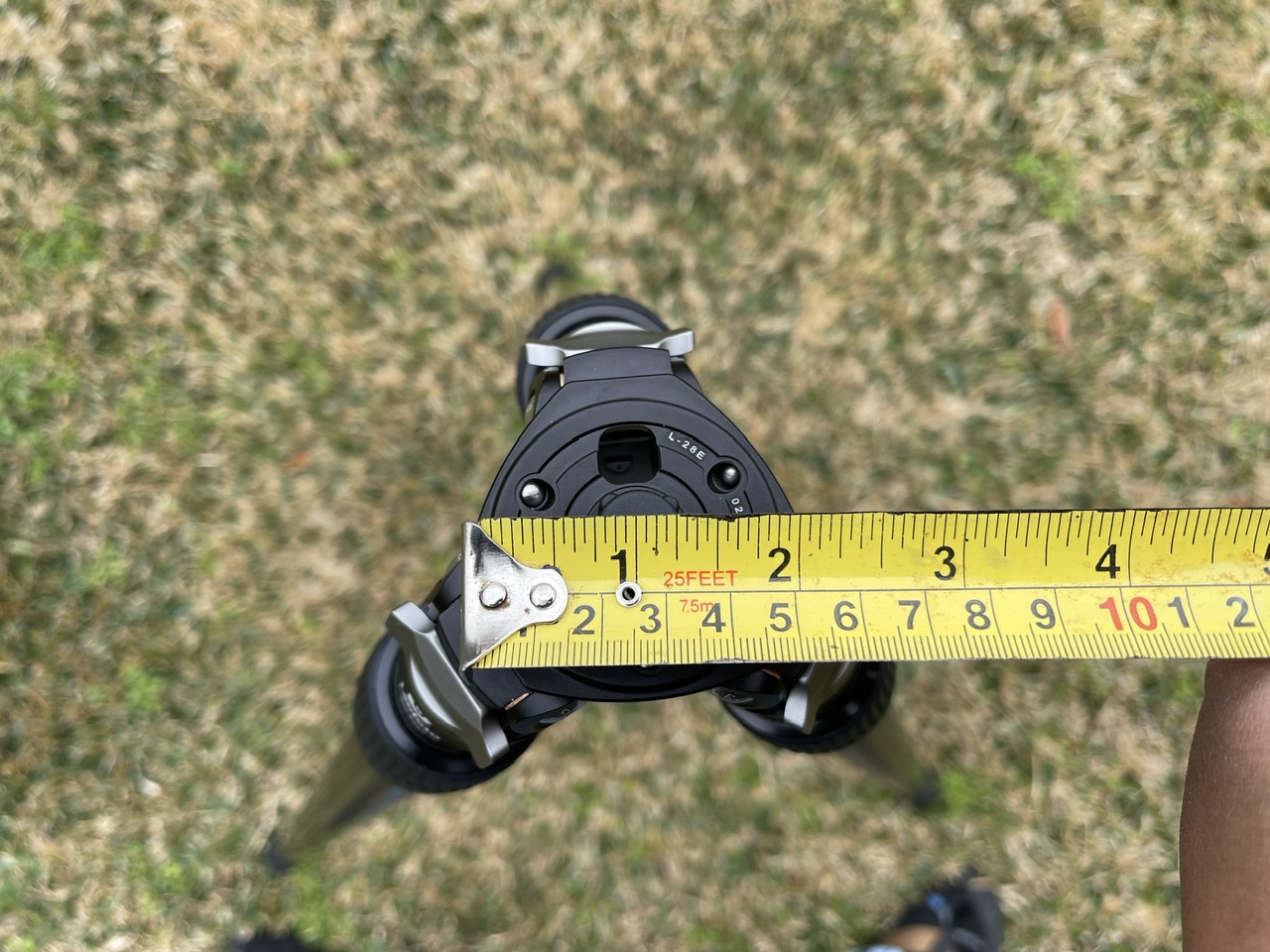

So here it is.. the Leofoto SO-282C. Off the cuff it is very light and surprisingly nicely made. I’ll leave it at that and will not compare it to anything else on market or ever say “it’s just as good.” It’s a little on the narrower side but for occasional rear support and to run binos I can justify it. Fully collapsed it’s about 3’ tall. Fully extended it is 5.5’ or so.
The upper (inner) legs are about 28mm OD and lower (outer) legs are 33mm OD. I messed around the house with the rifle and tripod in various heights. The upper legs feel fine for support. I also applied downward pressure on one leg. Felt stable enough. The apex is very small at 2” wide. One thing I don’t like is how they reversed the locking collars. Lefty tighty, righty loosey. To save time on production they probably just flipped a set of legs upside down and mounted them up. Lol
This example of customer service is worth the money spent.
I had a similar looking issue on a slot in a Precision Reflex Inc Carbon Fiber Handguard, yes the same PRI that made MK 12 SPR parts.
They told me that the defect was completely normal. You could pull apart the carbon fiber weave by hand. Thats how poorly it was done around the slots. Based on that idea of "normal" I realized long term if something else went wrong, I'd be SOL, and promptly sent it back to them..
Reactions: Jefe's Dope

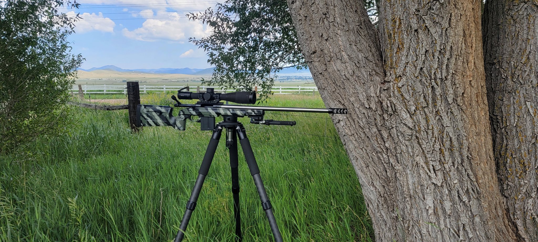

I wish 2 vets would build there inverted in this way with the locking collars up. I like there locking collars and I like the version 1 Apex that is large for throwing a bag on top.

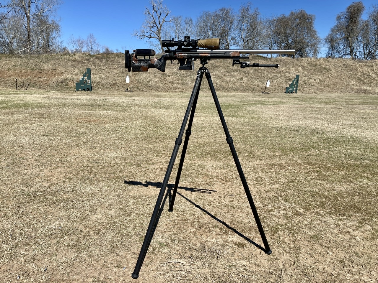

Even though the apex of the 282C is small, it seems to support a WCMFC just fine. I obviously need to shoot off of it to see but just placing it on there and pressing down in it, seems ok.

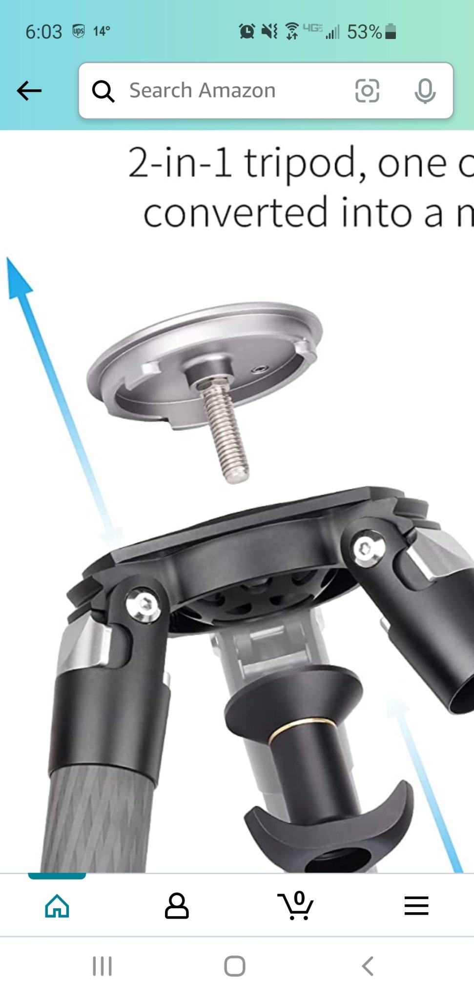

Is there a good cheaper ballhead that would fit and it can be a backup tripod? Something like this: https://cameragearstore.com/collect...0-ma-30l-rapid-lock-ball-head-for-soar-tripod
If I don't use the plate are there good options to drop in?
Just ordered a TVC22I to replace the RTC-90 with Midwest Plate and Anvil 30. I will move the Anvil over to the RRS leggs but need to decide what to do with the RTC90 and plate.
Sunwayfoto IB-30 purchased from Two Vets. Works fine and is cheap.
