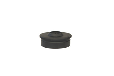

Being in the U.K. I don’t have access to the midwestoffroad plate. Measuring the RT90C today the place / bowl size is really odd. It’s neither 100mm or 75mm. I know it comes with its own bowl adapter but it would seem no other off the shelf plate will fit. Any I right or wrong?

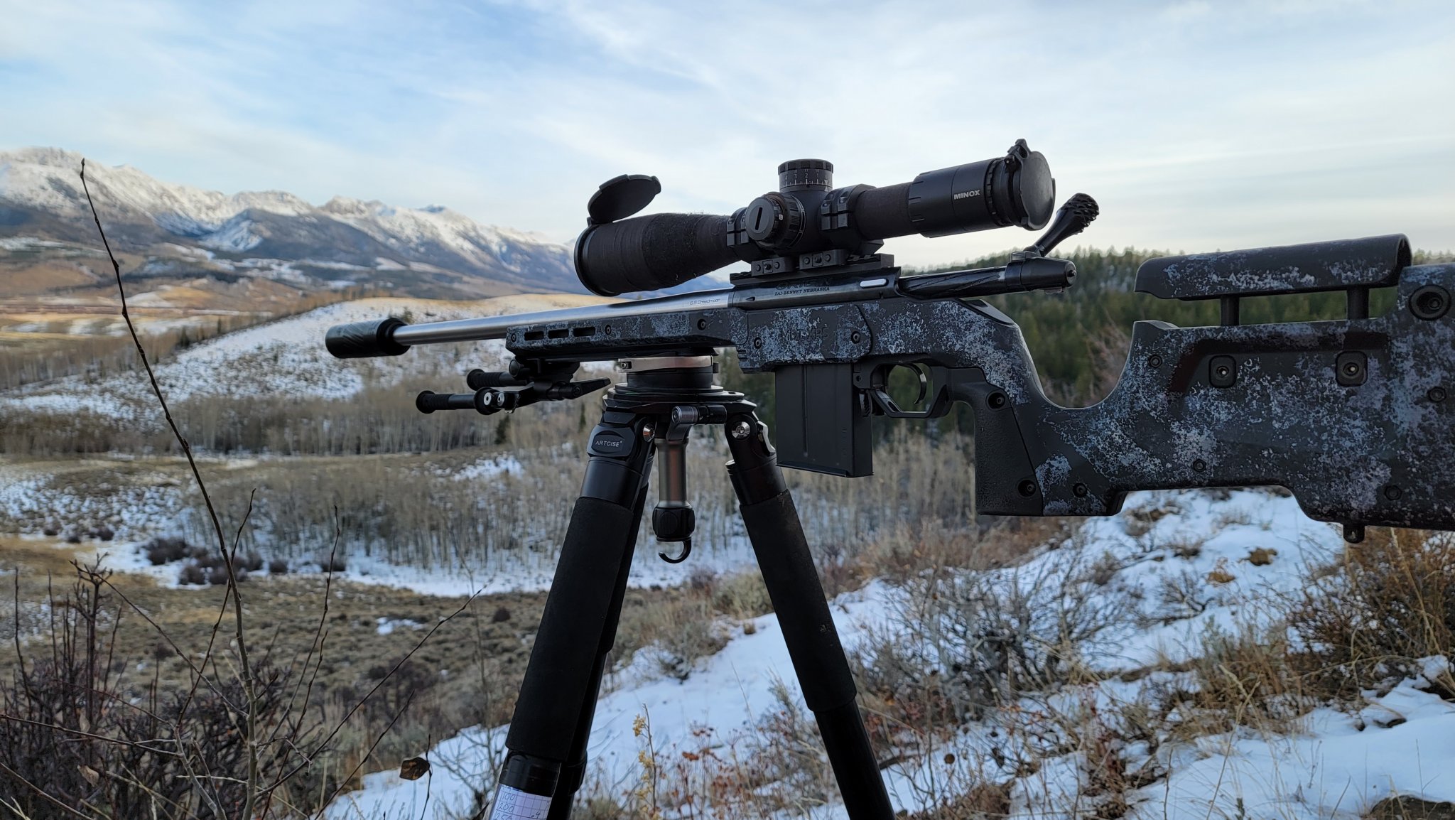

I initially bought the RT90C to use as a spotting platform for precision matches. After going through some different ball heads I settled on the Sunwayfoto IB-30. I've gone on to use it to great success for varmint hunting, shooting squirrels standing off the tripod from point blank to 200 yards with my 223 and out just past 100 with my Vudoo 22LR (pictured below). The RT90C now seems a bit heavy to be walking around with. I may be in search of a lighter option for next year's varmint shoots.

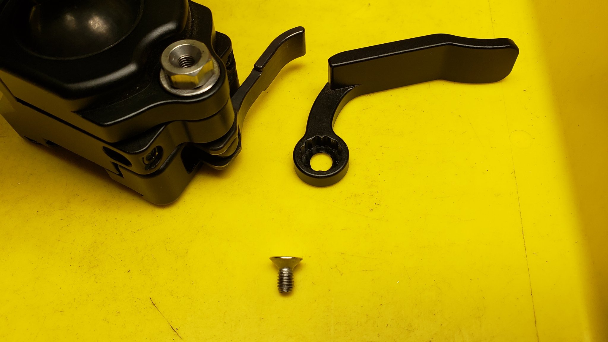

When new, the IB-30 held tension well, but after a year or more, it was right on the edge of holding the rifle securely without tipping.
I looked further into the construction of the IB-30 and found you can adjust the tension. Just remove the screw that holds the tension lever and you can then re-index it to hold tighter. Hopefully this helps someone who's displeased with the initial tension these offer.

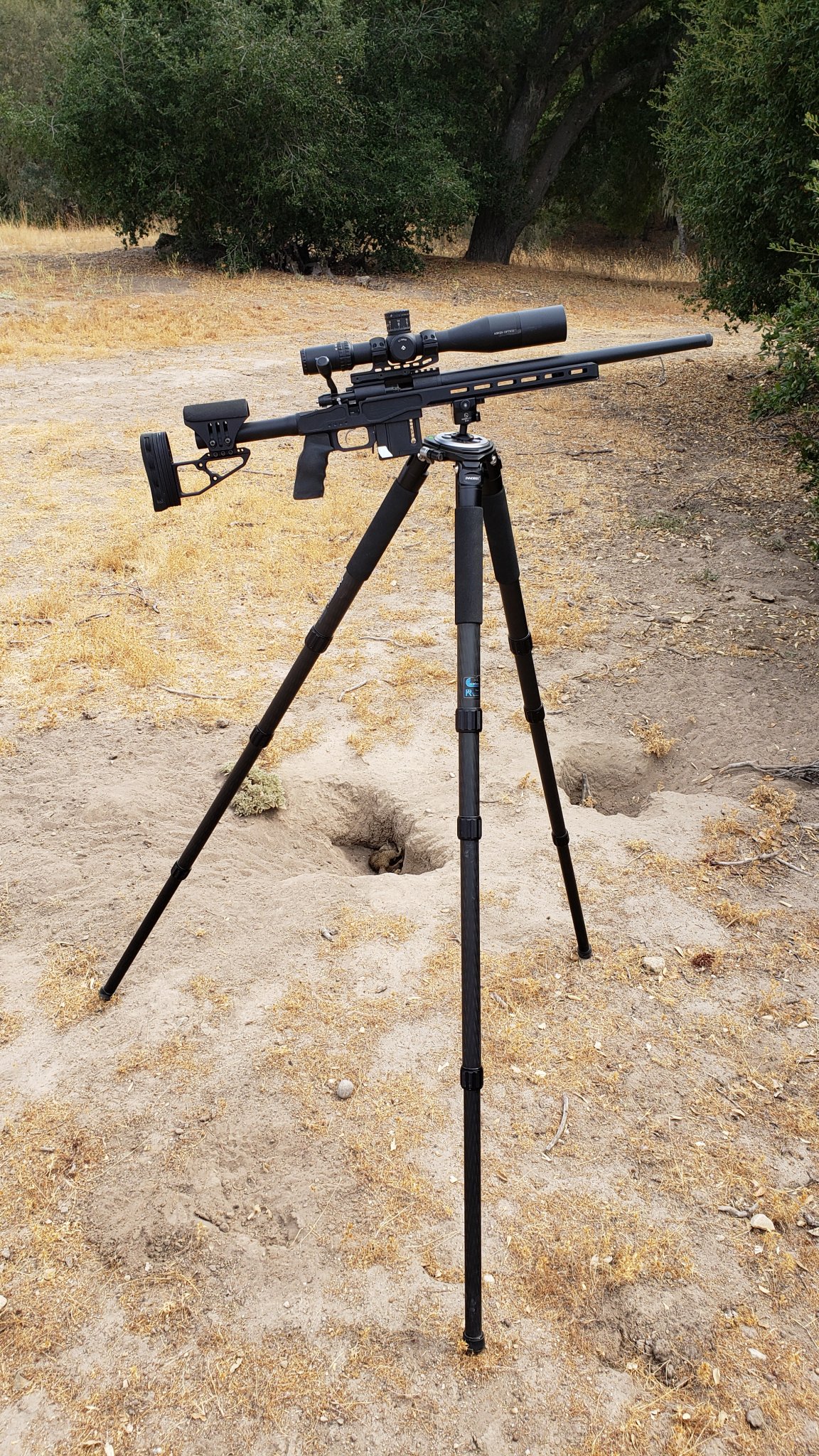

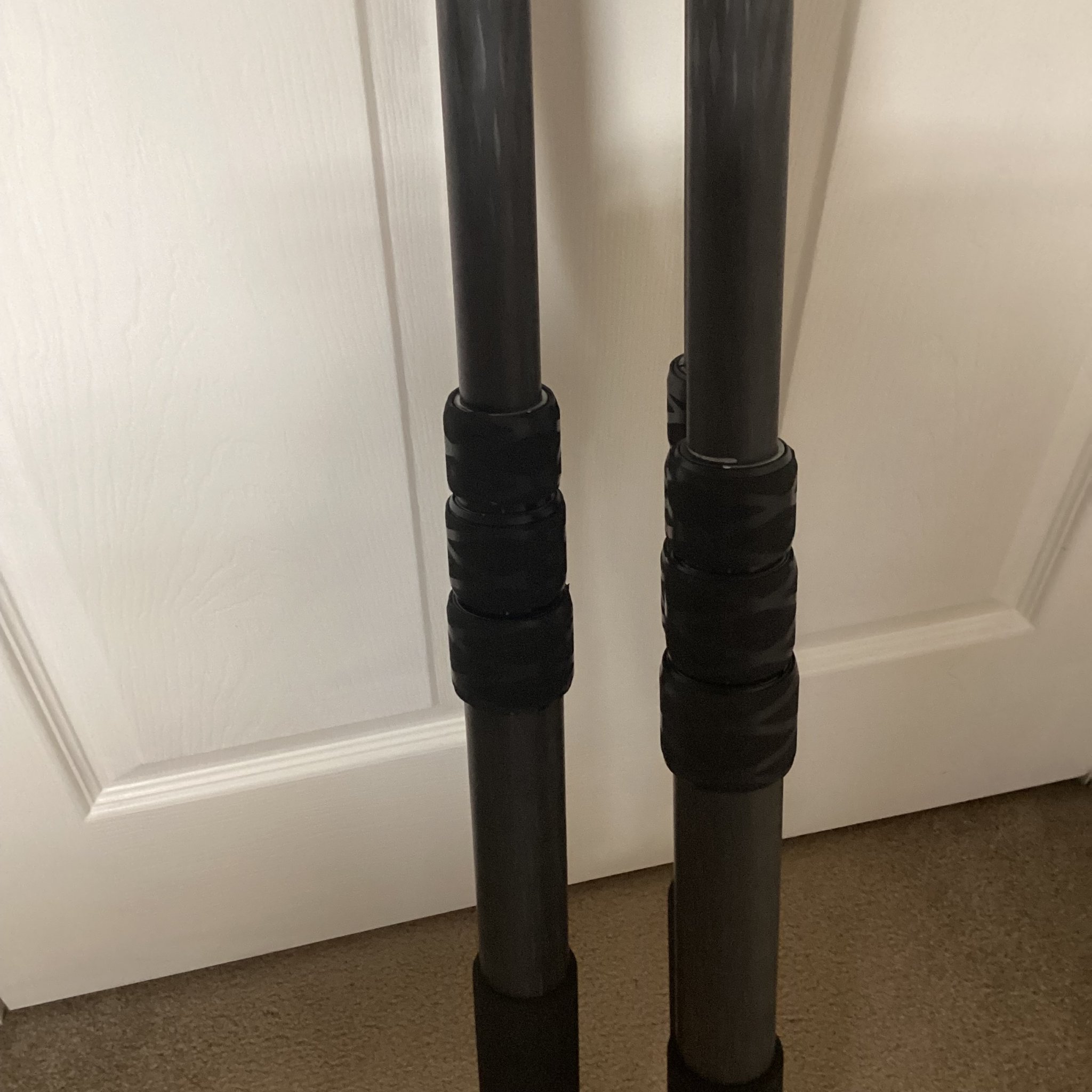

Don’t know if this has been mentioned before , but here is a little mod I did to my rt90C, and boy what a difference it made.
When I first started using my rt90c for night hunting I was horrified how loud the legs were. Whenever I folded the legs they would somewhat cross and the knurled tightening knobs would bang together. It sounded like pots and pans banging together in the quiet of the night. It was bad enough I was trying to sell the tripod and was going to replace it with another brand that the legs don’t cross (nice feature).
I got an idea and found some 45mm heat shrink on Amazon meant for fishing rods.
The 45 mm tubing will fit all 3 section locks on the tripod. I did all 9 twist locks on mine , and wow what a difference it makes !
