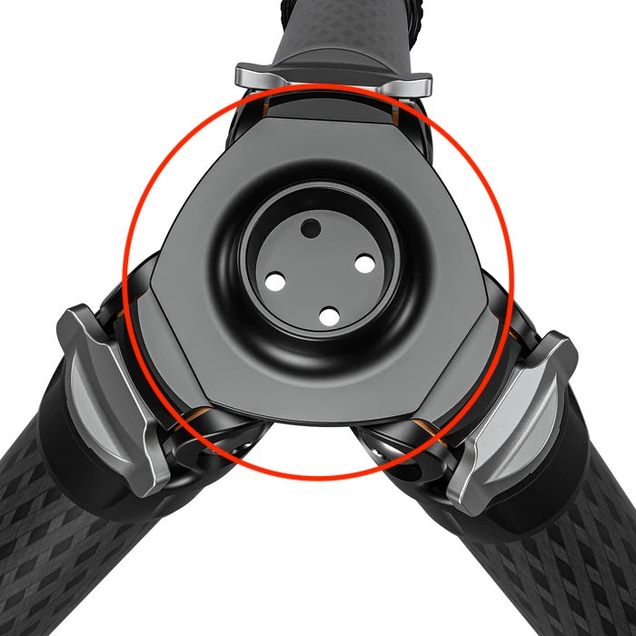

Bottom of the anvil has 4 holes and one big one in the center (i believe it's 3/8). You could easily use the center hole to mount the anvil to the tripod, but there is a big possibility that it'll come loose under torque of movement of the rifle on the anvil.
If the anvil is secured by the 4 smaller bolts, you're eliminating the change of that.
I got the plate from @midwestoffroad and it works perfectly for the application between anvil and rt90c
Reactions: 260284
You can screw it to the plate via the 3/8 stud. The anvil is tapered. And it is 1.00 in diameter. So directly mounted to the plate there is quite a bit of leverage on that 3/8 stud. That is supporting your rifle.
The adapter utilizes the taper fit and secured with 4 screws on the bottom provides more rigidity
Factory plate just has the stud. Midwest plate has the stud plus four additional screws to keel it from rotating off the stud when you move the rifle left or right. No matter how tight you make it or how much loctite you use, you will loosen it from the factory plate.
Reactions: 260284
Another reason for the more than one fastener approach: both parts being fastened are aluminum and/or aluminum alloy and every movement, irrespective of how minute, effects to egg out the holes on both.

Being in the U.K. I don’t have access to the midwestoffroad plate. Measuring the RT90C today the place / bowl size is really odd. It’s neither 100mm or 75mm. I know it comes with its own bowl adapter but it would seem no other off the shelf plate will fit. Any I right or wrong?
