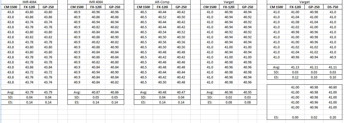

From strictly an SD point of view, improving the accuracy of your powder weight can help a lot . . . particularly if a .14 gr variation can effect your SD numbers. Below is a comparison I did with some various powders using a fixed indicated weight on my Chargemaster and comparing that weight on my more accurate scale, the FX-120i (along with my Gem Pro 250 just to see how it compared too). The 120i definitly got me consistently into the single digit SD's.

The more costly suggestion would be to upgrade your scale/powder thrower with something like and AutoTrickler. My Chargemaster worked fine, and 90% of the charges would be fine, but after I got a better scale I did some samples and found that maybe 10% of the throws were outside of the desired range. With an AutoTrickler and a good scale you can reduce variability in your charges.

I use mostly Varget in 6 GT and 6 ARC, H4350 in 65 CM, and 4064 in 7-08. From your tables, it looks like all three powder measures are well under the 0.1 gr goal/spec of the CM1500. How much doe it cost yo go to the FX120i all in? Is it enough better than the GP-250 to spring for the extra dollars?

The dry lube will happen on my next pass! What are we looking at for the AutoTrickler and FX120i? Any extra costs or just the base price of the units?

Hmmmm??? 0.1 accuracy = +/- 0.1 gr = ES of .2 gr, so my 1.4 gr. ES results are better, but not great.;)
The FX 120i is not cheap and it run as low as $550 -$600 (often more). The best thing about the 120i is not only is it accurate, but it's fast and stable (it doesn't drift like other cheaper electronic scales). The GP-250 can be irritating as it tends to drift, though I developed a technique for keeping that better under control. There are some cheaper electronic scales that are similarly accurate. You just need to be aware of their susceptibility to drifting.
BTW: Autotrickler v3+ scale = ~$900

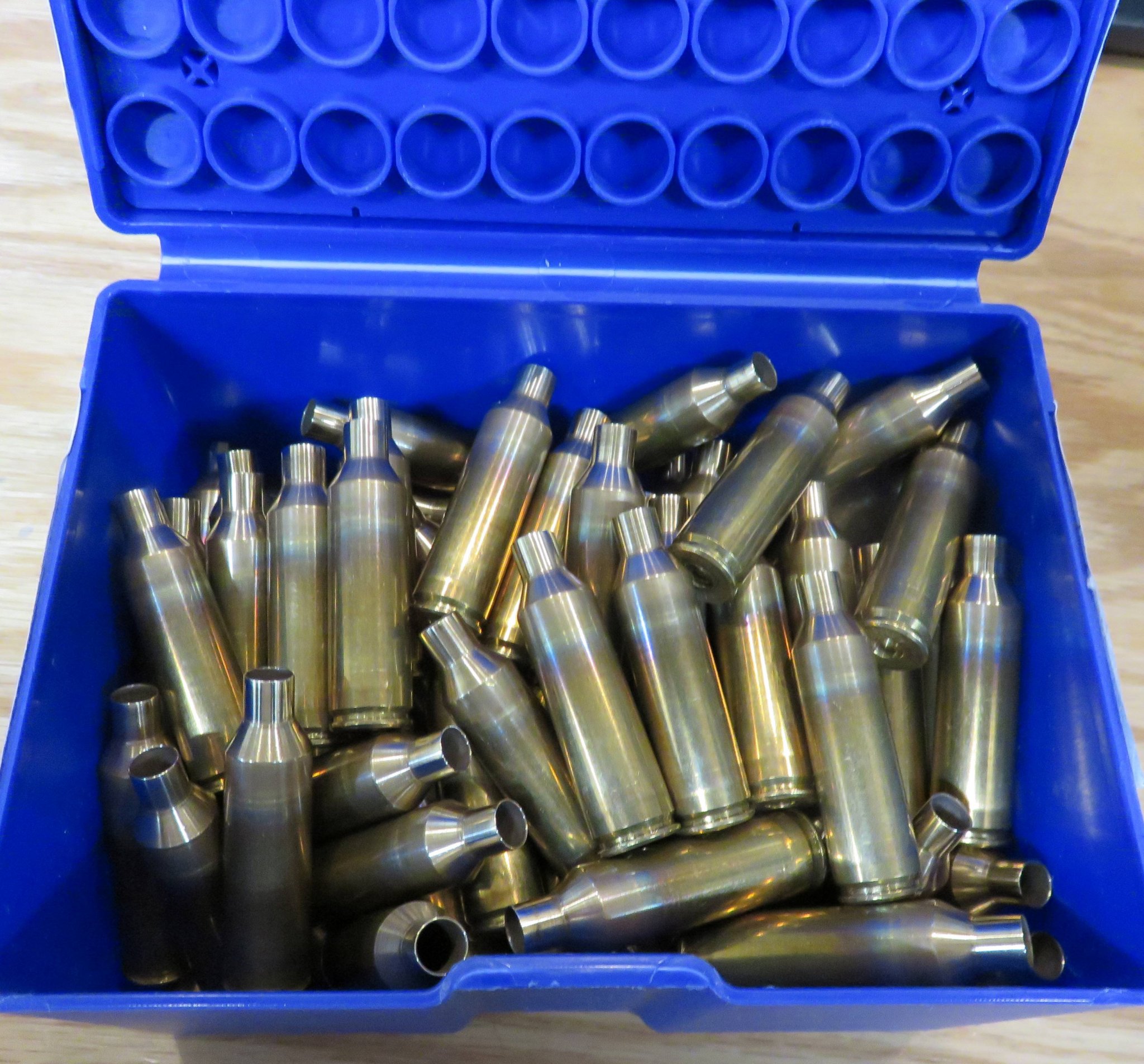

I don't clean my brass until after I anneal as the annealing process leaves a rough/tacky oxidation film layer that I want removed before I run them into my sizing dies. Though I focus on cleaning the outside, the inside isn't touched until after sized where I then dry tumble with medium sized rice that takes care of any that oxidation layer left inside. The end results look like this (7 reloads so far on this 6.5 PRC brass):
Especially with suppressed gas guns, my brass gets filthy hence the steel pin right after decapping. Would you anneal the dirty brass before steel pin?
When you say "filthy", it makes me imagine your brass caked in mud inside and out. So, no . . . I would not anneal before tumbling with steel pins. Having heavy dirt or mud clinging to the neck and shoulder would not be good for the annealing process to get uniform results.
A very good rinse after tumbling with pins to get rid of any cleaning chemical residue (e.g. soap, polish, Lemi Shine, etc.) left on the case will minimize the amount of the oxidation film left on the brass. And the sizing process can then be ok. But one will need to lube the inside of the necks for bullet seating. In the past, I've experimented with annealing after wet tumbling and then I'd size the brass, then use my vibrator tumbler, using medium grain rice, to removed the Imperial sizing wax. This also left a very light waxy film behind (feeling like the paint surface on my car after I've waxed it) where it worked well inside the neck to smooth bullet seating nicely.

Chargemaster is more than capable of making accurate ammo. Its not as good as a FX120, but thats a big jump. The first thig i would do is address the neck tension as many people are suggesting.

Glad to hear about the CM1500. Given that conclusion, why spring for the AutoTrickler and 120i?
My main reason was I wanted one.
I had a CM lite before and my SD/ES didn't seem to change much.
The V4 is faster especially with large charges (100gr ish) and I have the piece of mind that it's exact or very close.
When I got my 120i I weighed 10 charges from my CM lite and the variance was .1 grain

I bought the Auto Trickler solely for speed of throwing charges, not necessarily because it was more accurate than the other scales. You can jailbreak your ChargeMaster to adjust the settings, but my issue was overthrows, so I could adjust the speed settings and take a little longer to throw a charge or I could speed it up and deal with the occasional overthrow. Granted, it's not like the ChargeMaster was overthrowing by 0.2 grains, but if my charge is 42.0, the OCD part of me doesn't want to see 42.1 on the display. The Auto Trickler simply throws accurate charges in significantly less time than the ChargeMaster and if it overthrows, it's only a kernel or two, not a full tenth of a grain.

Second, evaluate your powder throw. Borrow or buy a precision scale. It should be stable and accurate to 0.02 grains (there are 350,000 of those per pound) or 0.001 grams (there are 453,600 of those per pound). A load cell scale is probably not good enough. I have an expensive load-cell scale. It is milligram-accurate but it is not stable.
Throw 25 or 50 changes on the Chargemaster, weigh each one on the precision scale, write down the numbers.
If your Chargemaster holds plus or minus 0.02 grains, don't change anything - and don't bash it, that is a good one. If it doesn't hold plus or minus 0.02 Gr and your style of shooting demands high precision, consider one of Adam's toys or consider modifying your process. I love mine. By the way, one grain of IMR 4064 weighs a little less than 0.02 grains. One grain of IMR 7828 weighs a bit more than 0.02 grains. I refuse to cut grains of powder, I just can't shoot that well. Those powder grain weights are why I suggest a scale with 0.02 grain precision.
