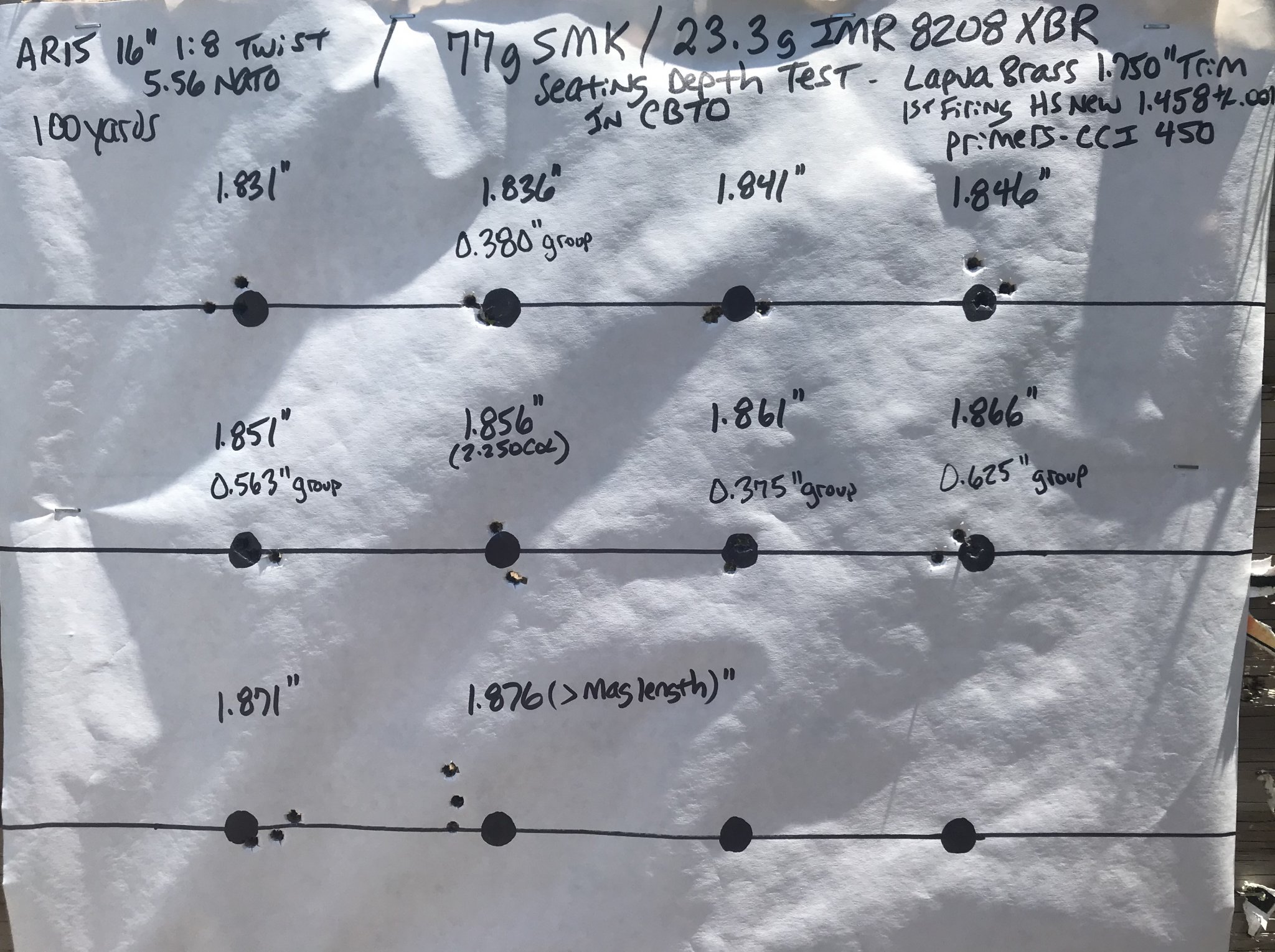

Your next step is to do a seating depth test. That is the step where you look for group size. If done properly, I guarantee you will find one group that shrinks right up and stands out from the rest....
Here is my load development with 8208XBR and 77smk out of a WOA 20: 1:7 SDM barrel all at 100yd

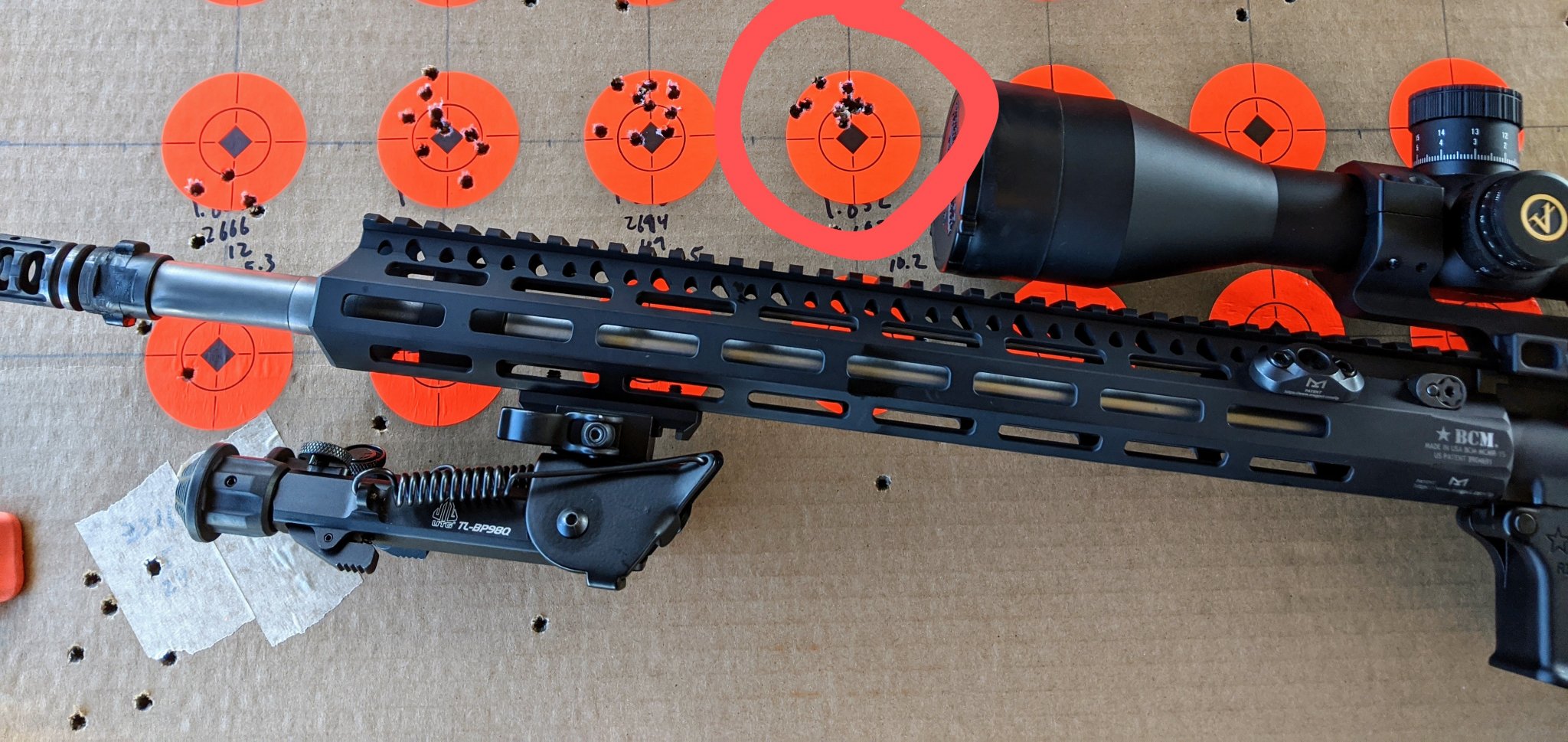

This is my initial OCW looking for the node (consistent POI across various consecutive charges).. You can see, my POI is very consistent from 23.2gr to 23.8gr. I picked 23.6gr being pretty much in the middle of this very wide node... If not knowledgable about how to do proper load development, you would think Im crazy as 23.6gr is one of the largest groups. But doesnt bother me, because Im NOT looking at group size. You have to ignore it.
Now, Ive selected 23.6gr so I load up a bunch of rounds with 23.6gr and I do a seating depth test, again shot Round Robin style at 100yds..
Now here you can see the clear stand out of the seating depth my barrel/load likes. It shrunk right up, just what I was looking for. Im now ready for load confirmation test.

I then revisited OCW test with 68g BTHPs, and also did as you recommend, and tried a Seating Depth Test with my 77g SMKs at 23.3g of 8208 XBR load. These were done round robin with 10min cool time between each flight. No Chrono this time. Forgot it🤦🏻‍♂️. Here’s what I got:
Not sure what to do with the 68g load. POIs are moving around from starting left, to centering up, to ending right. 23.2 maybe then Seating Depth Test? Your thoughts are welcomed.
The 77g SMK Seating Depth test below was fun, but this was a first firing for the brass, and I’ll admit, it’s hard for me to break that many shots consistently, so I’m not sure if I was as precise as I should have been on my technique. Anyhow, my interpretation is that slightly over 2.250 COL at the 1.861 CBTO is looking good, but I’m all ears if you have any thoughts or recommendations.

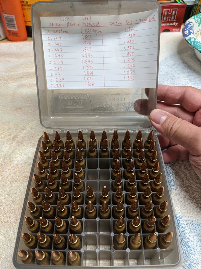

When measuring the bullet seating depth to the ogive with the Hornady tool, I usually measure 8 times while turning the cartridge. If I get 1.846 on all 3 sides of the cartridge, but 1 side I get 1.849, should I seat the bullet deeper until that 1 side measures 1.846, even if the 3 other sides.may measure 1.843?
