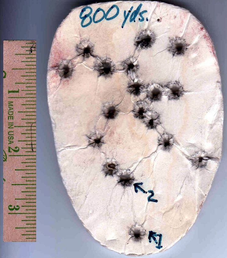

May 1997 issue of Precision Shooting has
an ad for Krieger Barrels, Inc. that showed an actual-size copy of a 20-shot group shot at 800 yards by Bart Bobbitt with his Krieger Barrelled PALMA rifle." Now this group has a .942" mean radius, with an extreme spread of 3.325".
In 1997 on the rec.guns forum on usenet where Bart contributed, we asked him how he did it.
I used a .308 Win. with Sierra's 155-gr. Palma bullet with 45.3gr. of IMR4895 and RWS Primers in full-length sized WCC60 match cases. Had a 20X scope on the English Paramount action and shot prone with a bag under my front hand to steady the rifle. It was about 6AM in dead-calm wind conditions.
Bart is still around and still using IMR powders.
Notice the point of impact rise as his barrel got warm.
What's interesting about Bart and this group is that he says IMR4064 has always been more accurate. They used IMR4895 for the 1992 Palma ammo because they made the ammo on a Dillon and 4985 metered better.
