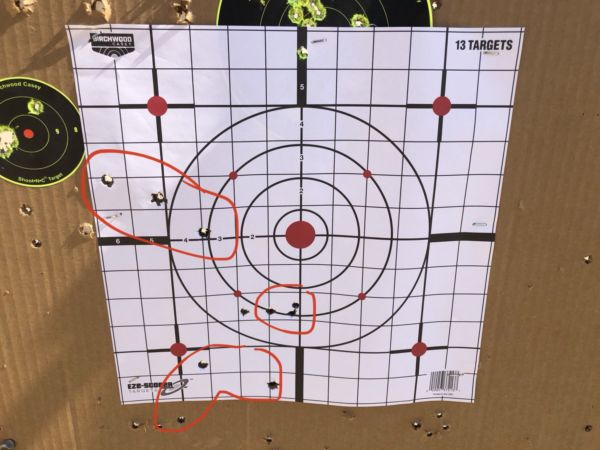

Is there a big difference in skill between shooting magnums and smaller calibers such as .308/5.56?
I can shoot sub MOA groups with other calibers, but as soon as I pick up my 300WinMag I suddenly suck. Both the rifle and optic have been checked my mfg and are not defective. I've tried multiple match grade rounds, including the exact same one the mfg used to shoot 3 sub MOA groups. It's not the gear or ammunition. It's all been systematically checked.
I've tried shooting just about every way, including a sled, but I mainly shoot prone with a bipod and bag. My groups range from 1"(rare) to 3.5." I've noticed a lot of the time a 3 round group has 2 very close if not touching, and one outlier ruining the group. I don't understand why I can shoot sub MOA with a smaller caliber and then have that large of a difference when I shoot the WinMag. I've had friends film me shooting and everything looks normal. I've accidentally fired on an empty chamber a handful of times and didn't flinch. With other calibers I can tell when I throw a round. On this rifle I can shoot a group that feels like it should be great, but it isn't.
I've got around 500 rounds through it and it's been the same repeated target since day one.
I've been scratching my head for over a year and I don't understand how there can be that much of a difference in my shooting ability. Is this common? Am I missing something?

It's a heavy barrel. I have shot strings of 3 quickly, and tried waiting 5 minutes in between each shot, with no difference.

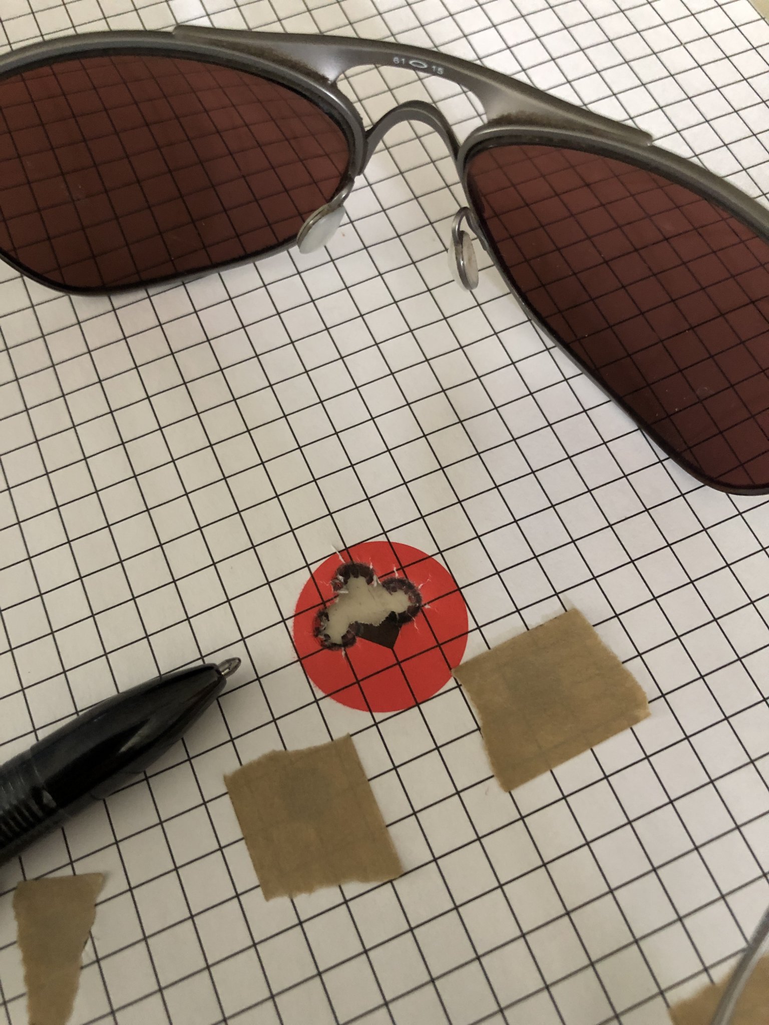

Magnums are a different animal, the last group I shot with a 300NM looked like this,
5 shots, 230gr Bergers at 2990fps,

I can’t believe there’s such a difference.Here are my two 3 round groups with the mag today next to a 3 round group confirming my zero on my 14.5” m4 clone with a 3.5x acog using 62 grn green tip. I’m sure you guys will see the video and it’ll be stupid obvious but damn. I thought I could shoot.
Ok, here it is. Ruffle away.
It looks like the muzzle is jumping a lot, and not symmetrically. How do I stop this? I feel like I have a good NPA. I close my eyes at least twice before each show and when I open I'm still on target. I'm pulling the gun into my should with about the same weight as the gun. I'm loading the bipod by digging my toes in and pushing my whole body forward into it.
