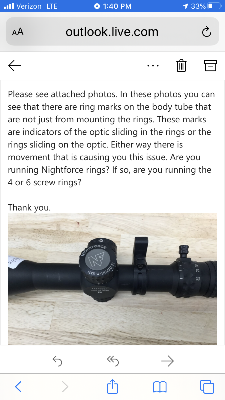

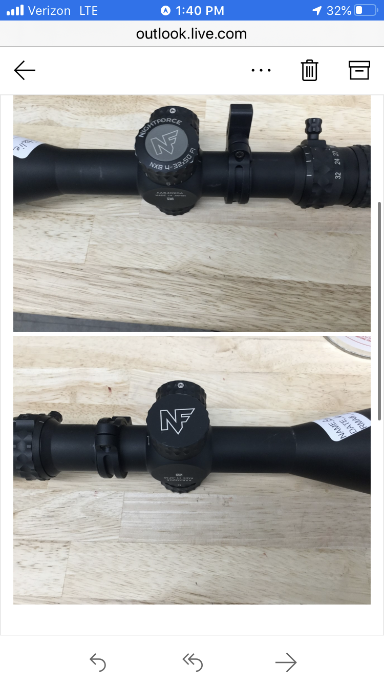

They said they thought the scope was moving in the rings. However, I have remounted it and had it remounted several times to their specified torque settings and nothing has changed.
Did you put a witness mark between one of the rings and the scope's maintube? Try that with a pencil. You should be able to see if the lines separate but can easily erase them once you don't need them.
I did not. Do you think I would actually be able to see a difference with a witness mark? NF said something like .0003 is enough to shotgun rounds. I don't think I can eyeball that.
Can anyone think of something else in the system? Can the rings be jacked up and not hold despite being torqued properly?

Nightforce said they saw signs of the optic moving. I did not see it when it was returned. I sent them an email asking if they were positive it was slipping, or if that was just an assumption because the optic itself was fine. I haven't received a reply yet.
Yeah, maybe not such a practical idea. I did forget that it takes very little movement at the scope to make a noticeable change down range.

So, not sure if you loctite your bases down. Looking at your glass the front ring looks a little close to the bell of your optic. Not sure if it is pinching in the web of the bell. That may be another reason the rings aren't tightening down. In adding to lowlight's comments you may want to lift up the comb of the stock so it is recoiling perpendicular to your shoulder. It looks like it is digging into the ground.

Hopefully replacing the rings will sort it. Most importantly is don't get discouraged as you can take that to the range with you and you start to expect it to not shoot as you want. I shot 5.56 & 308 for a long time and then went to a HS Precision in 300 RUM. I love it but it took me a while to adjust.
