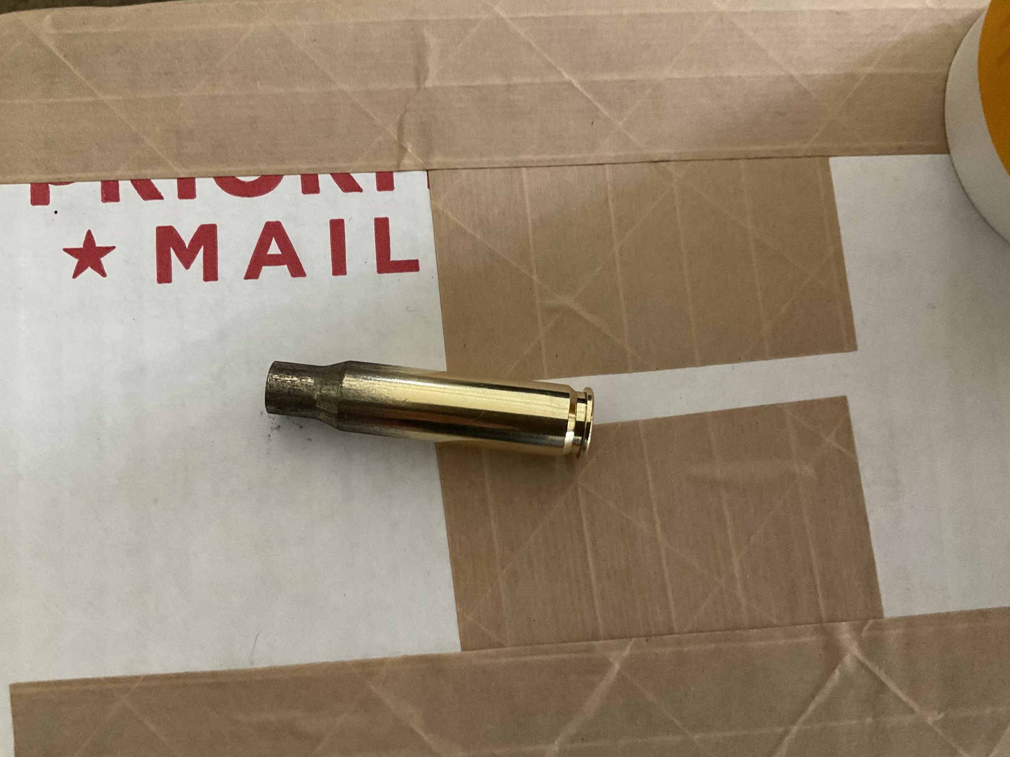

Seems you found your issue OP. Good. Just as an FYI though, I'm wondering if you stripped the Dies when you got them and gave them a good cleaning, always a good idea. And as stated here and there, the Mica/Graphite works excellent.
And when you're resizing and/or bullet seating I always twist my cases 2 or 3 times, depending on Die Set, to get as close as possible the same seating depths and concentricity. Always a good idea to run your new brass through either a mandrel or your sizer button ro round out necks/mouths and hopefully close to the same neck tension. Just be consistent in what ya do.
Reactions: Changed
I don’t think what you did applied enough graphite to the neck. The necks should look sooted like this:
Reactions: 1J04
In order to get that much graphite on the case I had to remove 1/3 of the ceramic media and shake the hell out of the container. But now bullets seat smooth as butter even in annealed necks.
