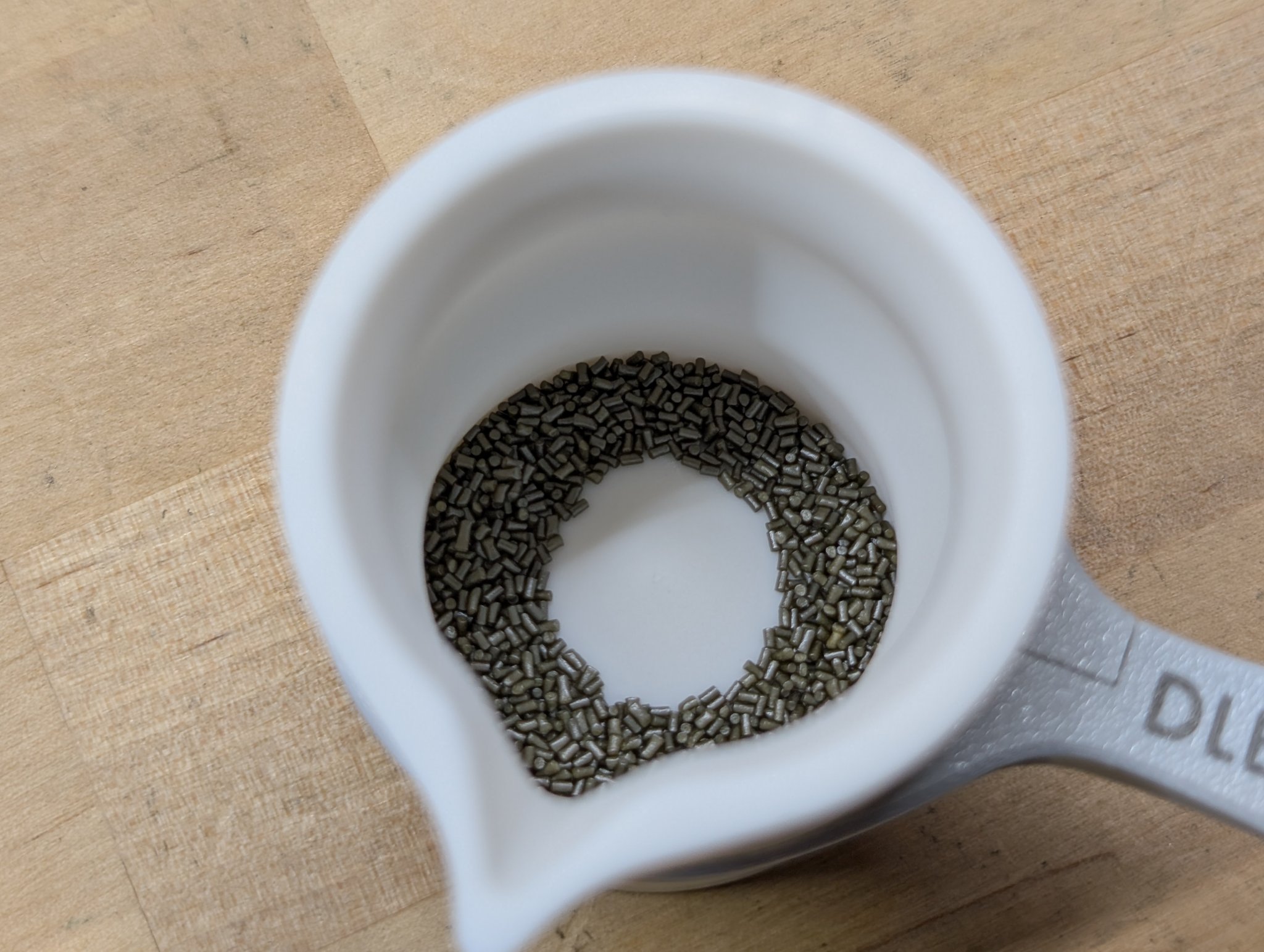

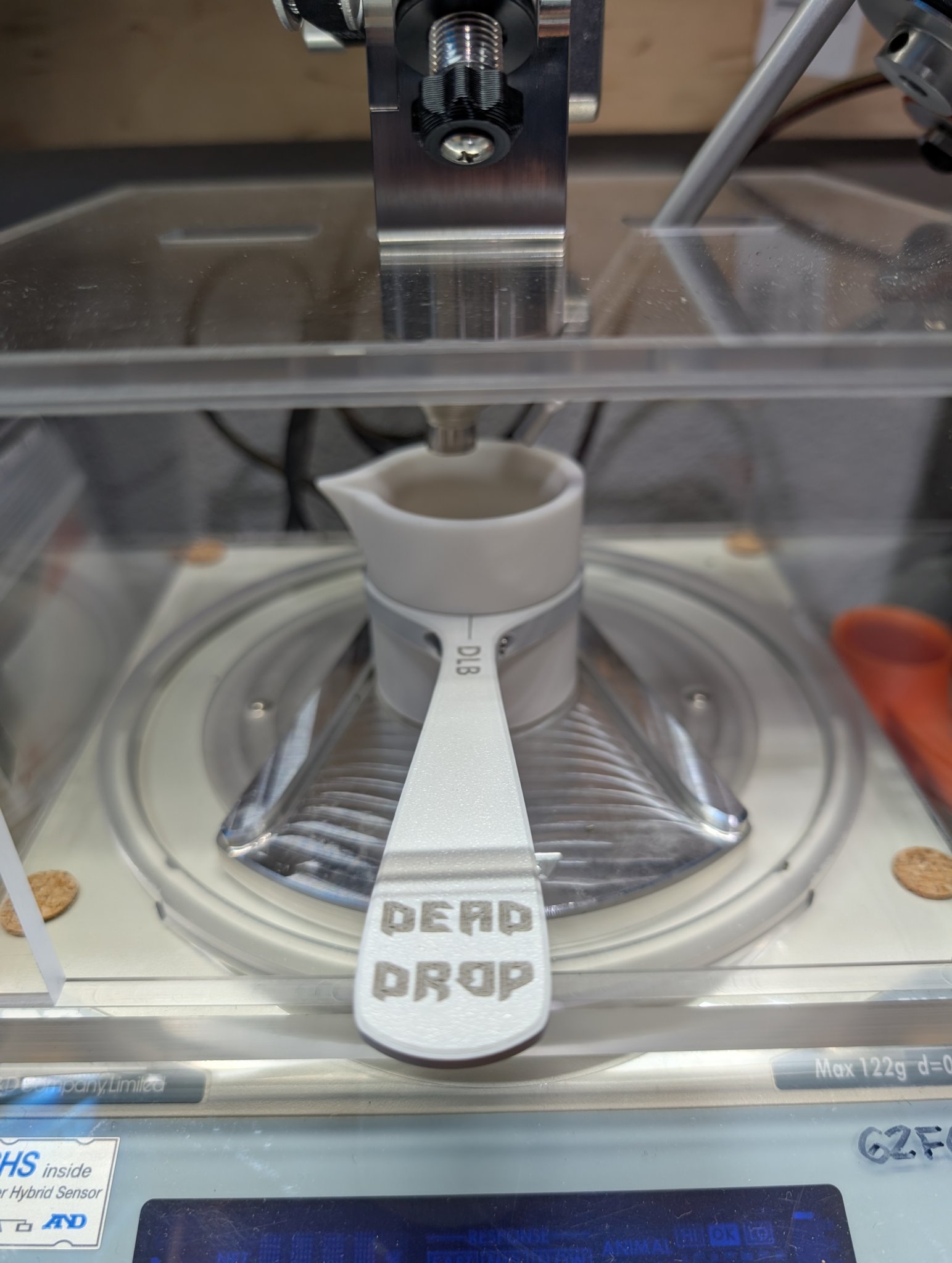

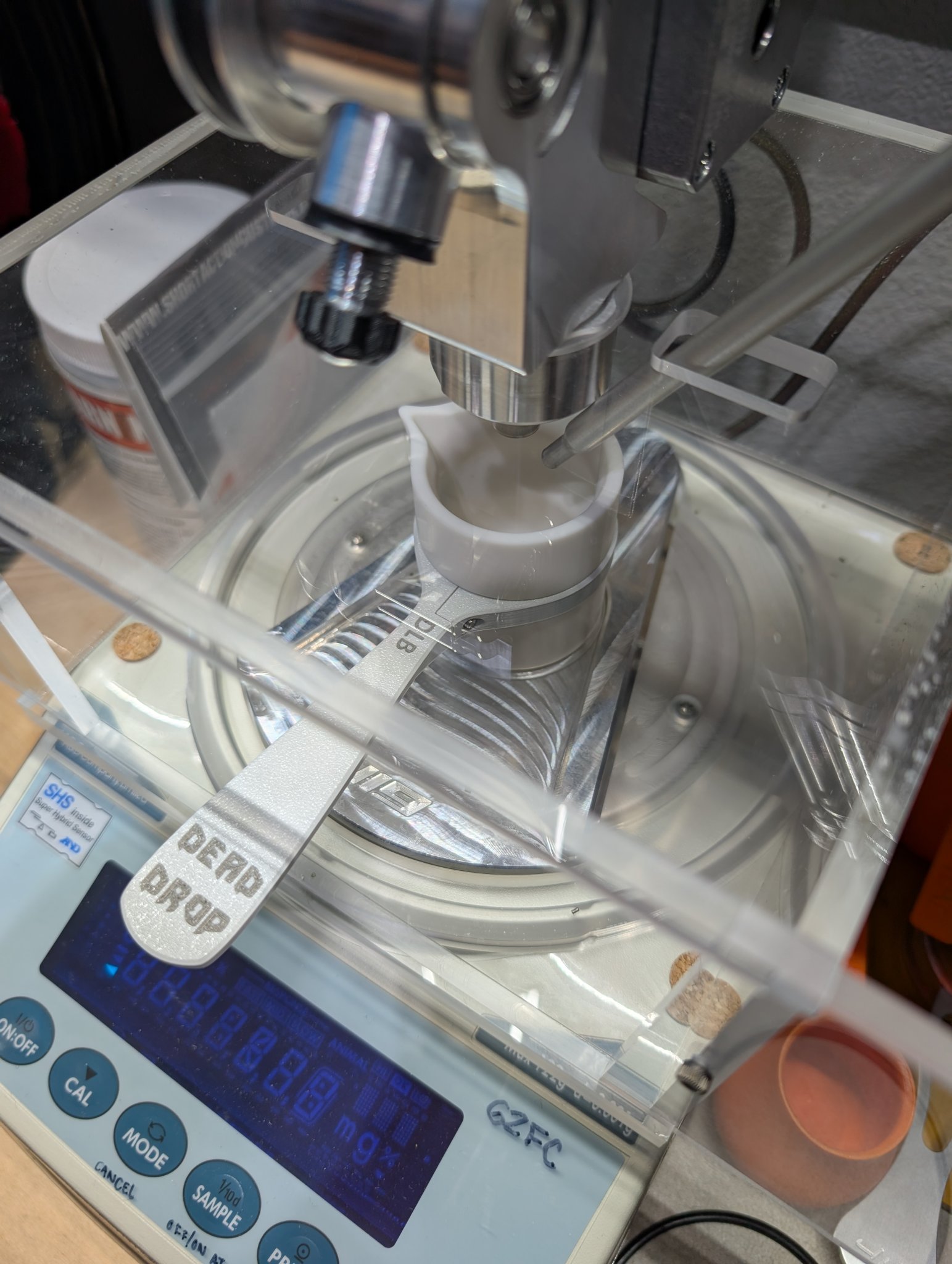

Not to derail the current conversation, but I picked up a powder cup and it came in today. So far it does a great job at keeping kernels inside the cup and the shape is pretty well designed.
EDIT: Coating the inside with graphite powder seems to have solved this issue.

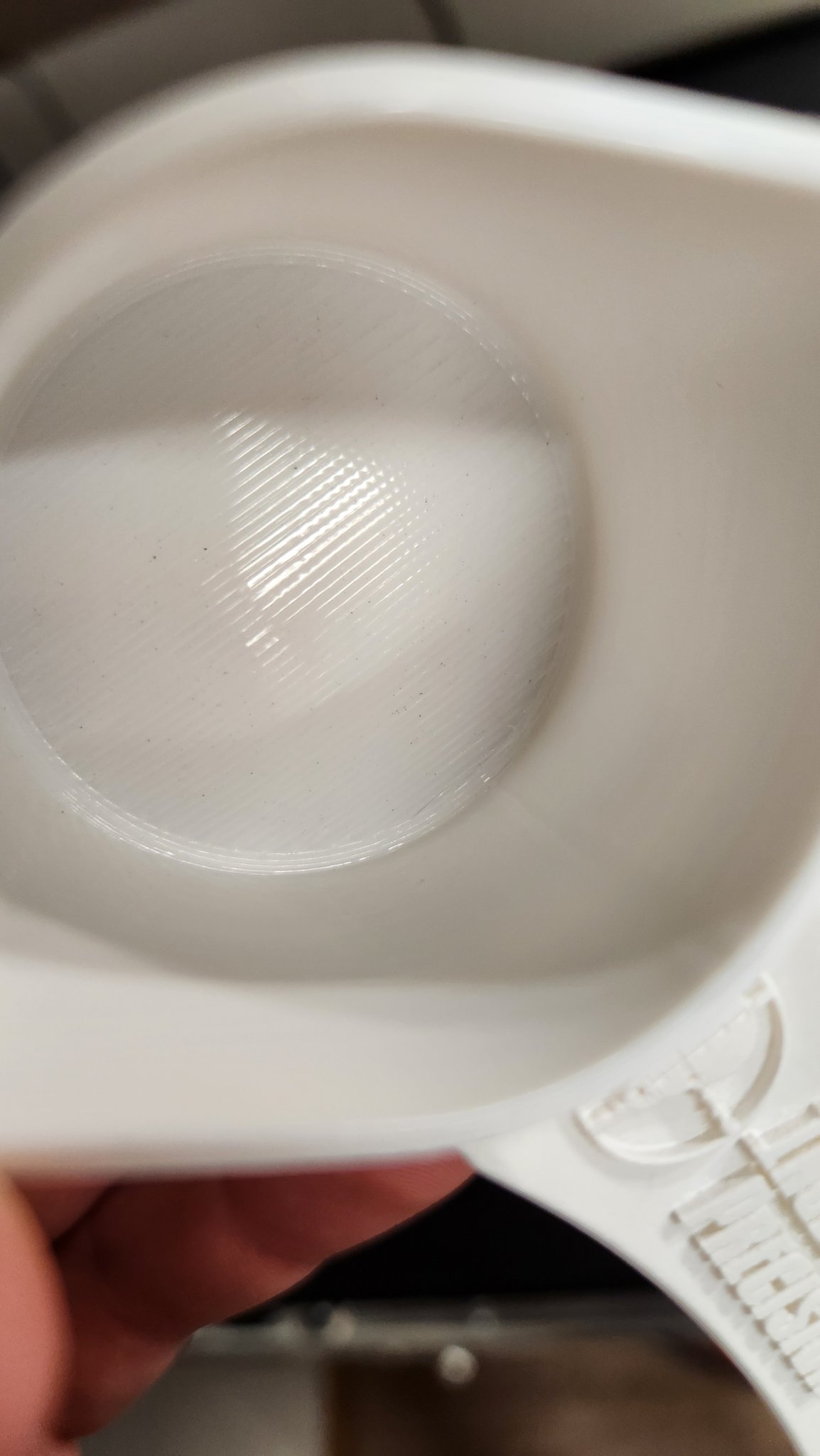

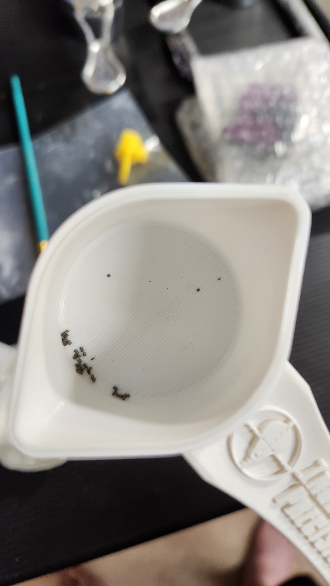

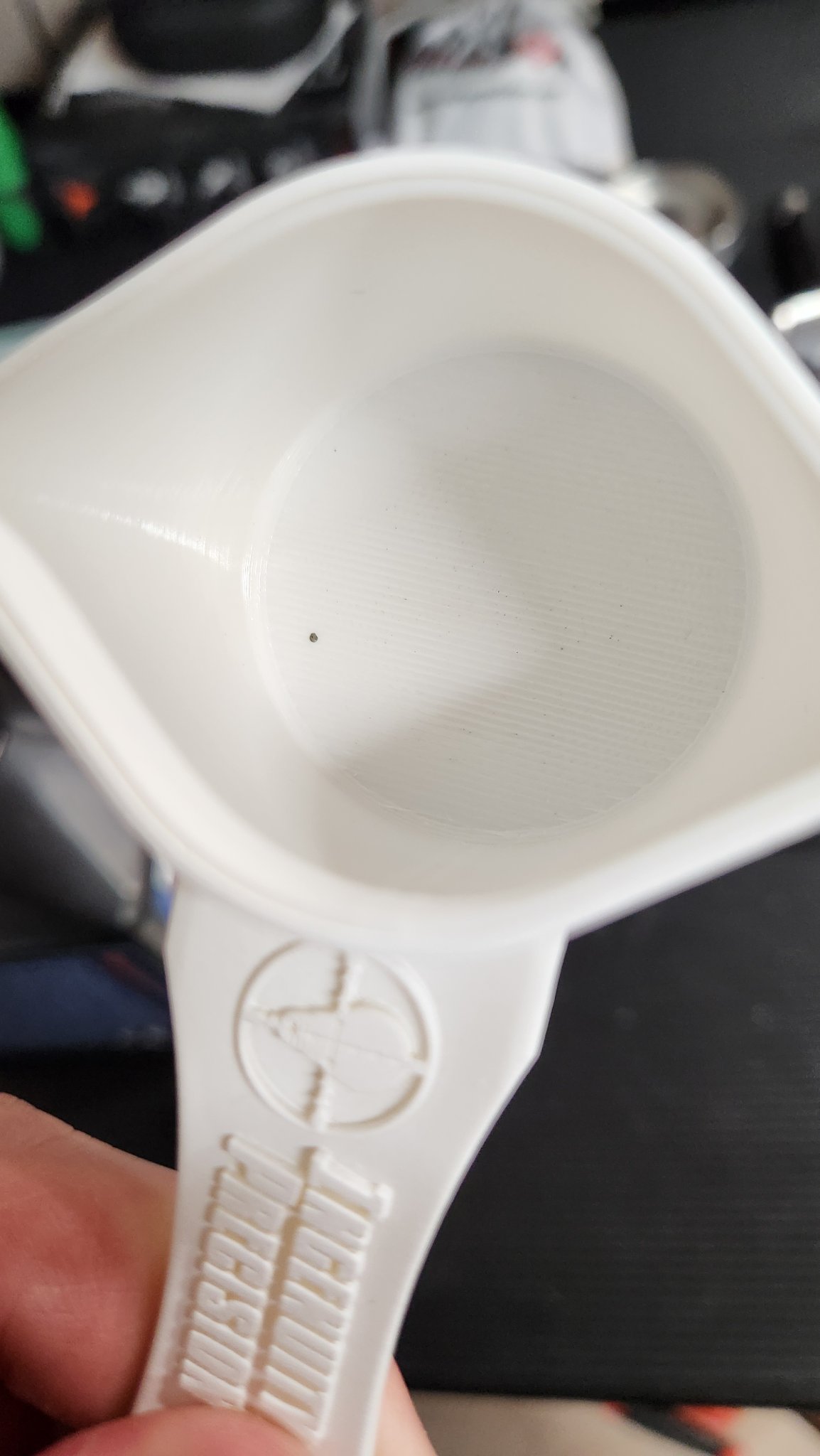

There's one crippling flaw in my opinion. The inside flexible material should not be 3d printed, or requires some chemical post processing. Printing leaves a rough texture that makes dumping powder out of the cup a royal pain.

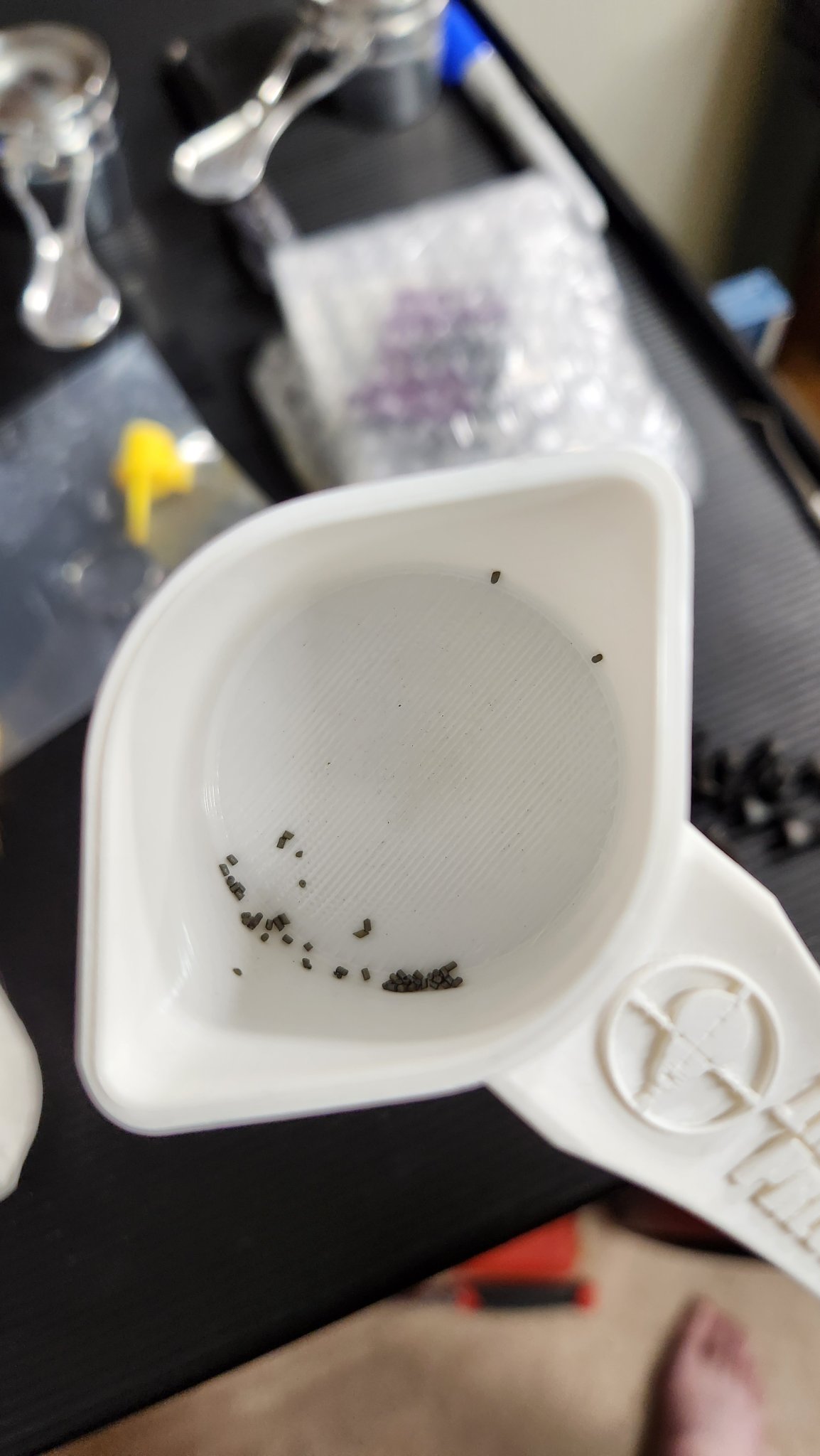

Here's what's typically left of N135 if I dump powder out like I would with a 419 or AT cup:
Here's what I typically get after spending ~3-5s tapping on my funnel
Here's why I think that's happening, notice the ridges
Might seem like a relatively small gripe but it opens up a lot of opportunity for me to spill measured powder, and adds a lot of time to the process. Basically leaves me with no spilled kernels, but adds a half hour or more to my overall powder drop time, and makes me less confident in what's in the case.
View attachment 8565169View attachment 8565170

Do you have any powdered graphite? If so, rub some all over the 3d printed plastic inside the cup. It will help the powder release better.

THIS is exactly what I feared would be the case when I saw the final design. Wiping the cup with a used dryer anti-static sheet may fix it, but you shouldn’t have to in the first place.
Reactions: LR1845
Tried that first and it wasn't enough. Graphite seems to be working tho.

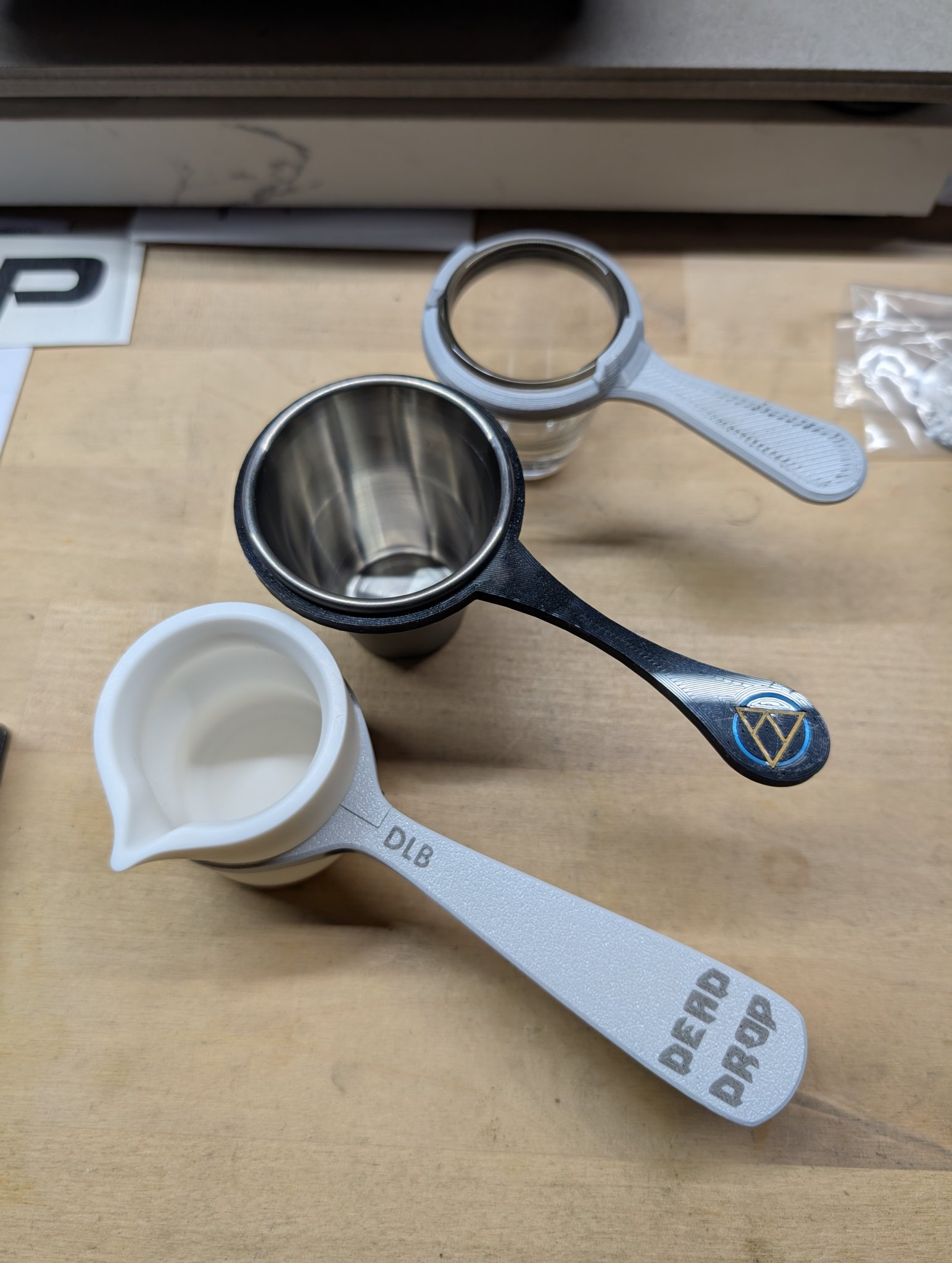

The best cups I have used with my existing ATV3+IP system are the bottom two. One is a stainless shot glass and the other is some hybrid 3D printed porcelain. Both are smooth AF. With zero kernel bounce.

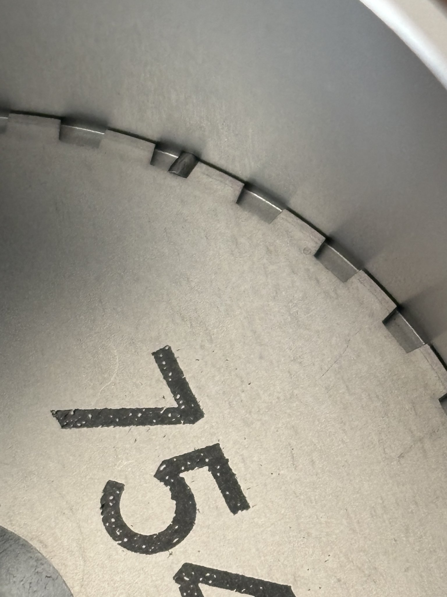

This is N150 stopping the trickler…it dumped 4.96g and bound up…after the powder settles in it get worse…I made a video but can’t post it from my phone.

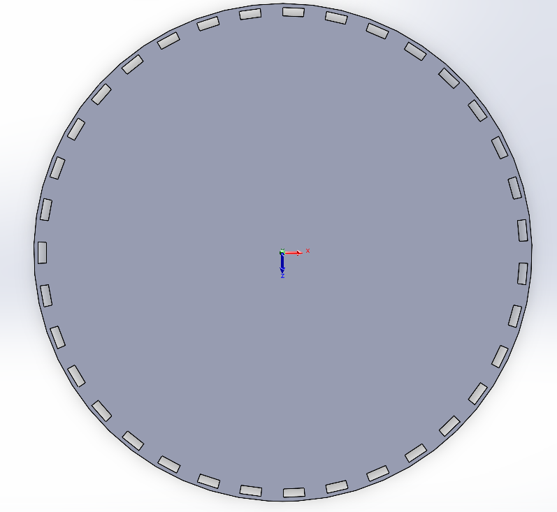

Odd sized kernels wedging between the base of the notch in the disc and the outside of the housing and binding/stopping the disc has been an issue since the IP trickler was first sold, I’ve been dealing with it from the beginning as my IP trickler came from the very first shipment.
Some powder and disc combos bind up worse than others. I always end up moving the pulley arm away and then rotating the disc by hand to free it up, then letting go of the lever so the trickler can finish on its own. I’ve also found that the binding seems to happen more often when you put too much powder in the trickler.
One solution I see would be to make all the discs like the 705 ball powder disc, except replace the holes in the 705 disc with appropriately sized rectangular cutouts for extruded powders—but like the 705 ball powder disc leave a full circumference of disc material around the edge of the disc. That way the kernels can never contact the side of the housing and wedge/stop the disc, they’re always fully contained in the rectangular cutout in the disc.
However, even with a really good laser cutter I would expect production/yield problems with manufacturing such a disc... I would expect possible yield issues from that thin remaining piece of material around the circumference of the disc likely doing weird things from the heat affected zone during cutting and causing flatness issues or even burn through. Might have to go to a 2-step process where the initial disc is oversized on the OD, then the rectangular cutouts are lasered so there is excess material beyond the heat affected zone, and then the OD can be final cut after the laser cutting process… and after that I’m sure it will still require a straightening operation.
Another possible issue is stick powders may not be “picked up” as easily from the pile of powder with small rectangular windows vs the current open ended notch design.
Just throwing ideas around, it would have to be fabricated and tested. Kernels wedging between the disc and the hopper and binding the disc are certainly a problem and have been since day 1.
Something like this might stop the binding, can't get kernels wedged between the notch and the inside of the hopper if the kernels can't touch the outside of the hopper.

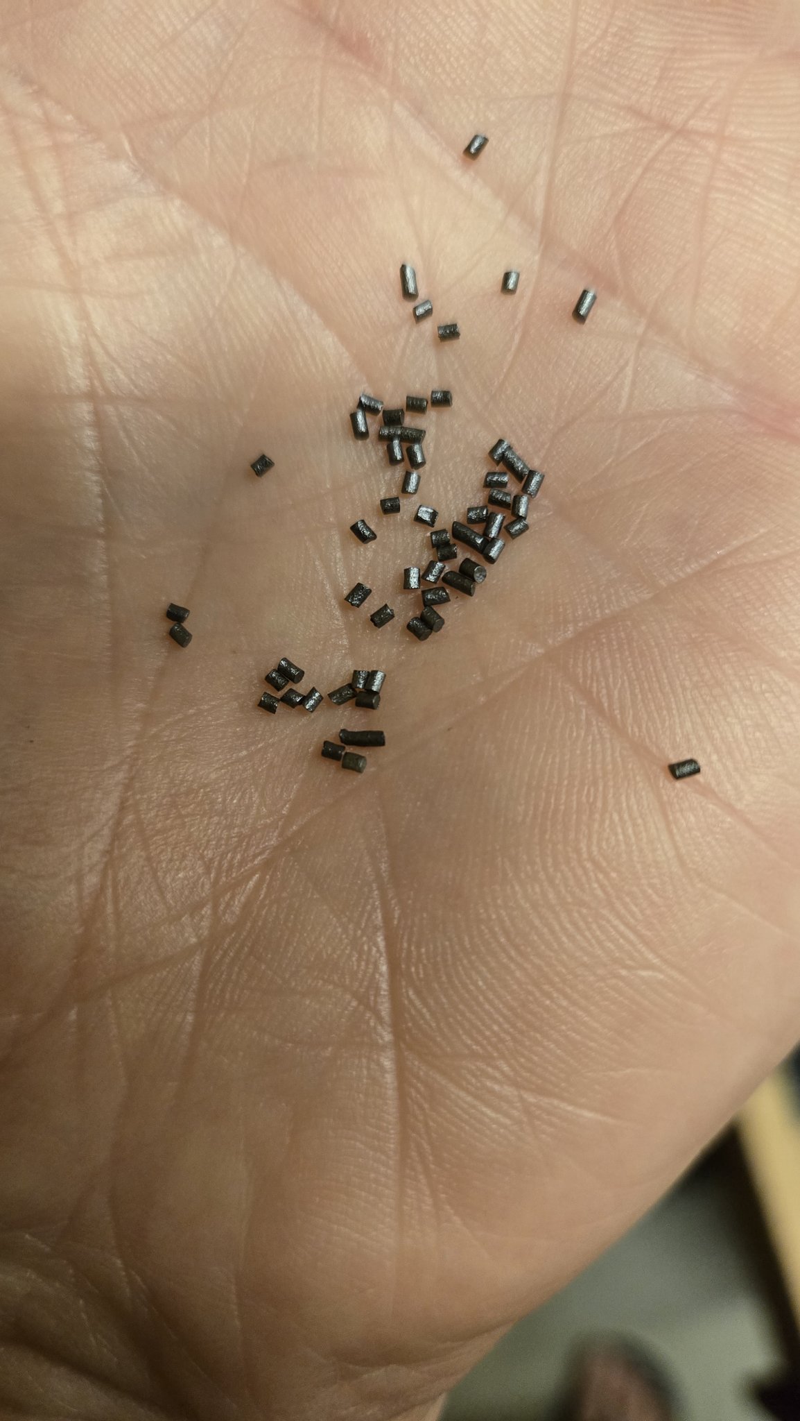

I'm using IP disk 7545. With all the powders I mentioned. I didn't even notice that Paul suggests a different disk for N150.
My N150 is dated 30.08.2023
Varget is dated June of 2021
Attached picture is N150
It looks like you had the 7545 disc in your pic. Have you tried the 567 Disc?
this, use the 567 disk and it gets a lot better
also replace the red O ring if you haven’t in a while
i’ve dispensed about 30lbs of N135, N150, and N160 with the 567 disk.
it still binds some times, but nothing crazy that can’t be cleared with a simple 1/4 twist by hand
And...or did I miss it....how does the N150 work with your 7545 plate?
