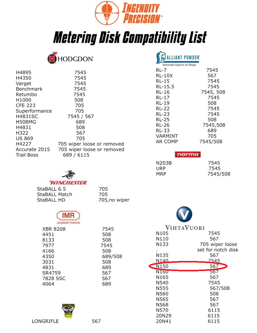

It looks like you had the 7545 disc in your pic. Have you tried the 567 Disc?
I loaded 32 rounds of N150 using the 567 disk per your recommendation(and per the instructions which I guess I should be reading)only 1 clicker and zero stoppages I was pretty happy to say the least because I found a great load for my GT with the 150 this morning.

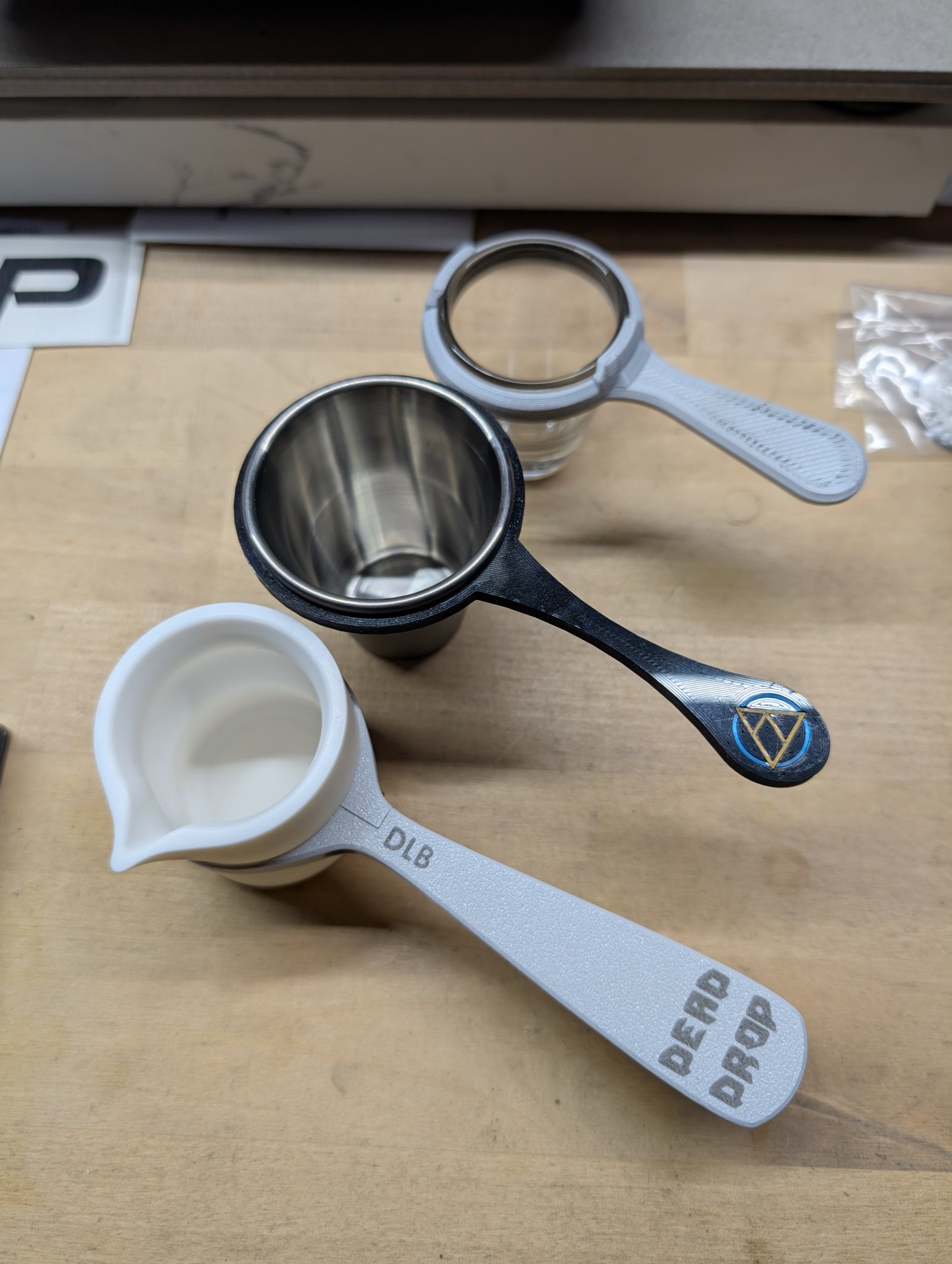

The best cups I have used with my existing ATV3+IP system are the bottom two. One is a stainless shot glass and the other is some hybrid 3D printed porcelain. Both are smooth AF. With zero kernel bounce.
Is the fancy dead drop any better than the Shot glass setup? I use a shot glass with mine and it works really well. Just trying to see if the $45 cup is worth it.

This is N150 stopping the trickler…it dumped 4.96g and bound up…after the powder settles in it get worse…I made a video but can’t post it from my phone.
Well, that's because you are running the wrong disk for N150. Do not say it doesn't work if you can't follow the instructions. You should be using 567 disk for N150. It's listed on the powder list.
Not to derail the current conversation, but I picked up a powder cup and it came in today. So far it does a great job at keeping kernels inside the cup and the shape is pretty well designed.
EDIT: Coating the inside with graphite powder seems to have solved this issue.

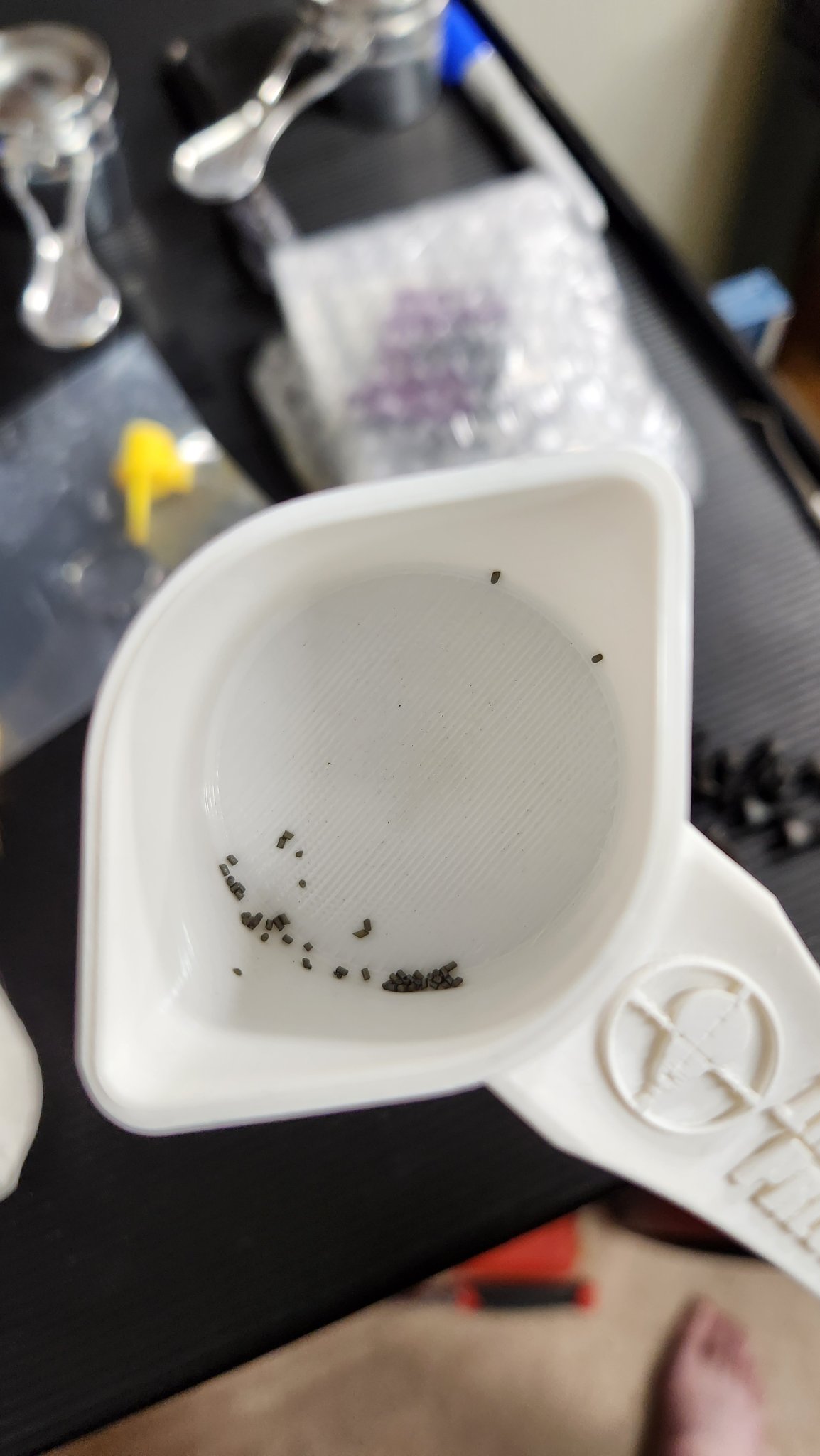

There's one crippling flaw in my opinion. The inside flexible material should not be 3d printed, or requires some chemical post processing. Printing leaves a rough texture that makes dumping powder out of the cup a royal pain.
Here's what's typically left of N135 if I dump powder out like I would with a 419 or AT cup:
View attachment 8565169View attachment 8565170
Here's what I typically get after spending ~3-5s tapping on my funnel
Here's why I think that's happening, notice the ridges
Might seem like a relatively small gripe but it opens up a lot of opportunity for me to spill measured powder, and adds a lot of time to the process. Basically leaves me with no spilled kernels, but adds a half hour or more to my overall powder drop time, and makes me less confident in what's in the case.
The printing is not the problem. When it is new it is a little sticky and we cure it by a light dusting of baby powder, or you can use graphite or other bullet lube powders if you wish. I have had very good success with all testing just starting with the powder and after loading a little while the gun powder will coat also. it is possible that one slipped out to you and didn't get dusted. My apologies.
Did you read my other post or just come in and start running your mouth? I posted that I did not read the powder/disk chart and also posted that when I used the proper disk(567)as someone suggested it ran flawlessly.
Yea, I didn't see the follow up post until after I replied. Glad it's working better for you. Send me an email if you have any other problems.

Sorry didn’t mean to be an asshole Paul, you and I spoke several times awhile back about some odd lots of powder I have/had.
I got that worked out and been running pretty much flawlessly until I got this N150 but with the 567 it’s been money…

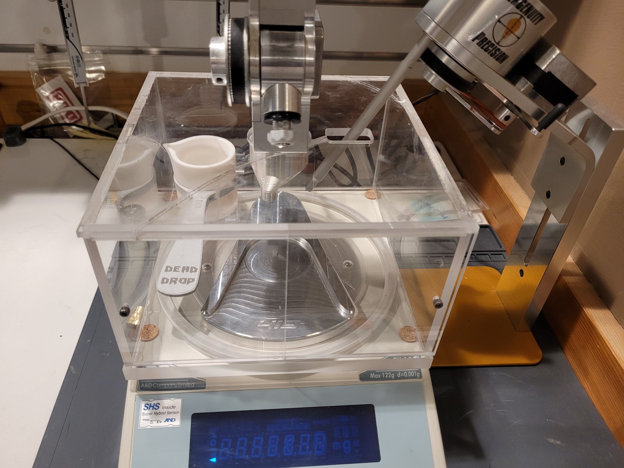

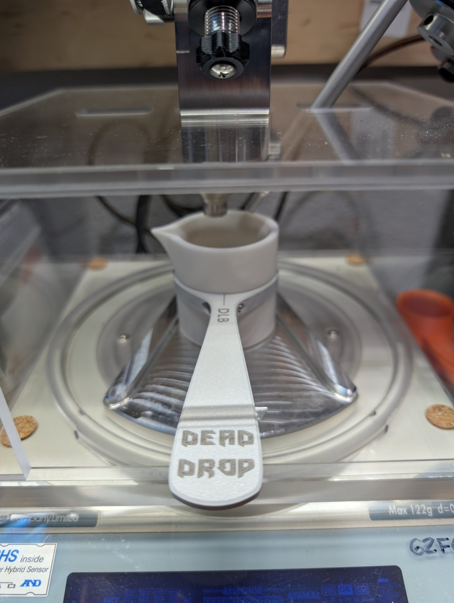

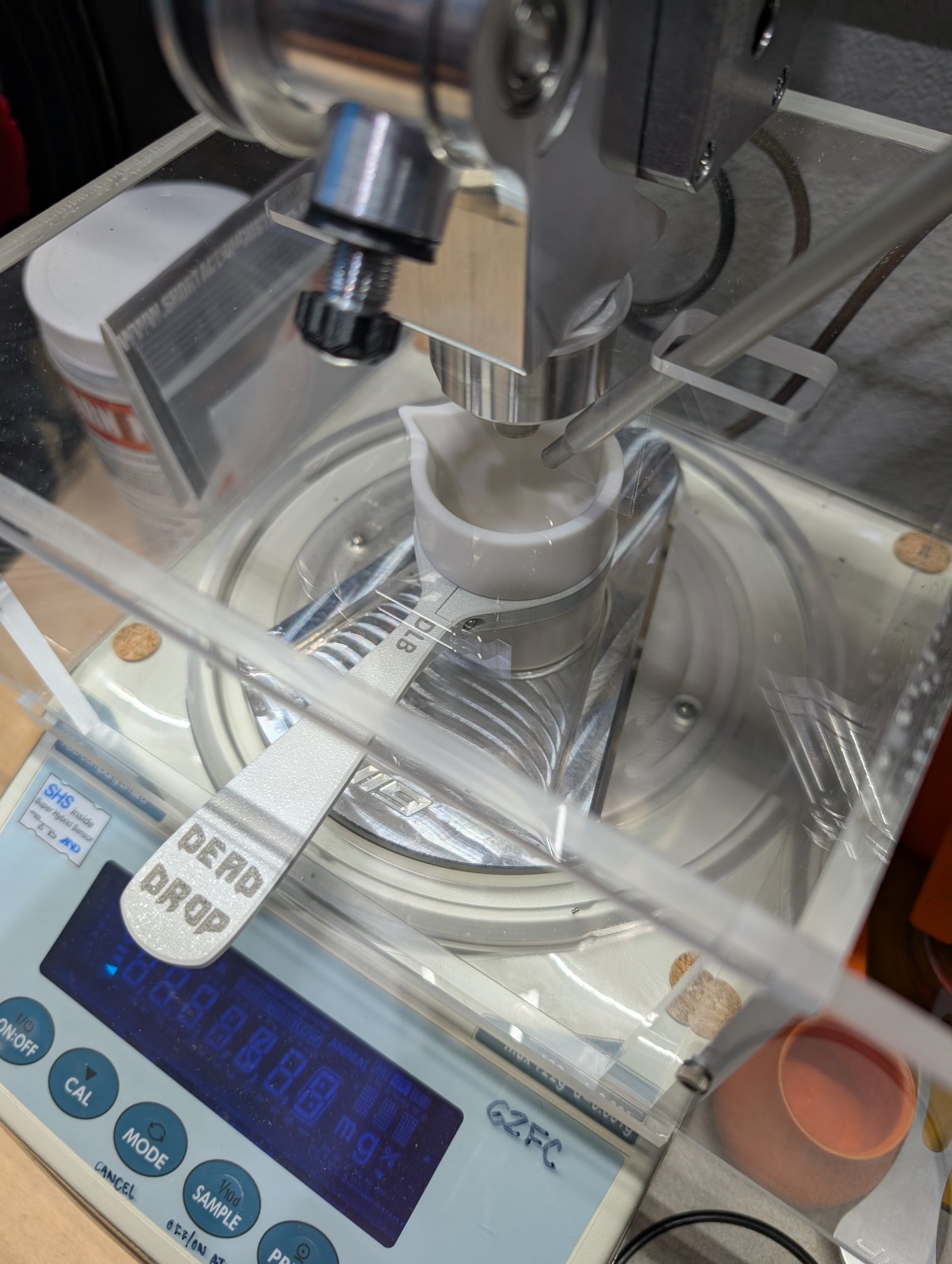

Just for people to reference, this is what it looks like with the area419 setup. Hope this helps!

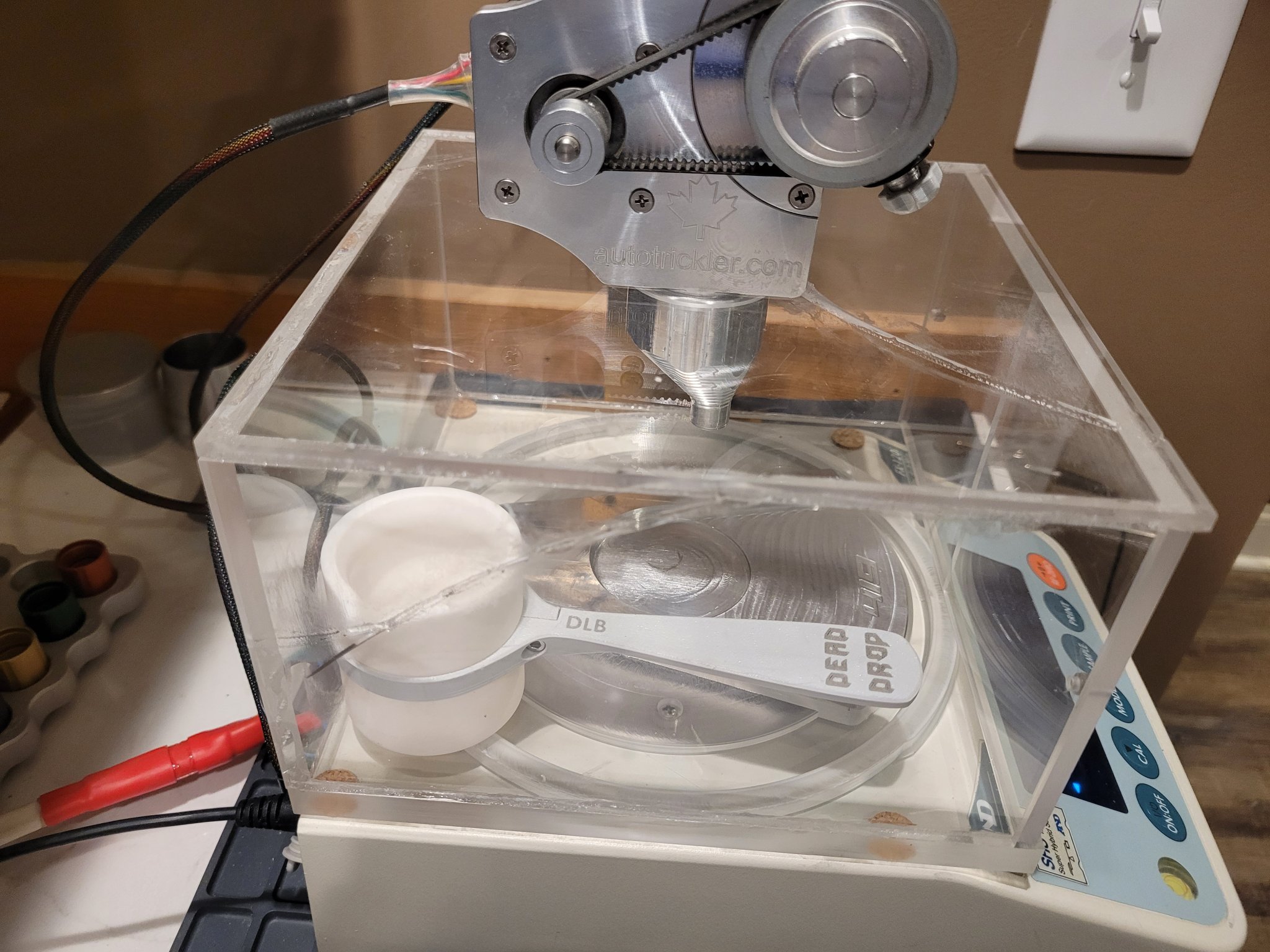

I used my dead drop cup yesterday for the first time. Loaded 90 cases with 60gn of N165, found 2 kernels on the platen after I was done. This is with the offset area 419 “straw” on the V3. Maybe it’s getting better using the original one?
With the area 419 cup it’s definitely more.
A question I’ve, I use the V3 with ingenuity trickler for quite some time now and don’t experience any issues.
How about the max 122 Gramm max on the FX 120i sticker? Never paid attention to it before. The area 419 platen and cup are almost 150g and with the dead drop cup slightly more.
Yep, they sure do advertise that 122 gm is max capacity for the 120i
I note that Paul is selling the 300i with is powder drop system (or at least will be when it ships) and the only diff supposedly is the max capacity with the 300i going to 320 gm...11.5 ounces.
