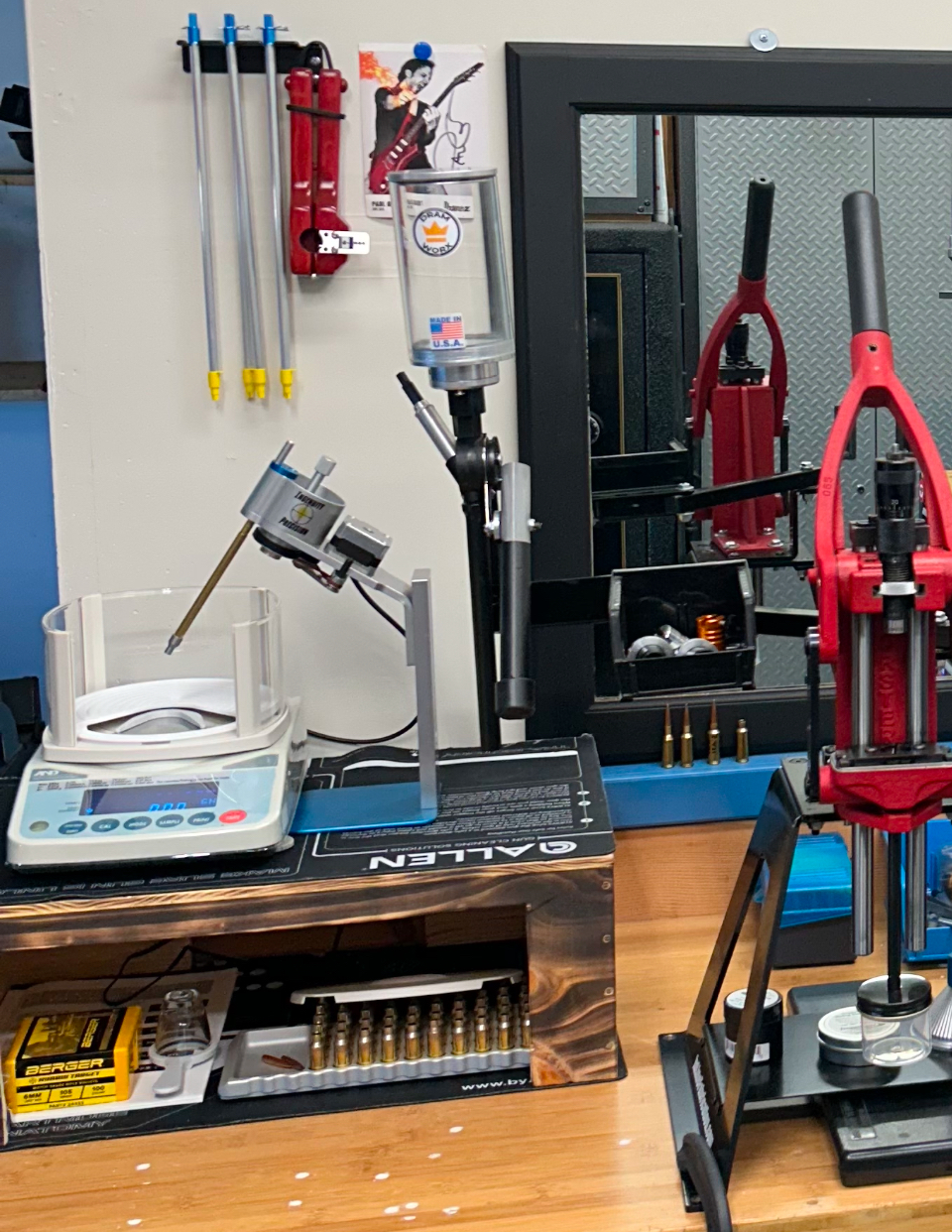

when you drop a bulk charge and the trickler finishes it off, doesn’t it have to go back to zero to start the process again? Or can you put a cup with weight/bulk charge and have it go from there?
The scale goes back to zero when you lift the filled cup off the scale… so if you were manually dropping bulk charges and wanted to go even faster, all you would need is 2 cups that weigh the same (and all that would take is some sanding with most cups).
The trickler does the hard part and does it fast, so the bulk drop almost doesn’t even matter and doesn’t even really need to be that consistent, the trickler will trickle up to the target weight regardless.

Yes, like CK said. The entire process goes like this:
After allowing the scale the specified warm-up time, place your cup on the scale and Zero it. When you take the cup off, it will read the weight of your cup as a negative number (-727.20gr for mine). I like to verify it returns exactly to Zero when I put it back on the scale, and back to the same negative number when I take it off.
Now you set your manual thrower to throw somewhere around 1.5gr under your target weight. If 80.0 is your target, somewhere between 78.0-79.0 works great. You have to do this before you engage the app to the trickler, or else it will try to trickle while you're trying to set your manual charge weight.
With the manual charge all set, and with the cup off the scale, you then connect the app on the phone via bluetooth and set the target weight.
Now manually throw the charge (78-79gr is what I set it for in this example) into the cup and put it on the scale. The Trickler will engage and finish the charge up to 80.0 and stop.
Pour the finished charge into the case. If you're going to seat the bullet next, DON'T set the cup back on the scale. Set it on the bench while you seat the bullet. If you put the cup back on the scale empty, it will go back to Zero and the trickler will engage and try to trickle out the entire 80gr up from Zero (you don't want that ;)). Since I'm using the AMP press on Autotrun (runs itself once you place the die on the sensor), while it's seating the bullet I pick the cup up off the bench and manually throw the next charge and put it on the scale. While the tricker is finishing that one, I pull the finished round out of the seating die and the whole process starts over.

Alright, I think i got it. If i manually throw 78g and put it on the scale, the scale doesn’t have to go to zero, so it will trickle until it hits 80g?
Reactions: secondofangle2
Correct. The scale is going to go below zero every time you remove the cup, and then back to 78-ish when you replace it with the manually thrown charge in it, at which point the trickler will engage and finish it to 80.0.

If you put your cup on the scale empty and zero it...then no, you take the cup off after that, dump your bulk charge and set back on sale and IP trickler instantly starts running and stops at your set charge weight... rinse and repeat
