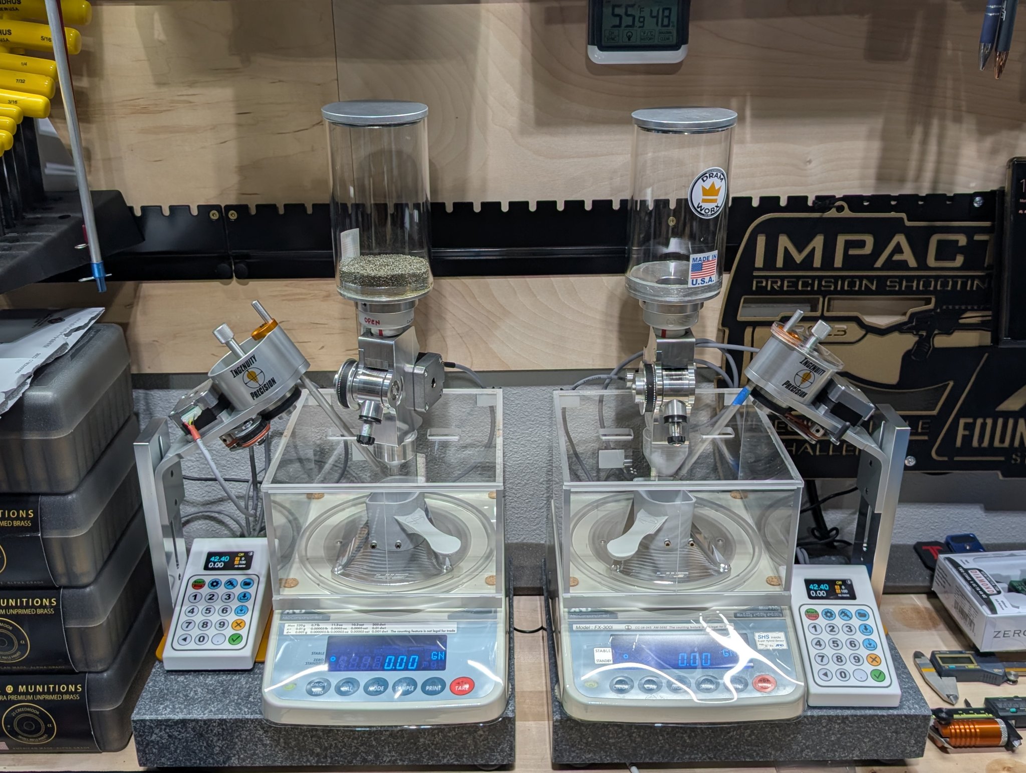

I ordered a scale, electronics and trickler. Had a receipt and shipping order in a few hours. I needed an upgraded system now so I opted to get everything currently available from IG and just use a cheap Lee powder measure to do dumps within a couple grains of final loads. Maybe I will get the rest when it comes available (who am I kidding I am sure i will).....it will definitely be a nicer package and a litle faster. I plan on running 2 same weight cups so my frankenstein set up will be much faster and more precise than the dual RCBS 1500's I use now.

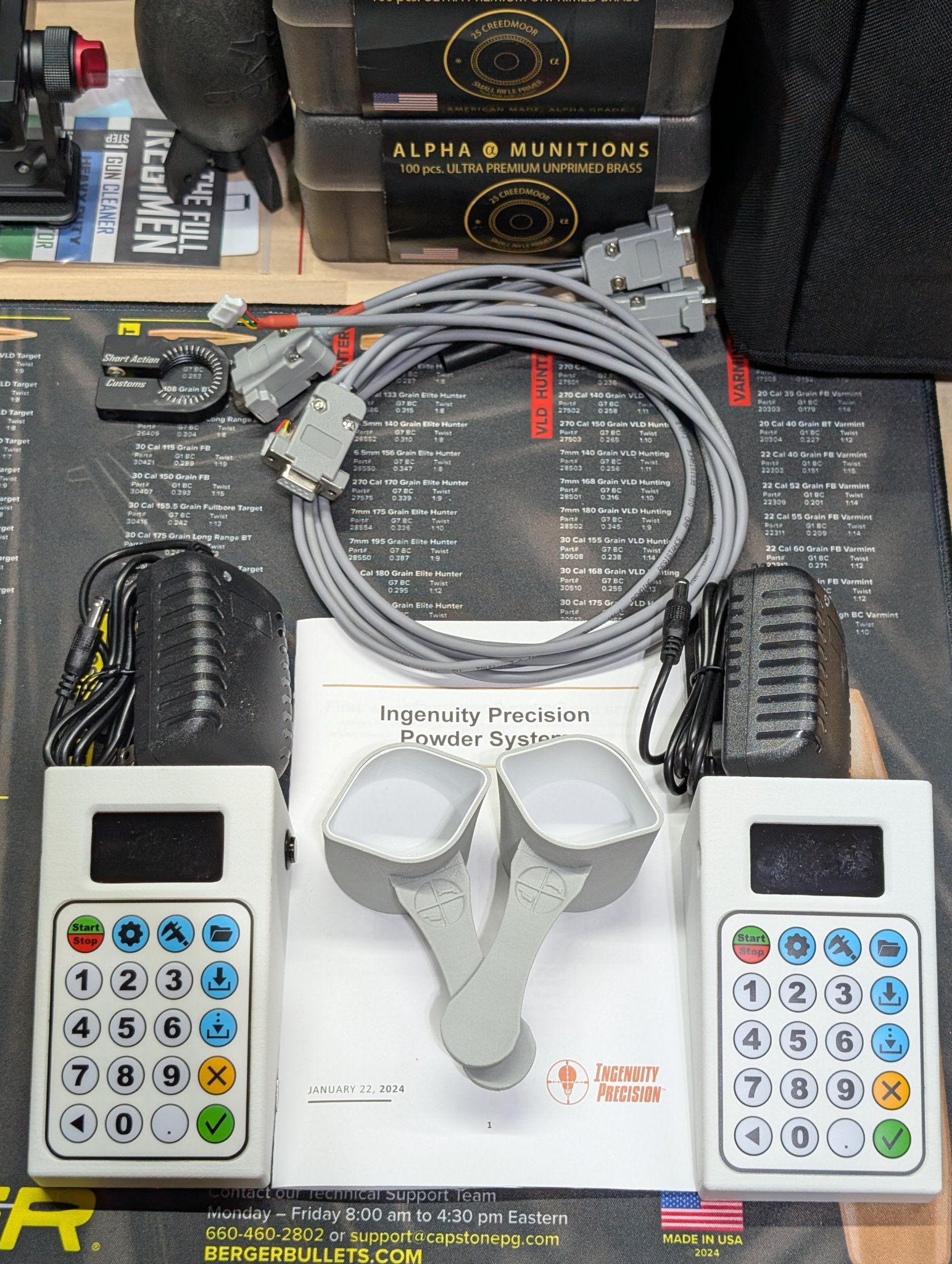

The "electronics only" version comes only with what is pictured below. Paul will send the "remaining" system with the price adjusted accordingly.

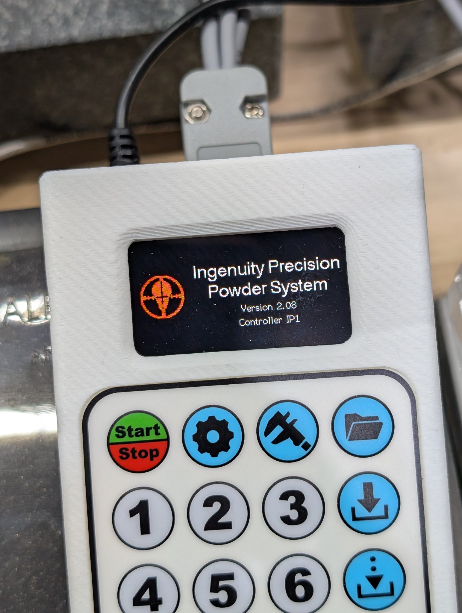

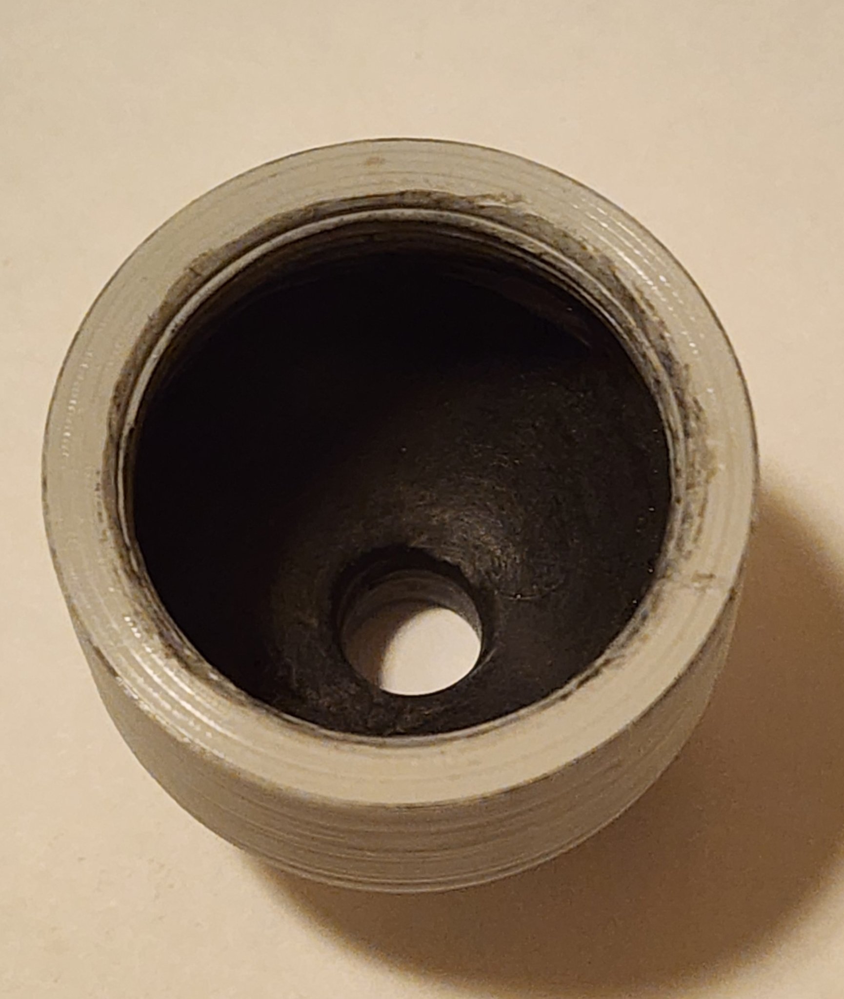

Loaded the firmware update to the controller but couldn't see a difference. Not saying it didn't help as I only loaded 25 round for the 300 PRC. I also took Paul's advice and removed the baffle from the V3 printed funnel. That made a huge difference! Will say there are voids in the funnel walls once the baffle is removed. I used JB putty to fill and make smooth. I'm very pleased with the V3 and controller setup. Can only imagine what the full IP setup will be like.

I just used my updated electronics and felt it made a real difference. I was getting some overthrows before but it seems to have completely stopped. But I really did not tweak my trickler settings before.

I really like it because I don’t need to have any device to hook it up to. But it also seems to make the trickler run way more efficient.

I picked up the ip electronics to run my v3 and ip trickler, as well as 2 powder cups. Loaded up 400 rounds this evening, and it was much faster and more consistent then the autotrickler electronics, i also really enjoy having the controller rather then needing to use the app. Much more intuitive to adjust setting as well. Really has me excited for the full system.
The powder cups were within .3 grains of one another, which made it very easy to adjust them to be identical weights. Over the 400 plus throws, i may have had 1 kernel bounce out which was very nice vs the cups i was using which i’d have to clean the scale off after every 100 rounds.
Overall i am very pleased with everything thus far. Also, Paul is awesome, i sent in the request, and received a phone call from him shortly after, and way beyond typical business hours.

I just got the IP Electronics for the V3 and it is pretty awesome so far. Having the controller is nice, I was surprised how quite the powder thrower motor is with the IP electronics/controller.

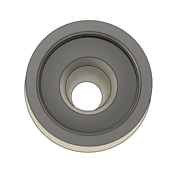

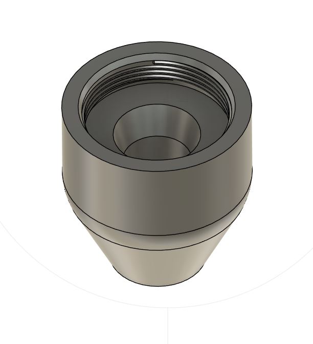

Based off of what Smokenaces posted about removing the baffle on the V3 funnel, I made and 3d printed a nozzle without the baffle. While I was testing the nozzle out, it seemed like the angle of the funnel can cause the occasional gun powder kernel to come out of the nozzle at an almost sideway trajectory and miss the powder cup.
I made another nozzle that is a very slight taper from bigger to smaller with the intent to make the gun powder drop straight down. I did around 100 throws last night with the IP Powder cup and the straight drop funnel and I didn't have a single kernel bounce out or not make it into the IP powder cup.
I definitely think a funnel with a straight drop workers better with the IP Powder Cup.
Here is what I made if anybody wants to replicate it or I could probably upload it so people with 3d printers can printer their own. I'm still new to CAD so I'm sure someone with more experience could make a better one than me.

I needed a new system now and didn't have the time to wait for my spot on the IP list and release of the full system. I have had very good results from the available new IP electronics/controller doing manual dumps with a cheap Lee powder throw and finishing with the IP trickler. It'll serve me fine until Paul's release of the parts to complete the system and it rolls around to my place on the list. Still faster and more accurate than the dual 1500s I have been using for a good while. The IP trickler just works.

I uploaded the files to Makerworld here is the link AT Straight Drop Funnel stl I made one for the V3 and the V4. There is a regular size and longer size. I like the longer version more since the Ingenuity Precision Powder Cup is shorter then the AutoTrickler Powder Cup. If you give them a try let me know what you think
