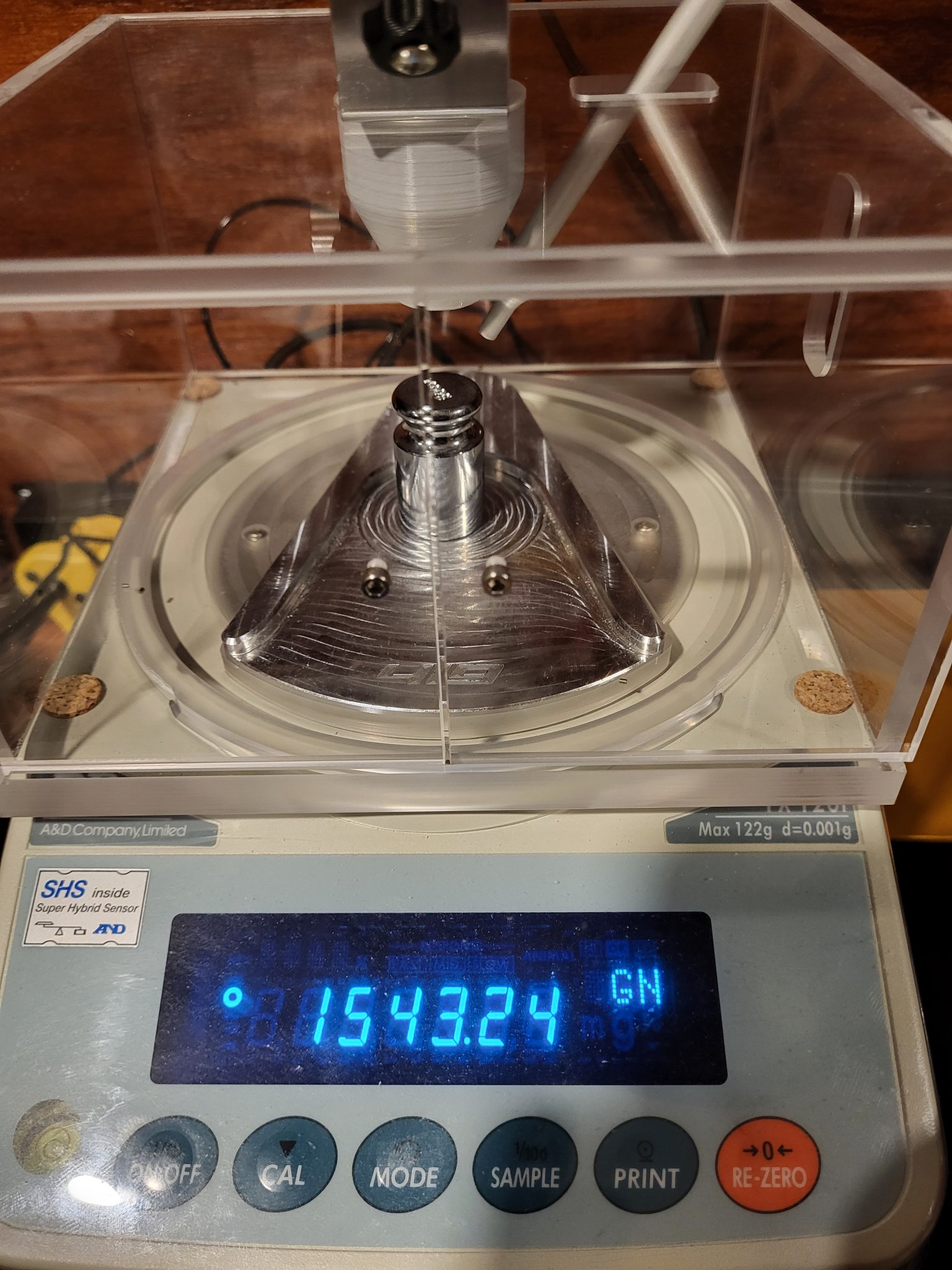

When it turns on it says fast on the display. I'm not sure what is causing it but I think it is Adam's board. I emptied out the hopper and trickler, and when I stroke the powder dropper or the trickler individually the scale drops down into the negative and then goes back up to around zero after I turn them back off so this leads me to believe it's something in the control module board interfering with the scale..

Did you try remove the AT electronics and see if the scale will function normally ? Put a know weight on the platen and see if it is stable

100 gram weight using no electronics, they are still hooked up and in place, but not in use.

1543.20 gn = 100 grams and its not drifting ? Your answer s there (cough cough AT electronics)
Yeah, im thinking it's the control board in the back of the scale, because I move either of the two motors independently and see a large negative shift in the scale readout with no powder being used. I still have a couple of other things I wanna try to rule out the cables and motors but I'm pretty sure I'm right in what I'm thinking.

I do, I replaced it to the trickler, no fix. The funny thing is, I can watch the scale and as soon as I connect with Bluetooth, I can see the scale flicker...

Thats got nothing to do with anything - you used the same trickler motor on the IP and the slider is meant to be adjusted , the issue happens even on the coarse drop ? unplug the IP side see if it happens ? maybe you can isolate the low voltage issue?
Just from activating the Bluetooth, and nothing else, the scale drops from 1543.20 - 1543.14 and stays there.. This is with both cables unplugged from the scale.
