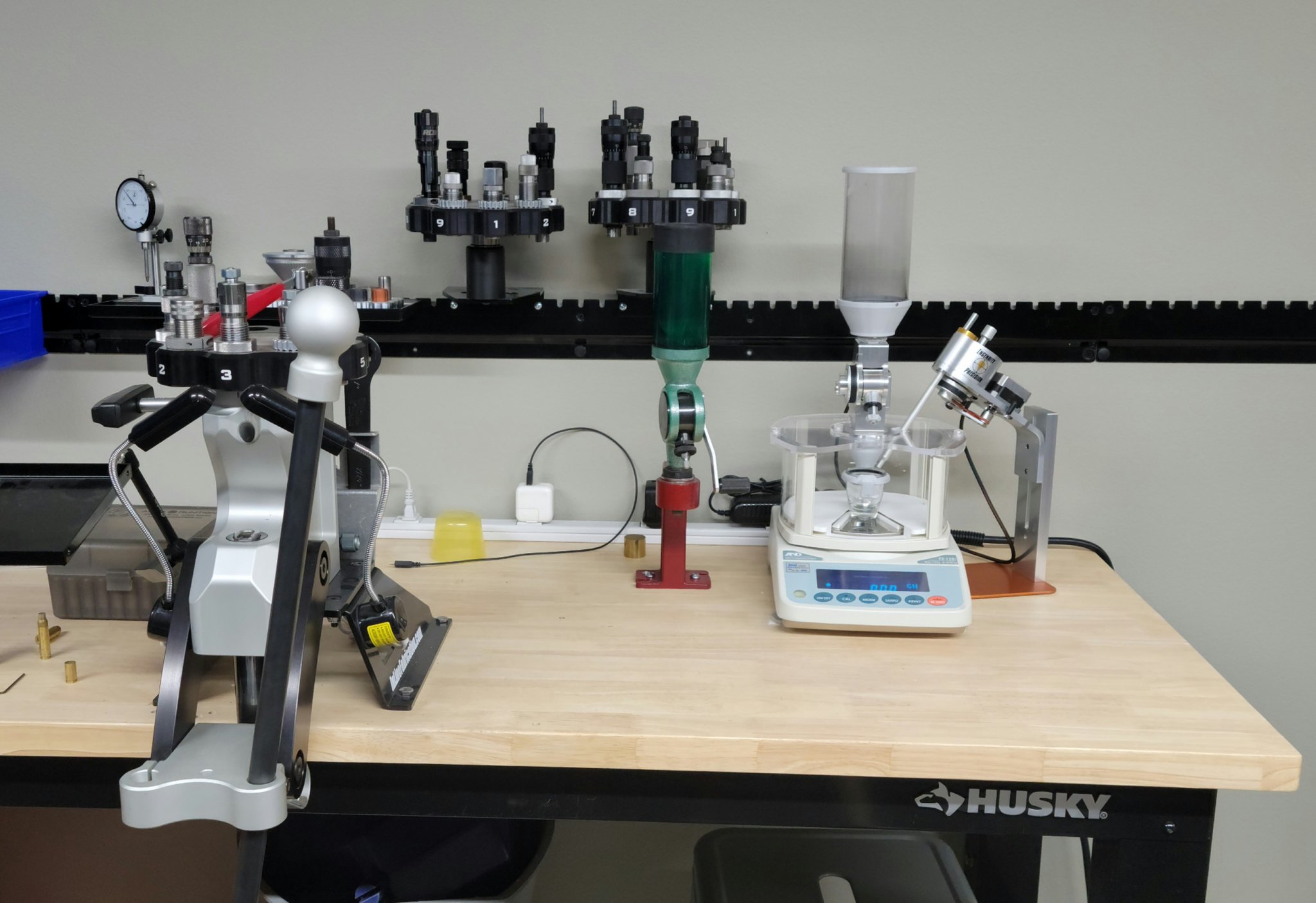

Ok, so, first, thanks for posting that video. This opened my eyes.
So I see the Ingenuity Precision trickler. I know what scale that is. What is that big yellow thing from which you are dropping powder before using the Ingenuity Precision trickler to get the final measure?
I am trying to see what it would cost to make that set up. Big yellow thing, cup, scale, trickler, and some funnels, oh, and trays, I guess that is it?
Reactions: CK1.0
the IP, and then ~$100 in parts:

Sorry, but one more question, so when you order the IP trickler, it does not come with the motor or cable or power adapter? That must come as a nasty surprise to at least some of the customers ordering it.
So thanks for correcting me, yes it’s @-Obsessed- … his panel set keeps the scale clean and makes it so it’s easy to put the cup in the same spot every time (plus it looks nice).
As far as IP not including the motor/cable/PSU… most of the guys buying an IP already have an AutoTrickler so they already have those parts on hand to reuse/repurpose. I’m one of the relatively few using the IP along with dropping the bulk charge manually, and to do it I had to grab those items “a la carte”.

Here a sneak peak of the all in one setup running..
I just talked to Paul. He said things are coming along nicely, just tweaking the electronics still.
He said he's still a little far out to being giving pricing out yet but hoping for early fall release..
Talk about a flex on the scale. 😆 That thing is even more expensive!
Almost sounds like a solenoid running a gate on the bulk drop and letting gravity do the work for the bulk charge...
I'm guessing he didn't show the back of the bulk dropper in this early video on purpose.
I like what I'm seeing though...
