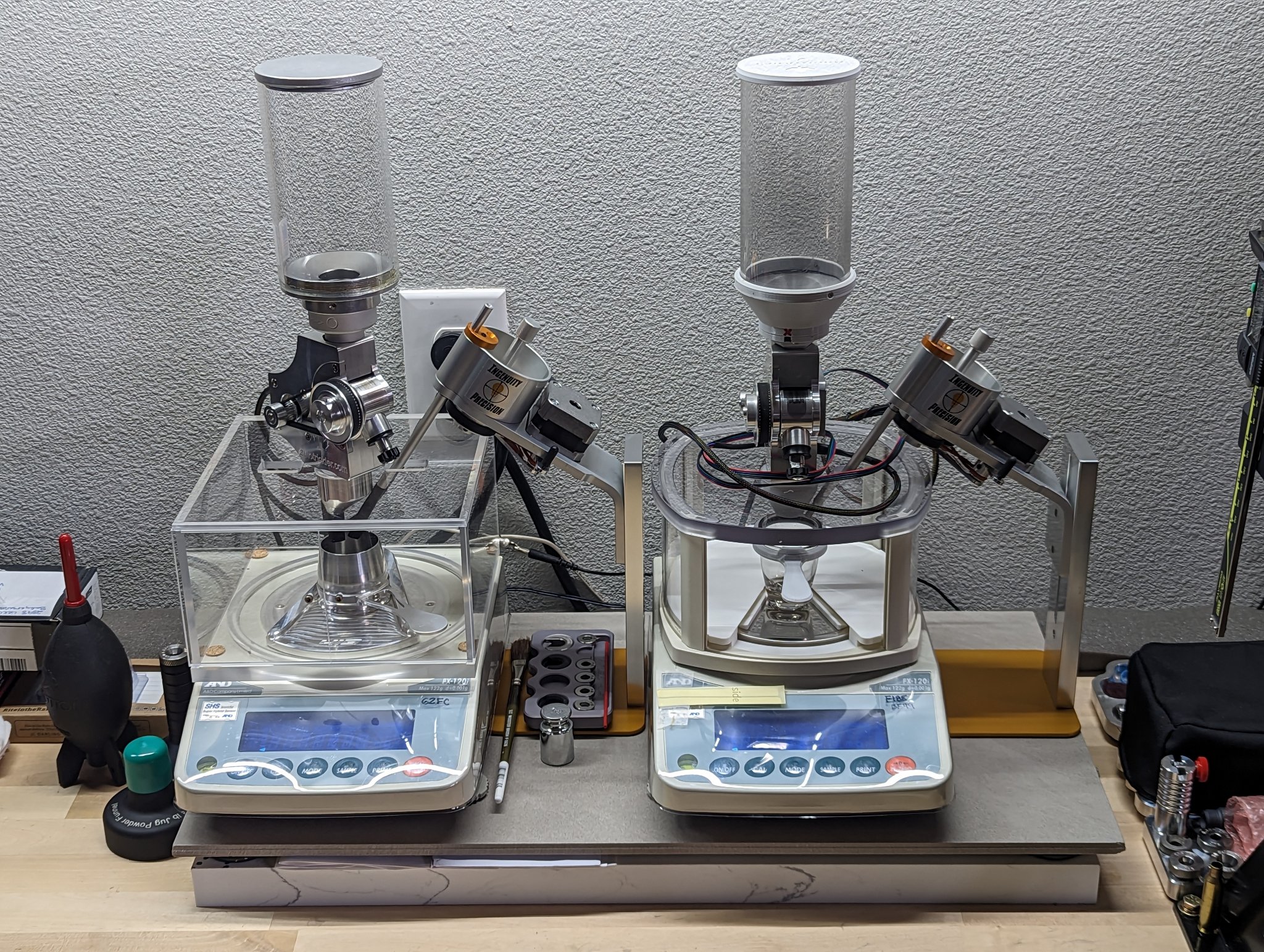

As is why its being made to work with several scales. You choose how fast you need it by which scale you buy. What's not to understand?
Paul is being extremely versatile by giving ALL reloaders options and compatibility with his products. Pretty awesome if you ask me. I'm sure that requires more programing and pivoting on his part, but in all honesty, there is probably a larger client base for a lower priced scale setup than A&D type owners....even if it is a little slower.... I know F Class John tested this Creedmoor Sports scale and had excellent things to say about it.

Here is a vid of the complete new system. I think we are ditching the keypad for a large touch screen to make things easier to access as we keep adding more options . What do you guys think?
All of it will be backward compatible with the powder meter. You can use your old side stand or like this. Trying to make it work with several different scales for different overall price points so the user can decide what fits their needs. Paul

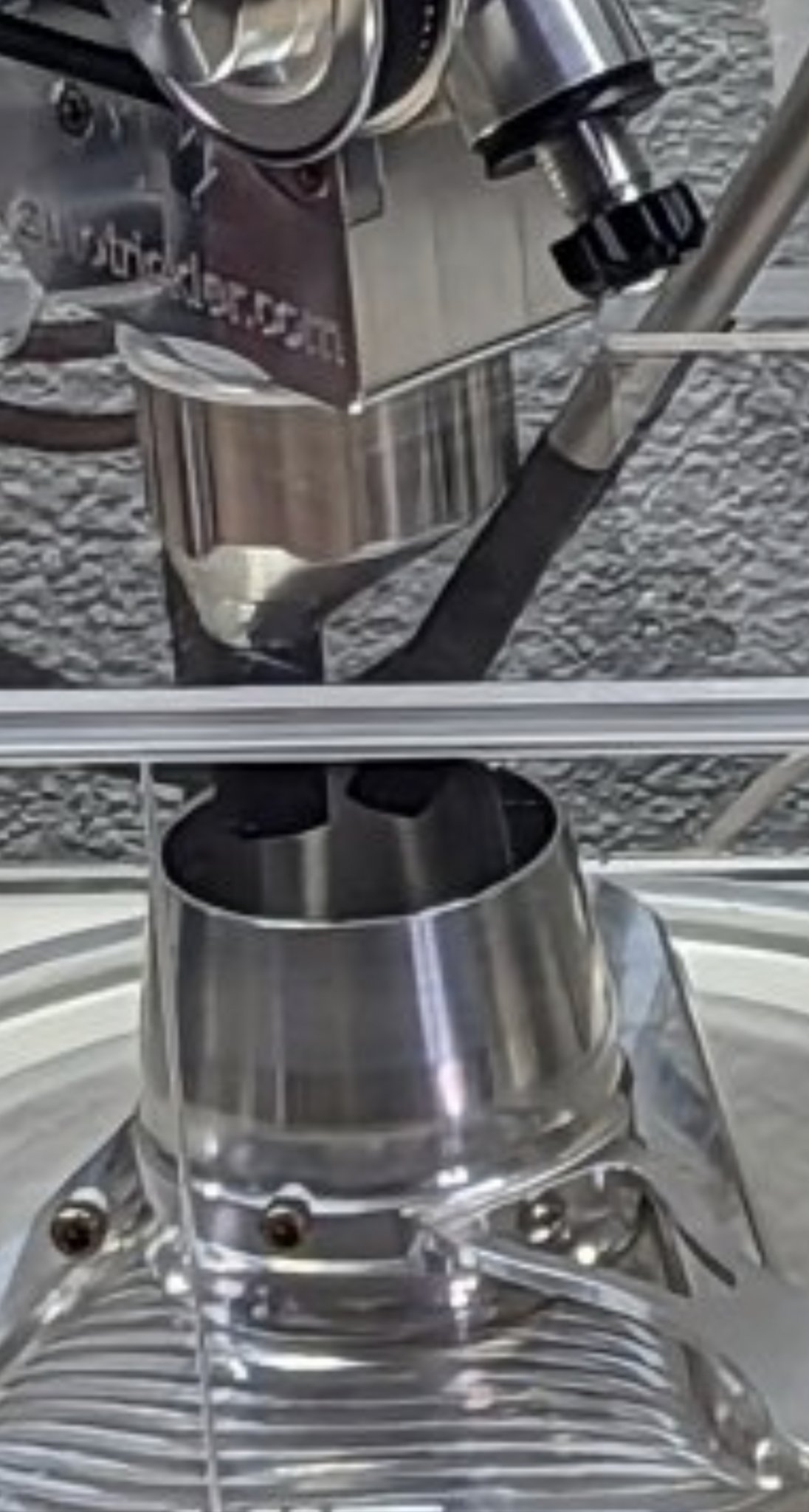

I place heat shrink tubing on my Autorickler (area419) powder dropper funnel and my IP tube straw.
Prevents all the kernels from jumping out
I get the IP straw but how so on the AT? I have a 308 shell I think it is, rhat I cut to fit on the bottom of my AT to get the bottom super close to the cup. Is that what you mean?
Reactions: NiteQwill
Now that's probably better than my set up then. I need to try that out. Mine works pretty well but there's still some splatter with ball powders
I bought the Amazon 100-piece, multiple size, heat shrink tubing set for a few bucks. That way you can experiment. Sorry I don't have a link but they're easy enough to find.
