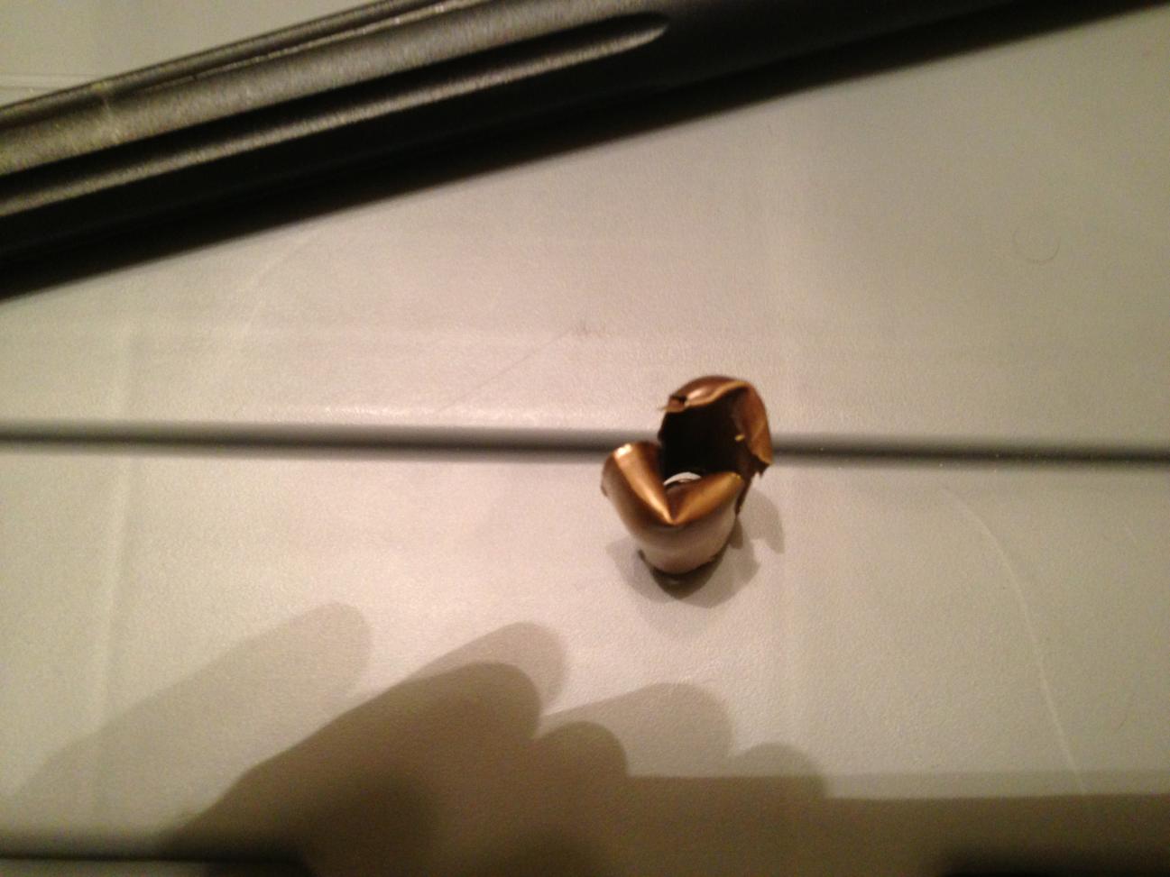

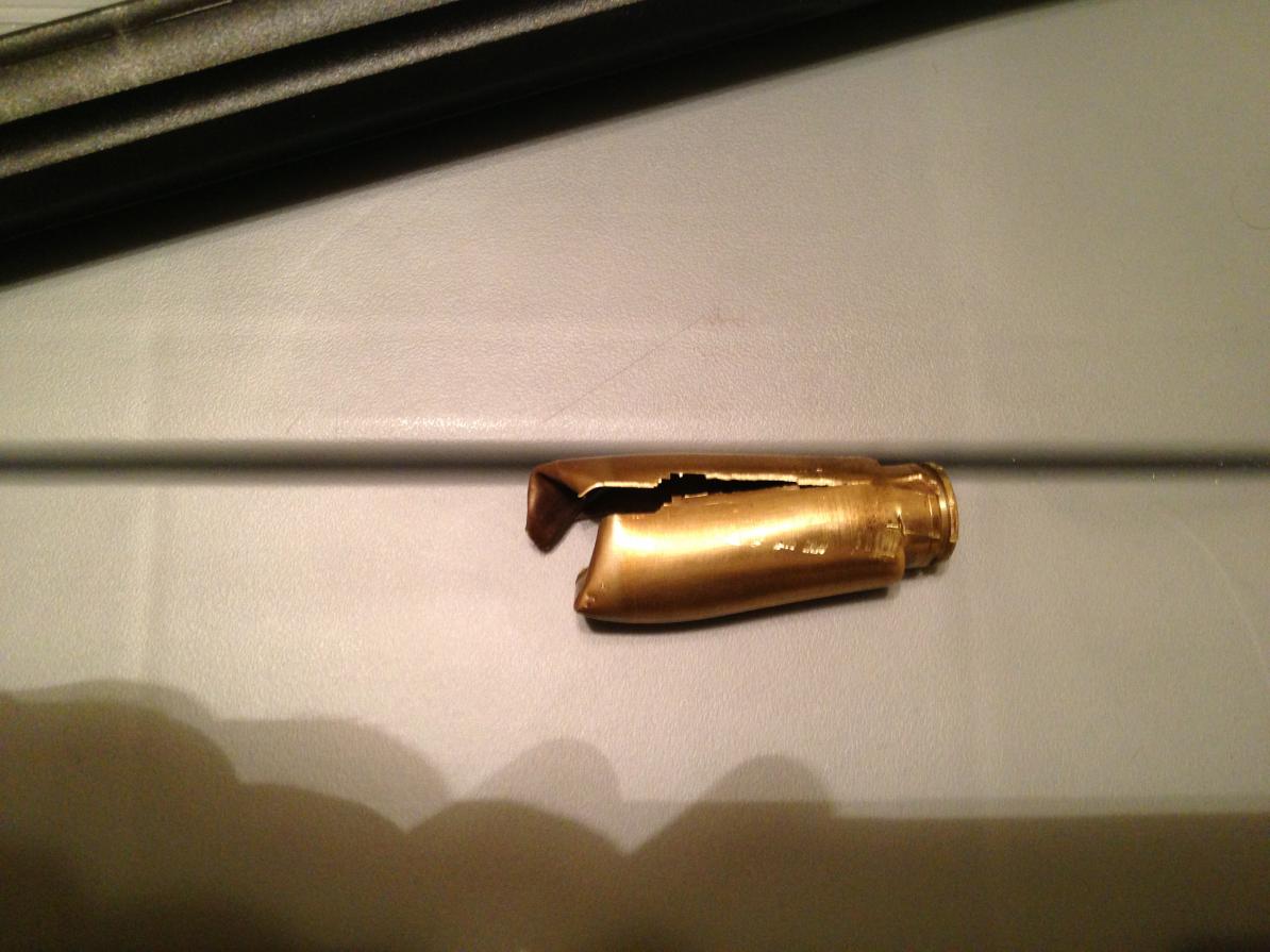

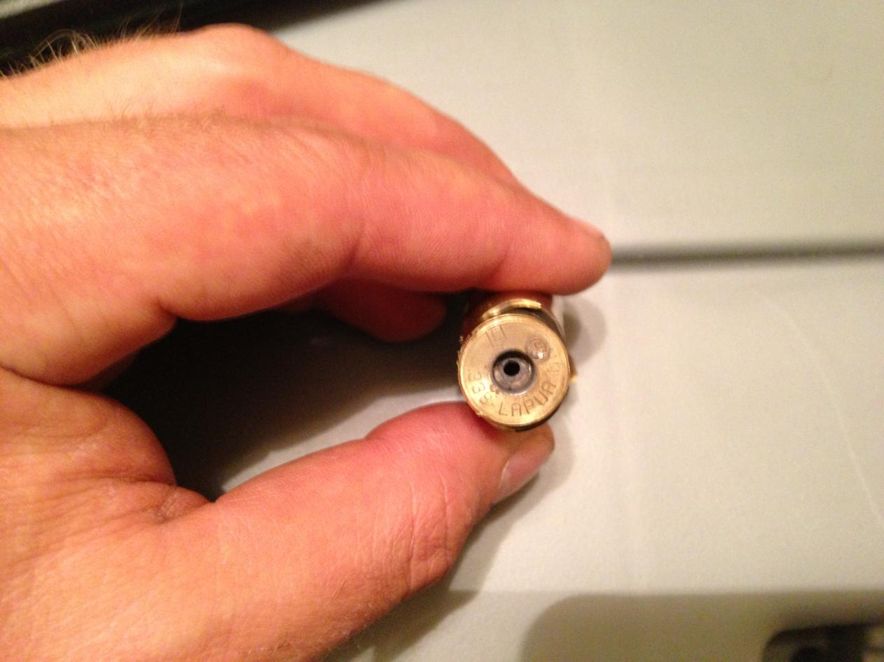

I know, im going to get flamed for this, but had a catastrophic failure and working with the gun company, but thought id get some input on the casing from the shot. Im probably going to send it to a professional along with whats left of the rifle since the company is giving me the run around, but this is the 20th round fired from the rifle on an otherwise new rifle. It was a hand load from a friend who was shooting them out of his remington 700p 338 just fine and apparently one found its way into my rifle and it didnt agree so well. According to him, the load was Lapua brass, 96 gr of H1000, HPBT 250 gr bullet.
Any help would be appreciated, especially if you have a shop that deals with bolt action rifles and might be able to do a full analysis of the rifle to determine the failure. So far it sucks that im out about $5500 between the rifle and optics, and only made it to the range once.
Ive had a couple local shops look at it already and the consensus was chamber failure, but the gun company insists it was the ammo and their rifle was fine.

Looks like some serious over pressure. I highly doubt the chamber failed, you are honestly going to be shit out of luck with the gun company because it was a reloaded round. I think you just learned a very very expensive lesson about shooting other peoples reloads. On the bright side at least you still have your hand and life.
just a guess...given the long throats of a 700, it's possible that when the bullet entered the lands there was enough of a delay to cause a pressure spike that could have worked it's way around the brass.
What gun did your buddy have?
The neck is probably folded back from the chamber blowout relieving pressure when the bullet was partway down the barrel, and the barrel pressure taking the path of least resistance, backwards. The last time I fired a friends reloads, it was some 357 mag cast bullet loads, and they leaded up the barrel after 4 shots-dumped the rest. I guess the receiver went south, too, if the chamber blew out. Bummer, bro.
there could be a flaw in the barrel material but it would take having a metallurgist section, polish and examine the grain structure to find out.
I'd say your choices are fairly limited in this case. Either eat it and call it a learning experience...I'd do this as a last choice, higher an attorney that has knowledge of the firearms industry to deal with Remington, find a metallurgist that can prove the barrel had a flaw or deal with Remington directly yourself and trust that they will help.
what caused it? Maybe the prior round didn't exit the barrel? Either a flaw in the material or a bad reload...doubt a chamber would cause that type of issue. If it was too tight the cartridge wouldn't chamber and unless the chamber was significantly oversized the brass would just flow to match the chamber, however this should be obvious. If you had cleaned the rifle just prior to shooting, maybe a cleaning patch was left in.
Do you have any of your once fired brass? If so, measure it at the mouth, shoulder, base and compare it to what the standard specs are.
Almost forgot about this...cleaning rod left in the barrel, it's happened a number of times.

Looks like massive over pressure. The brass flowed into the ejector hole before the chamber gave way. Glad you’re OK. You know us voyeurs world like to see a picture of the rifle.
Edit:
Over pressure, but as others stated, that could also be caused by barrel obstruction. Cleaning between shots to brake it in? Otherwise, I’d be talking to my buddy about his handloads.

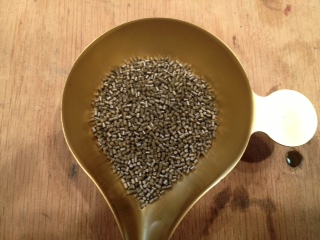

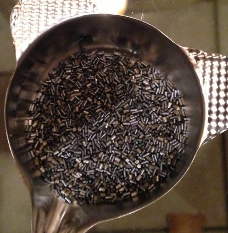

You sure it was 96gr of H1000 and not 96gr of some pistol powder?
I have a few more rounds from him that he left in my bag, I may go down to dillon this weekend and pull a few apart. I sold all my reloading stuff last year and never did anything larger than 308, so my experience is limited in this round. He swears up and down these are the same rounds that went through his rifle so im going to double check to make sure.

seanh started to touch on this, but do you have any pictures of any of the other once fired brass out of the rifle? You might do some investigation on those and see if you notice anything odd about it. Might give some clues about the condition of the chamber before the failure...
I will snap some pics tonight, I only have 10 pieces of the PPU brass as the rest went to them.
Did you check out the details on that load????? QuickLoad says that 96gr H1000 behind a 250gr Hornady BTHP will yield 68,632psi, nearly 13% above max rated pressure. Did you only fire one of them? If you fired more than one, perhaps you had cumulative damage due to over-pressure.
Hodgdons website says 98 gr is max load for that round with a BTHP 250 gr. I am positive only one was fired, and that was the one that did the damage.
Okay, I looked that up too, and Hodgdon does list 98.0C, for a 250SP (not HPBT)---not sure that makes a difference, don't think it does.
Hornady's book lists 92.6gr as MAX for the 250HPBT, QuickLoad is listing 93.0gr for same, and Sierra is showing up to 100.1gr for their 250HPBT. Quite a lot of discrepency here. Unfortunately you were not able to do a ladder test to find the max load for your particular rifle.

Here is the powder that came out of the other rounds
Do you have any H1000 powder from a can yourself? I just got mine out, and your pic looks awful much like a mixture of two powders. If you don't have any, I suggest you get some or find someone you trust who has some, and check it out. I see two different grain diameters and colors in your pic, and my H1000 is only greenish and fairly large diameter, no silverish and smaller diameter.
If this is indeed a mix, that could be your problem.
Here is the pic of mine...
