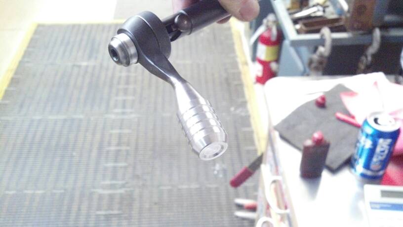

To me, it looks like there is a bit of ejector mark. I'd expect if there were enough pressure to frag the rifle, there'd be enough pressure to really extrude the casehead into the ejector hole...

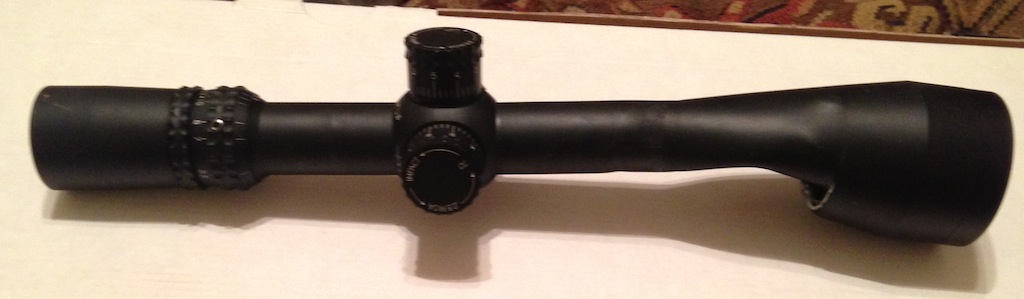

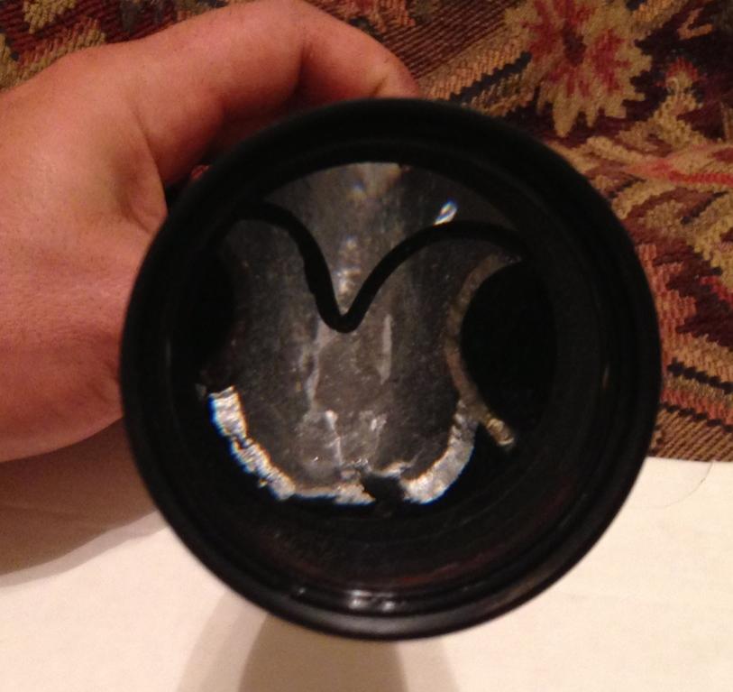

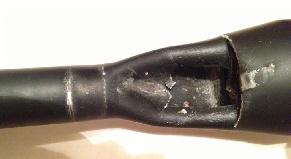

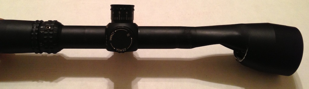

I will take some of the scope, I have already talked to Nightforce and sounds like they are all in for showing pics of a scope that could be the only thing that saved my life.

Here is whats left of the Nightforce NXS 5.5-22x56. It was mounted down with the Nightforce ultra lite titanium rings, and the force from the rifle blew the scope literally 40 yards away, still with the base attached to it. Its a true testament to the strength not only of their scopes, but also the rings which were still firmly held to the rail and the scope. of the 3 people that inspected this rifle, all 3 agreed the only reason im alive or at least not disfigured is because the scope caught all of the blast and held everything that came out of that chamber instead of distributing it into my face. I ended up with a few scratches and had to check my shorts, but it could have been a lot worse, and thankfully I had on eye protection and inner and outer ears. Ive since bought a couple other NF scopes and will stay true to their stuff on all of my rifles

I have the savage fcp HS also, but it's being reborn, so to speak. I have a spare action that i sent to Phoenix custom rifles (up your way)along with a Krieger barrel. By the time it's done it'll hardly look like a savage. No more barrel nut, and i made my own bolt and swept it back a bit, more like a Remmy. The stock is already quite a bit modified and painted:

Looking at the pics of the scope, it looks like whatever happened took place pretty far forward in the chamber, as the damage is way up on the scope. I know there has been some speculation about the powder, and I agree the pics of the powder look suspect. I am guessing that there was a huge pressure spike right at the lands.
Wow! That's killer...
More evidence that the base screws/threads are the weak point of most scope mounting systems.
