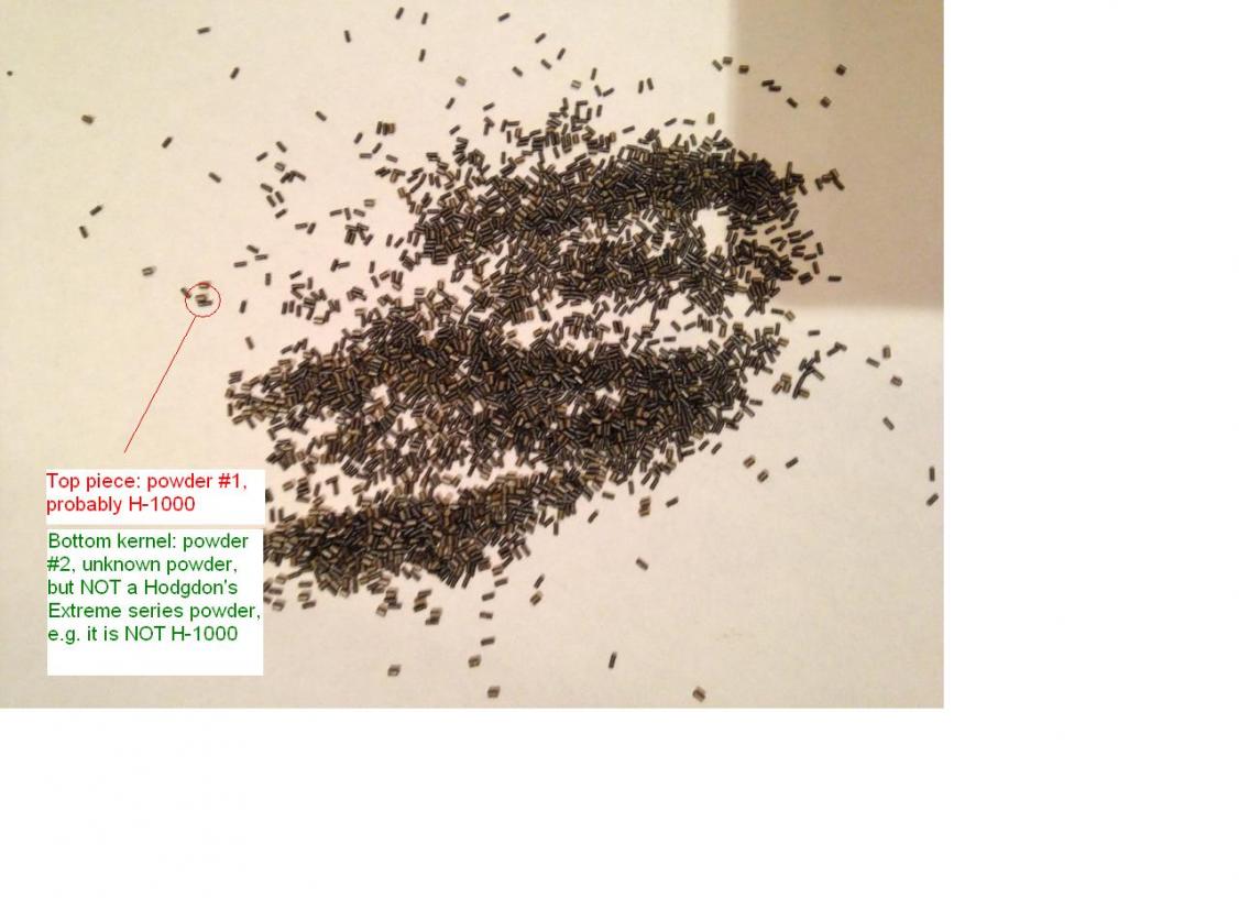

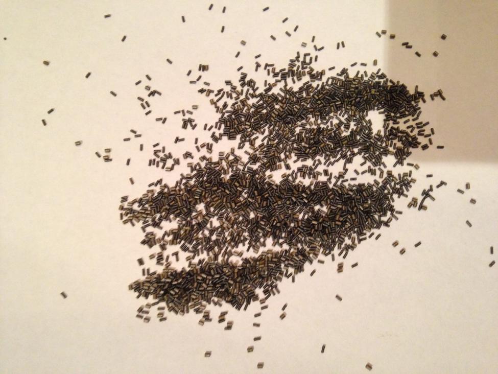

Do you have any H1000 powder from a can yourself? I just got mine out, and your pic looks awful much like a mixture of two powders. If you don't have any, I suggest you get some or find someone you trust who has some, and check it out. I see two different grain diameters and colors in your pic, and my H1000 is only greenish and fairly large diameter, no silverish and smaller diameter.
If this is indeed a mix, that could be your problem.
Here is the pic of mine...
Here is a better pic of one of the rounds. I tried to find some H1000 last night but everyone here is out.

I am quite sure that you have mixed powders there. I hate to say it.
And, Yes, you are correct, for some reason Sierra does go higher on the powder charges than Hornady does. I am actually glad to see that the H1000 by itself is not likely to be the cause. I would hate to be working with a powder that would be that sensitive to a minor "over-charge" (depending on which data you use). That would make me question using it at all.
That powder is most definitely mixed with another kind of powder, tell your buddy not to fire any more of those in his gun or he'll risk blowing his face off.
Find some more H1000 from a fresh can to confirm. If your buddy thinks that it came from Hodgdon that way, call them with a Lot # and let them know what happened. Yikes. The other powder looks like something much faster, maybe 4895 or similar? In any case, this is most definitely the fault of that reload, I'd be very surprised if the fired brass from the other gun didn't show severe pressure signs.

Concur with Sniper Uncle you have a mixture of two powders. The "Golden Rule" of reloading I was taught many years ago was only one powder on the bench at a time...
You need to go to your buddy's house and get out his can of powder and pour it into a bowl to see if it is contaminated (take a camera, take a picture if it's contaminated...). You can also look at his reloading equipment and see if he's hand dumping/measuring or some sort of progressive system. If you're doing it by hand - just looking at the powder would tell 99.9% of us that there was a problem...
The other question is how important is your buddy's friendship as you go forward as the liability and $$ involved is significant.

You're the one closest to the powder, is it different colors, or just not uniform lighting in your pics?
Also earlier you said the gun and scope were valued at 5500.00, what brand of gun was it? I have fully custom guns with NF scopes that I don't have that much into.
You said you sent the gun back to the manufacturer, I just can't see any gun mfg unvieling info that their gun was the problem. You'll never get it back either for others to test.
To me, mtncreek's pics looks th same as the powder in the pan.

Since we've established that the H1000 is the shorter grain length of the two shown in the first picture on previous page, the other powder in that mix looks to be an IMR style grain, like 4350, a great powder but NOT at 90+ grains in the 338.

Looks like to me there are some longer and shorter kernels of powder in your friends' load.

I checked two lots of H1000 this morning; both were very consistent in dia, length and cut angle.
One lot of H4831sc; same as above.
One lot H4895; same as above.
One lot Rx17; consistent dia, but cut length and cut angle were all over the place.
Never used VV powders, but I would think they would be extruded from the same dia plate and would have same dia. Cut length and cut angle could be all over the place.

Milo, I'm talking about kernel diameter. I have looked at some of my powders, and the length of the kernel does vary, but I haven't ever seen a pronounced difference in the diameter of the kernel in the same powder can. His pics show a rather marked difference in kernel diameter as well as color. Also, he is talking H1000, which I have checked my can, and it is all relatively uniform in color, and the kernel diameter is all similar. Also, the kernels in my can run in a fairly constant range of lengths, and in his pics I see not only a diameter difference, but also a length range difference which coincides with the different coloration ranges that I see.
All that together, Diameter, Length of Kernel Range, and Coloration, look pretty clear (from the pictures) to be two powder types.
MntCreek, I see your coloring differences in your pics, but I see relative uniformity of kernel size in the H1000. In the second group of pics, did you mix the powders??? I am not sure what I am looking at, because I see color, length and diameter differences in those, so I assume you mixed them for effect?
There are certainly two powders mixed. One sure looks like H-1000 - the fat, shorter green shaded kernels. The other powder is longer, thinner and gray/black and doesn't look like a Hodgdon powder. I'm sure those kernels are what killed your rifle/optic. You could, if so motivated, take a pair of tweezers and separate the two kernel types into two lots. Would at least give you some idea of how much H-1000 you had vs the other powder. Not sure what you could do with that data, but you would at least know a bit more.

Based on your pictures of the powder and others pictures of their H1000. I see more of the "other" powder in your picture than I do the H1000. What does it look like to you? Does it look like two different powders? Have you spoken with friend about this to confirm maybe being mixed?

" I am not sure what I am looking at, because I see color, length and diameter differences in those, so I assume you mixed them for effect? "
H1000 x H4895 (mixed; made me feel like a mad scientist…) Was going for a lighting comparison too, but too little sleep & not enough coffee made for a pic failure…
I just spoke with Hodgdon and sent them pics of the stuff. He said it is "impossible" to blow up a 338 Lapua round if it was only H1000 as the compressed load at 98 grains is the max that will fit and even then it is 52,000 cup pressure and very slow burning. I will see what he says about the powder and go from there I guess. I have also emailed Lapua and been talking with them a bit, curious to see what they all say about this.

I agree. H100 is the short, green stuff and the long grey stuff looks to be an imr powder and based on shape alone most likely not even close to the same burn rate. Mixing powders is not a good practice at all. Mixing powders of totally different burn rates is just plain dumb and a recipe for disaster.

I also see two powders mixed.
I'd bet the farm the large green kernels are either H1000 or Retumbo. Those two are very similar.
The longer, skinner, gray kernels are NOT a hodgdon extreme powder, nor are they a reloader powder. To me it looks like a fast-burning IMR, such as IMR4895 or IMR4064.
The Hodgdon extremes are all green colored. The reloader powders vary bit in length, and don't have nice squared up ends. Rather, a lot of the RE powders appear to have "slash-cut" ends. The IMR stick powders have the shiny graphite black look, appear rather long for their diameter.... My bet is IMR4895, IMR4064, IMR4350 or IMR4831...
It also appears the fast powder makes up the majority of the mix... You can load 338 with H4350 or IMR4350, but it calls for ~75gr, not ~95.

Does it look like two different powders to you?

It "appears" to me, to be two different powders.

I attached a screenshot highlighting the two different powders, at least how I see them.

The problem is that there is clear evidence that the powder used in the reloads is questionable, at best. Depending on how the load is 'hacked', it is most certainly at fault, especially if it is creating chamber pressures far in excess of what the rifle is rated for.
The problem you have here is that you willingly chambered a round that was not loaded by a commercial entity, and you don't have proof of what it contained. That fact alone is more than enough to absolve the manufacturer of any liability. Had this happened with a factory-loaded round, you'd sue either the rifle manufacturer or the ammo manufacturer and let them hash it out with testimony from 'expert' witnesses in court.

I'll agree with you that the mixed powder (i assure you based on your pic there are two different powders there) can not be proven to be the culprit. But we also can not be 100% certain that what you got from him are the same exact loads from the same exact run of reloads that he was shooting, either unless he happens to have a few left and was willing to pull one apart to verify. Even if it did end up having the same mixed powder, i would not be willing to ask him to fire another round out of his gun to see if it doesn't blow up!
I'm still assuming you have a savage. My experience is they have a tight chamber and reasonably short throat. Going off memory, i had to keep my loads around spec length to avoid jamming the bullet into the lands. If the rounds you have are the same recipe that your buddy had been firing and he's not looking at pieces of scope scattered on the ground and a banana-peeled barrel, it is possibly due to a looser chamber and barrel and just plain dumb luck that he is not in your predicament.
Bottom line, the round that was in the chamber at the time your rifle went kaboom was one of your buddys reloads and it was the first one at that and it was charged with an unknown assortment of mixed powder. Sure, it's still speculation, but the evidence is quite overwhelming.
