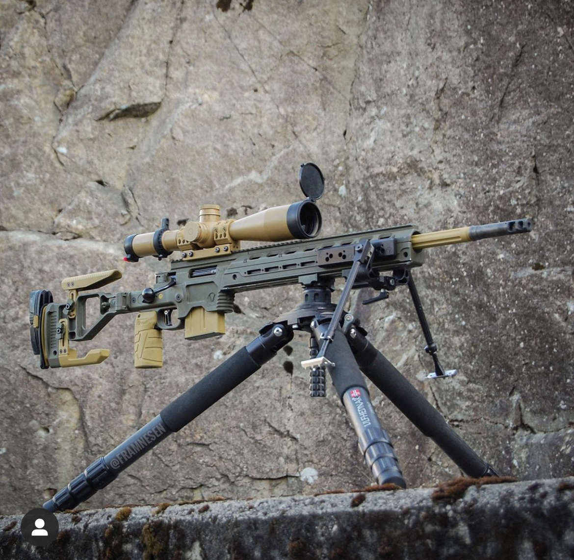

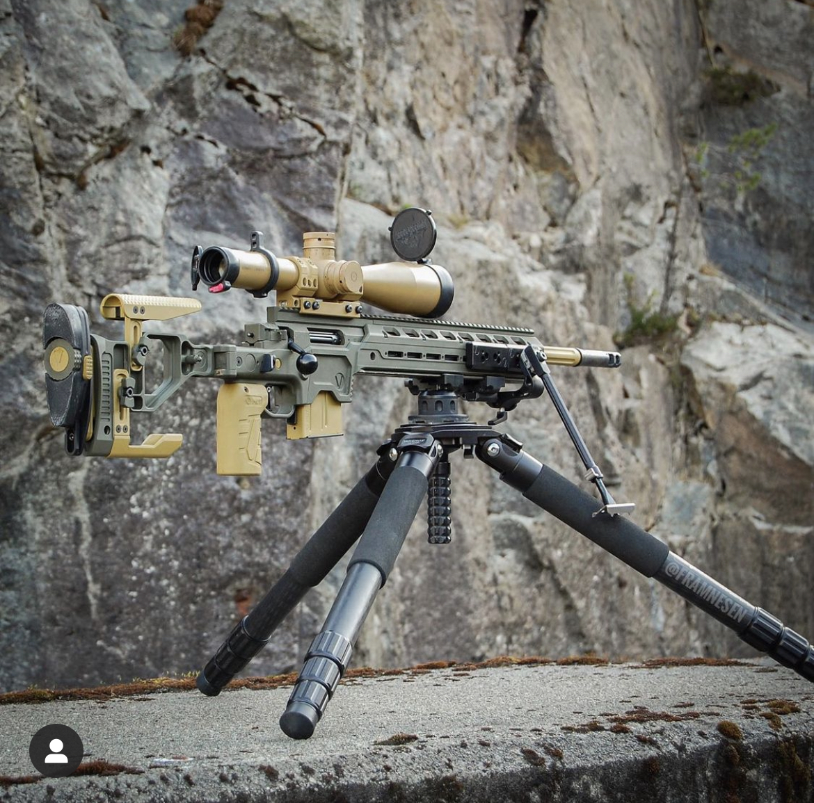

@samb300 , love the two tone, thing looks badass. Makes me want to get another AT to do this to. I miss that swept bolt with 60 degree throw...in your chassis it's about perfect.
Thanks, yeah it's Framnesen's rifle, check him out if you're on social media. He's one of Christian's friends in Norway and tests all the Vision stuff out for him.
