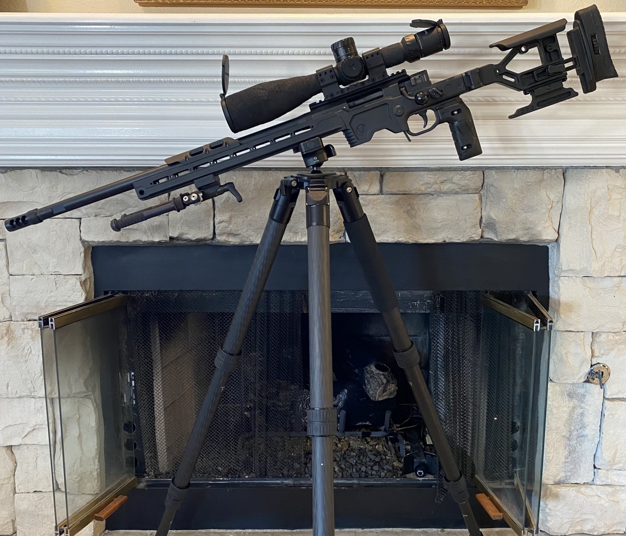

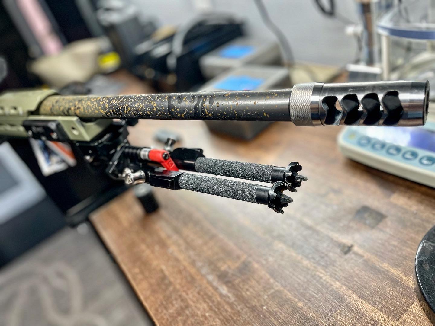

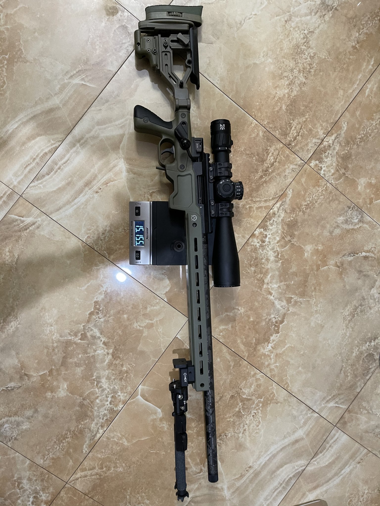

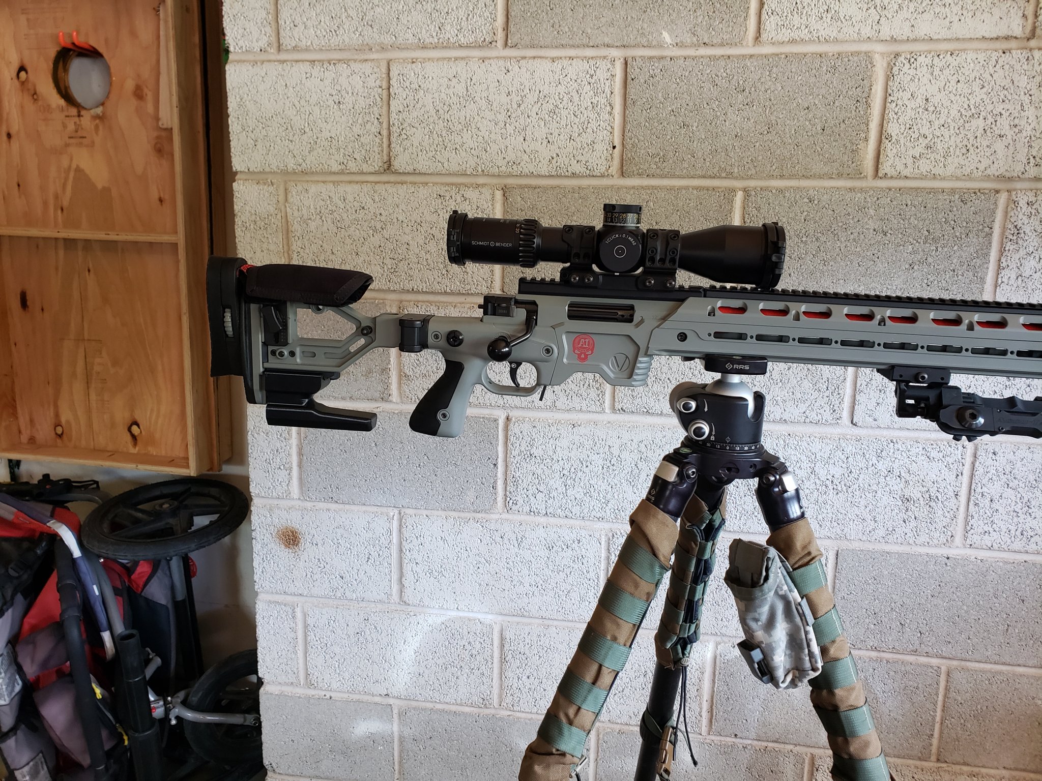

No idea. I dont have a carbon barrel. But @Covertnoob5 had his down below 16lbs for NRL Hunter. As you see it in the pic with that 28" proof comp barrel and full internal weight kit, it weighed 24.8 lbs. I removed the weights and its down to 22lbs where it will stay. 25lb is just too damn heavy. 20-22lb is my ideal weight.
I'm suprised @Covertnoob5 got under 16. No matter what combo I try I'm 17 lbs
Yea, i have no plans of shooting an NRL Hunter match, although it looks super fun. If i did, i would shoot my Tikka in 25CM with my Minox zp5. I know i can get that one well below 16 in its current configuration.

You're looking at:
Chassis 8lbs 13oz
NX8 2lbs 6oz
Barrel 3lbs
Ckypod is 2lbs
Suppressor is 12oz
17lbs with a Ckypod. You could maybe sneak it under 15lbs with an Atlas Cal, 20" Sendero, muzzle brake.

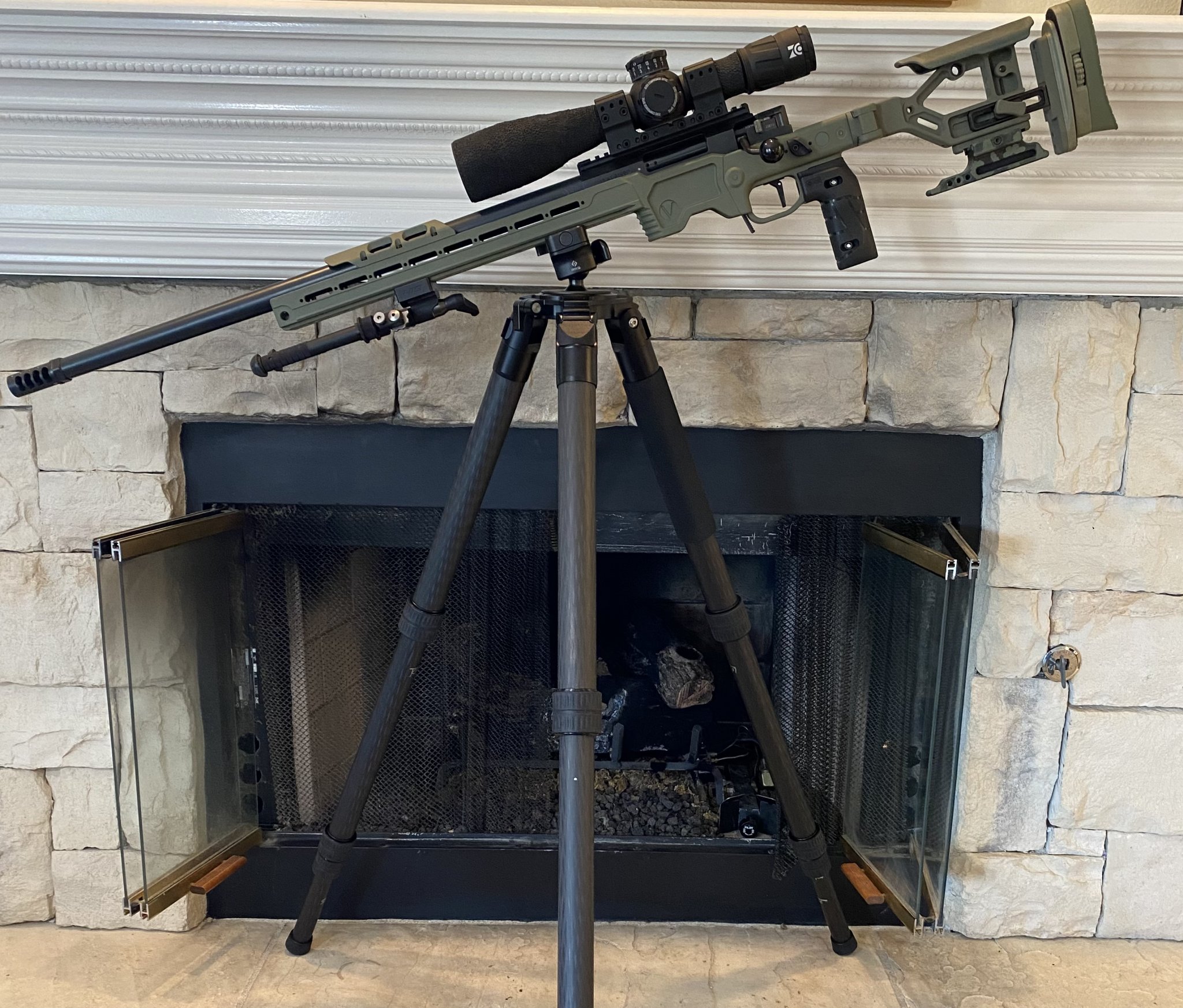

Double pull lightweight Ckyepod might do the trick, I used it at the Leupold NRL and between that and the Hawkins lightweight tactical rings my NRL rig was 10.3 lbs instead of 12.3 lbs with a standard triple pull and ARC rings.

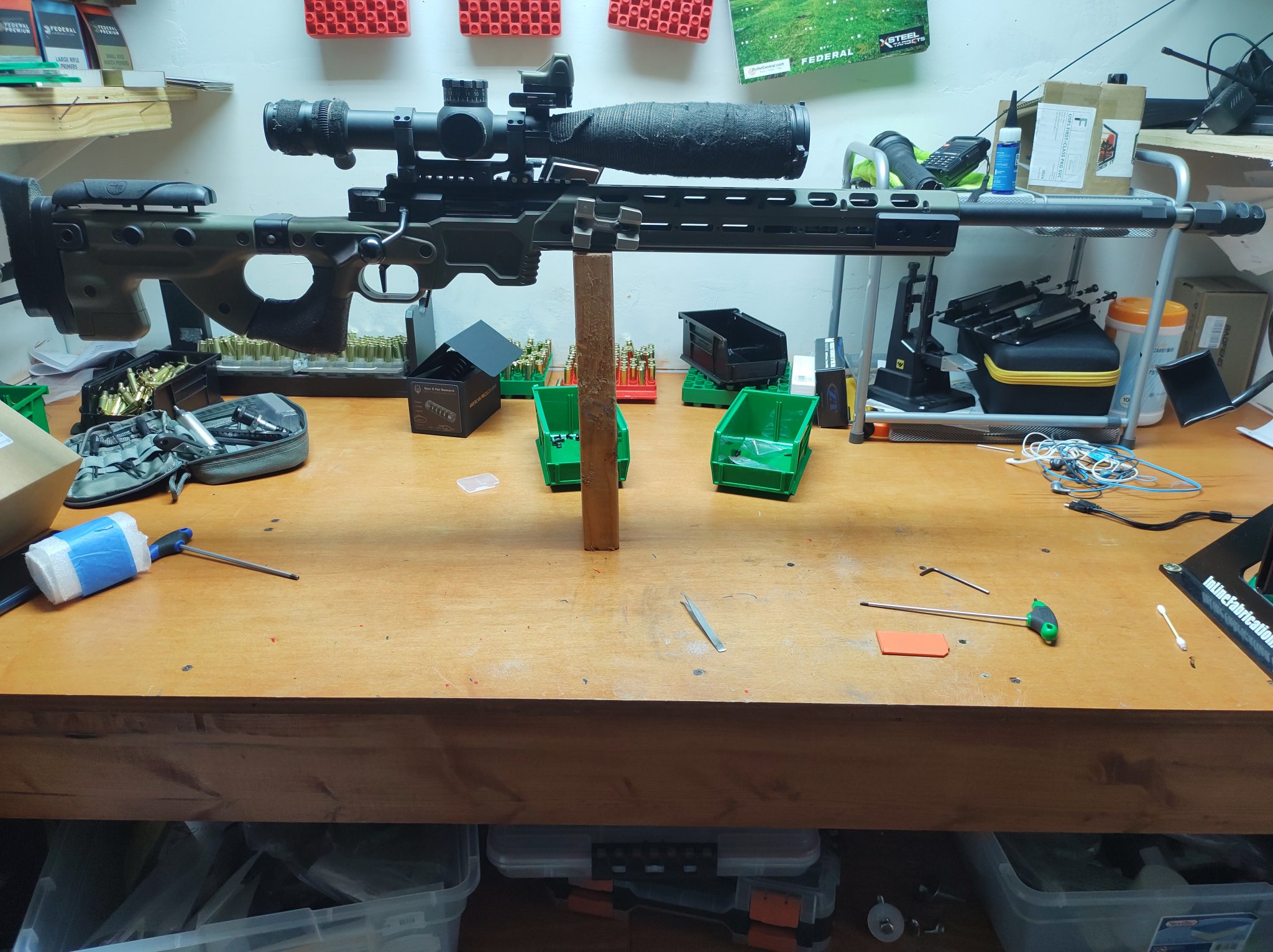

That’s weird cause I’ve got a 24” CF proof and a double pull with a ZCO 527 and I’m under. You got a pic of the setup? Are you using the stock grip panels etc?
Not right now it's ripped back apart for finishing the cerakote but it looked like this without the full bridge tho...I should have it back together next week and will reweigh it with everything...... But without the Harris @reubenski 🤣
Reactions: Covertnoob5
Damn sweet looking rig. You should be able to get that under 16. Obviously no bridge, no bag rider, I also use Sam’s cheek piece so that might save a couple ounces.

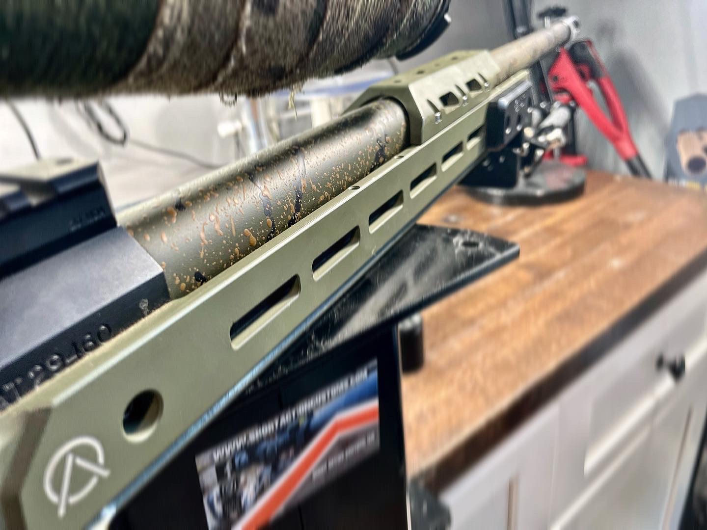

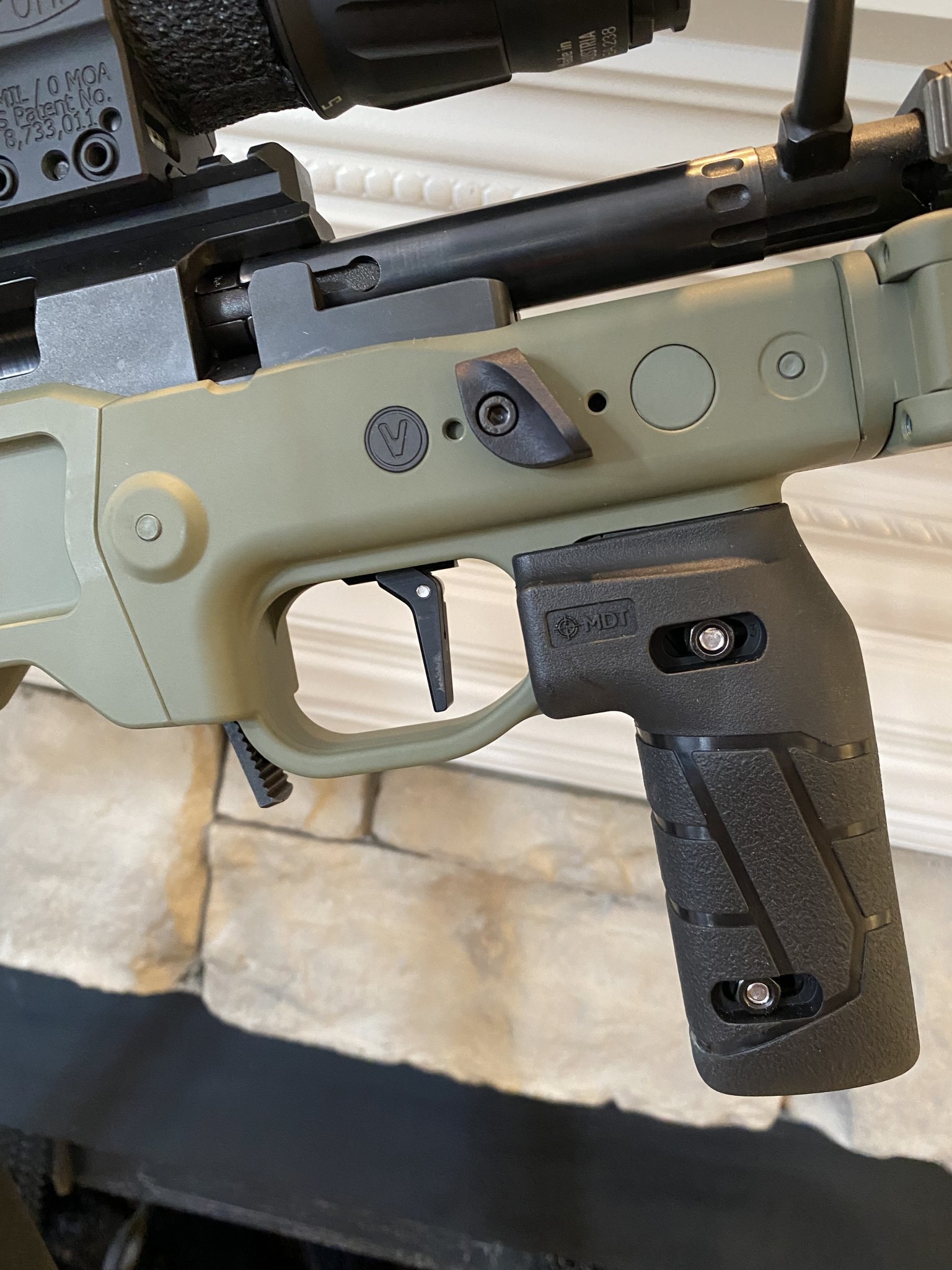

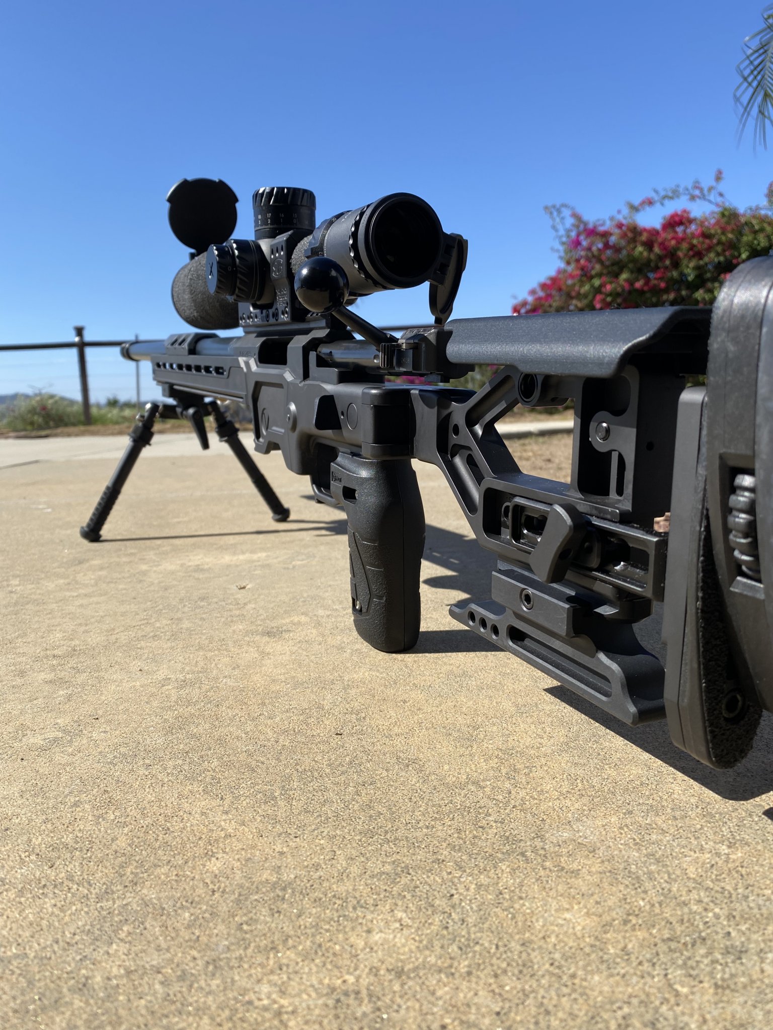

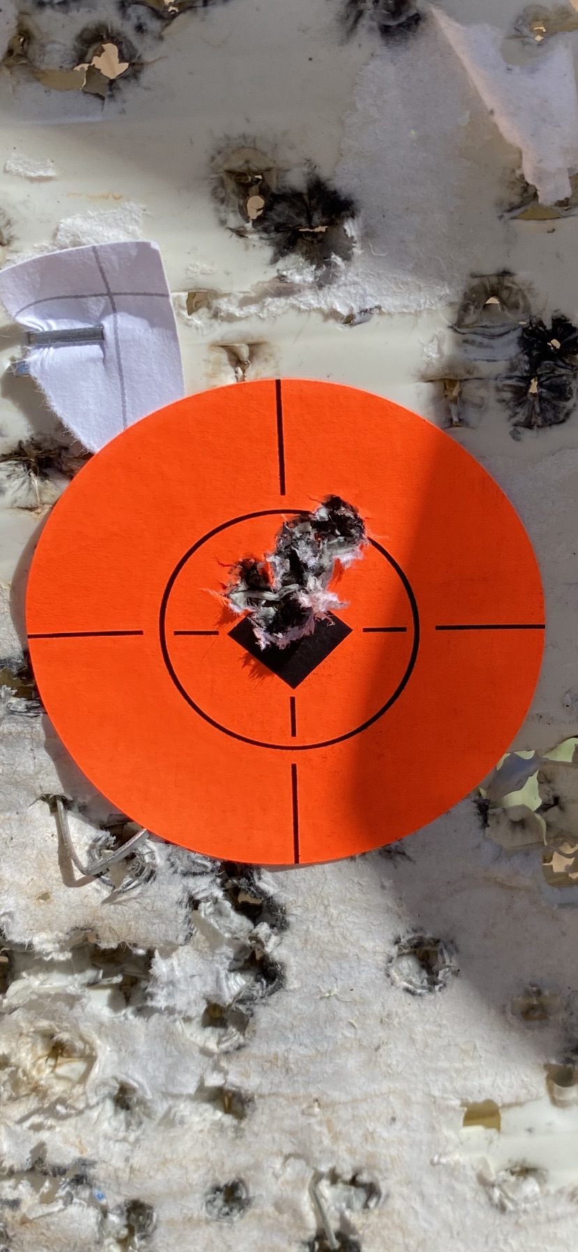

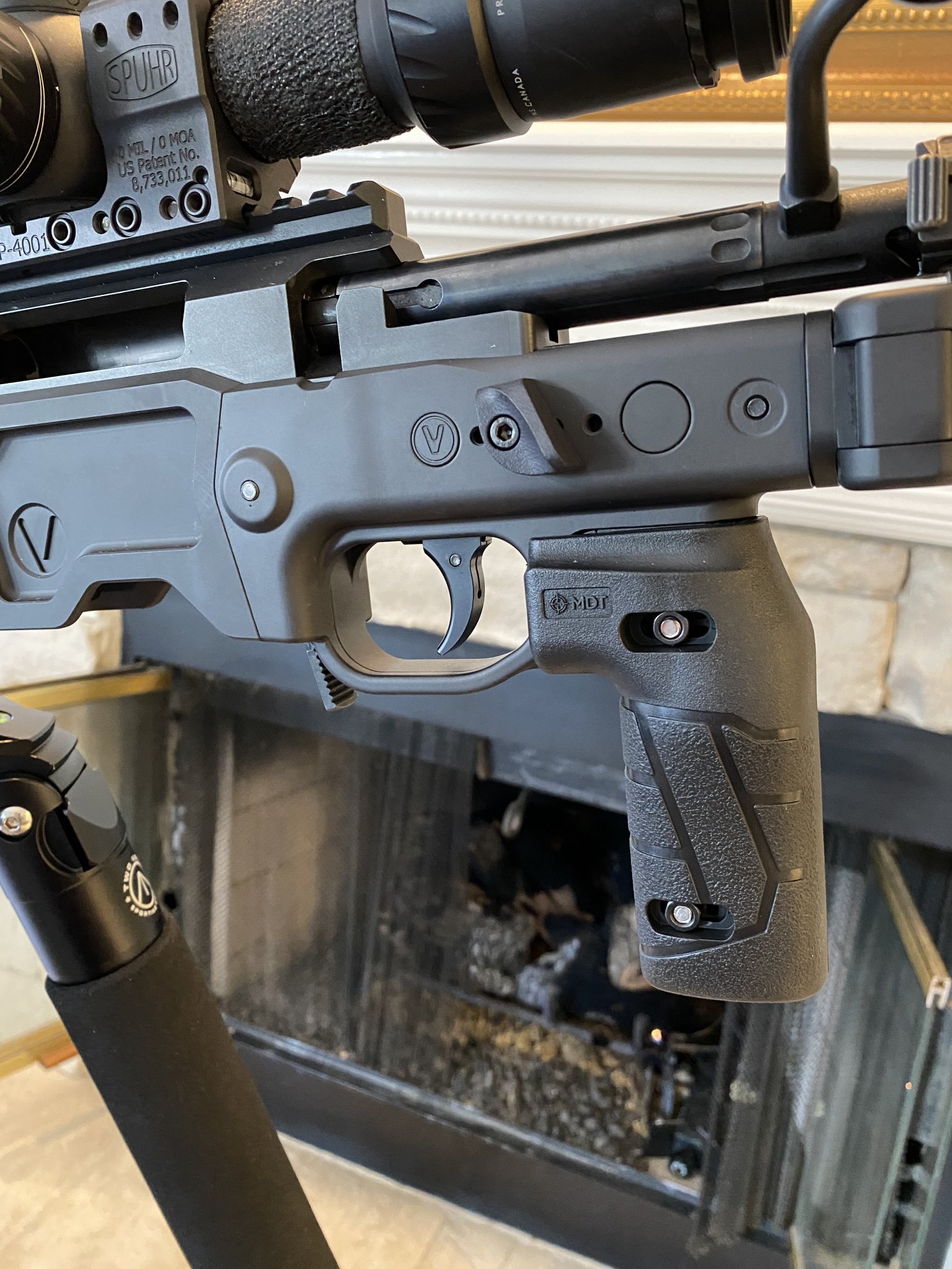

Realized I failed to post my completed rifles in this thread.
Been crazy busy so have only made it to the range with the black one. Stellar. I’ll get the Sage one out in the next couple weeks.

Is this a standard double pull or the lightweight? How’s she balance?
I’m considering this exact setup and hoping to swing the NV hood and stay under 16 for Hunter matches.
That’s the standard and if you look close there’s a gen 3 little B muzzle device on the scale. Balance is absolutely ridiculous. Super ass heavy. No way to get it to balance properly cause the AX rear is so heavy. I’ve got more dedicated NRLH rigs in an XLR mg and manner LRH. This was just a fun project more out of curiosity than anything.
