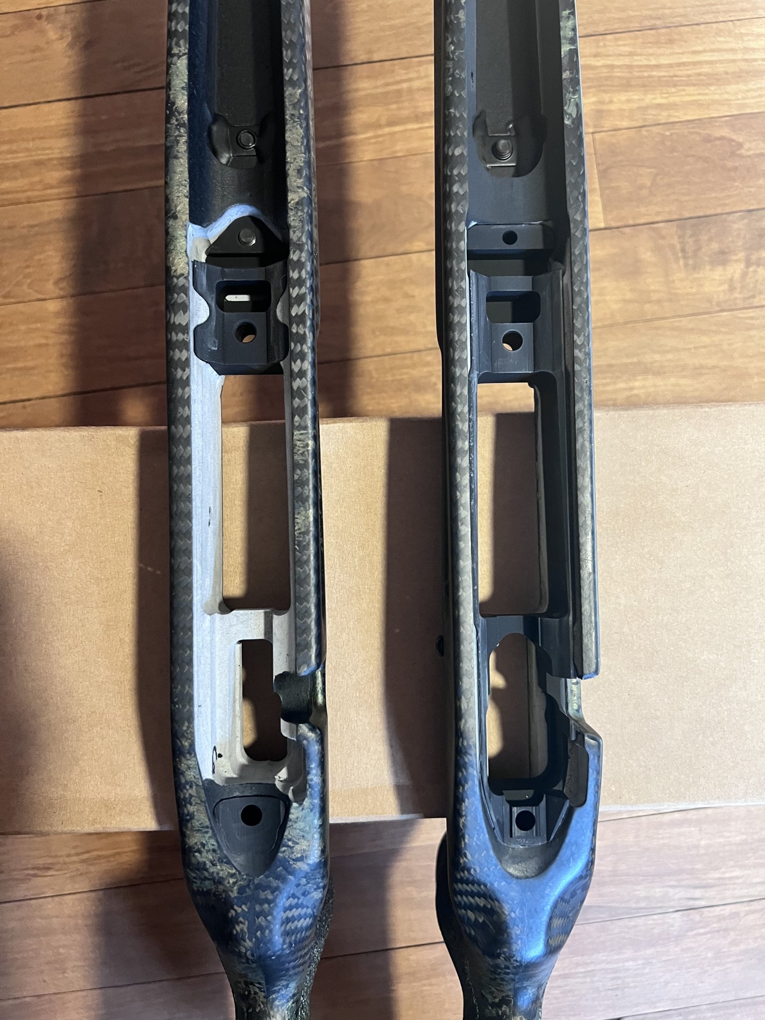

E: not going to pull the micro chassis w/out measurements, but since these are off, LRH M5 MC left, TCS G2 MC right
Micro left v. M5 MC right fwiw... if anything won't fit, it's going to be the Micro

@blacklab1 I realize you're asking about McMillan, but I'd be kind of surprised if a Solus won't fit Manners... If you post a pic of a caliper from the rear action screw to the back of the trigger hanger, I have a Manners G2 Mini Chassis and M5 Mini Chassis uninstalled, and can pull a Micro Chassis to measure
View attachment 8502662View attachment 8502663

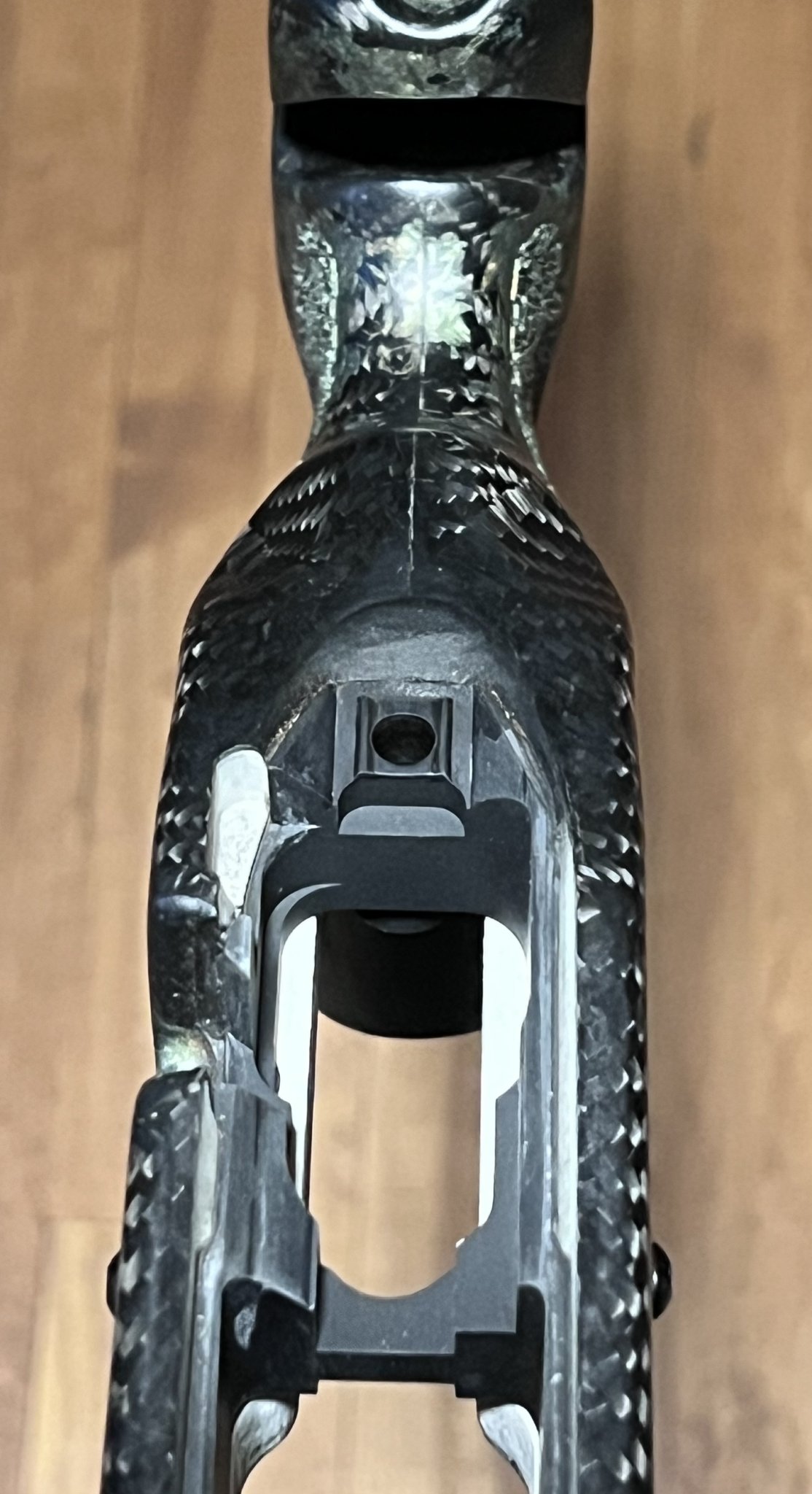

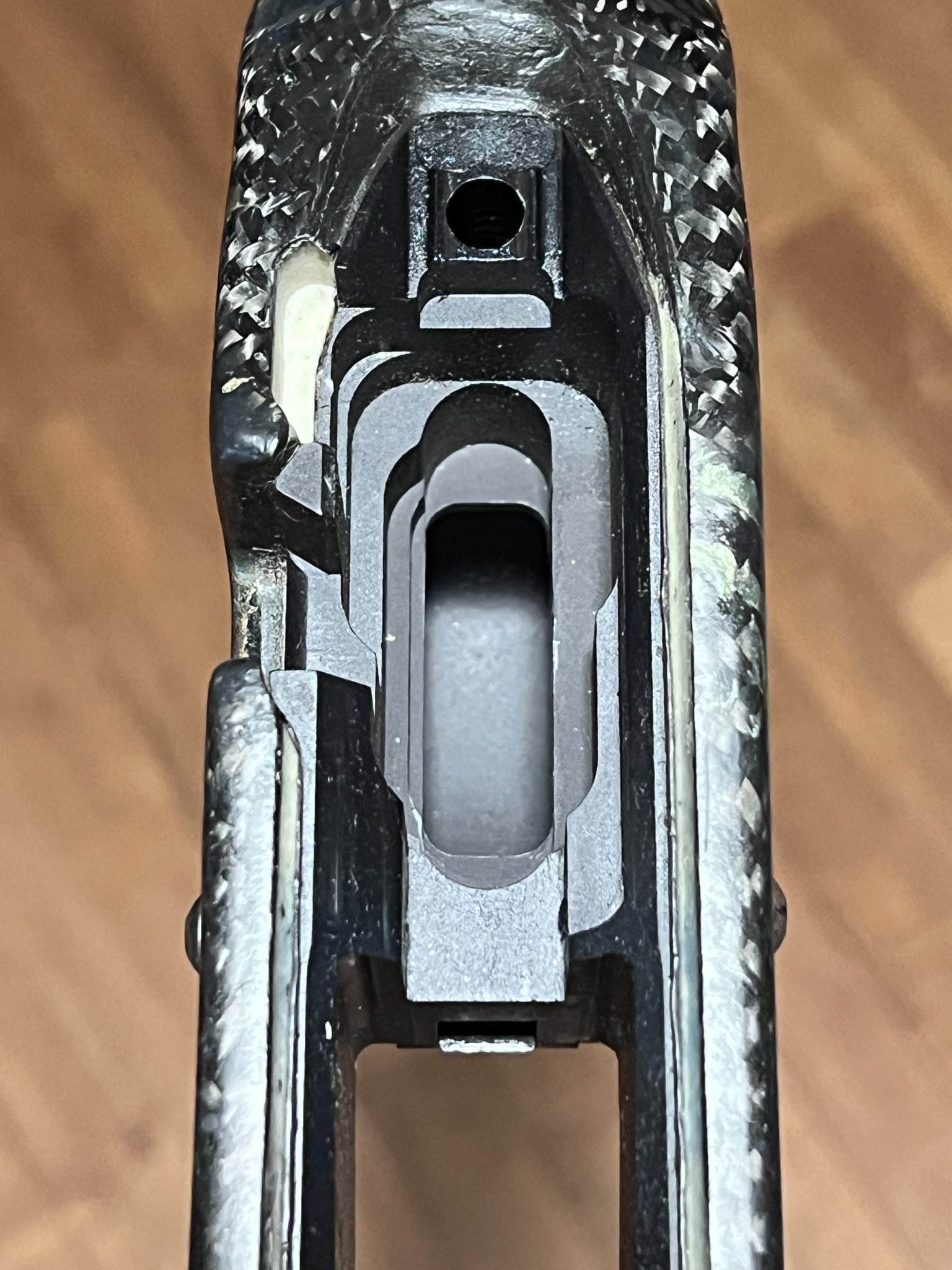

I had access to a Manners LRH with a mini chassis and the Aero fit perfectly. I bought the McMillan and should have it on a few days. Worst case scenario I’ll hit it with a Dremel and see what happens, I can’t imagine it’ll be a problem. 🤞
If any clearance is required, it should be a tiny amount. The rear relief notches on the Manners mini chassis are .275 deep vertically, I can get the back-front depth if you want it
