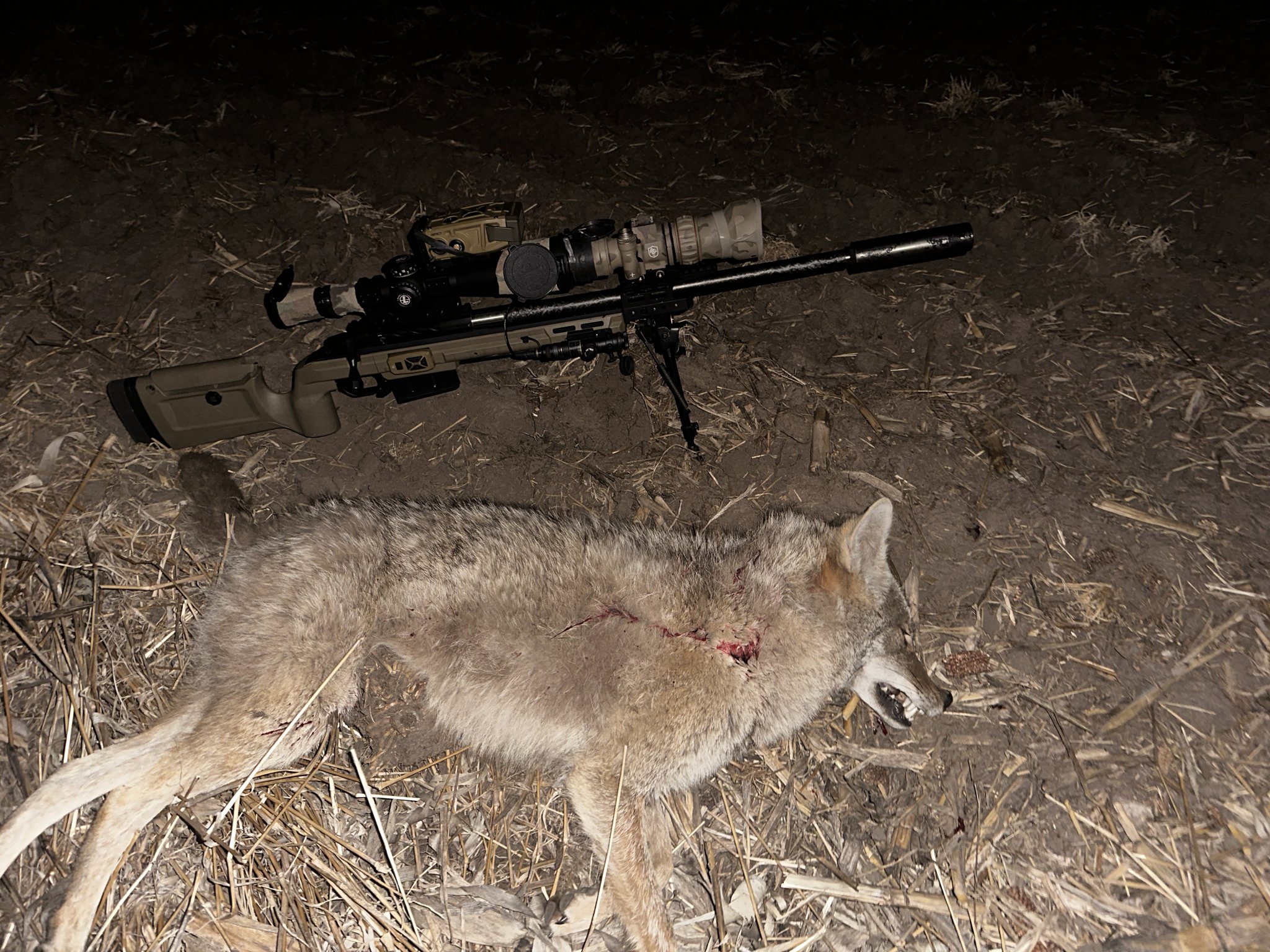

I run a 6 CM (Proof CF), 6.5 CM, 308 Win, 300 Win and 300 NM through my Zeus LA QC using the mags already mentioned. Trying to stay strong and not add a 6.5 PRC or 25 CM to the mix!
If you’re going to run a clip on and need the maximum versatility in an optic, I’ve enjoyed the MK8 3.5-25 TMR (easy to see at min power, great glass, good tracking, lightweight, better FOV than the MK5 3.6-18)

ETA: hard to get away from factory 6 CM slinging the 80 ELD VT’s at 3150fps and very accurate (good enough for 300 yds at midnight anyway)
