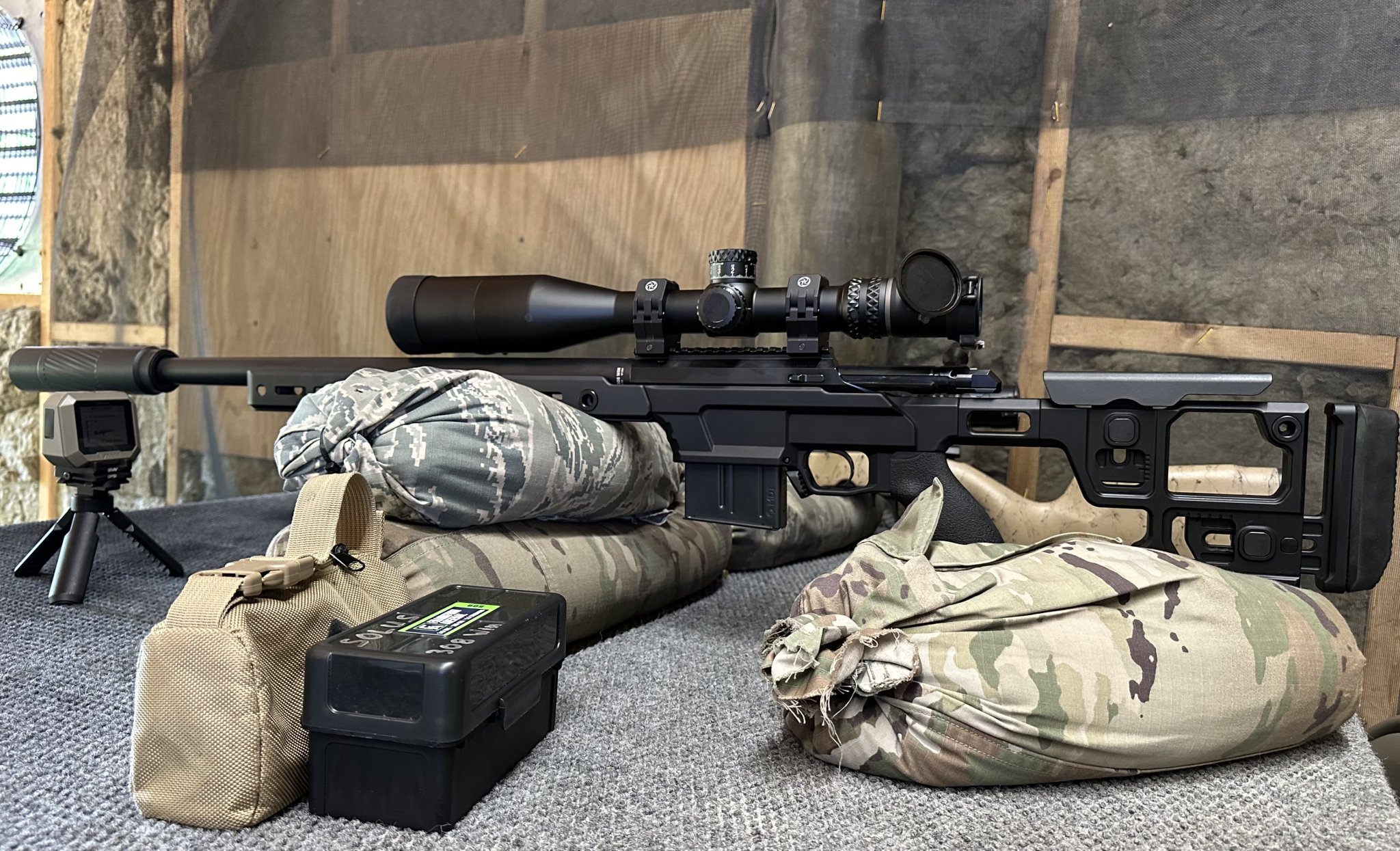

Got to the range today and can say it is the most comfortable compact chassis I’ve used.
The action ran perfectly and was very smooth and fast. For my non-warzone uses, it seems pretty damn good. I had the stock Aero barrel cut down to 17” and it shot well under MOA for the two groups I had time to shoot after sighting in.

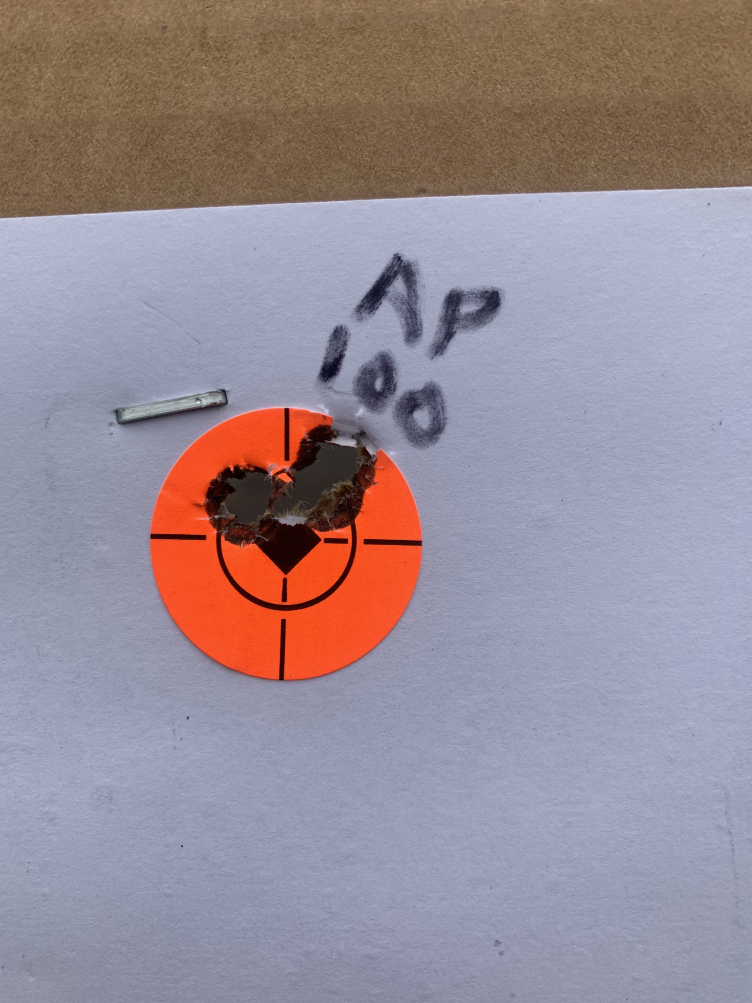

Decided to resurrect this thread after spending several months with a SOLUS .308 M24 20" version. Long story short, I am impressed how well this factory built rifle performed right out of the box. I was averaging 1/2 MOA with Federal 168 match. The cold bore consistency has been impressive and POA/POI shifts have been non-existent so far. I realize 3-round groups aren't the gold standard, but below is what I'm averaging every range day. The only downside is the M24 barrel is heavy, and the folding stock adapter needs to come out soon (cleaning is a royal pain).

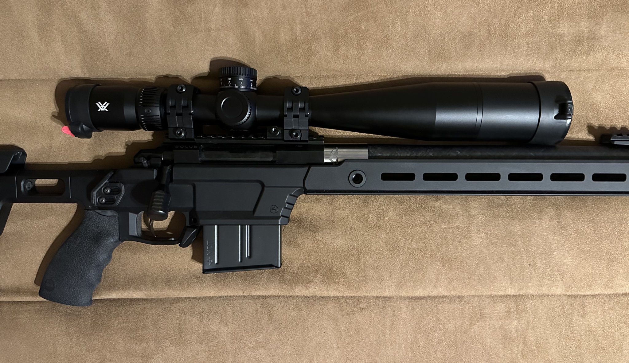

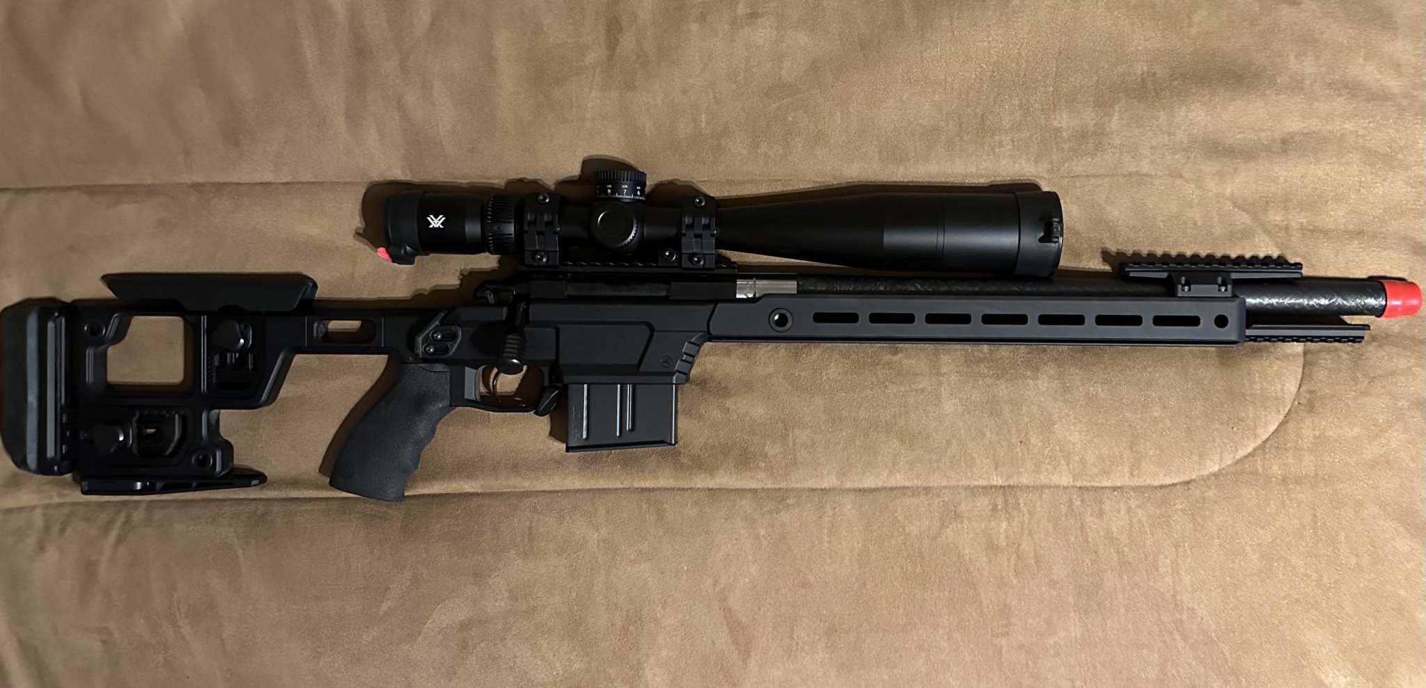

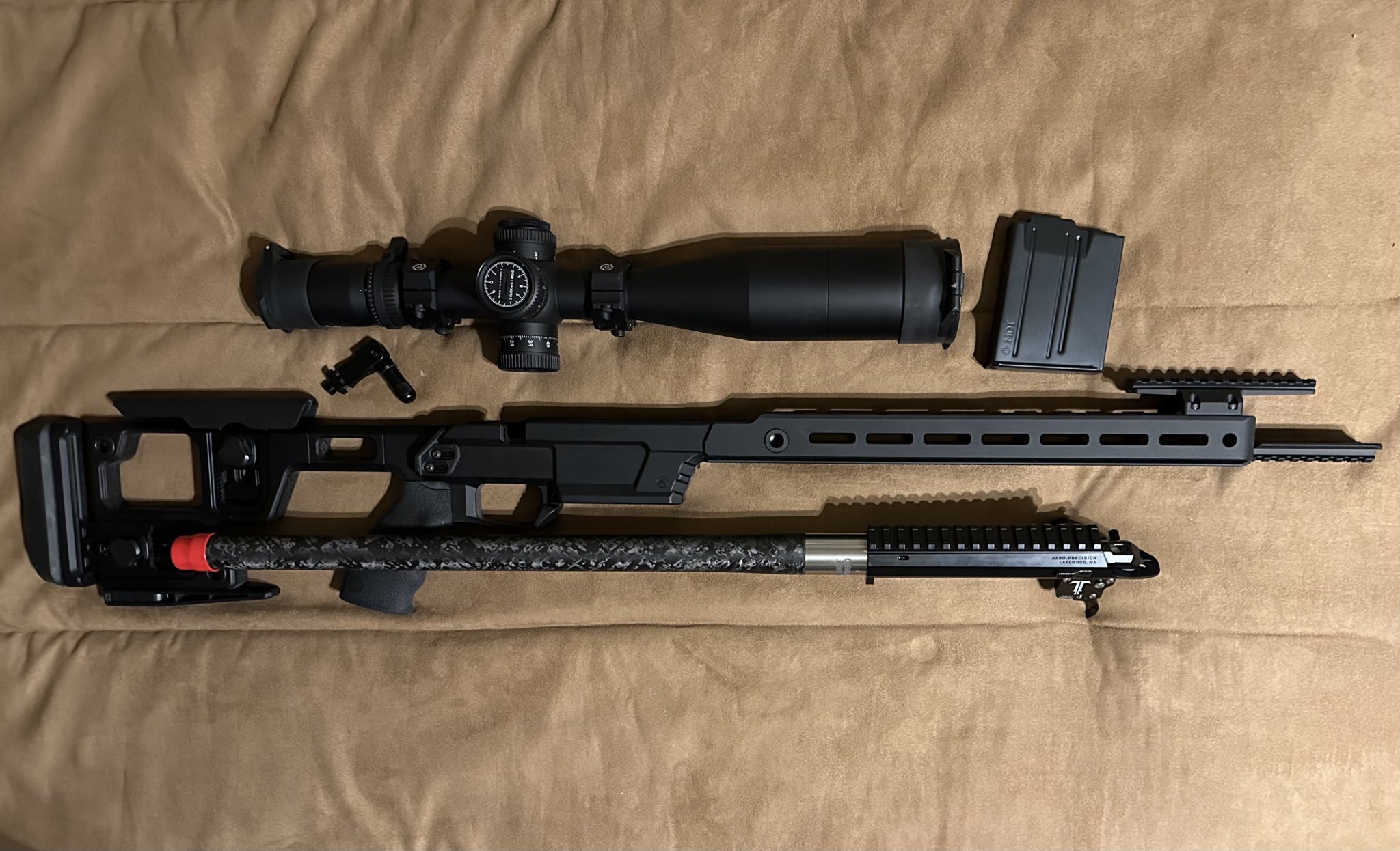

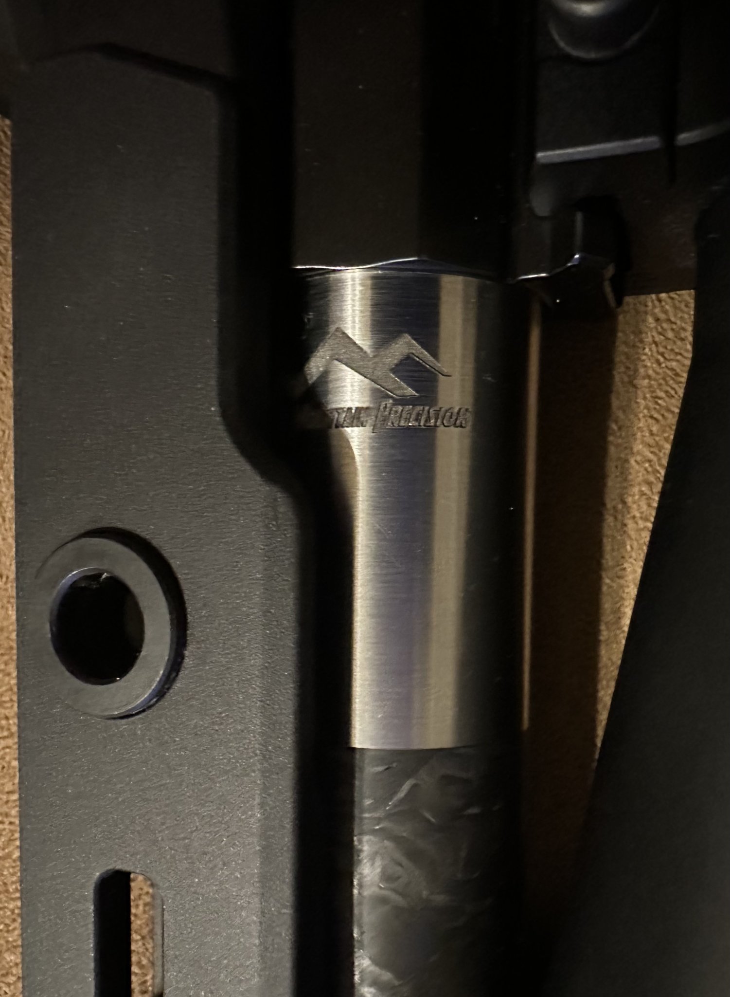

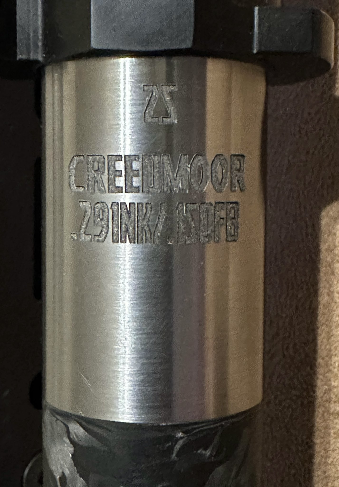

My Evolved Ballistics/Blue Mountain Precision 20" Proof 7.5" twist .25 Creed barrel showed up today... They do excellent work! The barrel threads are perfect, and all the threading and chamber are polished up and clean. They also put the neck and freebore of the chamber on the side of the barrel. So I torqued the barrel on with my old MAC 3/8" torque wrench, and the Solus action wrench to 80 ft. lbs., and mounted my SAC Modular barrel vise (35 ft. lbs for the big 3/8" allen bolt that holds the barrel still) in my Sawtooth Rifles Dependabite ARCA vise jaws, and it was solid as a rock. Checked HS with a set of Manson Go/NoGo gauges, and everything checked out perfect. So, she's good to go. Now, the only thing left to do is wait on my new set of ARC Medium 34mm rings to show up, because the Lows are too low for a 56mm scope with a Sendero profile Proof barrel. Hopefully they show up by Friday or Saturday so I can shoot it this weekend... If not, then it won't be ready to shoot until next weekend.
I just have to say, this barrel is beautiful... They really put some nice grains in this one, very flashy, and the machine work done by Blue Mountain Precision is exceptional...I'll definitely be calling them for another barrel in the future.
Reactions: Magsz18

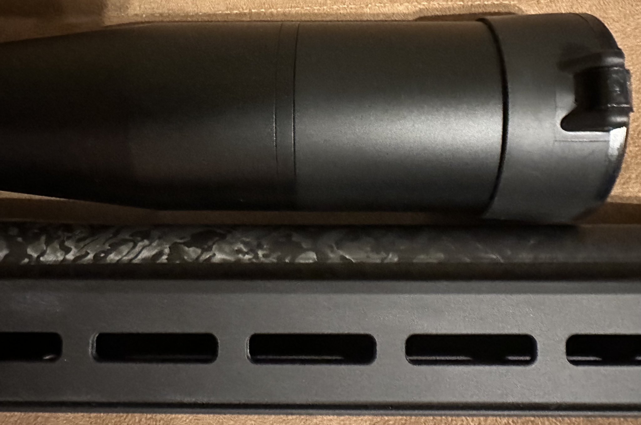

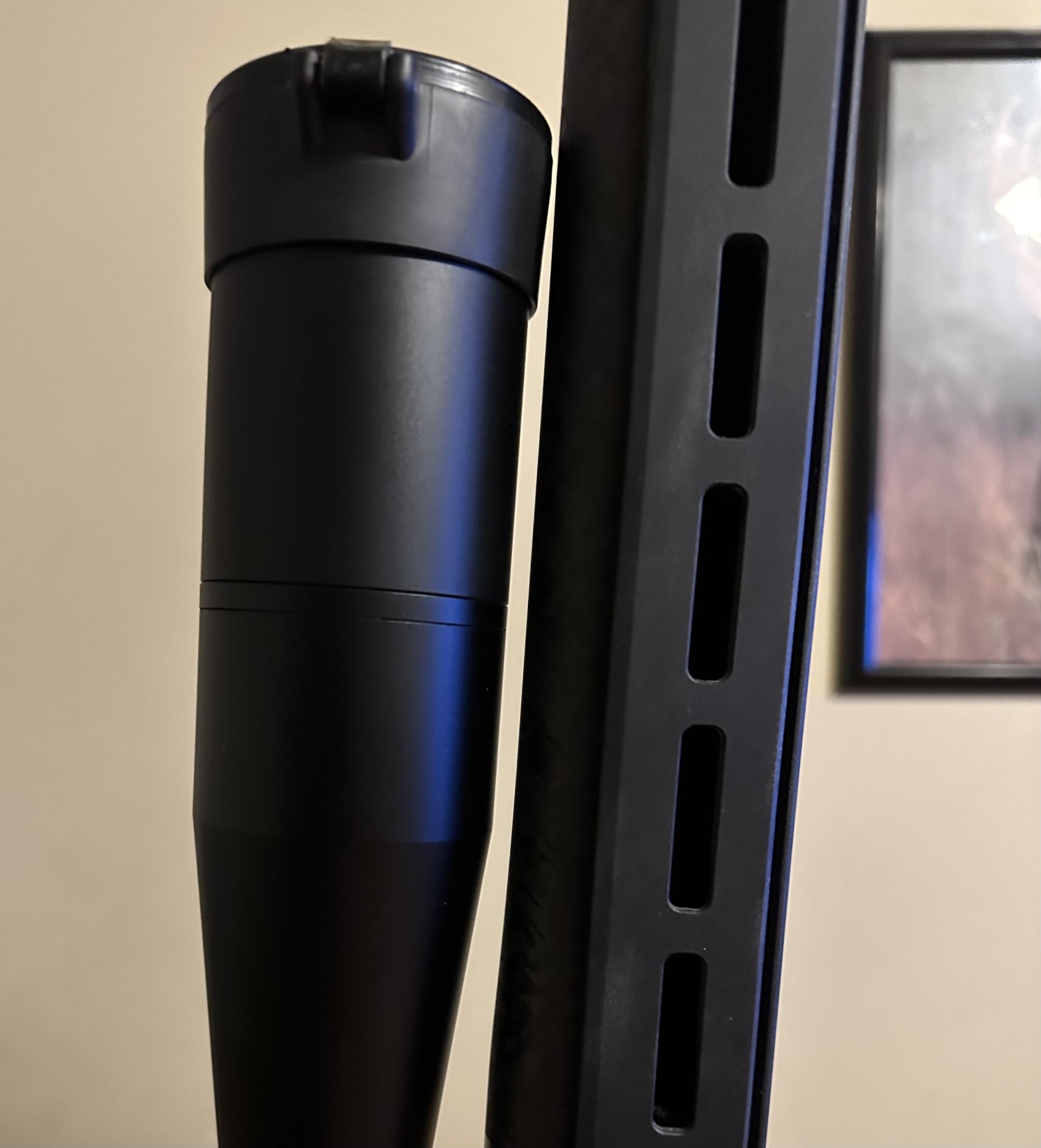

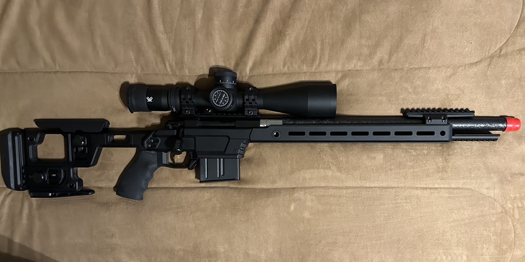

I swapped my new Viper HD 5-25x50 sitting in Low ARC rings on the, and it BARELY clears the barrel, I’ll get a pic when I get home. It was just one of those “let’s see for the sake of science” moments. My new Medium 34mm ARC rings will be here today, so the Razor G3 will be going back on the .25CM, as originally planned, I just had to pull it for lack of fitment. I just wanted to see how much difference there was, and as far as weight is concerned…Night and day. The Viper HD is so light, I could actually hunt with this rifle in current configuration, with just the simple scope swap from the Razor to the Viper, and changing nothing else.
