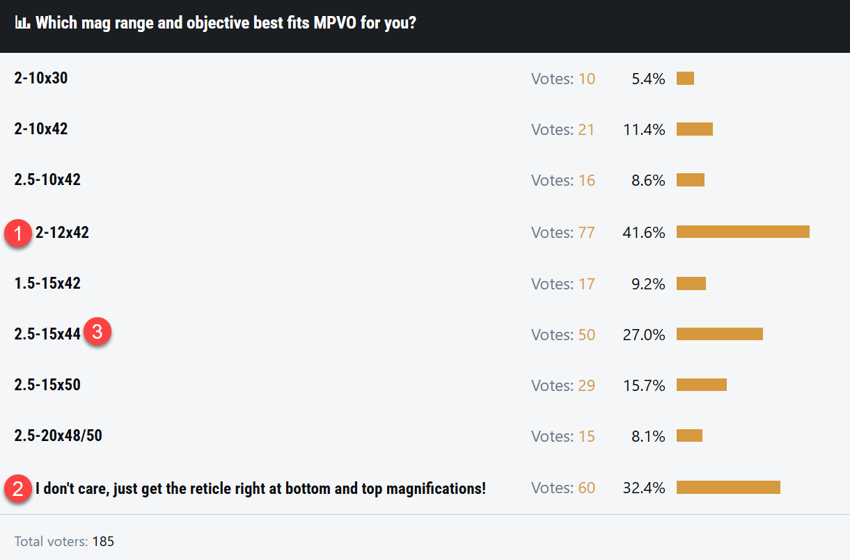

    UPDATE 02/20/2025:
    Okay, after almost 1 week we have 154 entries into the poll.
    For political polls they are often using a sample polling size of about 2000 to 3000 people to represent the 150,000,000 people who vote in our country. Let's take the high number of 3000, that is just 0.00002 of the people represented which if I have my numbers right means the 154 respondents above represent 7,700,000 shooters (that's right, almost 8 million shooters :ROFLMAO:, that is if I did my math correctly which was never my strong suit).
    So according to the above numbers, manufacturers take notice, that means that 42% would like to see a 2-12x42 scope that fits the MPVO criteria laid out in the OP above, or put another way, 3,249,400 (three million two hundred and fifty thousand) shooters are interested in an MPVO done right.
    Let's be clear once again and I'll start by stating what an MPVO is not, an MPVO IS NOT a crossover scope (though it could be used for crossover applications on a hunting rifle that is also used for long range steel shooting). An MPVO IS the next evolutionary step from an LPVO and is intended first and foremost for the gas gun crowd; therefore, it cannot have a higher bottom magnification than 2.5x (any higher puts it into the crossover category). An MPVO serves as an alternative to the limitations of the LPVO for PID and longer distance engagements while still maintaining a lighter weight, this is a short/compact FFP scope with parallax adjustment, lower profile exposed elevation turret (locking ideal), bright illumination and most importantly a reticle that works for quick engagements at the bottom magnification with a mrad hash option that works at higher magnifications for longer distance engagements.
    By the way, this was meant to be somewhat in jest with the above numbers, we understand that polling can be a bit skewed (especially when they focus in the wrong area to represent a fair demographic) but it does help to understand a sampling of interest from a community.
    UPDATE 03/03/2025:

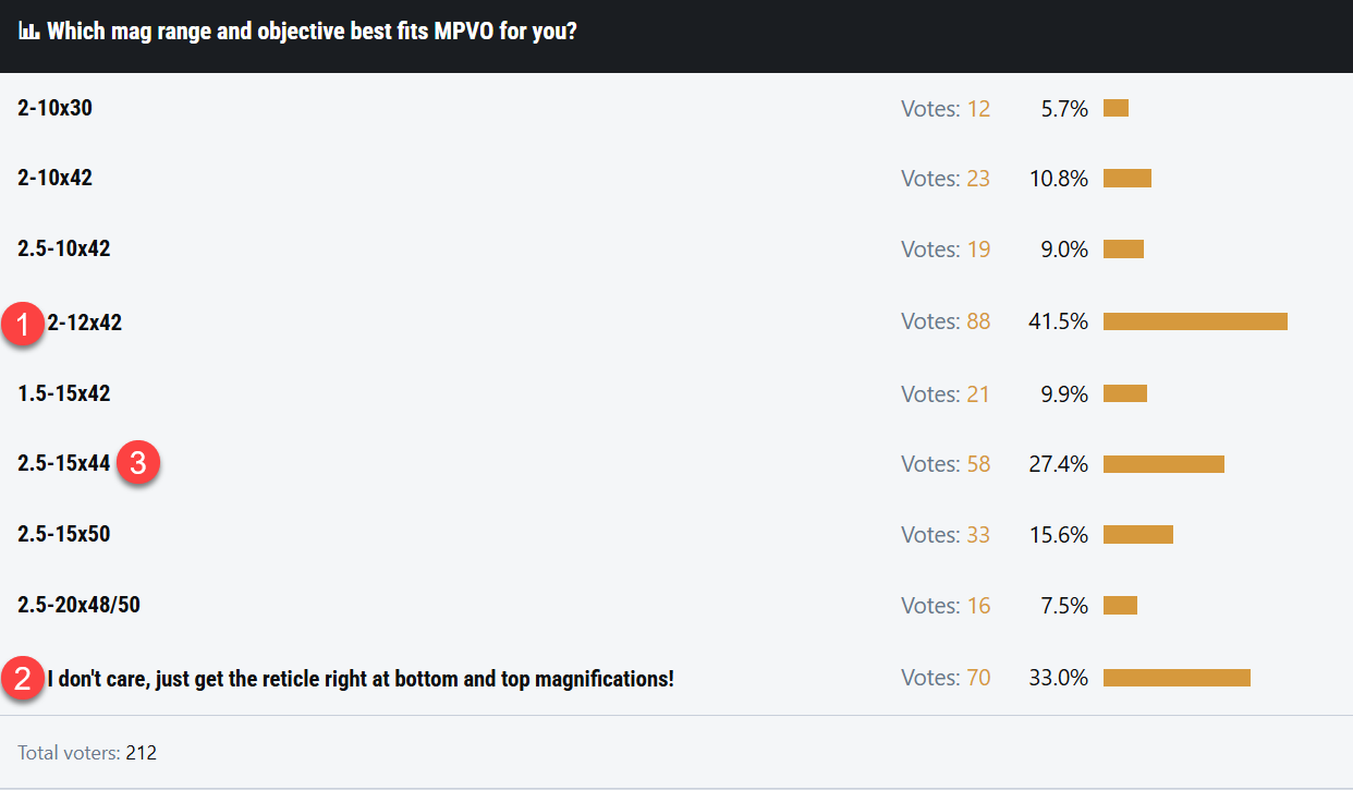

    Okay, we are just over two weeks into the poll and at 185 total votes; however, with 30 some more votes than last week, we went from 42.2% to 41.6%, so rounding shows we are staying at a steady 42% for the 2-12x42. Hopefully this gives manufacturers something meaningful to chew on and consider. The next higher percentage below is from the "I don't care" crowd who just want something with a better reticle in a FFP scope - something that works well at bottom magnification and at top and the third highest percentage is what I would call a hybrid between a crossover and an MPVO with the 2.5-15x44. Unfortunately, it takes at least a couple years to flush out a design, what we need is a good LOW 2-12x42 design that other manufacturers can OEM and put in their reticles (reticles designed for MPVO/crossover) and their turrets (lower profile).
    We are now just over a month in and the numbers are holding pretty steady. We have about 15% increase in votes (from above) but the 2-12x42 remains the top option with the next top being the "just make the reticle right" crowd.

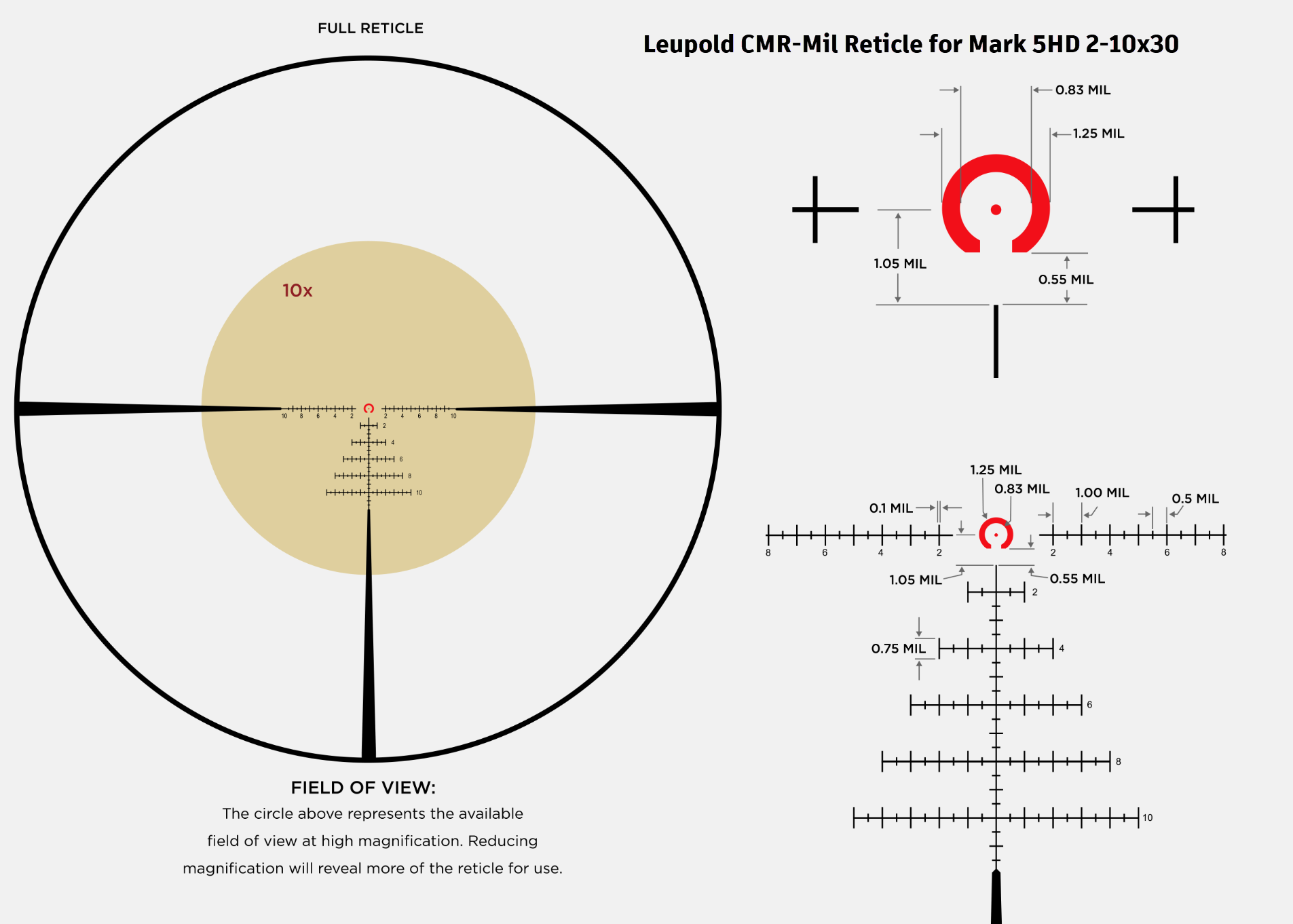

    And dont rule out the l&s mk5 2-10 ... hecque of a dialing range !

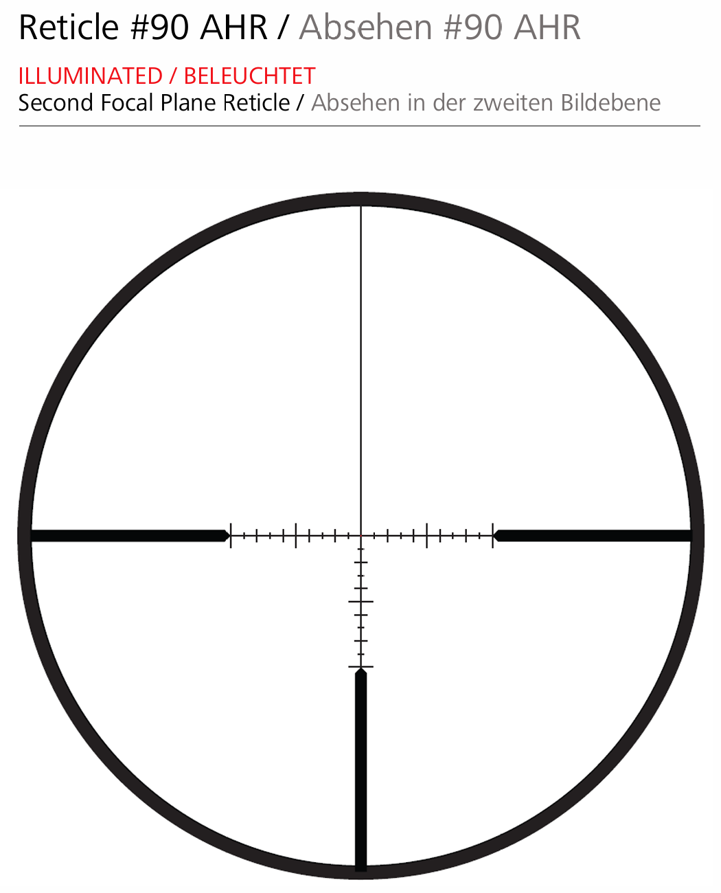

    I’ve got a Zeiss V6 2-12x50. It’s SFP, but man, I love that scope. It sits on a 308 hunting rifle.
    Do you think there would be interest for the V6 2-12x50 and V8 1.8-14x50 with exposed turrets and the AHR reticle? Not thrilled with SFP but might be what some are looking for? Here's the reticle with DLB center illuminated dot...

    Have you seen Leupold's new CMR-Mil reticle for the 2-10, might be what you're looking for... personally, they should have brought the main horizontal stadia with wind holds inside the donut, at least with dots, they way it is right now would be frustrating with light winds and dialing the elevation turret...
