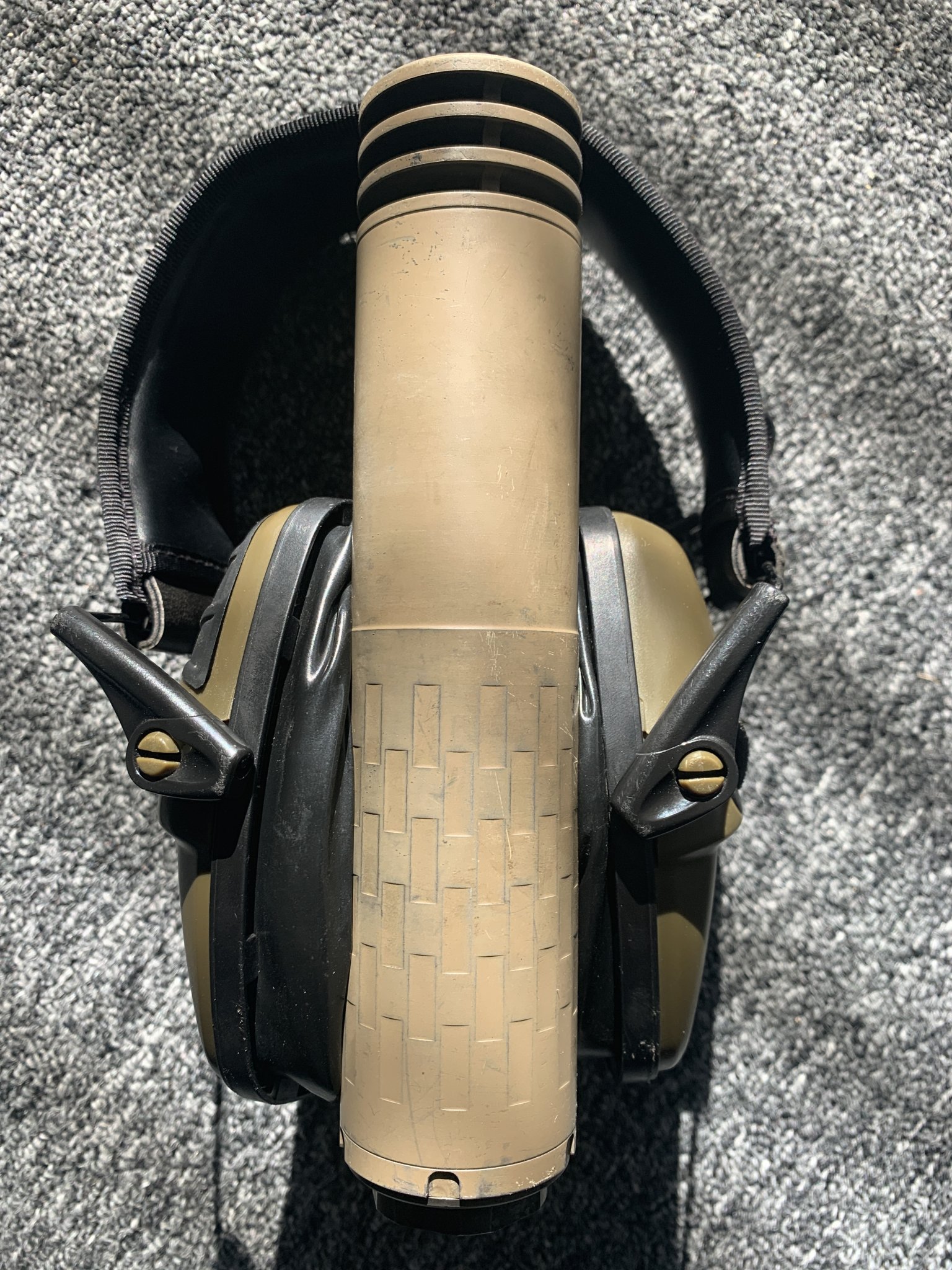

...It's crazy that guys cheap out when it comes to ear pro... I was shooting with a guy yesterday running a $6k rifle and ~3k+ RRS/Swaro tripod setup... he was using basic electronic Walkers only (no foamies). I hope he has some cash leftover for hearing aids down the road, because he's going to be needing them....
That is an option... just as long as you're shooting on your own, or everyone else you're shooting around is running a can too. 😜
Can or not, if anyone else around you is not using a can, it'll still add up to hearing aids in the end unless you double up the ear pro. Honestly, with most of the brakes guys are using these days, it's actually worse for anyone else in the vicinity who's not directly behind the gun.
