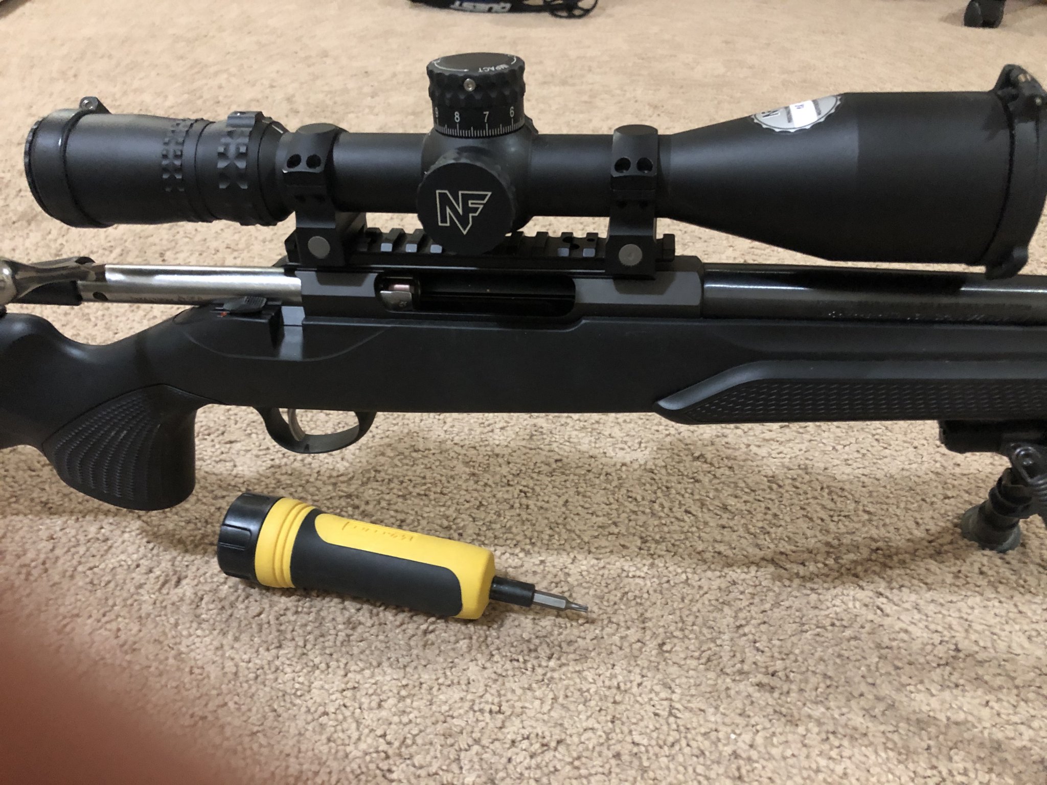

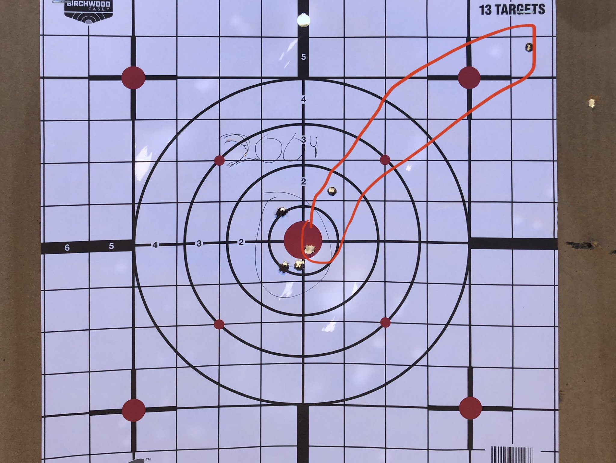

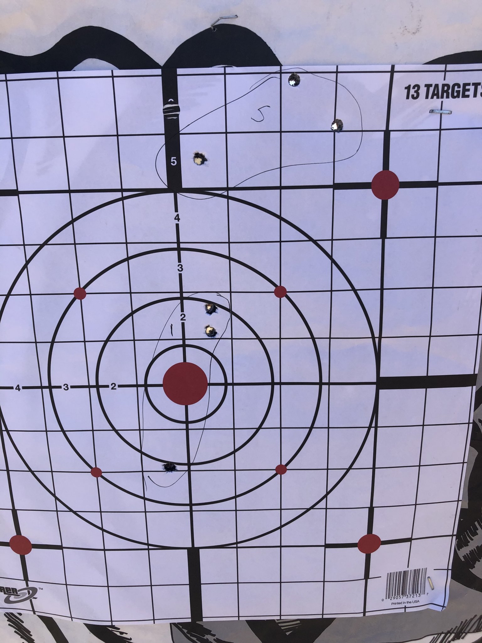

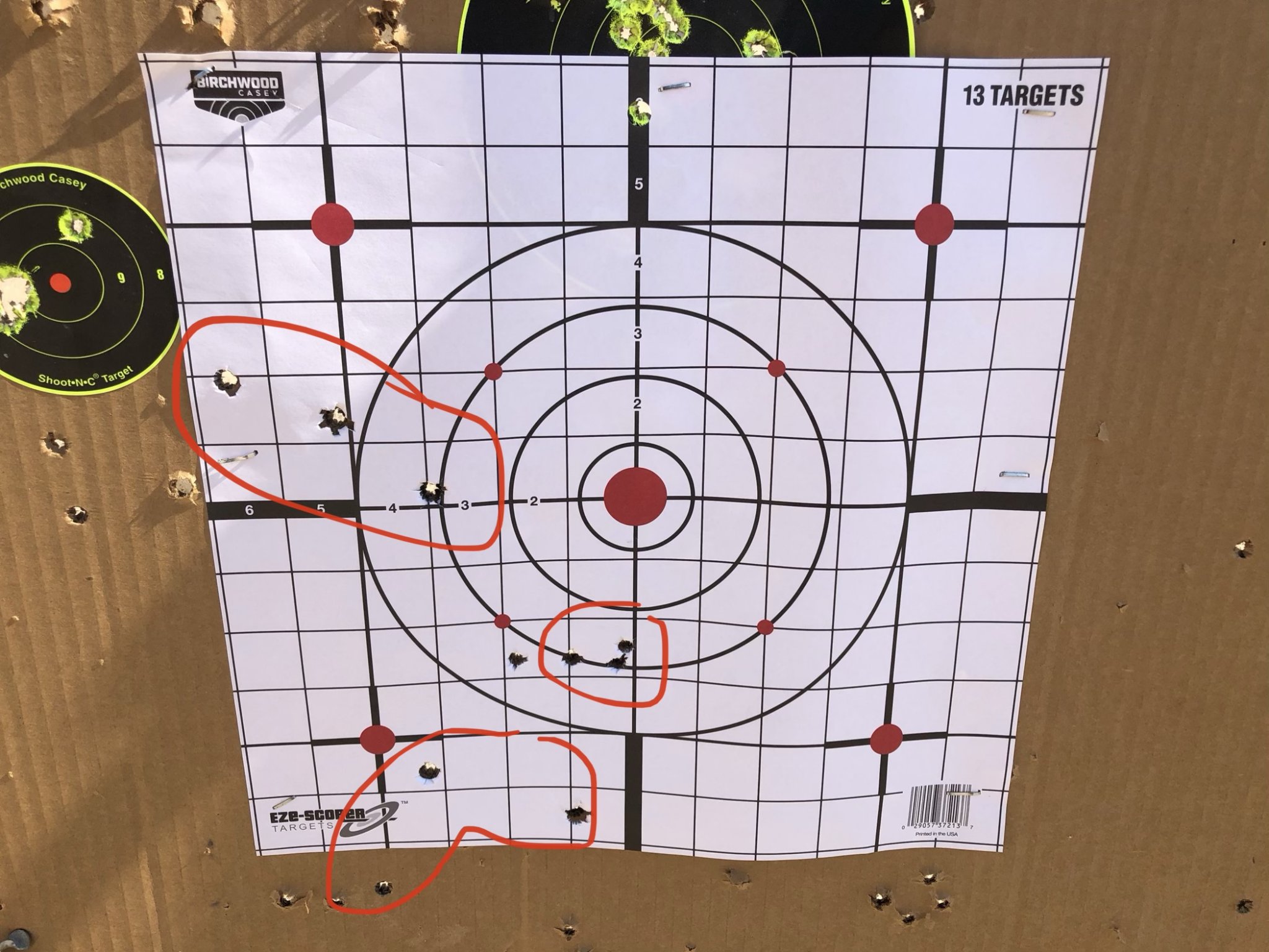

IdahoSpud
Jul 20, 2020
210
179

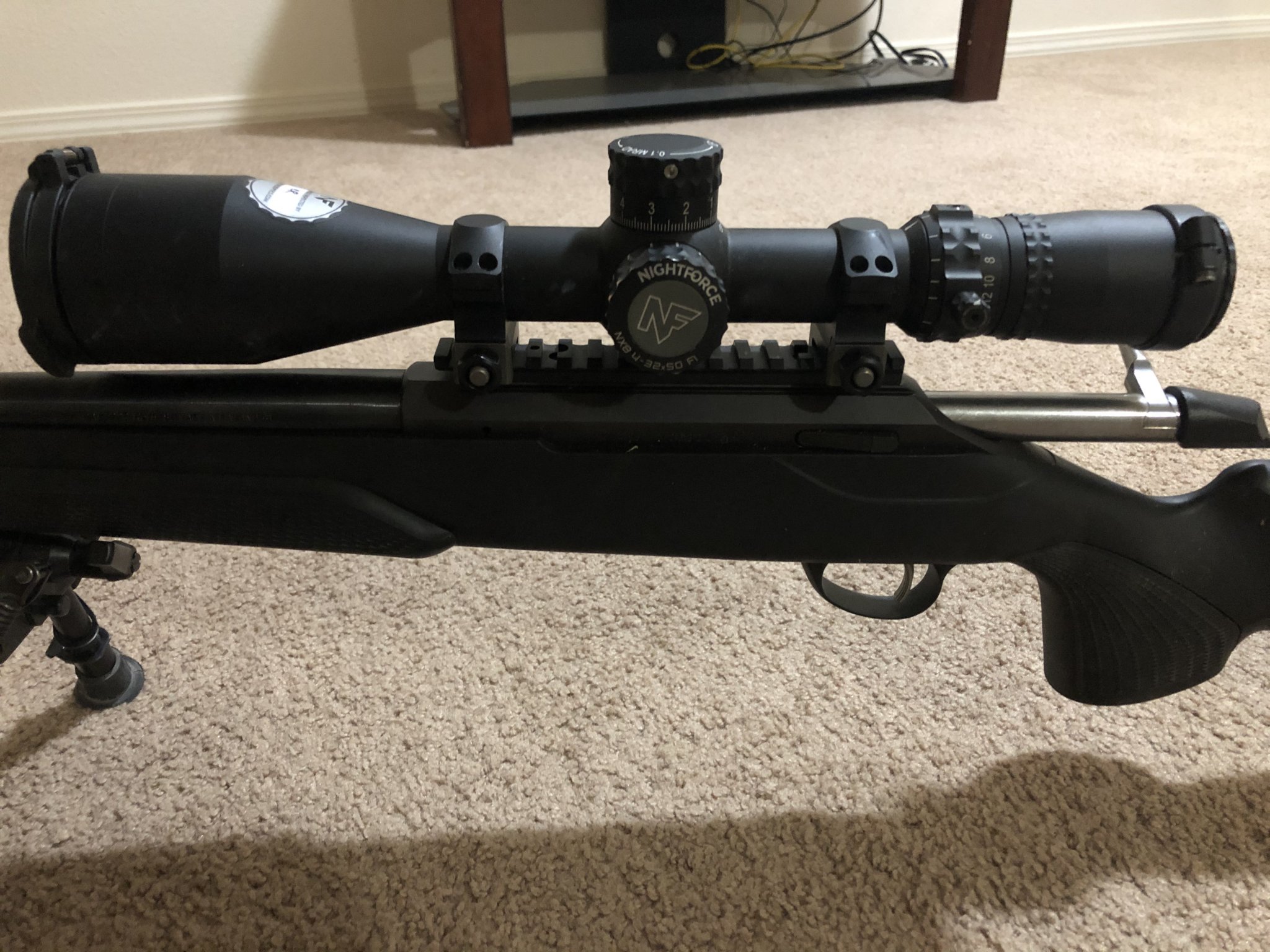

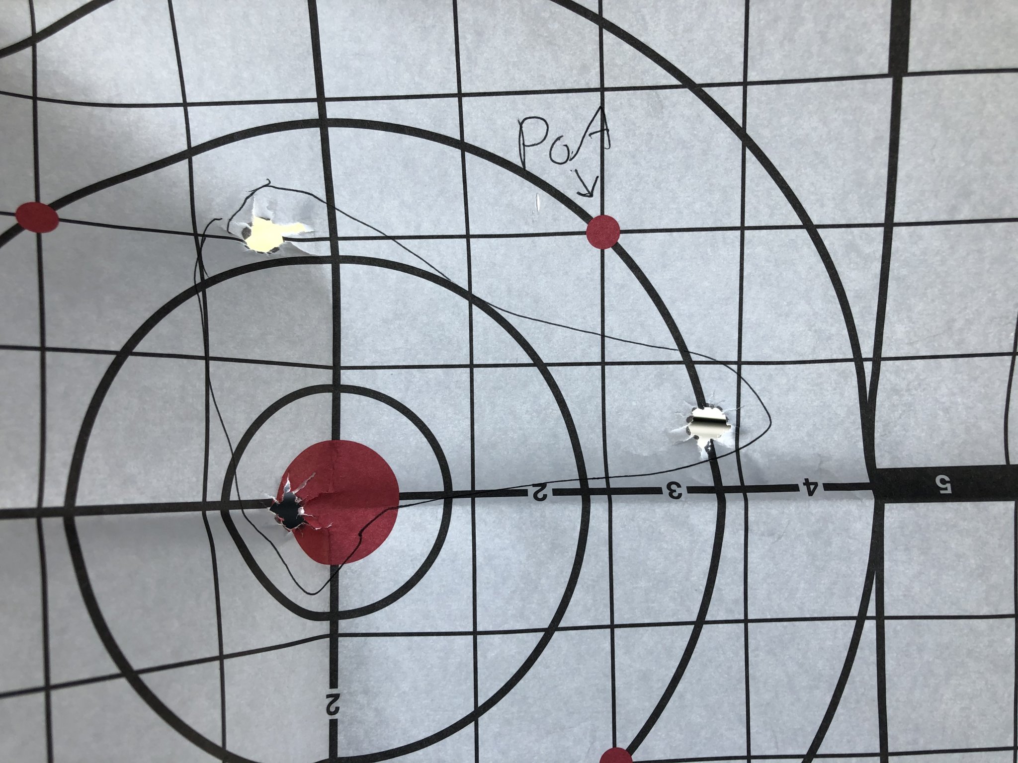

I purchased this optic over a year ago at a hole in the wall gun store after they first came out. Every other store in the area was out and this store not only had it but gave me a discount. Skeptical but I gladly took it.
For the past year + I have isolated the terrible accuracy problems I have been having to this optic.
I have put it on three of my rifles and they all produce the same results with the NX8.
I have put other optics on the same rifles and had normal good results. Even with cheap $400 scopes instead of the $2400 NX8.
I have had many very experienced shooter’s test it out including one of the accuracy testers at axial precision, and a PRS shooter from this site who won the last competition. Everyone has said the same thing. I couldn’t shoot this bad of a group if I tried.

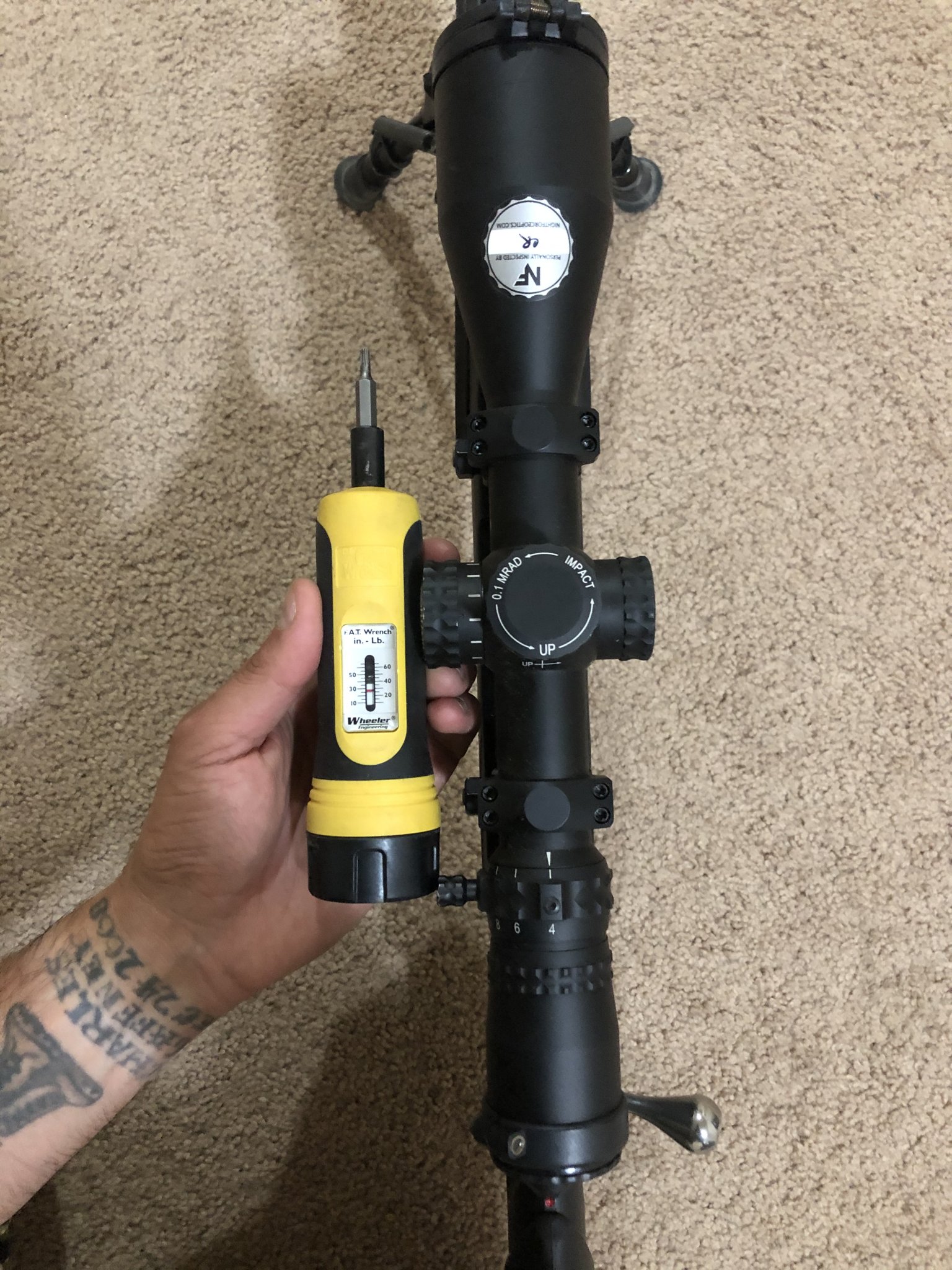

I have Purchased and tried several different rings and had the same results. The optic has been re-mounted several dozen times including a bunch by a night force dealer using the exact same tools they use set to the same torque settings.
The optic has been back tonight for twice now, only to be sent back as “not defective.”
Night force blamed me, the other gunsmiths, and their own dealer not using proper mounting procedures as the issue. It’s not rocket science. Their dealer mounts hundreds of scopes a year without issue.
Today I took my suppressed Tikka T3 X chambered in .223 out after getting the NX8 back. Same shit as the past year. It really is as if the scope is moving despite everything having been done exactly right countless times. A lot of times I will get two impacts touching or nearly touching, and then one flyer several inches away. Sometimes I will even get a lucky sub MOA group, but the vast majority of the time the groups are between two and 6 inches.
Im not starting this thread to bash any companies or start a fight. I seriously don’t know what else to do at this point and it seems I have a $2400 paperweight.
Night force has said it’s fine twice now and there’s nothing left they can do. Advice?

what Rings and mounts are you using? When you swap rifles are you using the same equipment? Have you tested the scope for tracking? how often do you make adjustments or was the scope zeroed and you use hold overs? For me, when ever I have a flyer its usually is my error.
post pics of your groups with the use Of both scopes.
Both NightForce rings and 20MOA base. I have tried every combination of “equipment” and it always ends up being isolated to the scope itself.
you are way beyond the point that I have even been able to get to. Zero it at 100 yards and don’t make any other adjustments. Horrible shotgun groups. I’m pretty good about being able to tell when I throw a shot. That’s not the issue. Did you read what I wrote? It has been shot by many experience people it’s not shooter error. [/QUOTE]
Let’s start with this. What does terrible accuracy mean? are groups moving or they opening up etc.
Erratic groups that are all over the place. What should be consistent sub MOA groups are 2-6” consistently.

was your POA the same for each set? Also did you make adjustments between shots or did you use hold overs?
Have you tried a Spuhr mount yet instead of those nightforce rings? I noticed your name and recognized it from your first thread on having issues with shooting a magnum rifle and how the scope had been moving in the rings. If a Spuhr mount is a little too rich for your blood, I would get some rosin powder and try that. Otherwise if you dont want to do that, call Doug and he should get your squared away.
[/QUOTE]
Sorry, those targets don’t do much without an explanation. Over the past year I have dozens if not hundreds of targets very similar to what I posted. Usually the POI is in the same general area. If it’s a little left and low I don’t bother making adjustments for my groups as long as it’s on paper etc. that part usually stays fairly consistent. The groups are just ginormous. As I mentioned pretty frequently if I’m shooting a three shot group I will get to that are nearly touching and one way off in outer space. Many times the group is just giant for all three or more shots.
The scope is still acting as if it’s moving in the rings. It definitely showed signs of moving before. I just do not understand how it could possibly be moving after having so many people do it to the right way multiple times.
The only trend I’ve seen is the two shots super close and one out in the middle of nowhere. That makes me think occasionally the scope does not move giving me a sub MOA group until the third shot where it moved ruining the whole thing.

@IdahoSpud Post a picture of the scope in the rings please.
Here are some pictures

I’ve used two different complete sets of NF rings and screws. No the objective is not touching the barrel. It has plenty of room. Nothing is visible inside. It is properly leveled.

I'm betting something is loose either on your mount (not the rings) or inside the actual scope. Have Doug talk to them for you as he'll get them to do more than put it through a tracking test and stick it back in the box.
why can’t they ship it back with rings? that is bs.
question for nf pros...is there suppose the be a small gap between the rings.
Bad pictures. There is a (Very) small equal gap.

Correct me if I’m wrong, but a tracking test would be hard/pointless to preform if the optic won’t even hold a basic zero first.
No, same scope from the start. NF first said it was slipping in the rings, no other issues, and sent it back. So I made damn sure the next mounting procedures were 100% on. Same issue. Bought brand new rings and remounted again exactly as supposed to. Same issue.
I sent it back to Nf a second time and they shot it, said both ring sets and the optic are fine, and sent it back again.
Something doesn’t add up.
