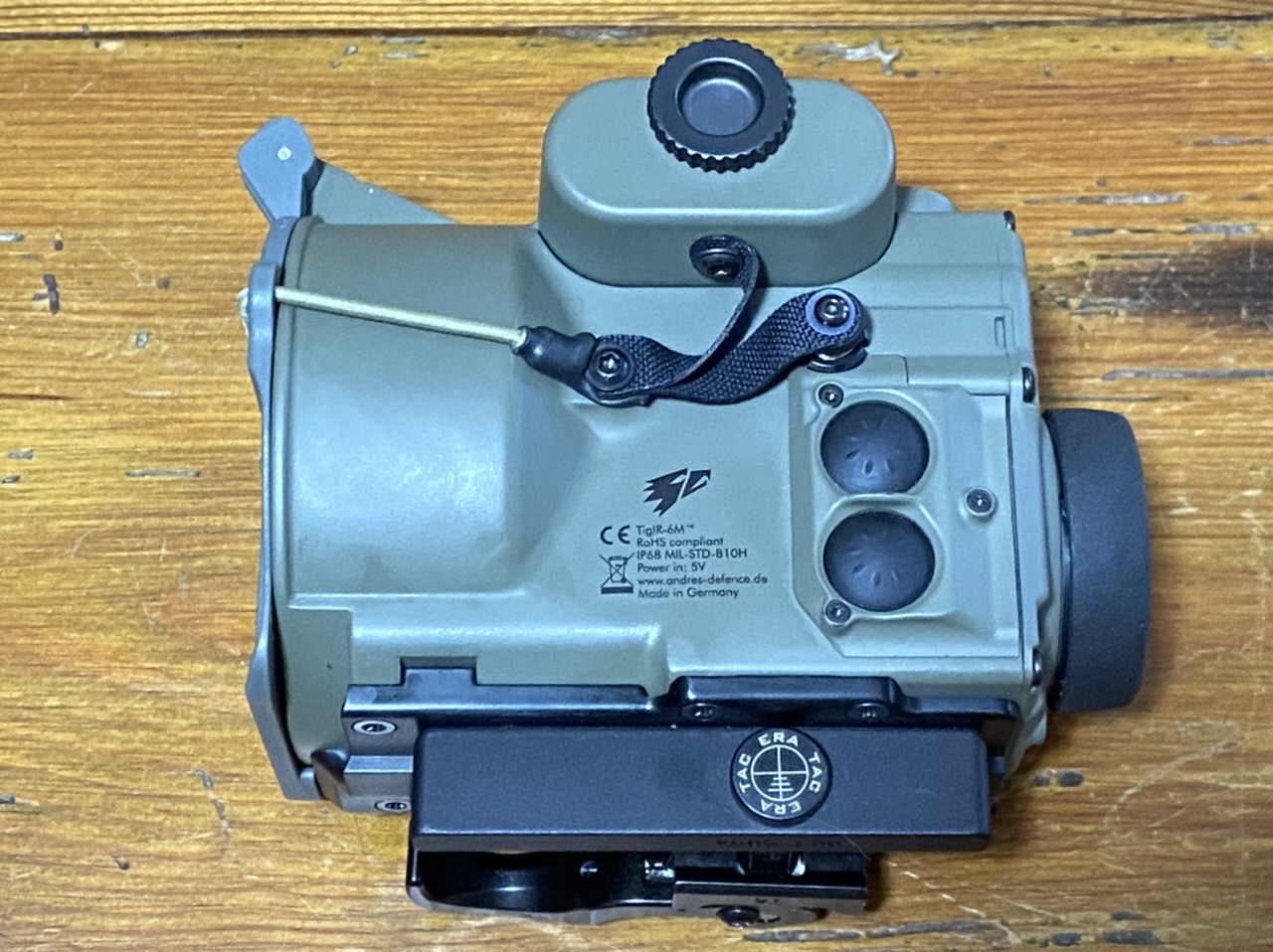

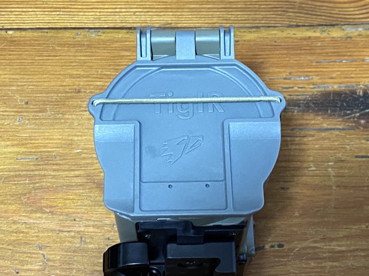

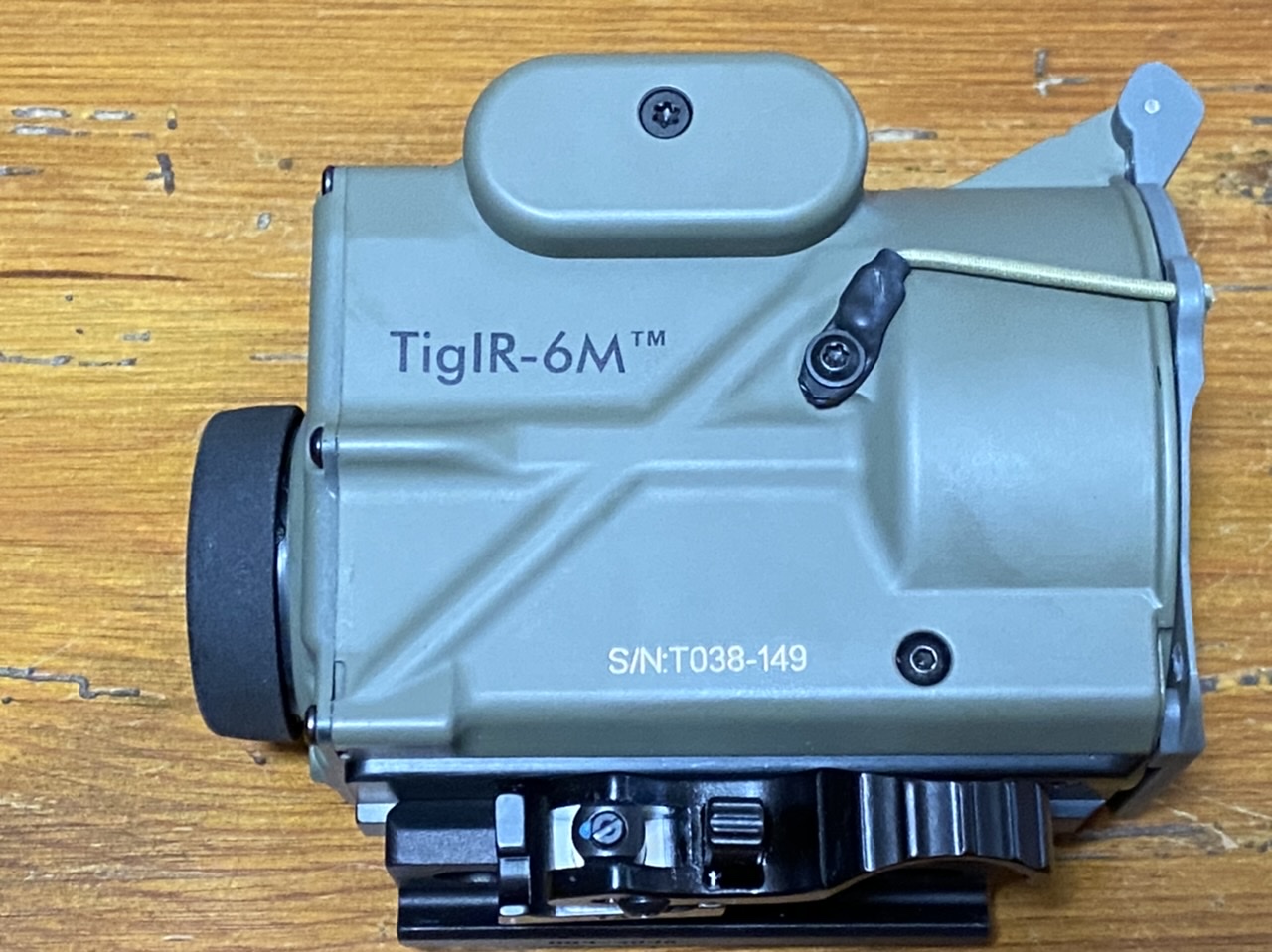

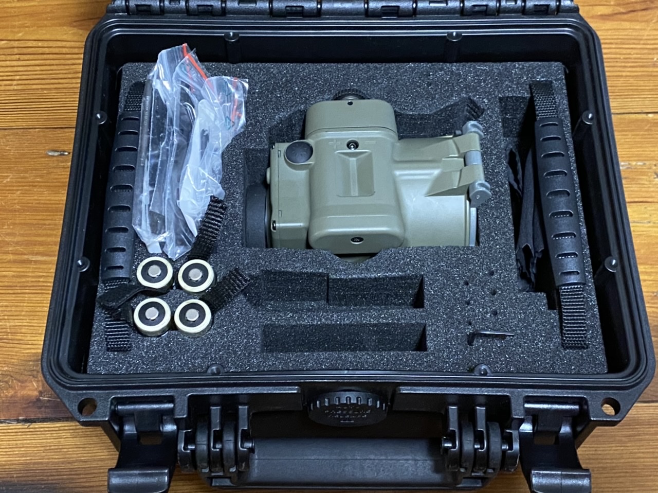

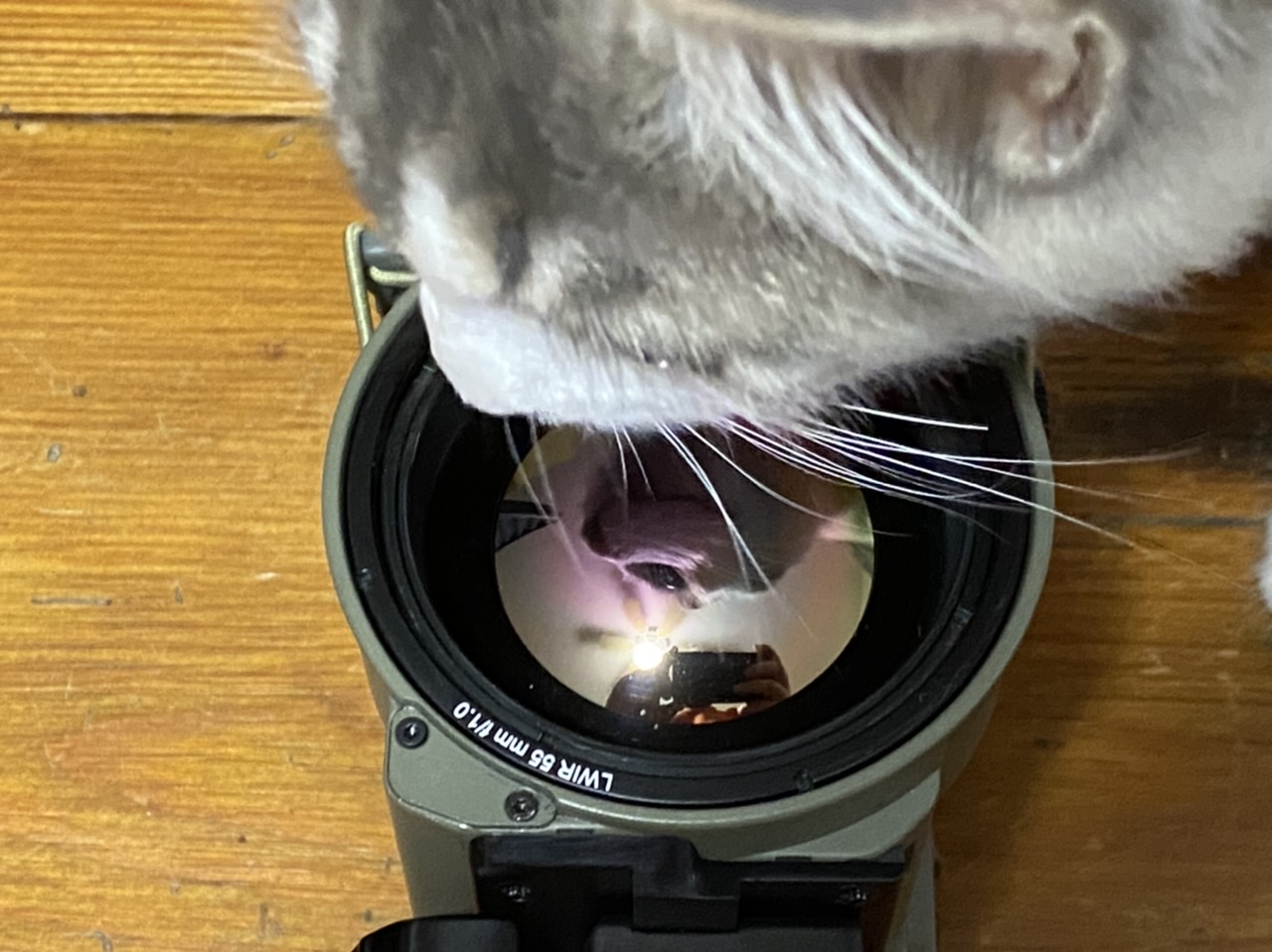

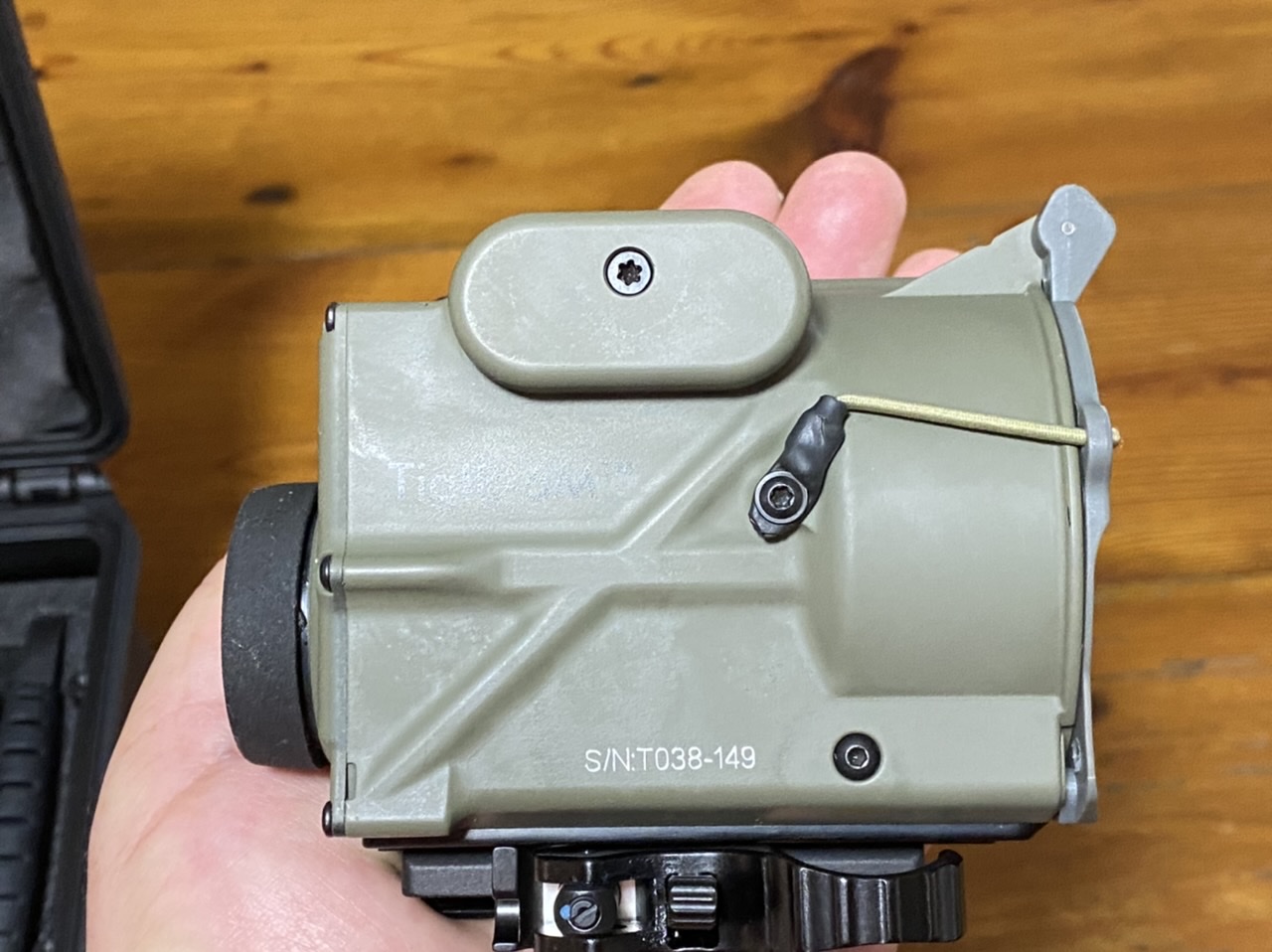

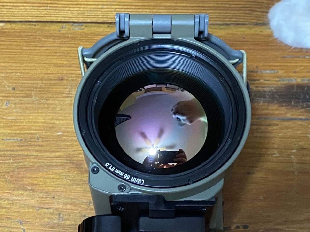

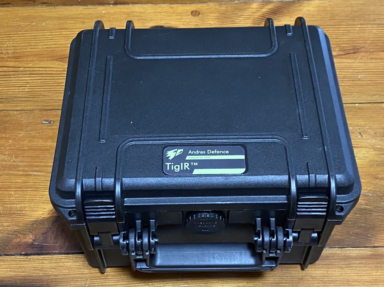

It’s (finally) here.
Nearly 5 months after dropping $12K, this just arrived today — our first day back from Kenya.
Ordered/Paid-in-Full: AUG-2020.
Arrived: JAN-2021
Will report tomorrow night after I’ve had some time comparing it to the UTC-Xii.

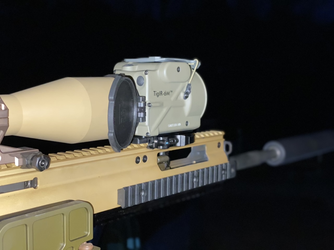

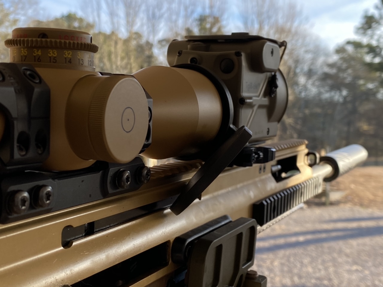

Bro . Your mount is backwards. Dafuq
Those bolts + Your knuckles + SCAR charging handle = Words that will get you banned from church...Bro . Your mount is backwards. Dafuq

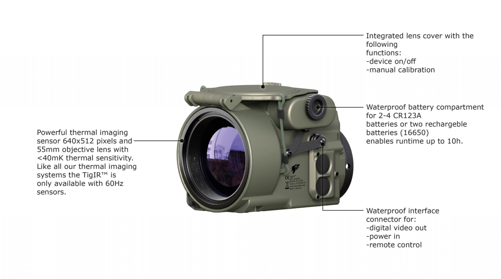

This thing has some seriously N.I.C.E. features:
1) Flip-up/down objective cover also turns unit on/off (no buttons)!
2) TigIR has internal shutter/NUC!!! AND, it’s virtually silent and super-fast!
3) Based upon VERY premature observations, the display looks just a hair nicer than the UTC.
4) Built like a tank.
5) Love the ERA-TAC mount.
6) Kit comes with multiple different mount height adapters. 1.35-1.95” (give or take) and everything in between!
7) Crazy number of color pallet selection. I can immediately see where “Hottest” will be my new favorite pallet (I’ve been a lifelong die hard black/white hot devotee... until today!)
LOTS more to come!!!

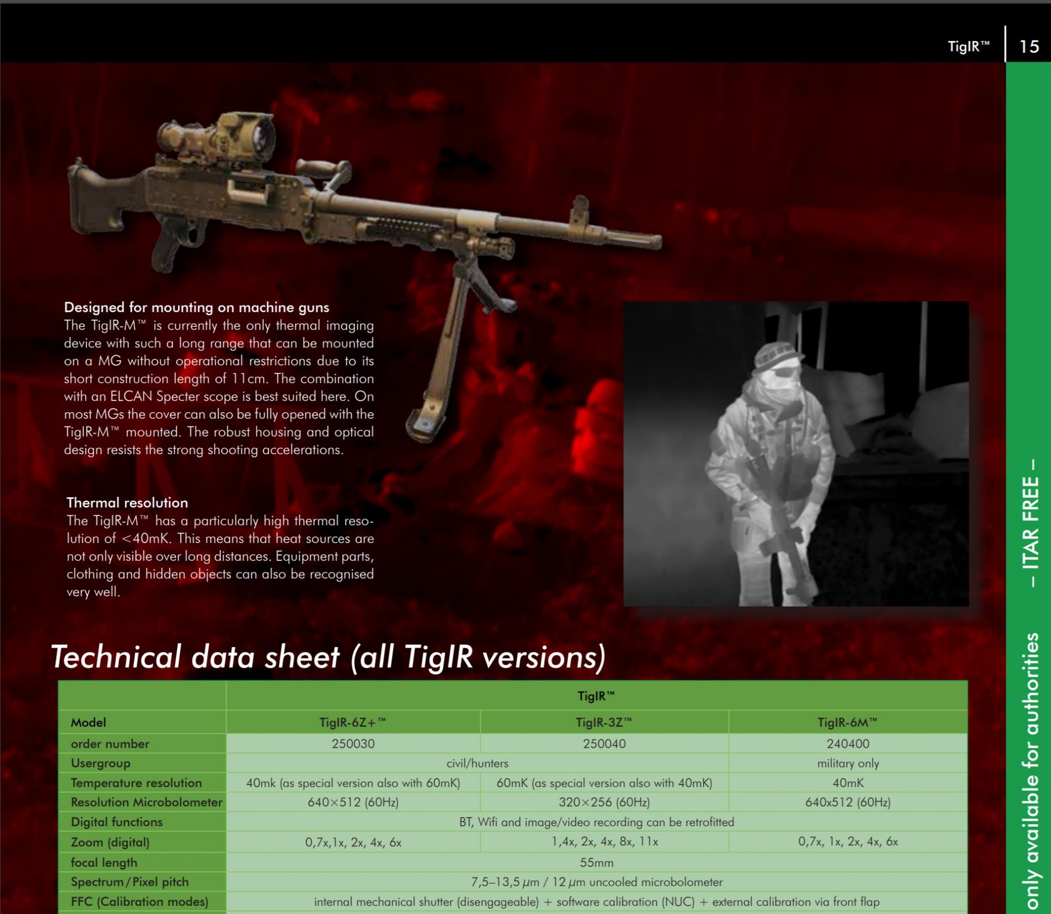

Do you know what the exact difference between the 6m and 6z are in terms of the unit and the kit? I’m getting some conflicting info online.

found this on the 'z', but imagine a lot carries over to the 'm'
Where did you buy the M from? They are trying to sell me the ZFirst, don’t confuse Tilo and TigIR. They’re radically different.
Second, AFAIK, the Tig 6M and 6Z are practically identical in terms of basic bits. The 6M is more ruggedized for .MIL use and is legitimately MIL-STD-810H certified, where I do not believe the Tig-Z is. Also, the M has both a reticle and pic rail mount, which as I understand can’t just be stuck onto the bottom of the Z to make it an M.
