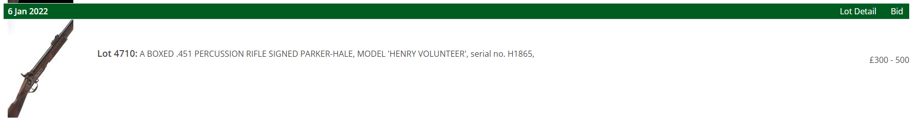

Back to the Hungarian guy - he has bought a .451 Volunteer rifle and here is shooting 900 yards with it - well worth the watch. Dud wind calls notwithstanding, he manages what looks like 2 moa or slightly better off his elbows at 900 - with a 170 year old rifle.

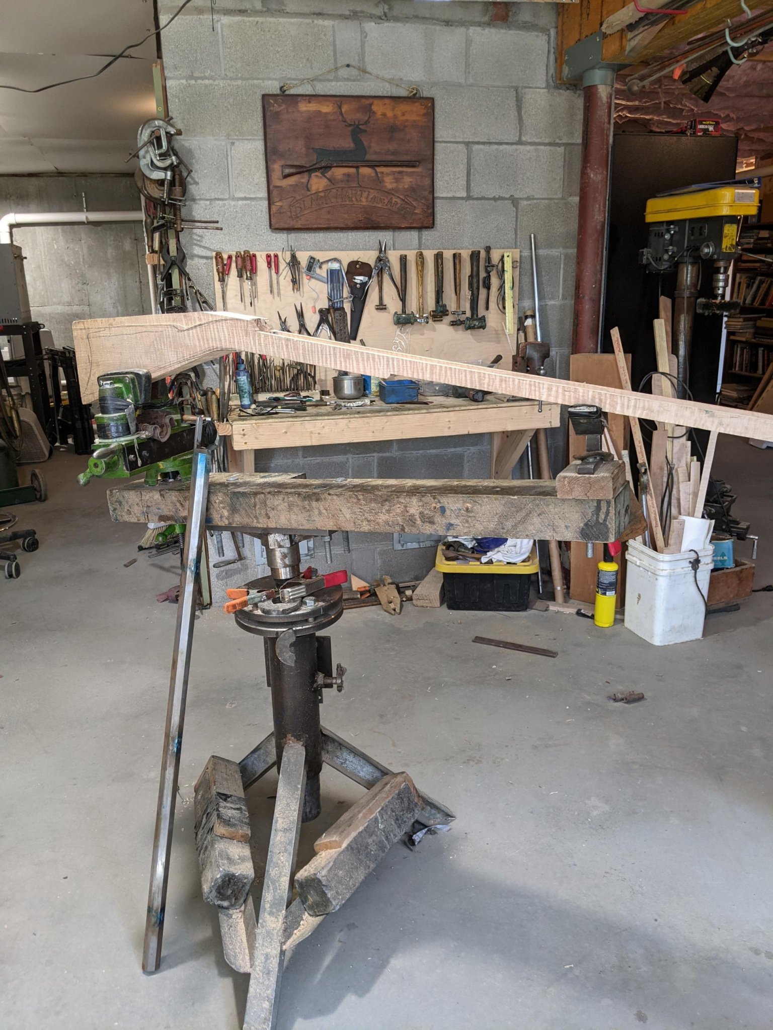

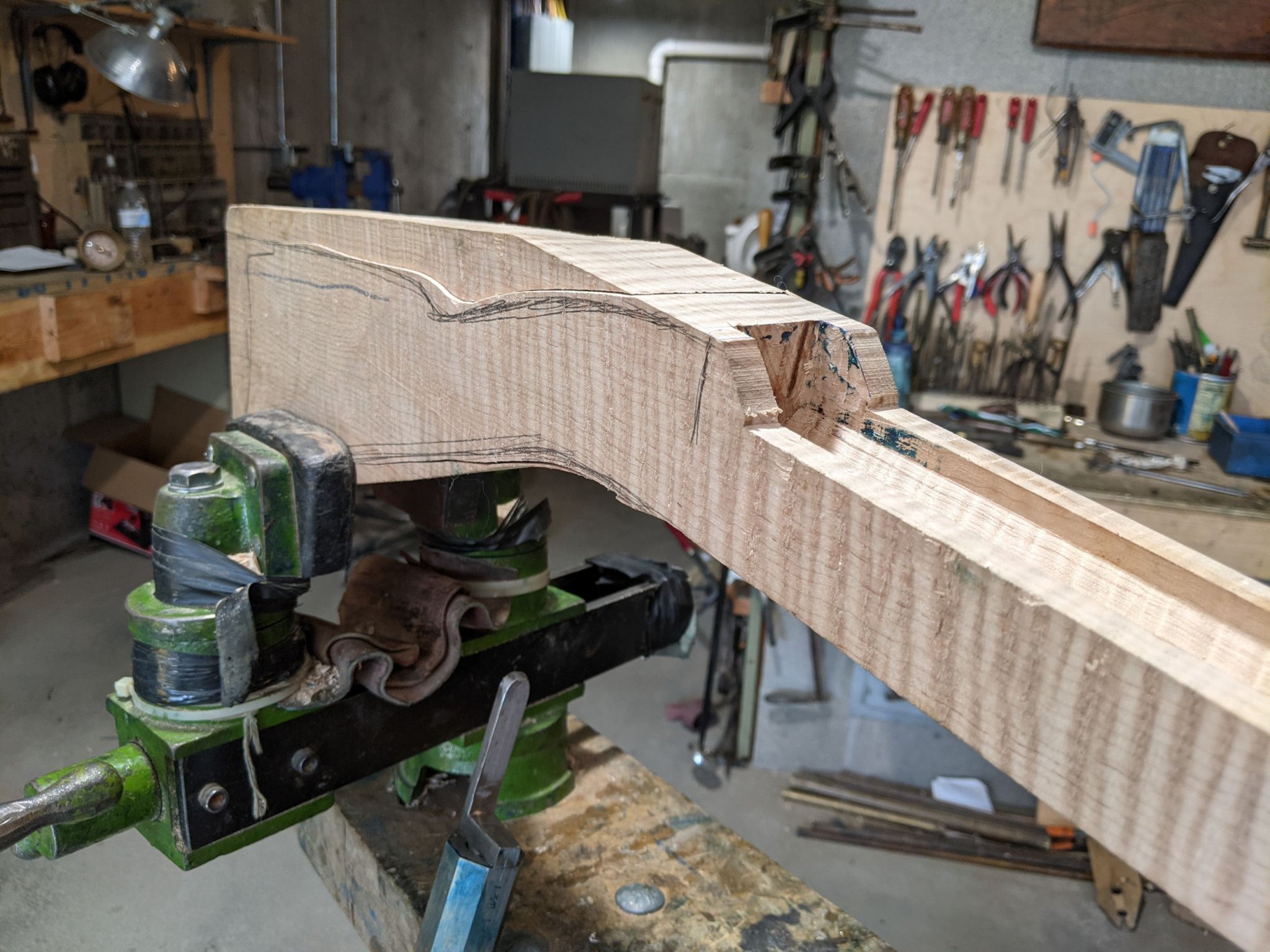

Was going to put this in Vintage, but since Sean started this fine thread… I’ll post here.
Project that had been ‘in the works’ for about three years has started as of last week…
Took a while to accumulate the necessaries and get in a good barrel.
There have been a number of debates about Hinsons projectile and, no, his mold has not been found that I am awaren of. The book describes it as a minie and not as a Whitworth pattern hexagonal bolt. And having had his rifle made locally, I suspect it very unlikely that they used a Whitworth barrel. The Marine Col who wrote the book is a “gun guy” and did extensive research including examining the actual rifle. So the book is, so far, about as definitive a record as I have come across so far.
Been Hinson’s stomping ground, which is right around Fort Campbell. But not his grotto. Now the “Land between the Rivers” is the “Land between the Lakes”. So much of the real topography is lost to the TVA. Might try and get to his cave on a trip there this fall. Make an interesting get-together if anyone is in the area.
There is a monument, btw. I’ll dig out the picture we took there.
In the mean time… These kinds of build pictures will have to suffice until a range report comes in.
Cheers, SirhrView attachment 7669676View attachment 7669677

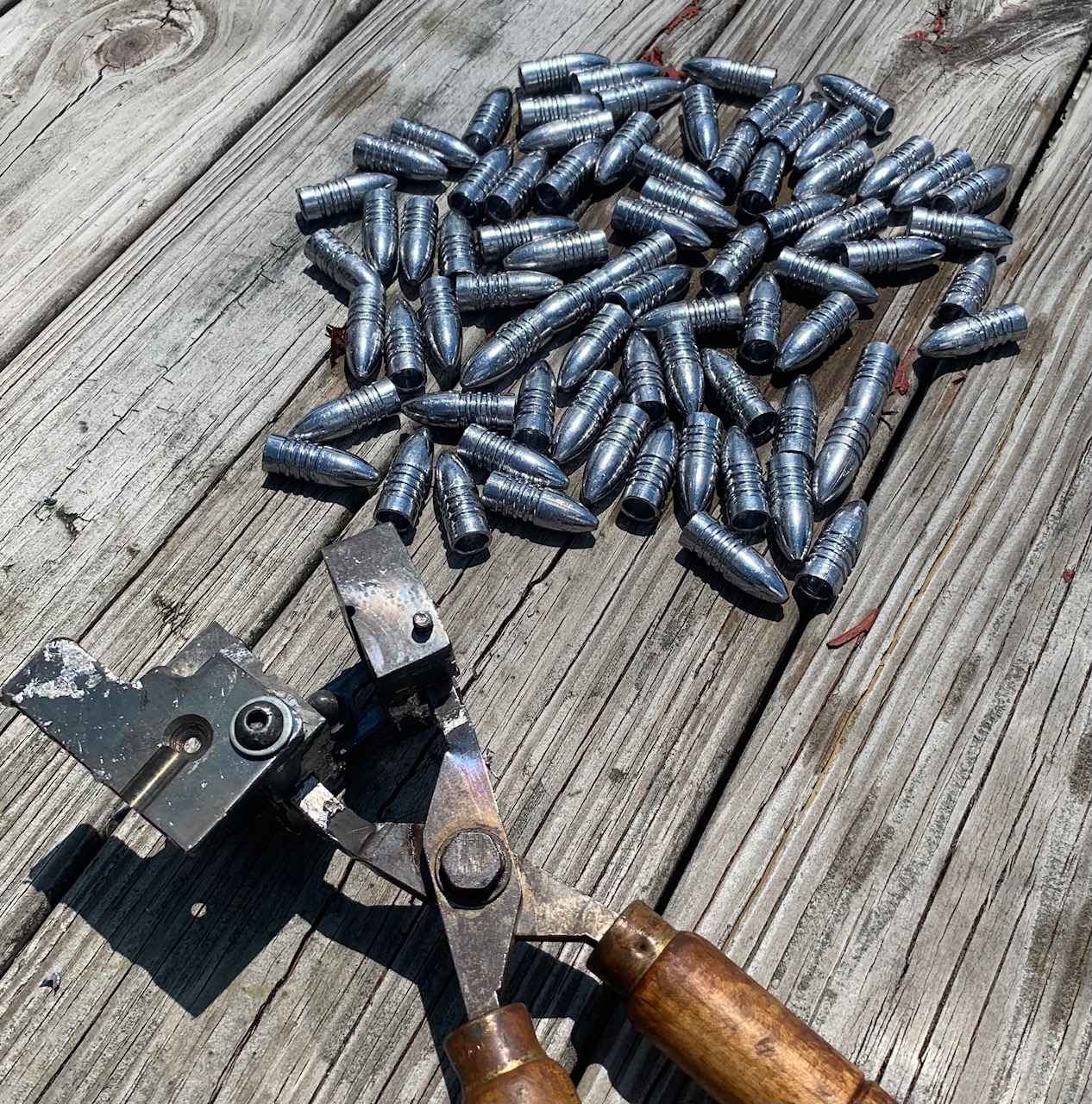

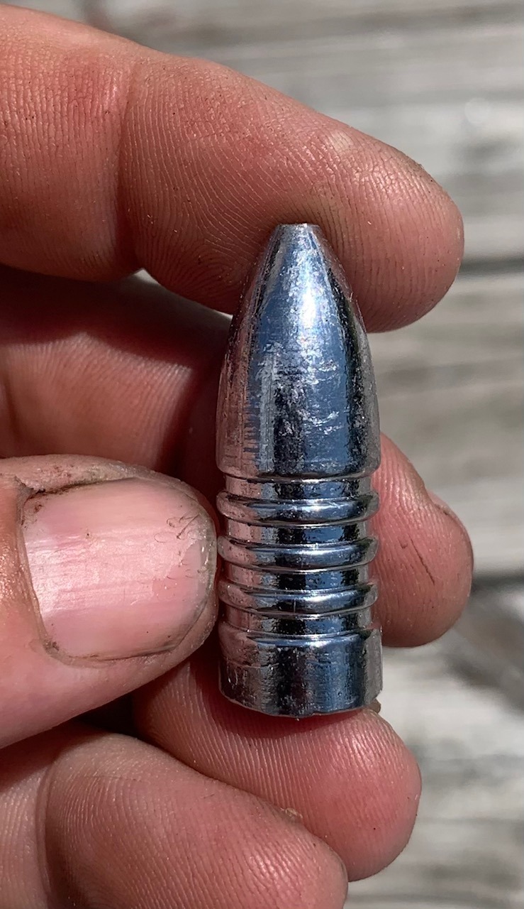

Got some casting done today for the Hinson rifle.... new barrel arrived at gunsmith. So needed the Tennessee-style long section minie's c. 1860...
Used a steel Brooks Nose Pore mold, custom made in .50. Mold took some getting used to, but once figured out, it produces very nice boolits!
More to come soon!
Sirhr
What alloy? 20:1 or 30:1?
Mould might need to be a little hotter. Some 2 stroke oil on top of th blocks will help with lead smear. Just don’t let it get into the cavities, lol.
Pure lead.
I think I could do some beeswax. Main problem was keeping mold hot, as you note. Might set up a hotplate ffor it. Also, keeping mold clean was a challenge. These will be OK for purpose. But I'm with you. I think I can do better.
