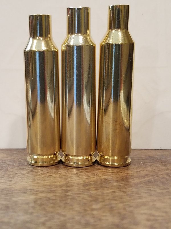

I ended up with a piece or two of what resembles of being 7mm saw after last years Lone Survivor match. A friend sent what he thought was some my 7mm Ackley cases but it's not. In the pic left to right is a 7mm-08 Ackley, middle measures and looks to be the saw case and on the right is a standard 308 palma case which both use. Can't say I see the velocities claimed but I've not seen performance in person.

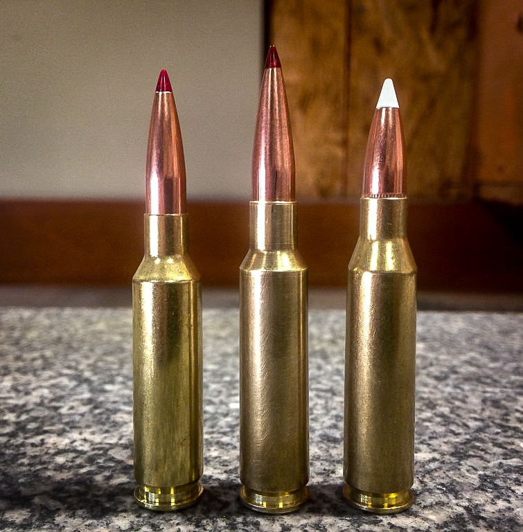

Left to Right: 6.5 Creed, 7mm SAW, 6 SLR

All comes down to case design and how efficient it operates. I had planned to go the 7 SAW route but decided stick with the vanilla 7-08. But I did tighten up the neck on the reamer.
The SAW caught my eye from the fact there’s no drastic case forming and you’re getting the benefits of a SLR/Creedmoor case design.
