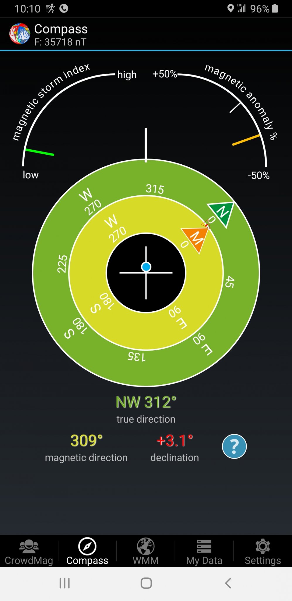

I have been using an app for a while to determine what's "normal" recalibration and what is not. Surprisingly I have found it be very useful. It is a NOAA Which gives me my true magnetic declination, but it also does something really cool in that it measures Magnetic Anomaly percentage. Or how much interference the compass at that location is experiencing. For instance turning it on right now sitting at my desk, I have a -25% anomaly rating and a "yellow" caution indicator. I try to only calibrate when the anomaly percentage is near non existent. This has proven useful.

@DocUSMCRetired , what compass app is that you're using? available on Android? tried to search on Play but could not find a similar/same interface.
