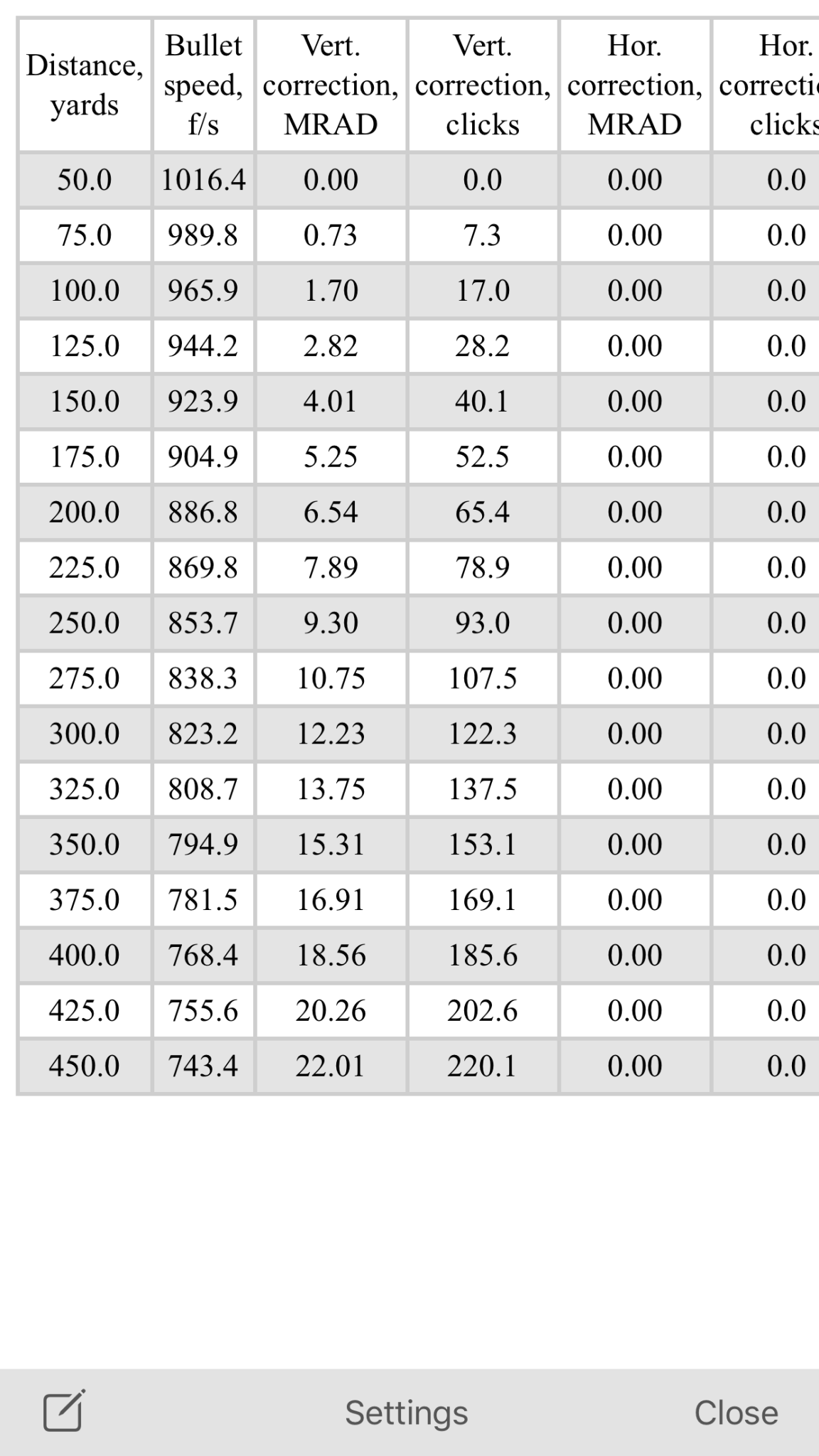

I apologize if this has been covered, I tried search function with no success. I am struggling to find an app that is even remotely close for my Vudoo shooting center x. I zero at 50, verify fps ( average is 1080 FPS of 10 shots). At 100 all apps, Strelok, lapua, and Hornady all call for 1.5 mil. My impacts are .5 high. If I use validate function in Strelok (Not pro version) it bumps FPS to 1380. Now I go to 200 and it calls for 4.2 Mil, I need 6 mil. I validate That and it throws everything off. Hopefully you can see how this is a never ending battle. I keep resorting to shooting targets every 25 yards out to 350 and writing down data. Is there an app or anything most people prefer and have success with? Any tips or anything I’m over looking? I’ve even played with bc from .169 -.132 and no success. Thanks

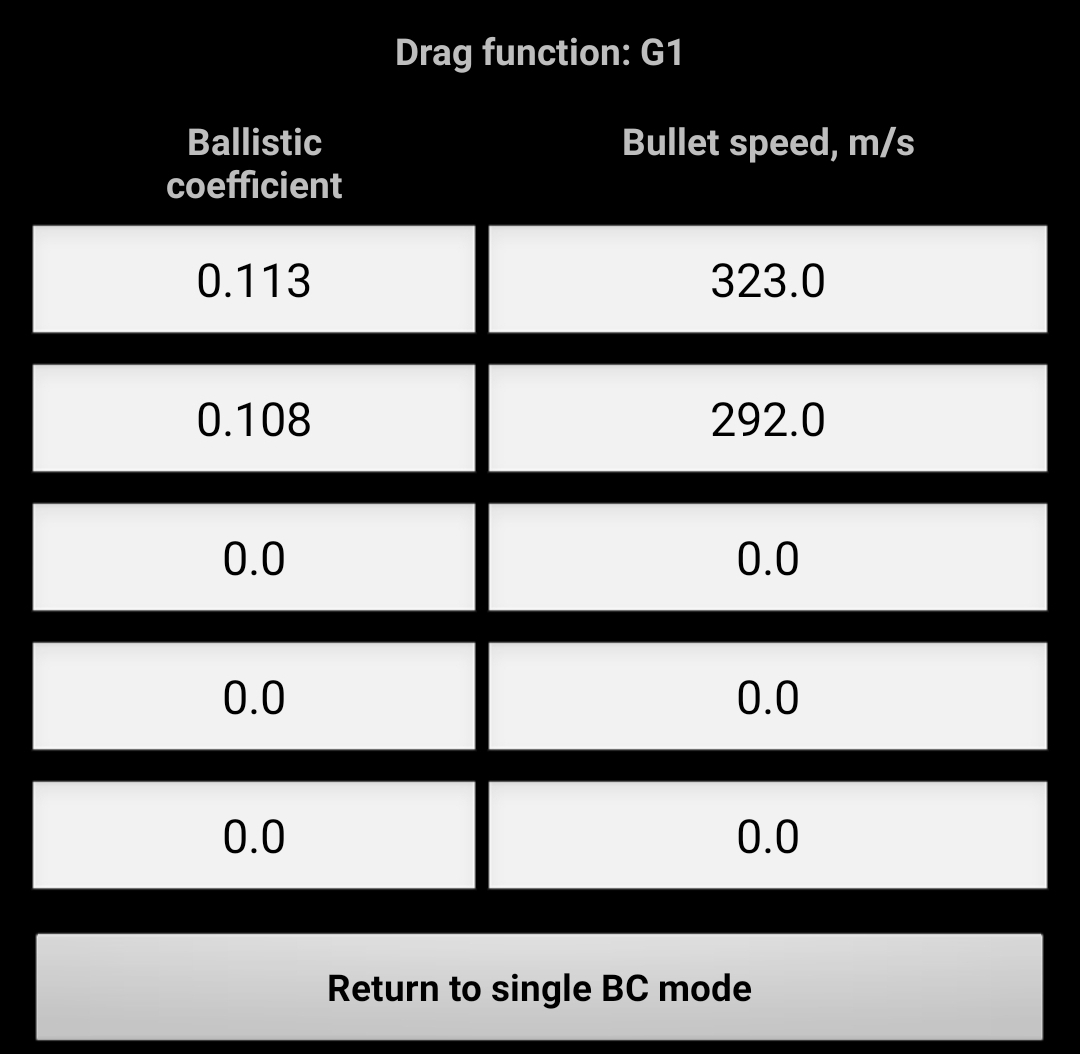

Strelok Pro should do the trick with the multi-BC function, which is basically the same as DSF on kestrel, only it is more editable afterwards.
I use Kestrel because I noticed atmospherics and temperature were very important for long range accuracy. Kestrel has long battery life which my phone does not always have.
If you are fine with phone and plan to use Strelok Pro, I suggest you turn on and configure multi-BC, zero weather, powder temp and let it fine-tune your shots from there on by the data you give to it. This will take some time to gather.
For reference of the changes made to trajectory make another profile without these functions and see how it differs.

I would like to point out that while Strelok multi-BC works wonders to trajectory, it is quite cumbersome to set up, to my experience changing one parameter changed the whole trajectory because it works by different logic, not by changing POI of the bullet at certain distances but by changing drag.
Of course in reality it is the same end goal but Kestrel seems to get things right easier. Maybe I just was too novice with the strelok.

Not really an answer to your question, but I shoot center x in my bergara and am averaging about 1080fps, like you. I have a 50yd zero, but my drop at 100 is about 1.7-1.8mil. This matches other guys I shoot with that use center x. Your result of around 1mil of drop seems very high. As someone else mentioned, you might try reconfirming zero and checking your scope tracking, if you are dialing.
Oh, I should have added that I am using StrelokPro and used the bc truing function to match my 100yd drop. This calls for 6.6mil at 200. I think I used 6.4mil to hit a 8” gong at 200, since the weather was a little different than my dope data. I didn’t get to see where exactly I was hitting, since it was a stage in the match. So, try truing the bc. I ended up with a G1 of 0.173 to get reasonable data.

would you mind sending me a screen dump of your Strelok 'table' and' details' ? i would have expected your correction to be closer to 2.1 than 1.5 ? Anyway if you send /post your 'details' i can see if i see anything odd compared to what i have

Hail, I think we need to revisit this statement and make sure we are all on the same page. You plugged in 1080fps and the used/plugged in the Lapua CenterX BC and got a 1.5mil holdover, correct? And with that holdover, your impacts were 0.5mil (or inches?) high?
As a check, I downloaded Lapua's ballistic software and used 1080fps and whatever BC they had already in there. With a "sight-in" range of 50yds and 1080fps I get 1.8mil holdover at 100yds. This matches what I get with Strelokpro and what I experience +/- maybe 0.1mil. The error I see at 100 is possibly temp, humidity, or slight error on my zero from day to day. I honestly haven't done a lot of exacting work to confirm that my 100yd dope is withing 0.001".
Now, back to your situation. I don't see how any of these programs, let alone several of them, are telling you 1.5mil at 100. 1.7 or 1.9 I would believe, since I have seen anywhere in this range while messing with zero weather conditions, scope height, etc. Never anything as low as 1.5mil except with ammo running well over 1100fps. Even harder to understand is how you dial 1.5 and are still hitting high. You should be low by an inch if I did the math right -> 3.6"/mrad x 0.3mrad.
