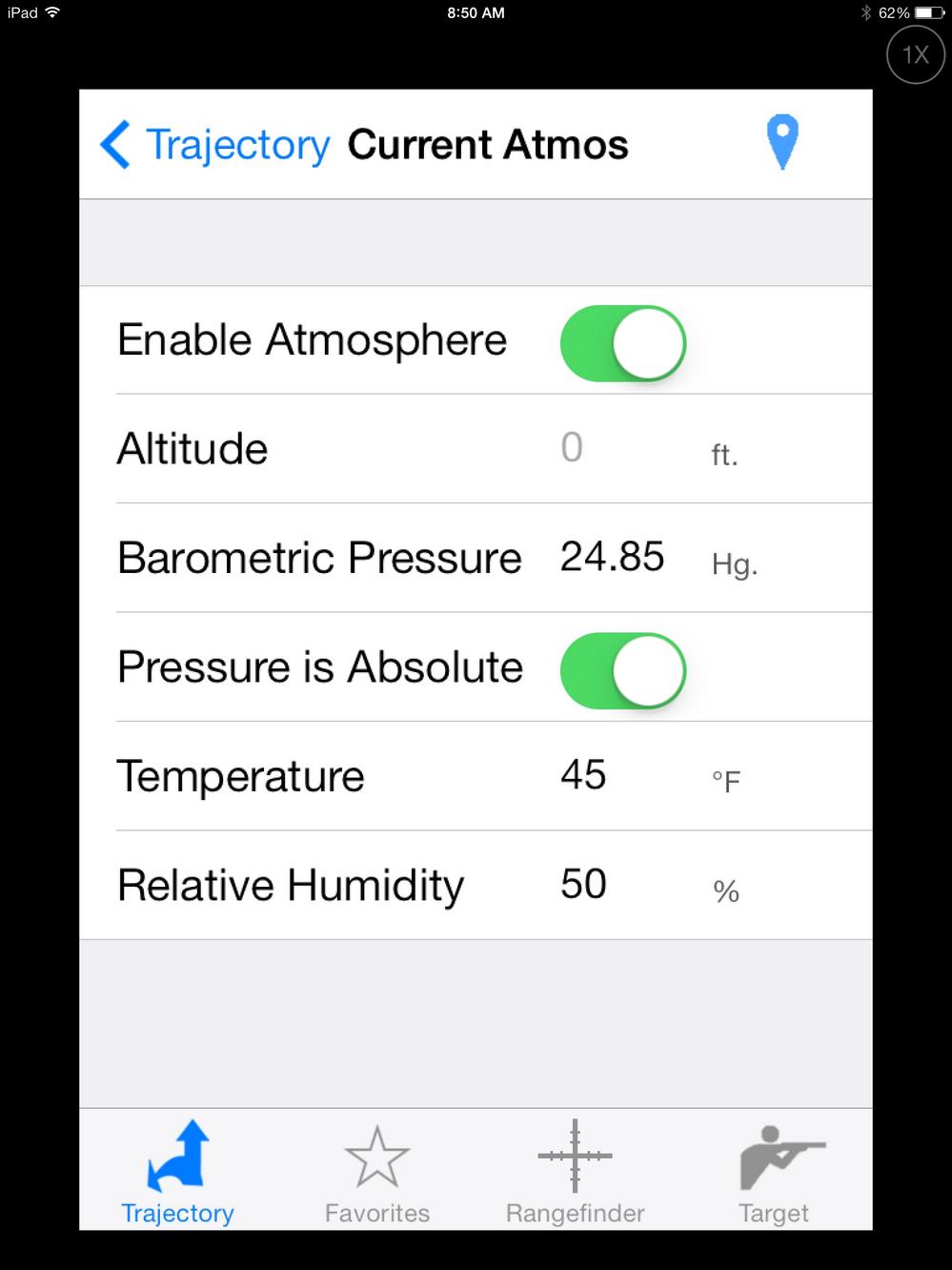

See no altitude
Your lack of comprehension in this matter is not a vindication of your position.

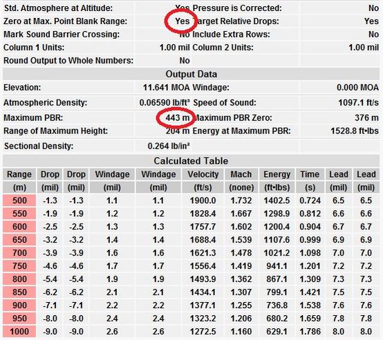

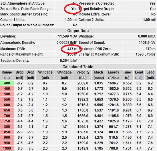

First Papa 30: the runs you did have one fatal flaw in the input data - this is a rerun I did here on your corrected version:
This is a run of your UNCORRECTED data:
Now, you have set the software to CHANGE THE ZERO TO THE PBR.
Therefore, one set of numbers is with zero at 447 m and the other at 443 m
That makes quite a bit of difference, believe it or not.
What would not have changed the result is if you tabled the total drop rather than the correction - ie turn off "Elevation Correction for Zero Range" (you also switched to standard atmosphere which made most difference - see later post).
Then the solution shows -11.9 mils of drop (corrected) and -12.4 (non corrected) (note:this is line of sight, doesn't matter what your zero is).

As you see above, at 5000' the standard model assumes it's 41.4F. But if it's 80F, you are 0.55 mils out.
This is what is causing the some disagreement between the people above.
Some people clicked "Standard atmosphere at altitude" and it uses 41.4 - which makes 0.55 mils difference.
Changes in the weather makes differences to the range of 0.1 or so.
So, you're both right. :)

At Rifles Only which is 78ft above sea level, in one day we saw a swing in Density Altitude from 3000ft above sea to -2000 ft below sea level. (5000ft) That was in a 24 hour period. No altitude change, but a combination of a front with a drop in temperature. Pressure & Temperature.
If a shooter uses a Kestrel... in order to accurately read Density Altitude you have to use STATION PRESSURE. (This is uncorrected) Station pressure goes below the recorded barometric pressure (corrected)
We are shooting NOT READING THE WEATHER ON TV so we want information that useful to us, without having to carry both a tool for altitude (GPS) and a tool for reading the conditions, a Kestrel. We choose to use a Kestrel so you want to maximize that tool and that information. Density Altitude is a great single number as noted several times including your Dan Thread. DA readings can be taken directly from the Kestrel however you have to set to 0 reference altitude and 29.92 which gives the uses STATION PRESSURE. Not corrected barometric pressure.
See the picture I posted, Denver is 24.92 (roughly) yet one hour from my house I can show as low as 18" ... using that number plus temp I can successfully use a ballistic computer and shoot. I have done this including zeroing a rifle in CO, and traveling to OR with a 4000ft change in altitude. However I did not use Altitude and still was 100% successful.

If I put it in just like he says, I get the .1mil difference (9.9 vs 10.0). The only thing that changes is with 29.92 the "pressure is corrected" box is checked and at 24.92 it isn't. Not saying that's correct, just that's how he got it. I don't really get what that proves though. It's just doing the correction for altitude sloppily by yourself vs. letting JBM do it when you can get the exact pressure to begin with from a Kestrel and not have to use an average, guess, or estimate for anything. I also don't get what that had to do with this discussion. If anything it proves that a Kestrel ISN'T a waste (which is what the thread asked about). I don't see why one would argue that using an average and a "close enough" altitude to work backwards is BETTER than a Kestrel. To paraphrase LL, doing it like that may work, but it's ass backwards.
Not exactly.
What I did was use the PROVIDED pressure 24.92 (absolute) at a range at about 5000 feet (according to the poster) versus using the altitude as the input to JBM with the standard corrected pressure, which is 29.92".
You can do the same sort of thing with JBM by using actual altitude and corrected pressure changes from actual weather sources. As I have mentioned, I ran the numbers based on the highest and lowest pressure at the Bang Steel range over a 9 month period. And also came up with 0.1 mil change in come up.
But the BIG ISSUE isn't weather pressure - it's TEMPERATURE!!!
