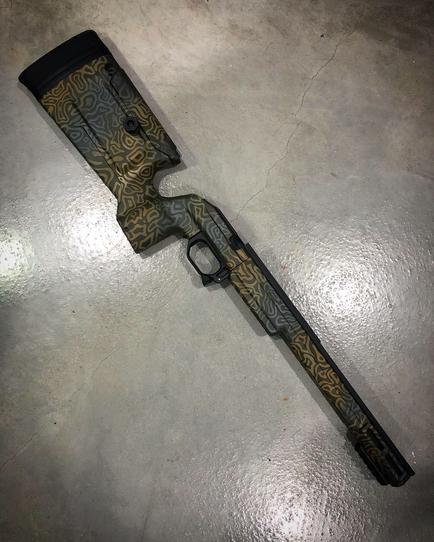

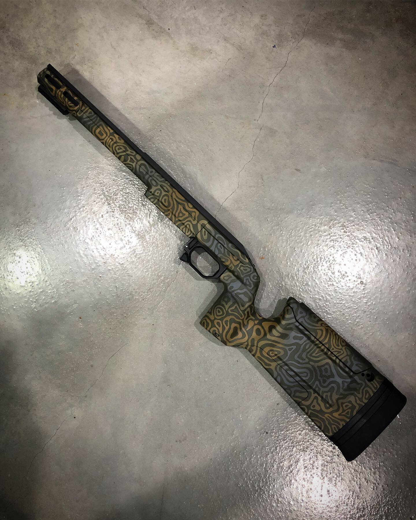

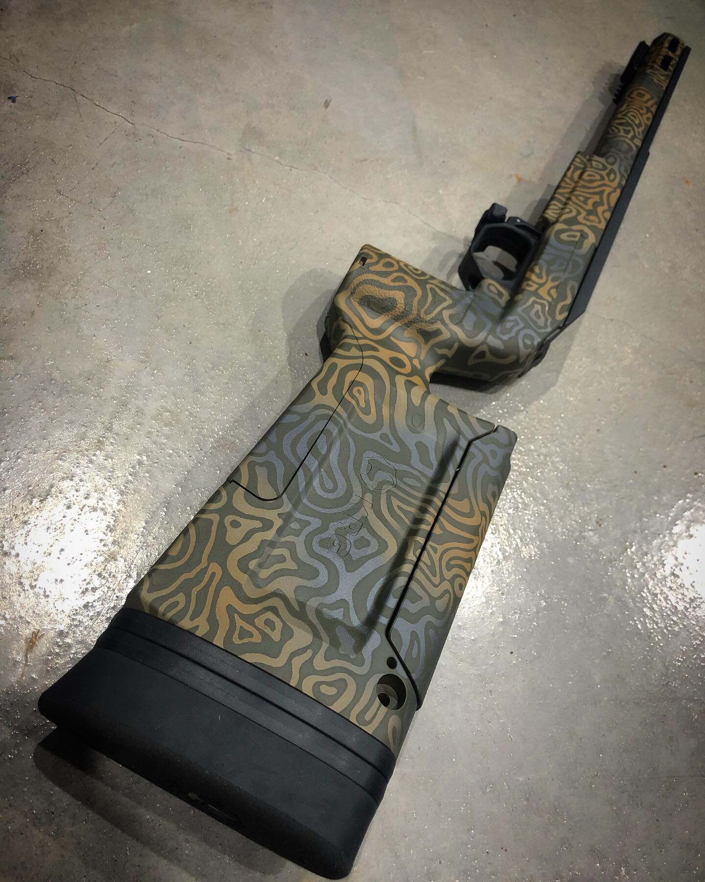

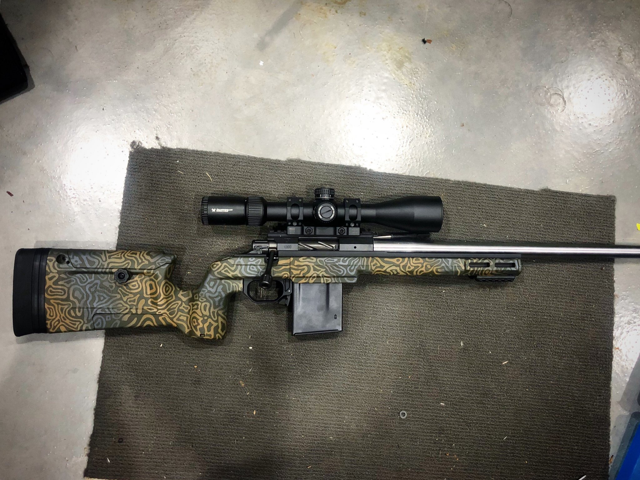

I finished up my Bravo cerakote last week - very happy with the outcome. 4 color “Topoflage” camo.

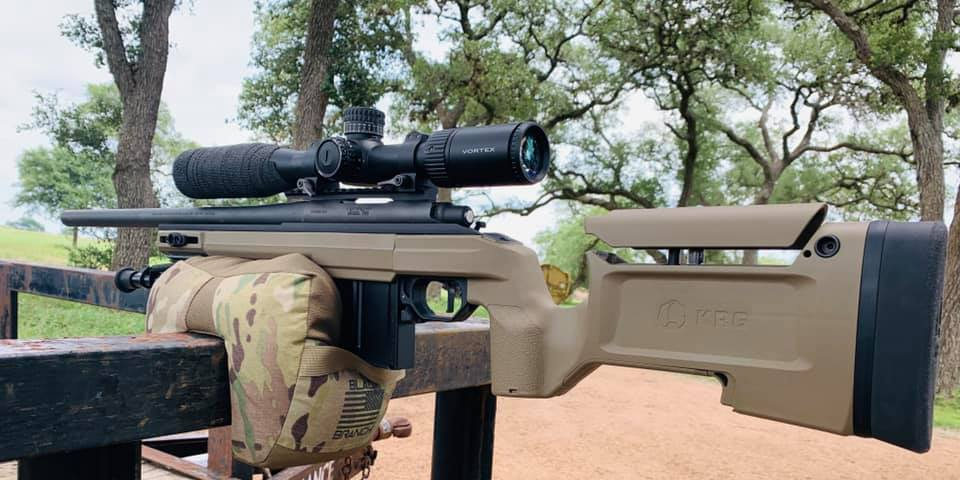

This build is a budget .223AI, KRG Bravo, Ultimatum U300, IBI Rem Varmint 1-7 15”, Triggertech Special trigger, Vortex Diamondback Tactical 6-24 in PMR rings. Should be a fun little plinker. Barrel isn’t chambered yet - but you get the idea.
View attachment 7099623View attachment 7099624
Ok that's a damn cool camo job!
That is awesome!

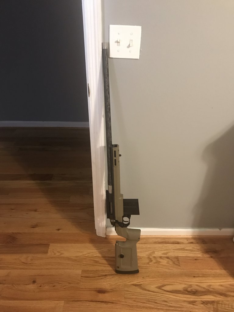

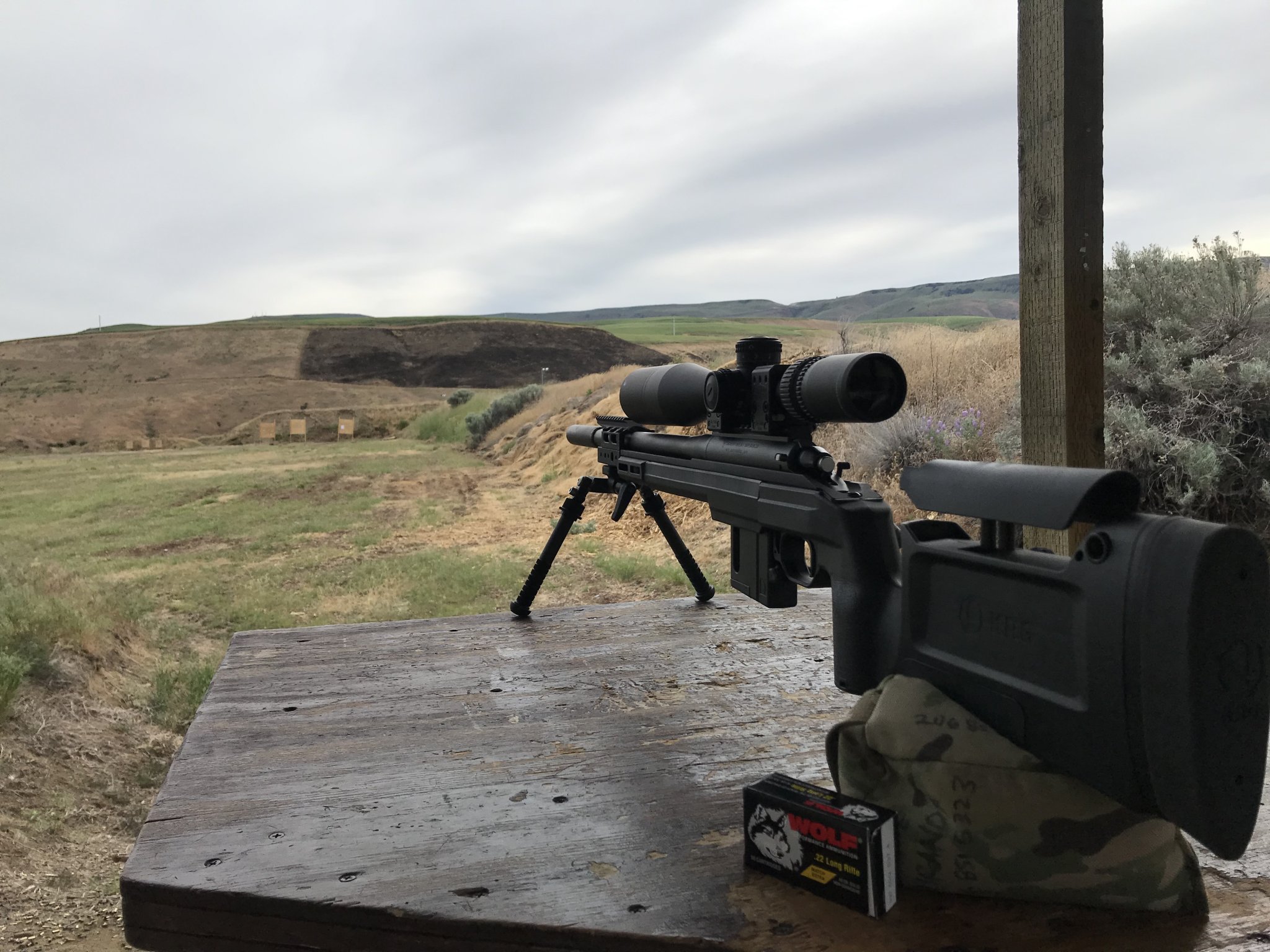

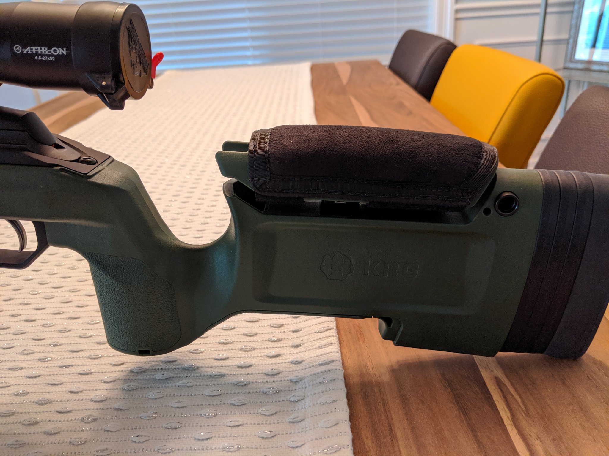

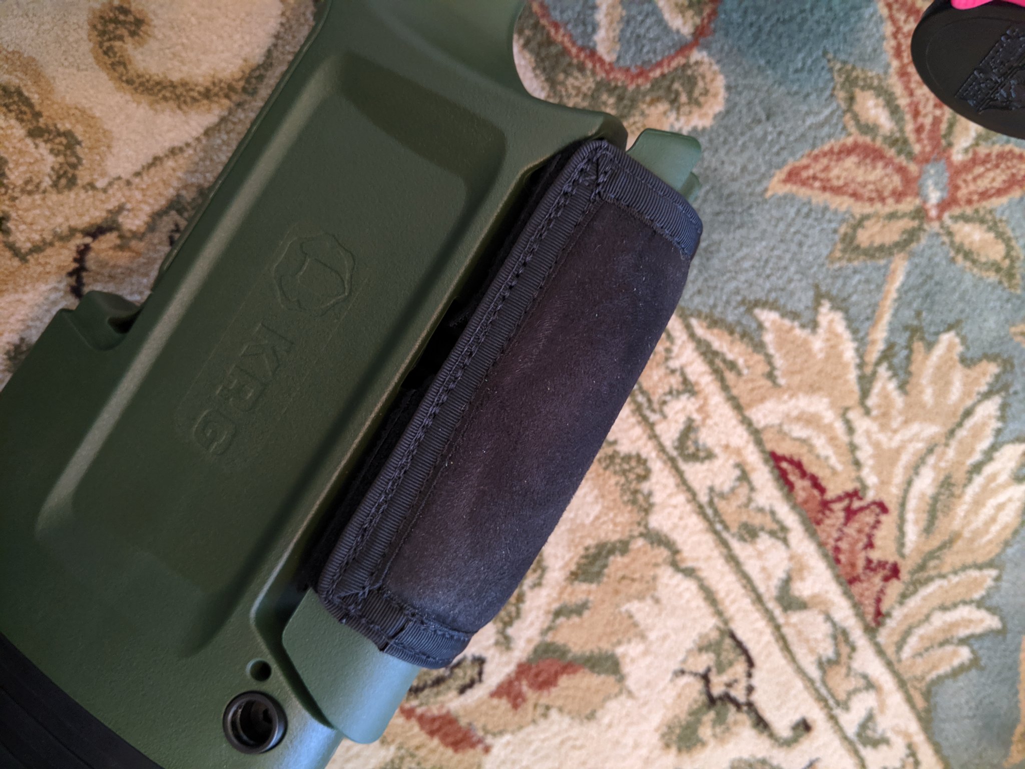

Mine isn't fully kitted out. Im trying to keep this build a bit on the budget and as reasonably light on the weight side as reasonably possible. I went out and shot it today, and I really like it. I need to put a spacer in the buttstock to increase the LOP, and I need to ditch these rings and bases (these were in the parts bin and Im impatient). Very comfortable chassis and the fact that it only weighs in at only 3lbs is a win for me.
I took it to 990 yards today. It looks like those measly 155gr .308 ELD-M's are getting out there pretty well.

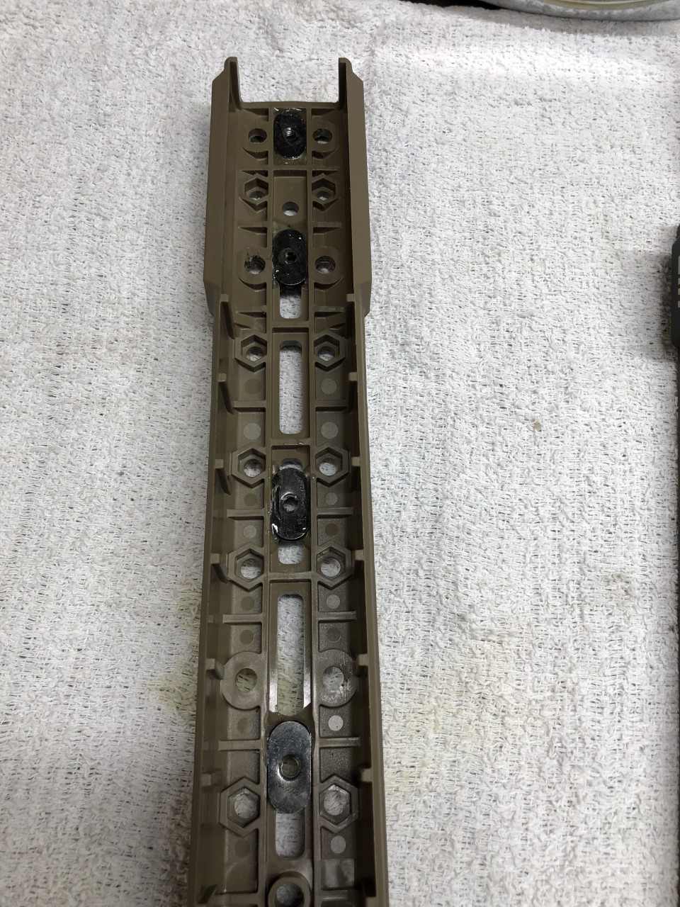

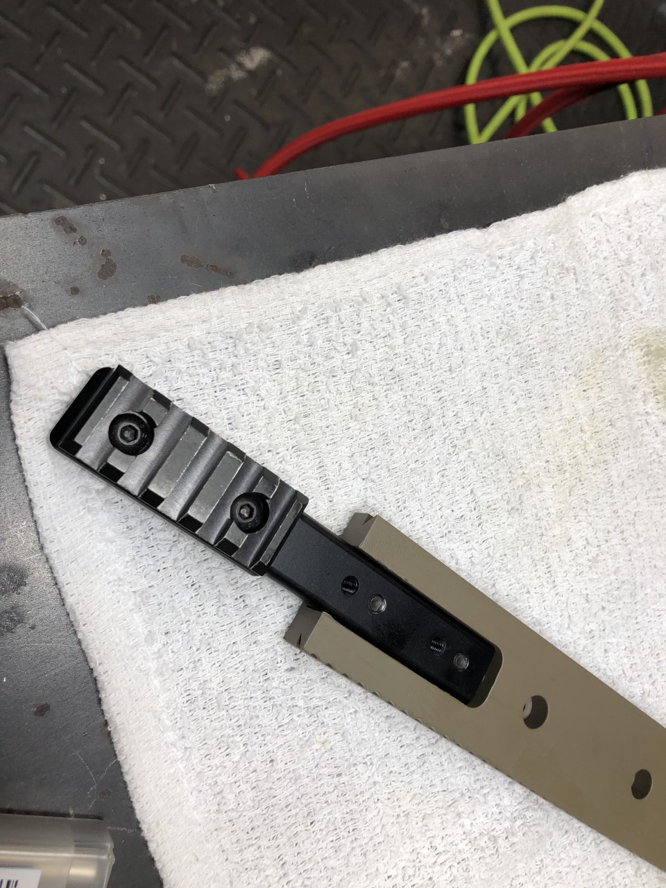

So I order a KRG Bravo in FDE a few weeks back. Had read that a guy on here was making a brass insert weight for the forearm that was actually pretty cool and priced reasonably for the work involved. But, I was bored and happen to have a awesome set of tools in my garage (dad was a tv repairman), and figured I'd make my own. I've got an Origin action and McGowan barrel coming for this in .223 to shoot local PRS club stuff and really did this just for fun. All time in is about 6hrs. All material is cold rolled steel. The spigot mount is an old one of an MPA chassis I have.
7118622

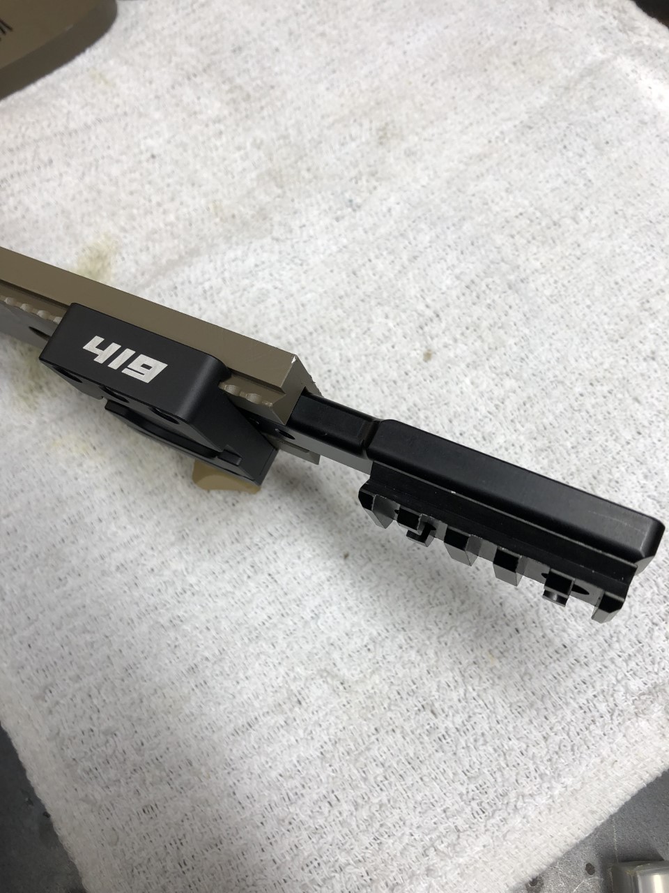

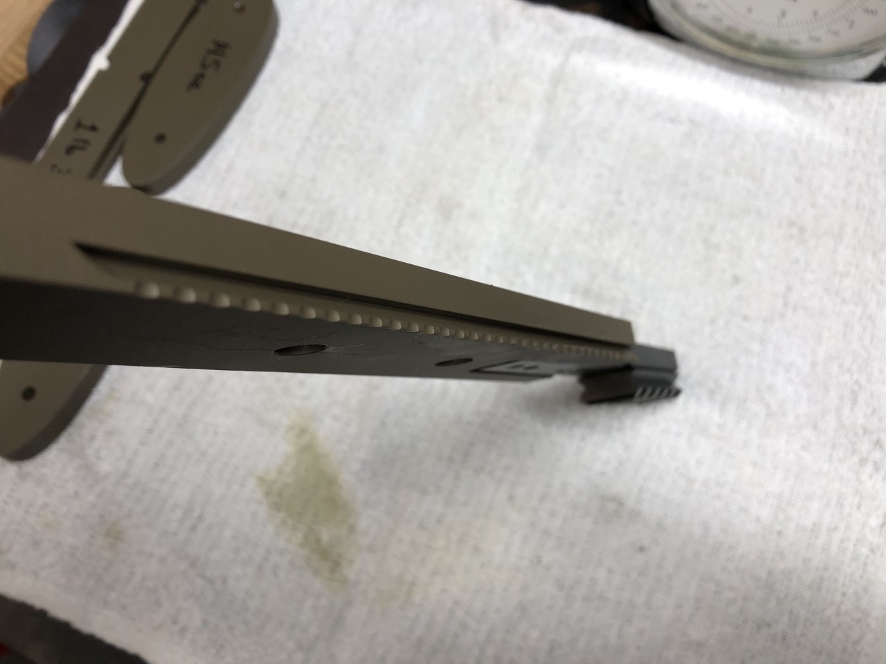

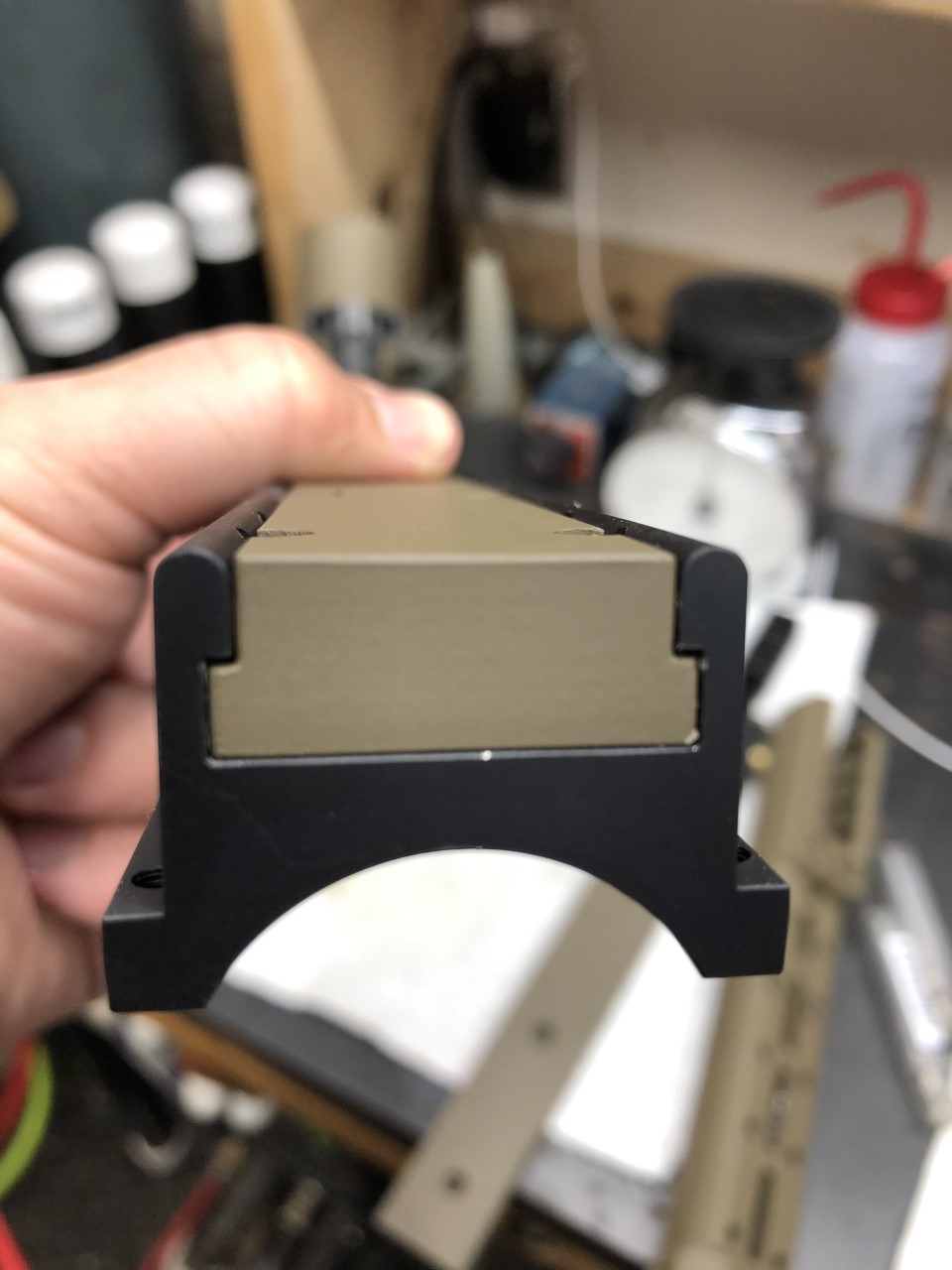

I inlet the spigot so I could get the Area 419 ARCA mount as far out as possible.
7118623
I also notched the dovetail so I could use the locking pins on the 419 mount.
7118625

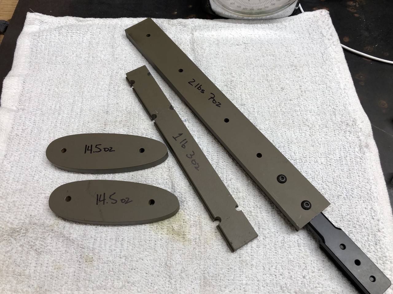

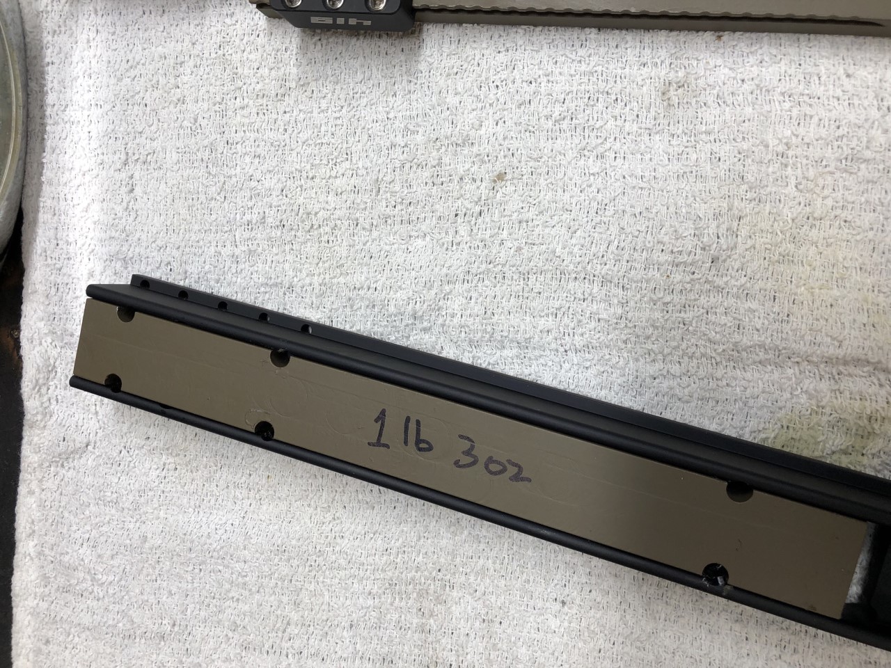

The forearm weight doesn't really require much design. I didn't have to machine the step in it, but it does help with supporting the drill with the through holes. Plus it'll help locate it and keep it from rattling around.
7118628
7118629

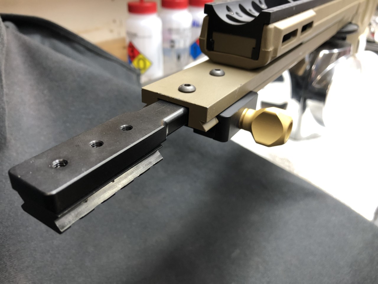

The MLOK mounts for the "ARCA rail" I epoxied in place. I HATE chasing those things around!
7118630

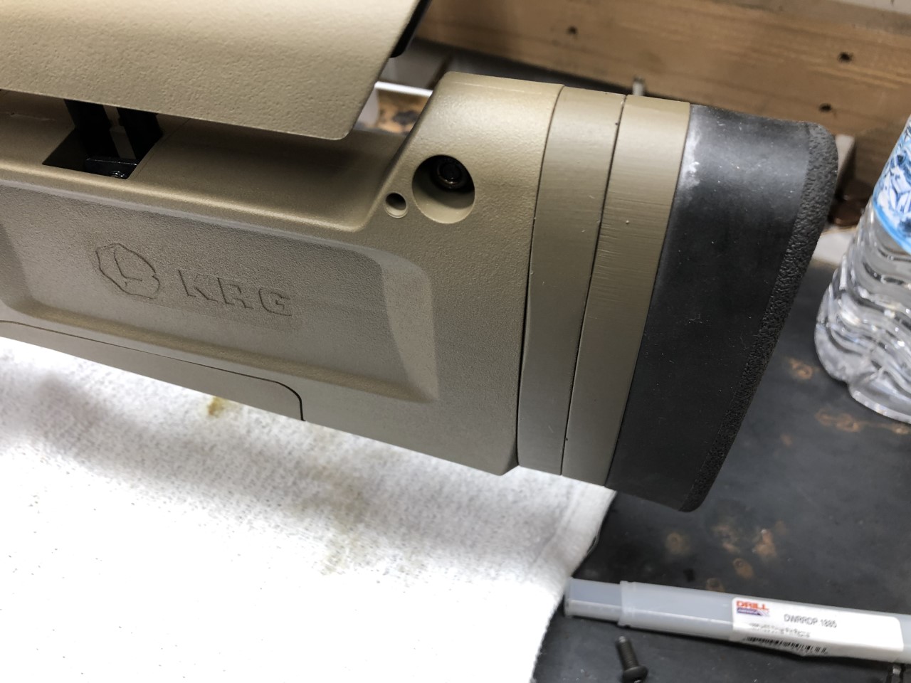

The factory LOP spacers I just traced out, then cut and filed. I made 3, but 2 works for me.
7118631
And a shot from the front end...
7118632
All in all, 10 bucks in material and 30 bucks for a dovetail cutter is not bad. 6hrs worth of work and 2 hrs cleaning up the mess and painting with Aluma-Hyde dark earth. Finished off with a cold Keystone Light and realizing I'll probably use it once, maybe twice, then just order the stuff from Area 419.......;)
