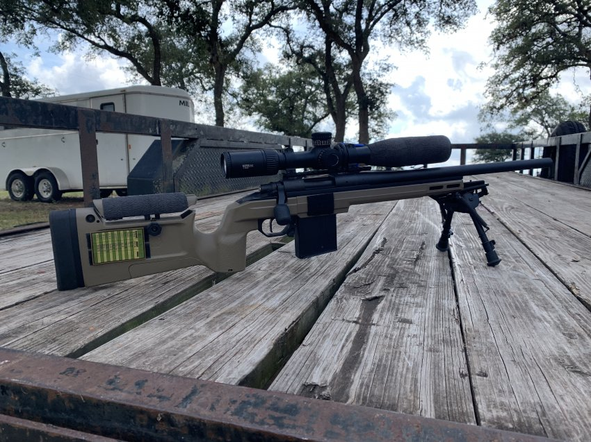

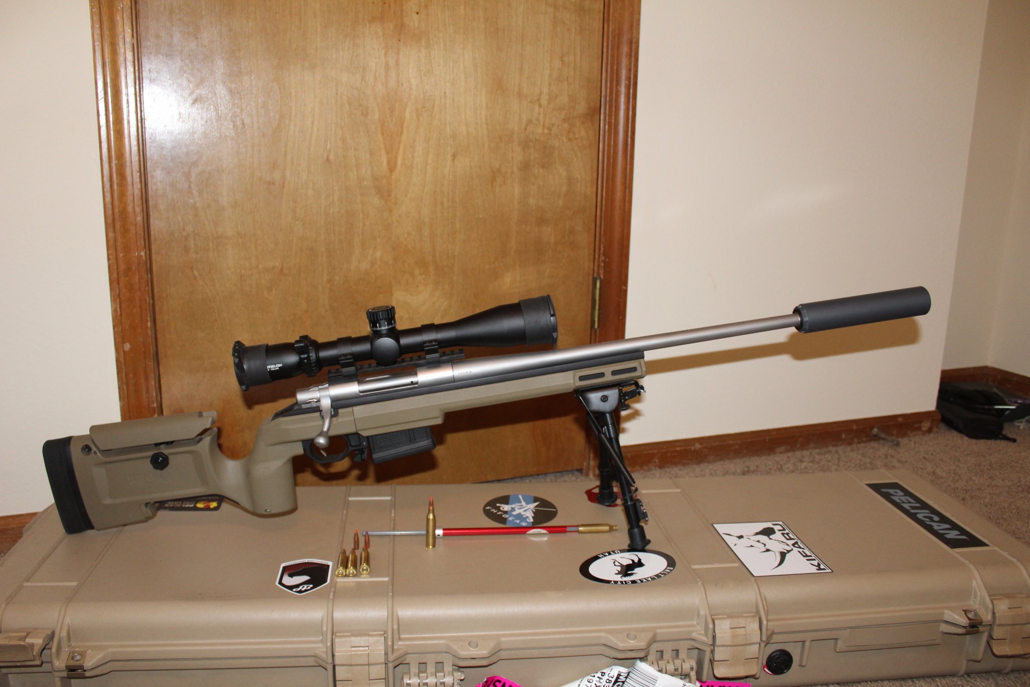

Howa 1500 in .243. Stock garbage twist barrel chopped down to 18.5" to run a form1 7" OAL suppressor that I just finished building. Glass is a 4x16 Athlon Midas Tac. I call her, "The Coyote Hammer".

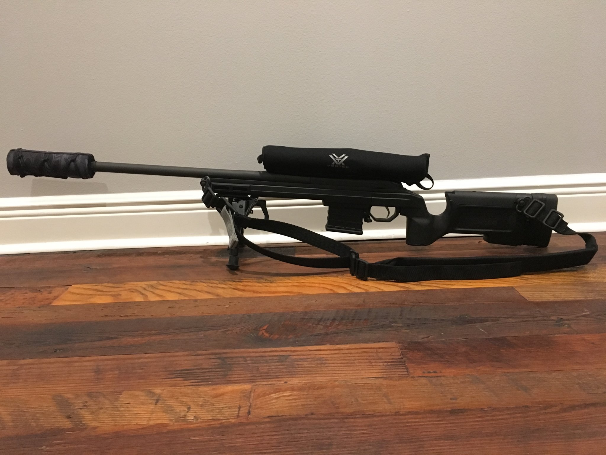

Thinking about picking up the Ambi Sling Mount. Who’s using it and what sling are you running to pack your 10-15# rifle around.
I’ll try to get some pics of my rig up later.
Ok, so I picked up the Ambi Sling Mount. Running a Blue Force Gear padded VCAS is very comfortable walking around.

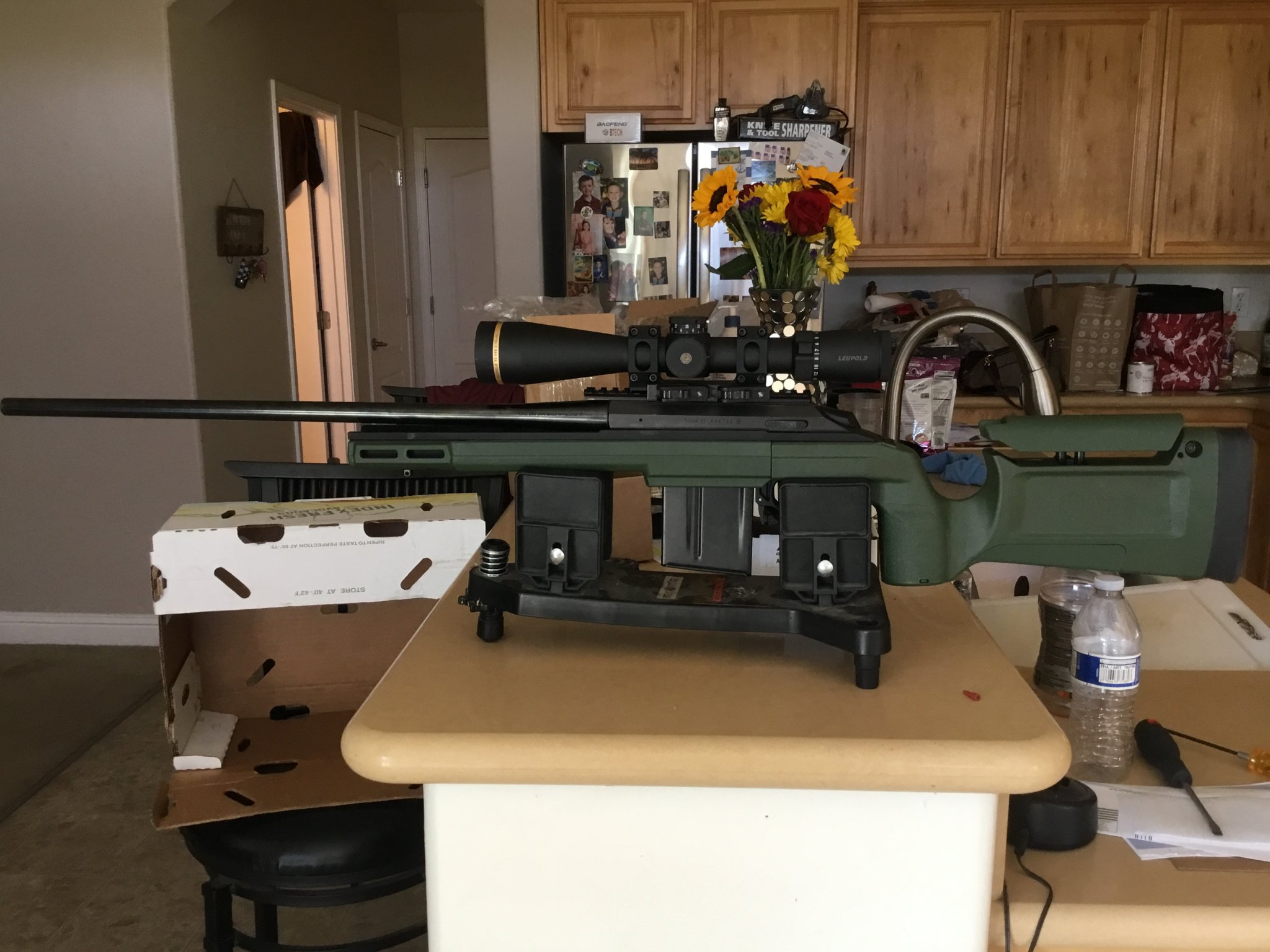

Good looking rig! Double check that the receiver has dropped into the lug in the chassis; can be tricky to feel, sometimes. Could be the angle of the photo, but from the lines, and how the barrel looks at the front of the chassis, the lug may not be seated in the lug cutout of the receiver.
Its not just you. It looks like its not flush and therefore pointing upwards pretty severely.
Reactions: SonicBurlap
@BG94591
Good eye. I missed it.
His recoil lug is on top of instead of inside of the recoil lug pocket. Ask me how I know. ?
I have to remind myself to follow KRG's instructions and slightly tamp the rifle of the buttstock before tightening down the action screws.

Damn y’all, I’ll have to check that out. Thanks for the heads up.
@BG94591
Shit fella’s y’all were right. Thank you again. Would have looked awful stupid at the range, I had planned to go today too.

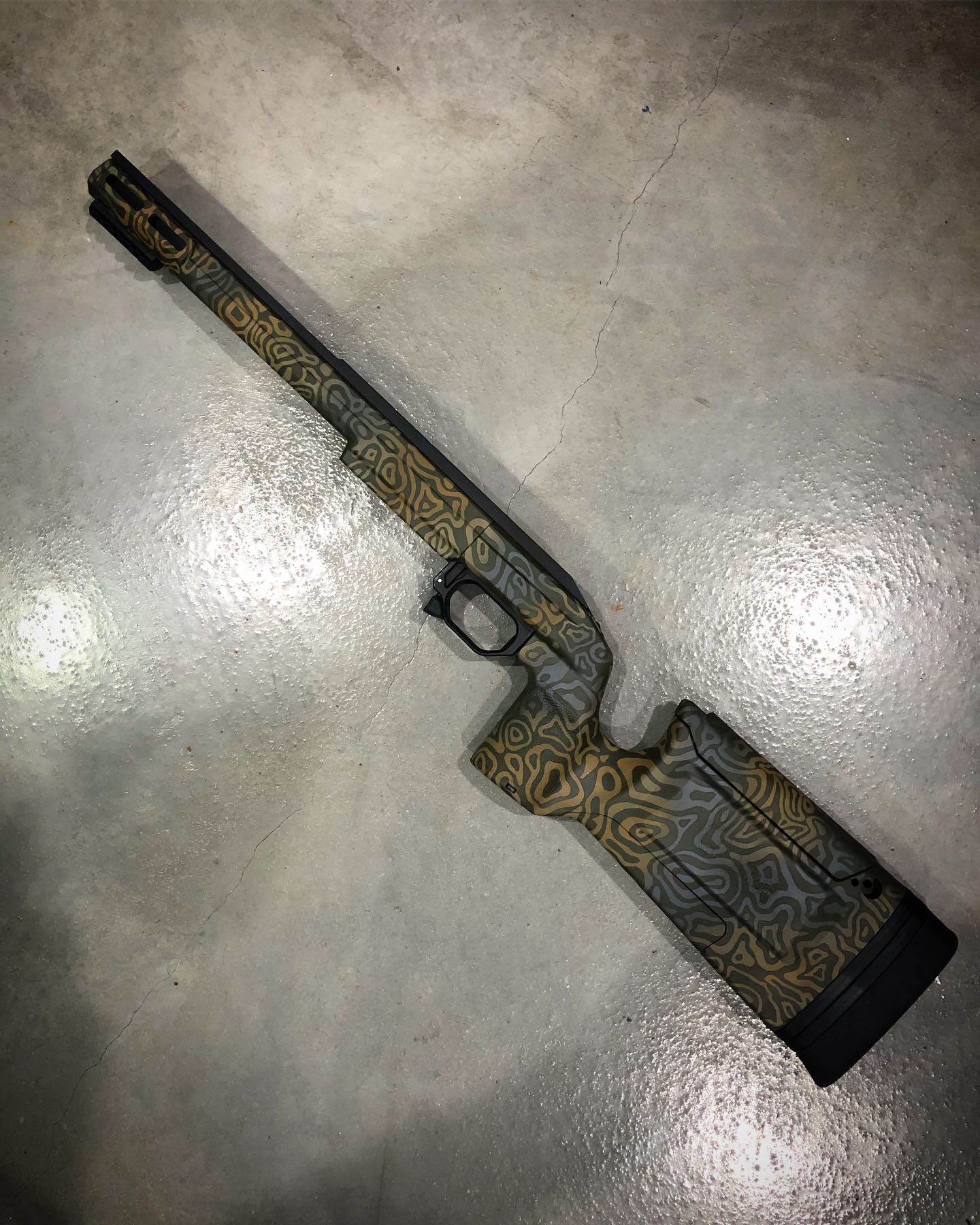

I finished up my Bravo cerakote last week - very happy with the outcome. 4 color “Topoflage” camo.
View attachment 7099623View attachment 7099624

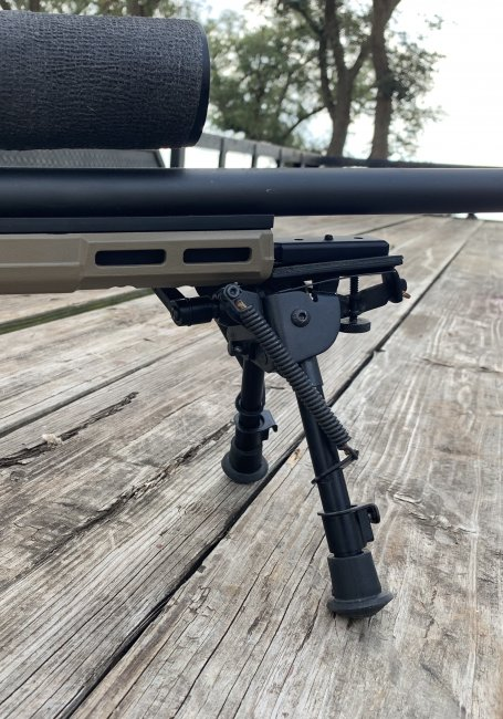

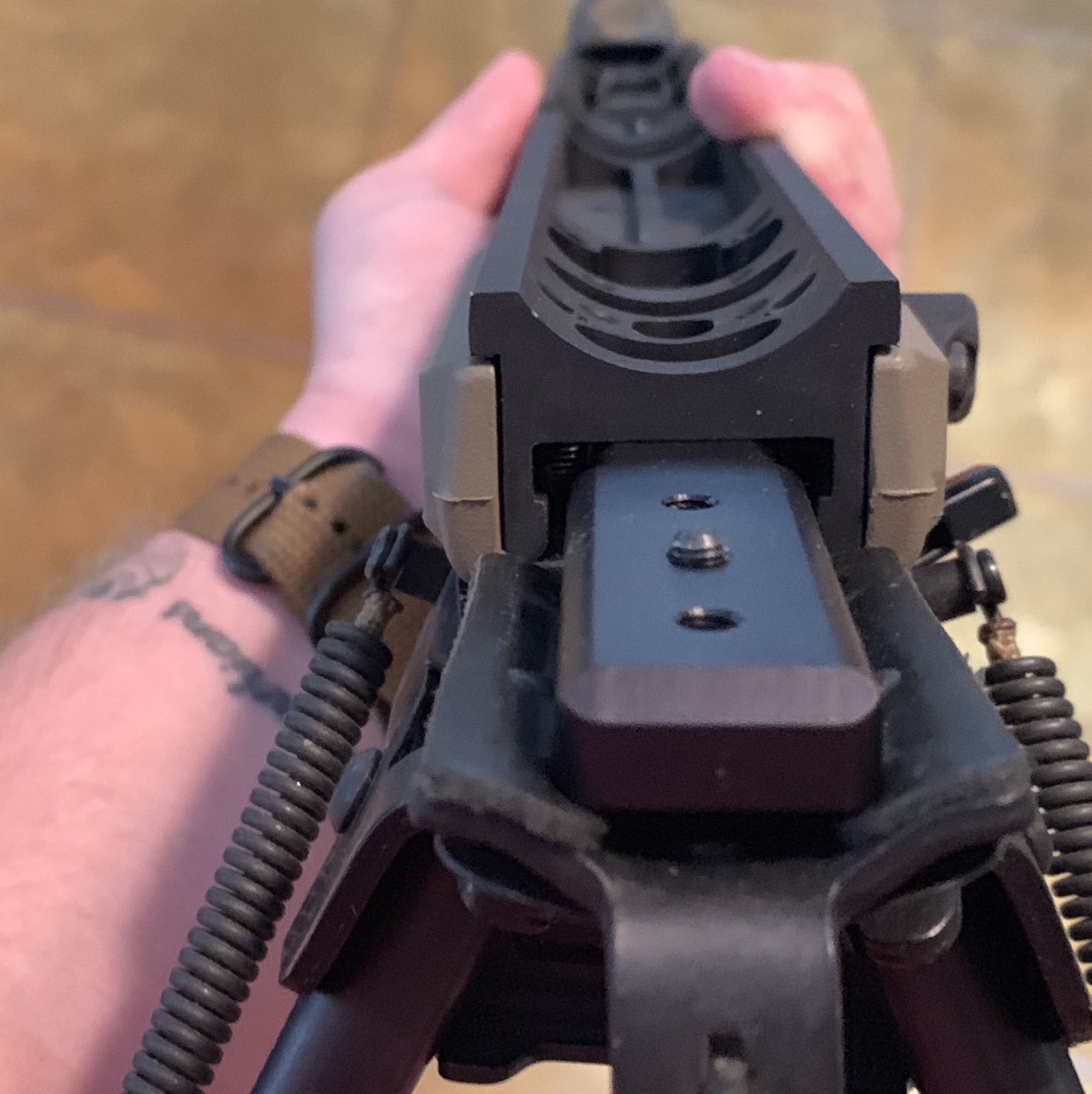

It's an MPA spigot that I picked up for $20 locally. Drilled two holes in the Bravo's foreend and it bolted right up. The spigot came with a pic rail on it. I unscrewed the pic rail and the KRG sling stud screwed right into the existing holes. I'll eventually switch over to the KRG Harris direct mount.
