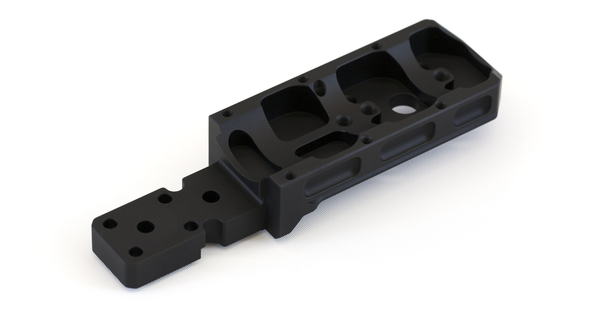

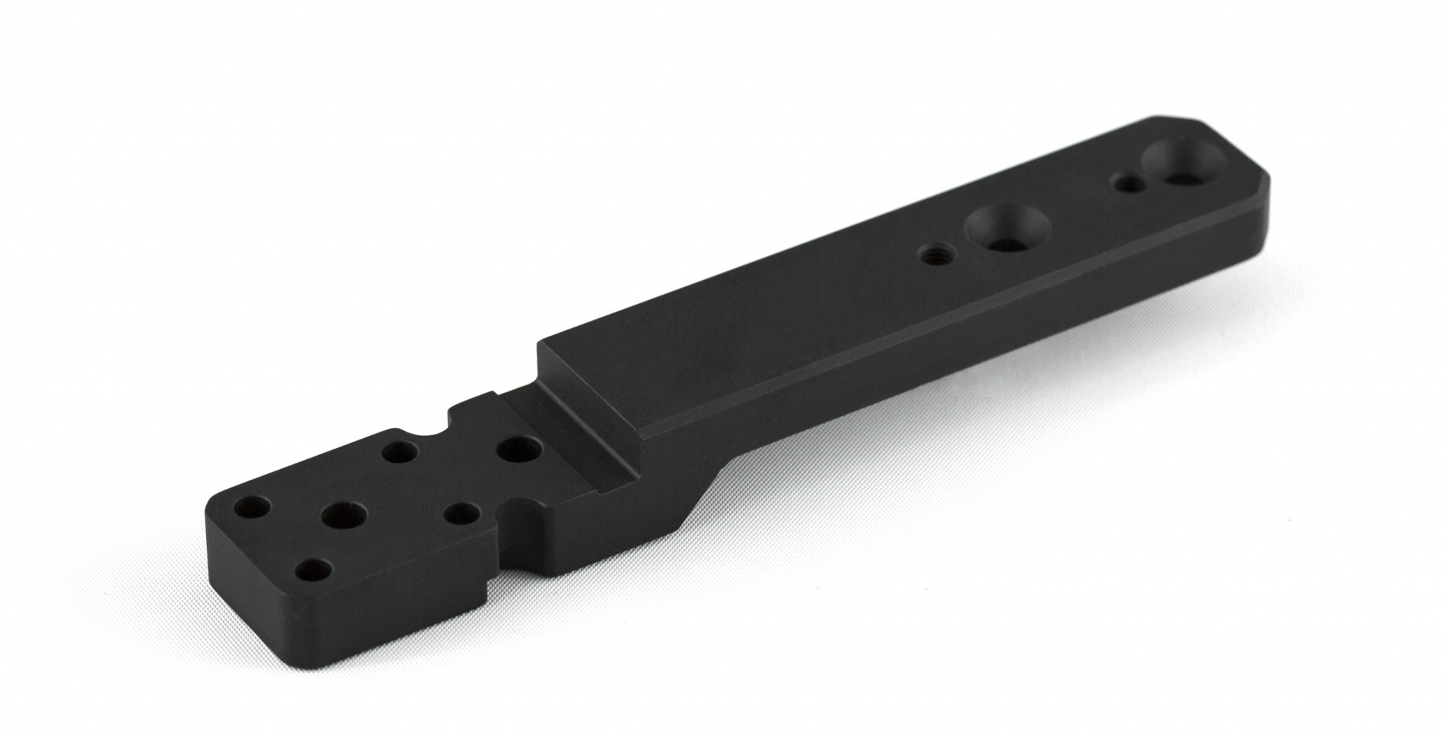

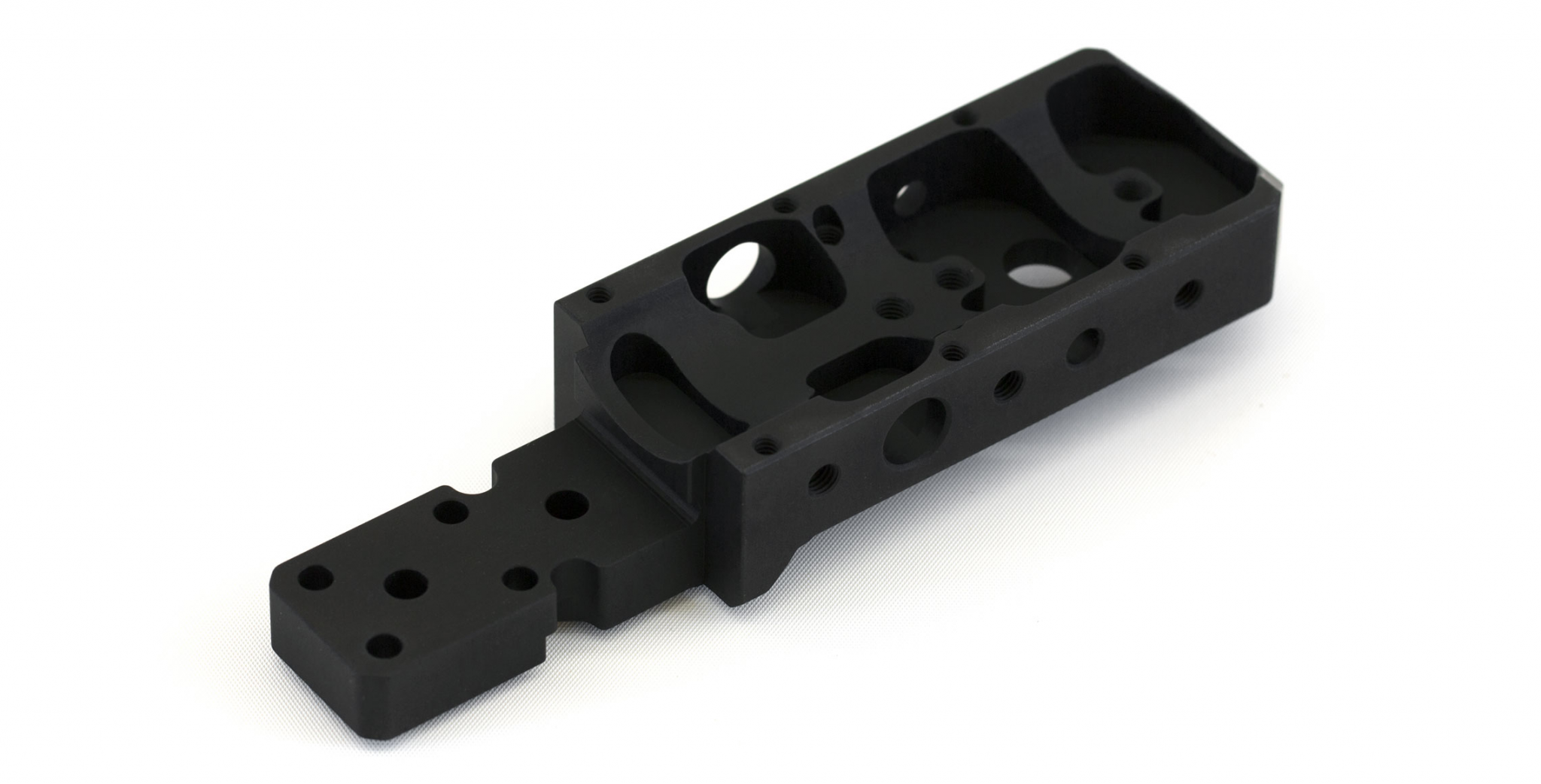

What exactly are the differences between the minimalist, Arca, and regular spigots, besides the dovetail on the Arca.
Trying to decide what to put on, I plan to run an Arca plate but could easily save a bit and run the minimalist with a picatinny for the bipod.
Might be a dumb question, but Iv read the descriptions...
Basically how much other crap you can screw onto it.
The regular has all of the attachment points for all the other crap to screw onto, lots of extra holes and drilling and threading to create.
The arca is sort of similar but because the arca encroaches upwards a bit the side mounting holes are not present and just small scalloped out areas.
The minimalist removes all that extra machining and offers no additional attachment points besides just the bipod.

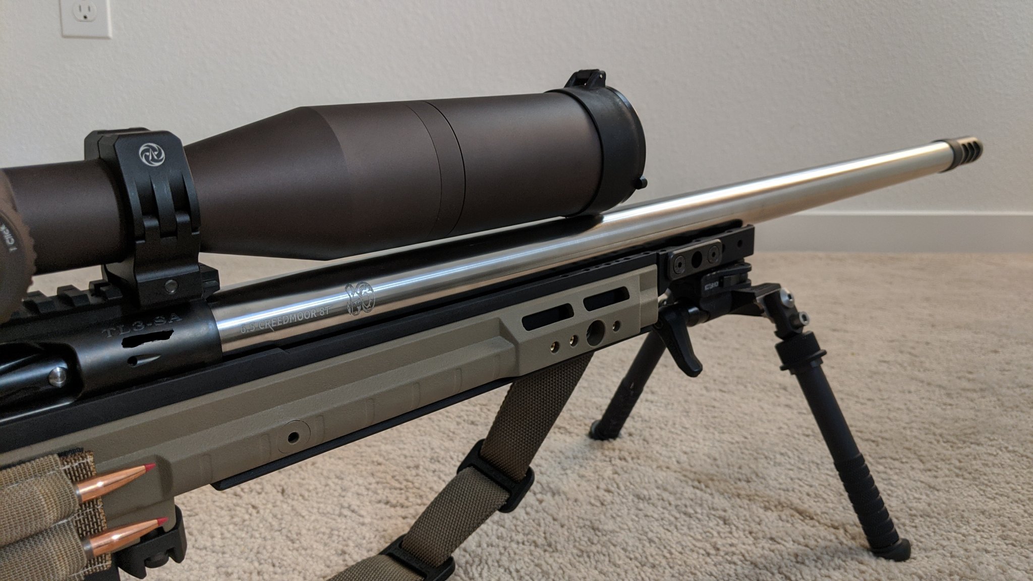

DDRH what barrel contour are you running
Proof Competition Contour. Chambered by Straight Jacket Armory. She shoots great!
It's a straight taper contour. Make sure whoever you buy from, if they contour their own bbl, to check the contour job.
