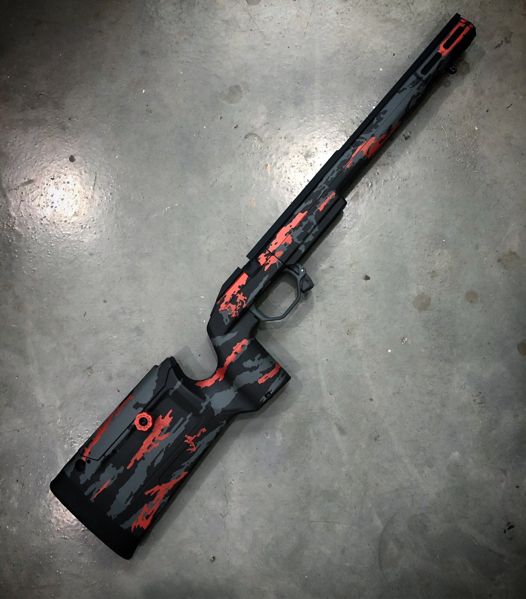

Upcoming rifle from BadRock. Should have it around end of December ~end of January:

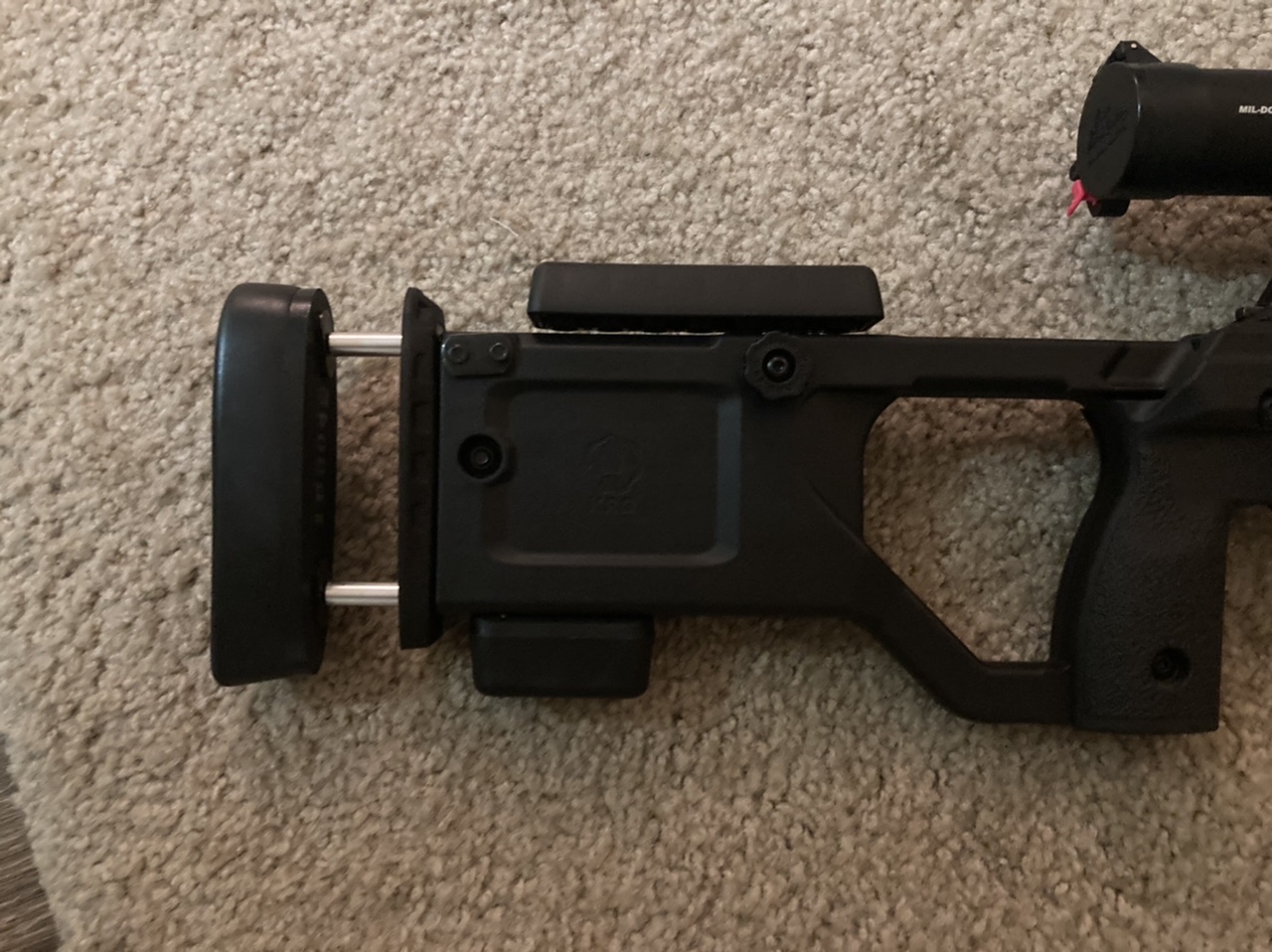

For you guys using this stock in PRS, I have a question on accessories:
1) is the Arca rail the one to buy, or the entire alum fore end
Stock isn't long enough + the back is light, so I'm going to order the heavy steel spacer and then add more if needed.
Anything else I'm missing?

I used a spigot and the Area 419 arca rail
I added the weight as well

IIRC you can actually add more weights to the stock/base Bravo forend, you'll want the Heavy ARCA Spacer, Heavy ARCA Rail, Forend T-slot Weight, along with 1-3 Heavy LOP Spacers... that and an MTU contour barrel will add up to ~22lbs which is about where most PRS rifles land these days. You can also add a pair of mlok weights up front if need be.
I think you can add a little more weight to the enclosed forend because the ARCA stuff is longer, and they look cooler, but those are a PIA to live with if you ever have to pull your BA (a zillion screws), and make most sunshades a no-go.

You can get just the aluminum forend (non arca) and bolt the heavy spacer and heavy arca on it for more weight than the polymer forend on top of everything else listed. The XL spigot is also a really good way to shift weight forward if needed.And you can get the brass weight from Raven Rock and it's heavier than the KRG one.

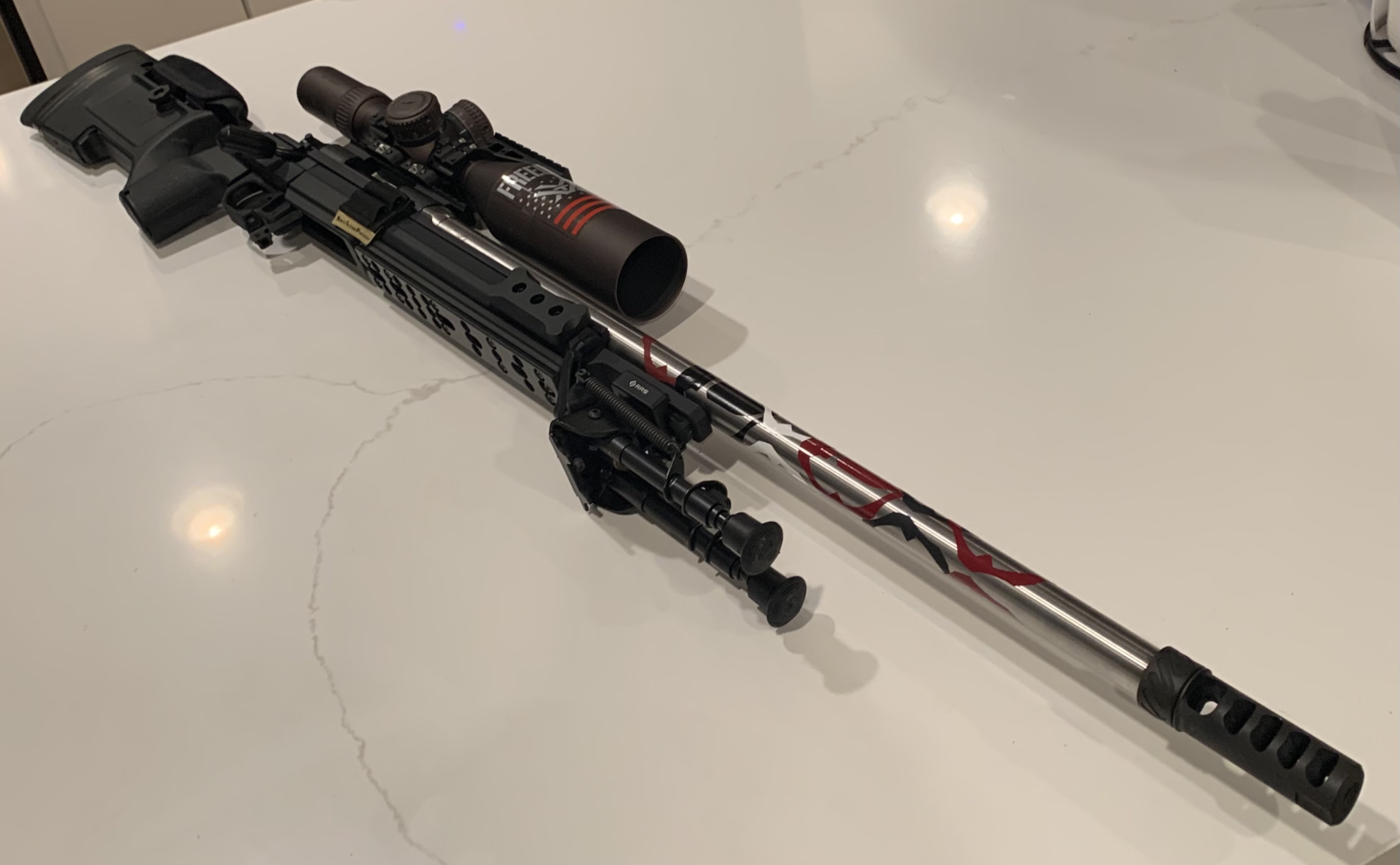

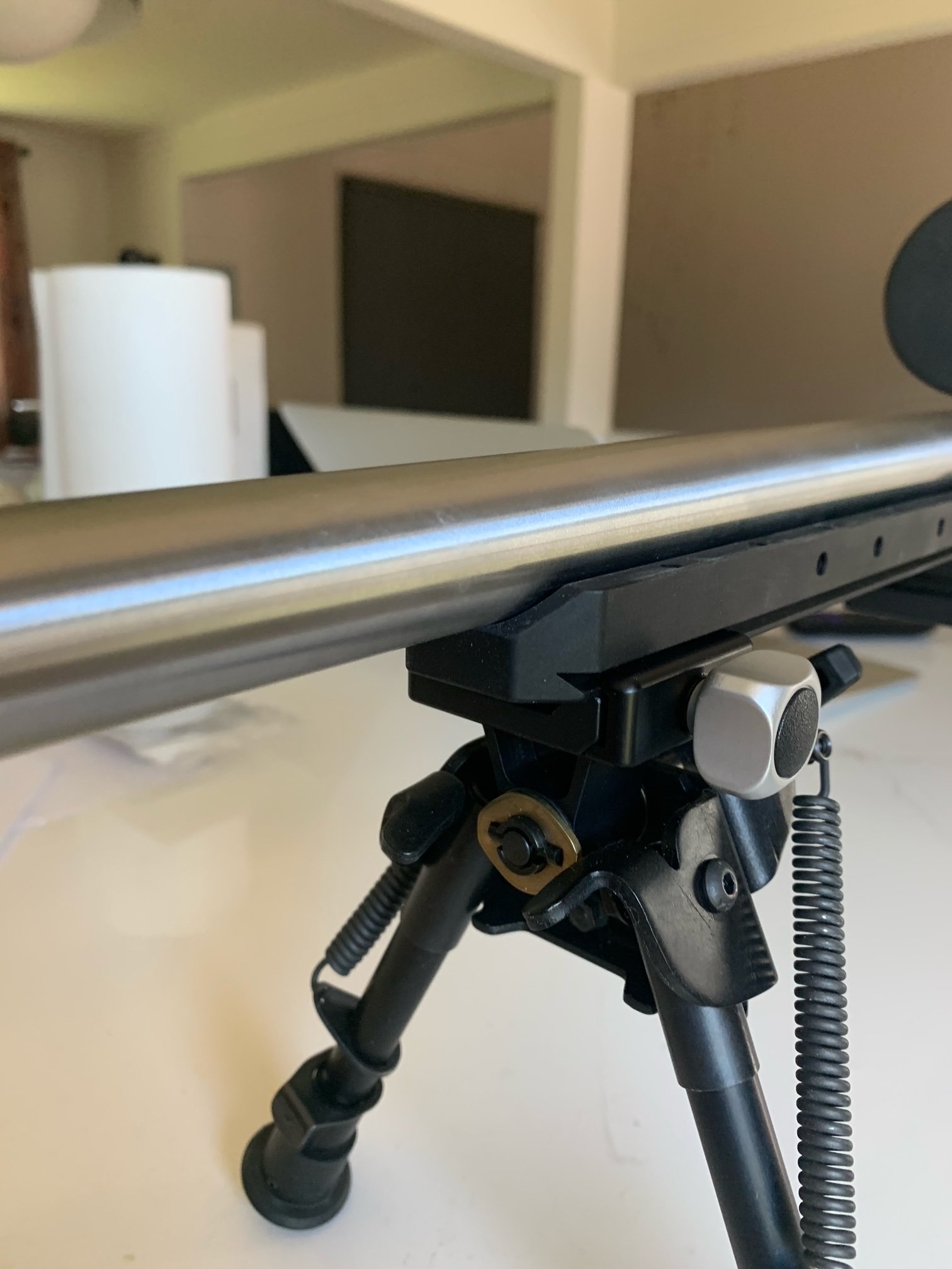

View attachment 7749766View attachment 7749767
What's the contour of your barrel? I just ordered the xl spigot and am running a competition contour barrel.
I appreciate all the input. I've got the heavy LOP spacer coming + ACRA rail. I've already got plans to weight the butt but have to wait for my scope to arrive (hopefully this week) before playing with the rifle's overall weight and balance point.

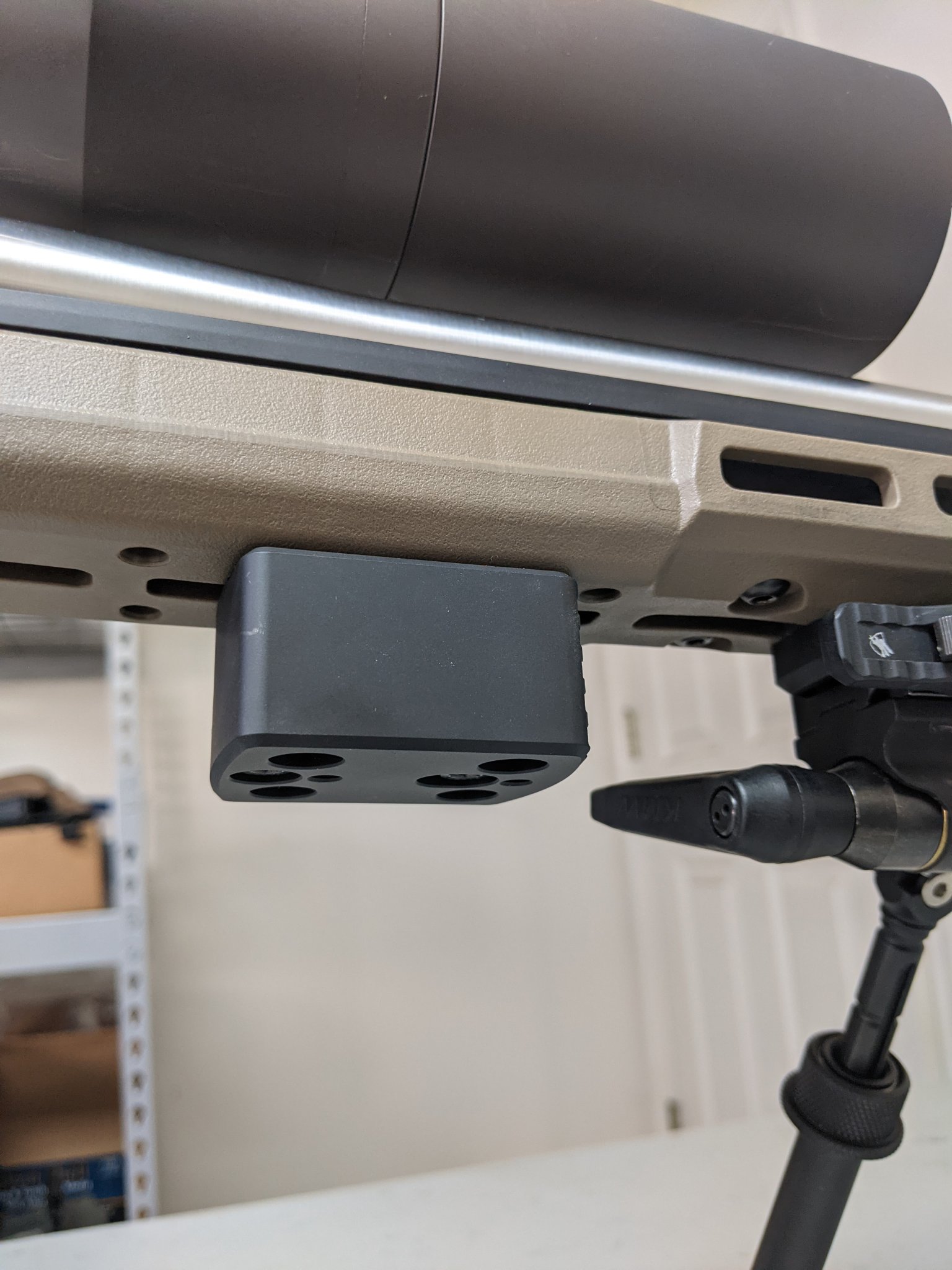

View attachment 7751208I made a personal modification to my KRG based on a post from r/longrange.
Instead of using the traditional spacer system, I went out and found aluminum spacers from Home Depot that could replace the space. It worked out pretty well. Anyone else ever give this a try?
What's the advantage?
I thought I would check back in after receiving and installing the xl spigot. It cleared just fine even using a custom competition contour barrel. I was pleased with how much more stable it is by moving the bipod forward.

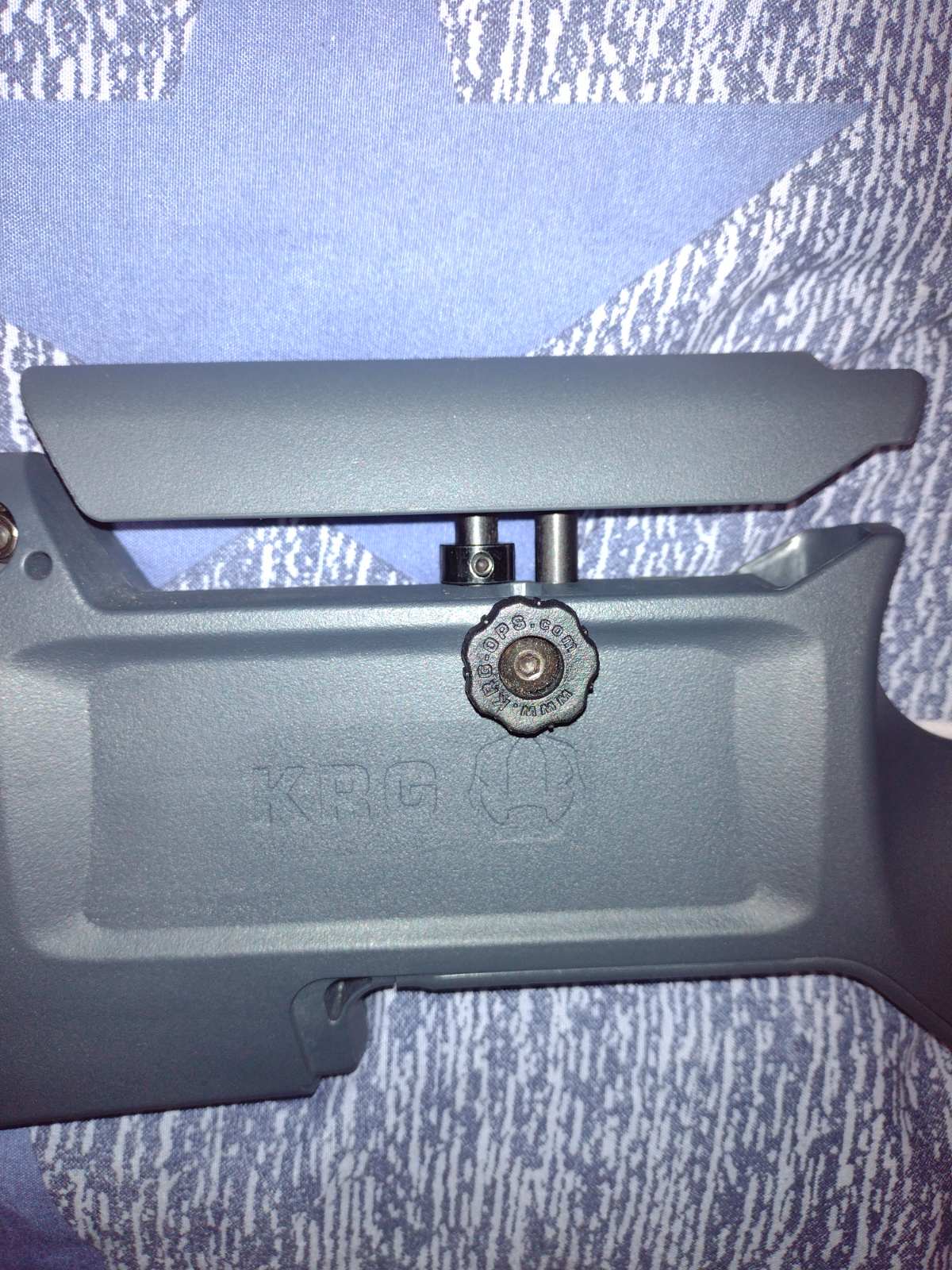

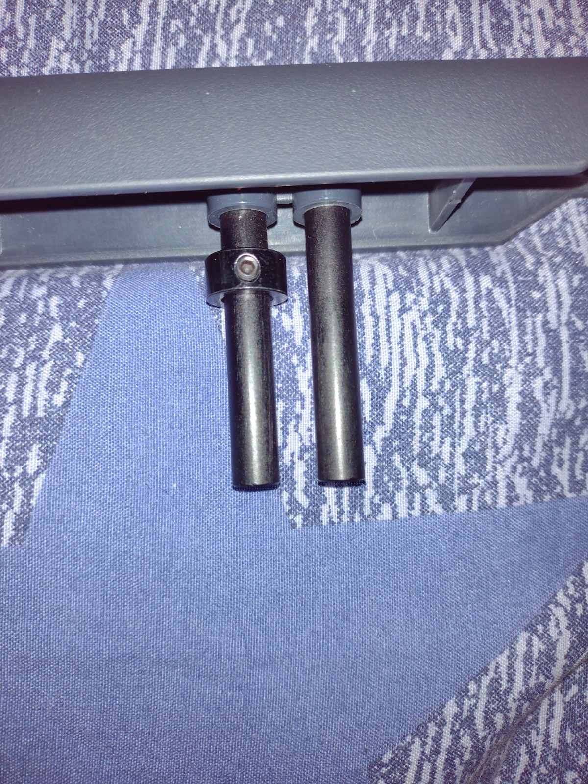

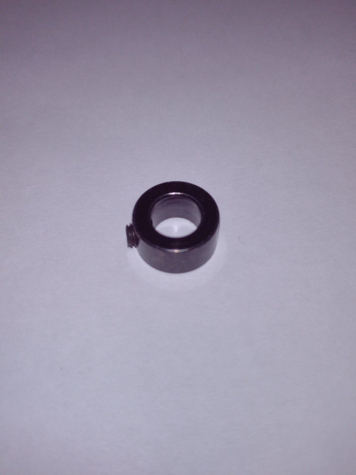

Interesting.....every KRG chassis I have ever purchased has a little rubber o ring that used to set the height of the cheek riser so when you set it up, and remove, it goes back to the height you set it at
