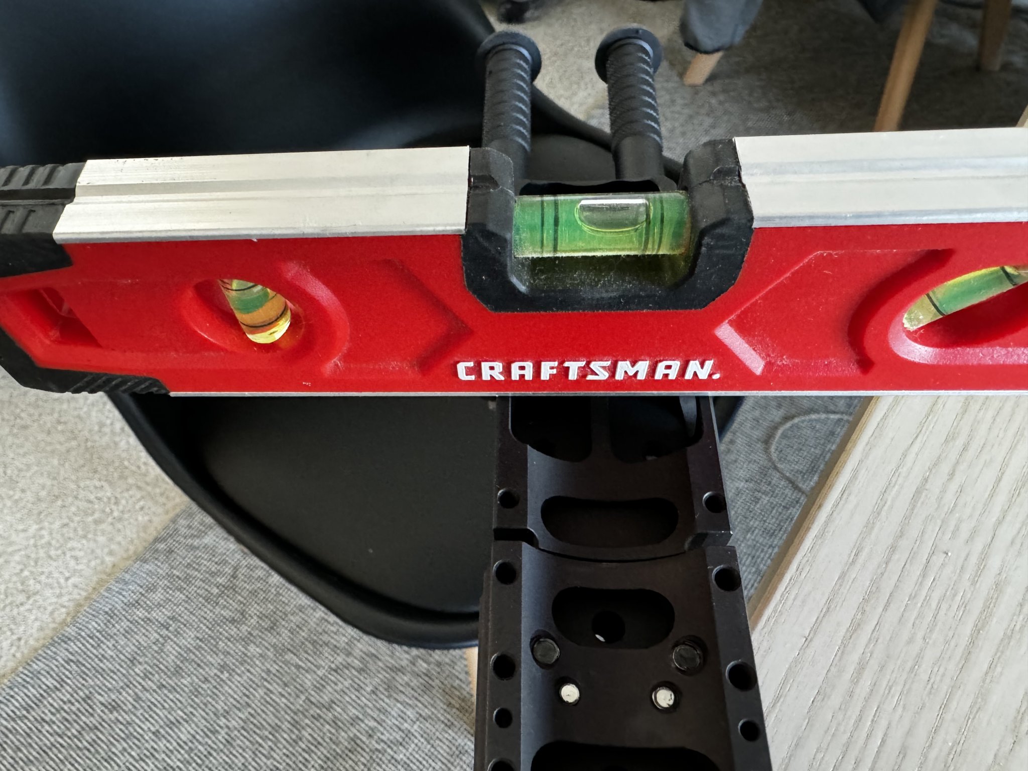

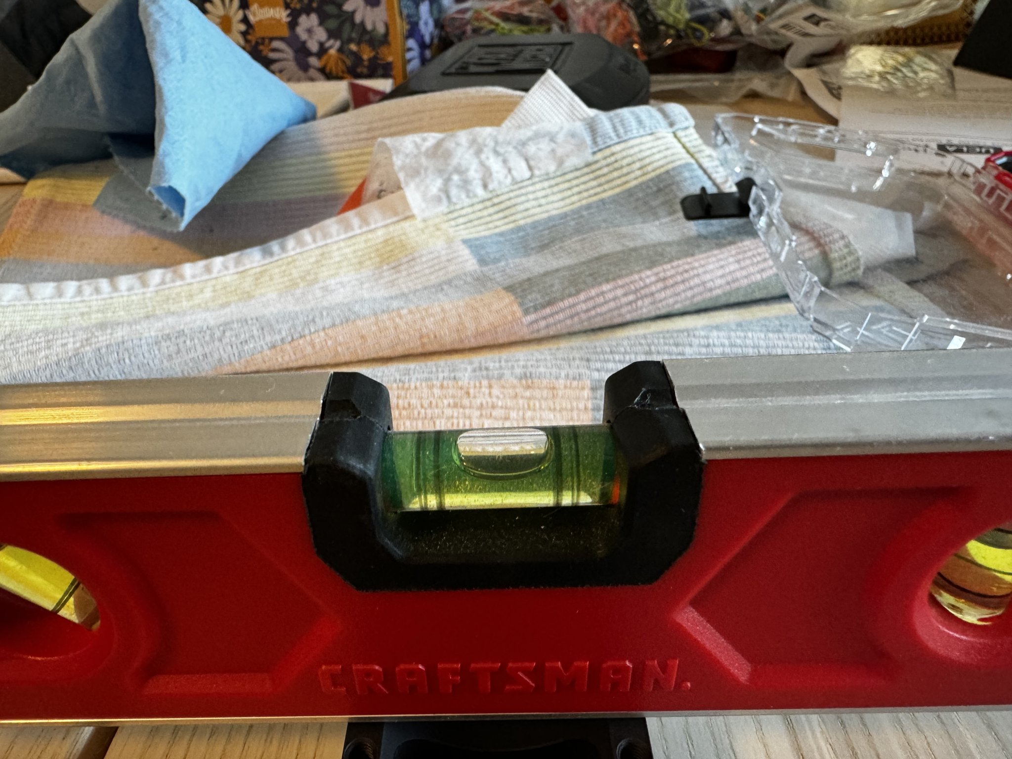

Recently bought a KRG Whiskey-3 Comp pack. First time installing the spigot to the chassis, found the spigot is not super align with the barrel tunnel.
Contacted KRG, sent it back, and they fixed it. All good! I can't be more happy with their CS.
However, my initial guess on the misalignment is due to something wrong with the backbone, like the angular error. I did put a bubble measure on different parts of the backbone and can confirm the backbone is twisting counterclock-wise from rear to the front. This tilt is still present after their service. I did measure the forend and the backbone separately today, both of them have this counterclock-wise twist.
Forend Rear
Forend Front
Backbone Rear
Backbone Front
I know the chassis, though precision machined, is not holding as tight tolerance as the action or the barrel. But is this type of twist considered normal in machining tolerance? or I'm just being too perfectionist?
If you folks have the KRG chassis, especially W3, and a bubble level on hand, would you mind measuring yours as well?
Since the barrel doesn't contact that area, it would have no effect.
Also, that is not a machinist level, there will be error there.
It appears you have it sitting on a wood surface. It is nearly impossible for that to be perfectly level.
There is a lot of tolerance stacking there. That is likely not a good reading.
yeah, i don't actually too much concern about the 'level' itself as long as the rear and the front measure the same way. But if the rear is measured 1 degree, the front is measured let's say 3 degree, that means the part is 'twisted' 2 degree. Isn't it?

The way you have pictured won’t tell you if there is twist. Turn it upside down on a known flat surface and see if it has constant contact

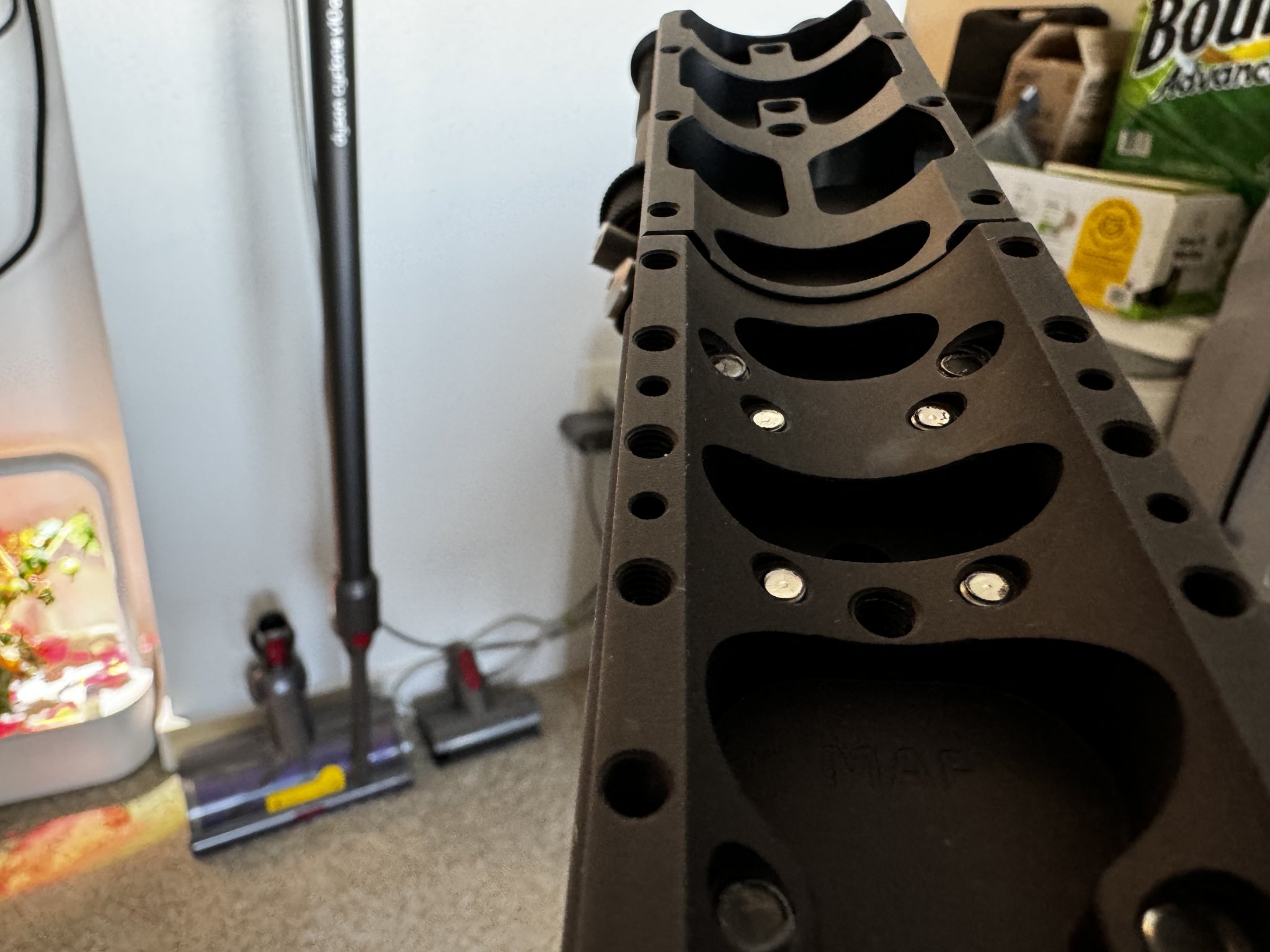

Initially i noticed is the misalignment on barrel tunnel between spigot and the backbone, this indicates the mating surface between the spigot and the backbone is not parallel to the top surface of the backbone, though from my eye, the concentricity is okay.
Then I guess it might be the backbone being:
  • tilted, in this case if i put the bakcbone on a leveled surface, the measures should be not leveled but haves the same reading on different measurement points
  • twsisted, this turn out to be the case, where one the same surface, the measure is different from rear to front
I sent it back to KRG, they fixed the spigot misalignment and sent it back. I asked how's the fix, they skipped this question. I measured the level again, and asked if it is considered within spec (multiple times), they didn't answer as well....

If you have a vise, can you hold the chassis on to the vise and put the level measure onto different points (I took 4 measures) of top surface from rear to the tip?
If you don't have the vise, you can also put the chassis on to the edge of a flat surface like me, and take the multi point measures. The caveat of this method is the little pressure you put onto the chassis to prevent the chassis from falling will influence the result a little bit.
^ without taking apart the forend from the backbone, those two methods will only give the combined error reading of the backbone and the forend, but this should be insightful enough.
Fuuuuuuuuuuuuuuuuuuuuuuuuck. You can take a thousand measurements, but the only measurements that matter are on the target. You haven’t even built the rifle. Build it, and shoot it. Come back with those results. And, for giggles, buy a traditional stock and shoot the rifle built up in that one too. Let’s have a comparison. Fuck, buy a top tier chassis too. Let’s make it a bake off.

You mean just the backbone? Sorry I'm not taking it all apart to check out the backbone. If there is something else I can do with the forend on one then I'm happy to do it if it will make you feel better about it. I can't even tell how yours is supposed to be off. Putting a 6" torpedo on it sitting on a table just doesn't really tell me anything.
Obviously, none of this is going to matter for your rifle performance so put your rifle together and go shoot it. If you don't like it, sell it and try a Vision or ARC, or MDT. There's a lot of options but I've always found the W3 to be a very comfortable chassis.
Reactions: Ziloooo and kthomas
no you don’t need to take anything apart. Just the whole chassis with the bottom of forend on a flat surface or vise, and pick a few points to measure the level from action side to the tip and see if the reading is the same.

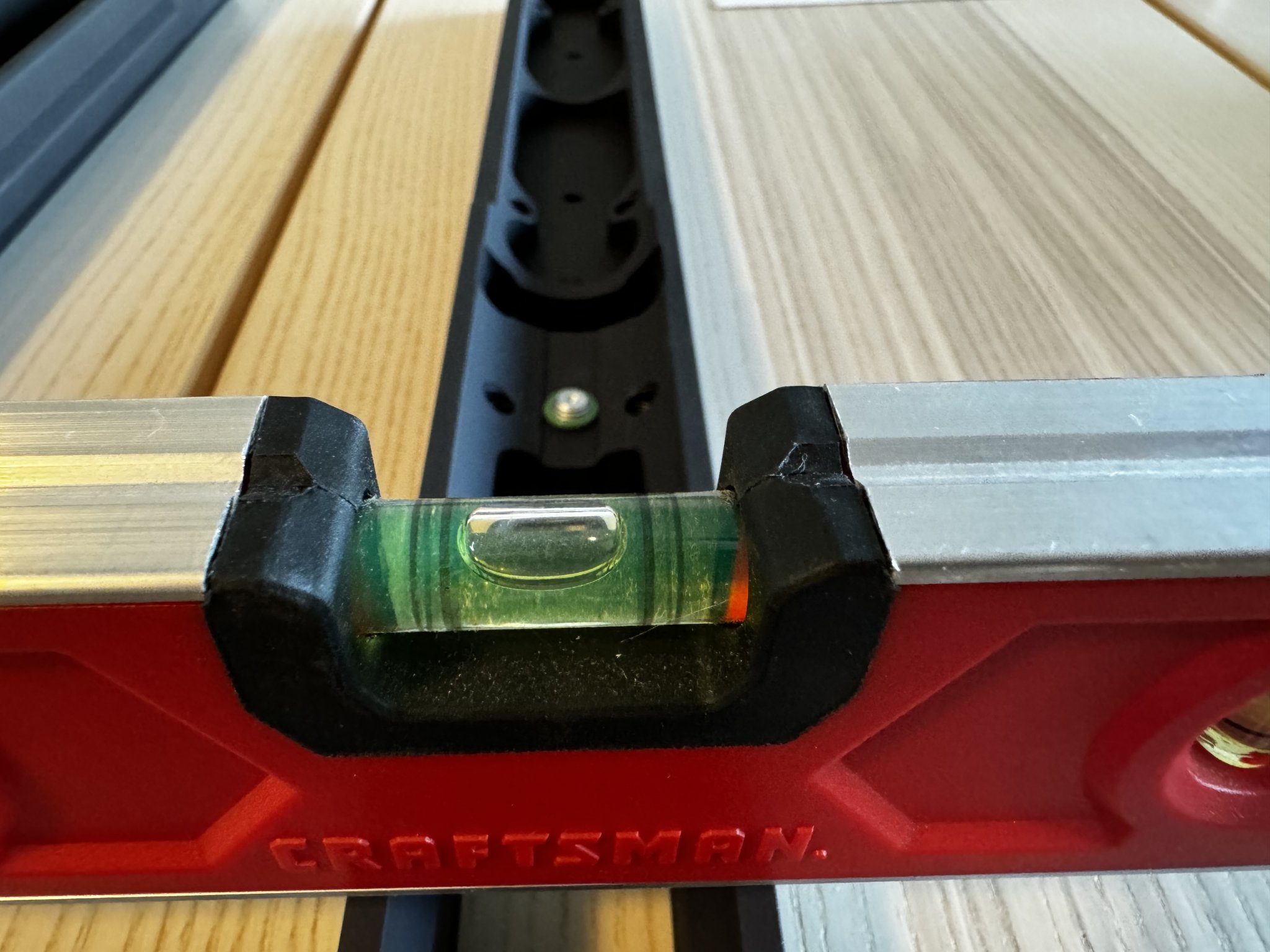

Ummm just need the chassis itself, so with the barreled action removed. ARCA rail attached is fine as the rail surface is supposed to be parallel to the bottom surface of the forend.

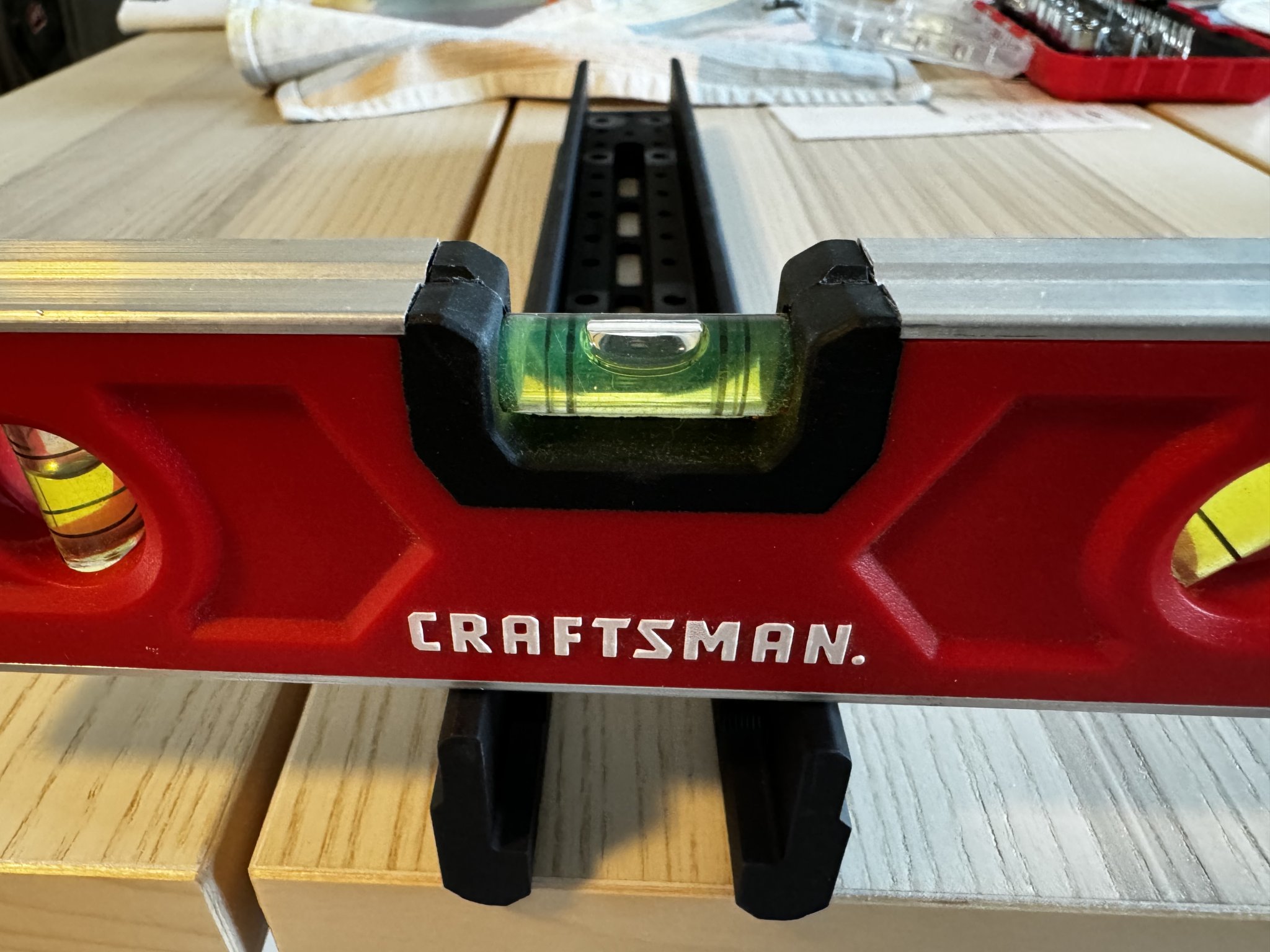

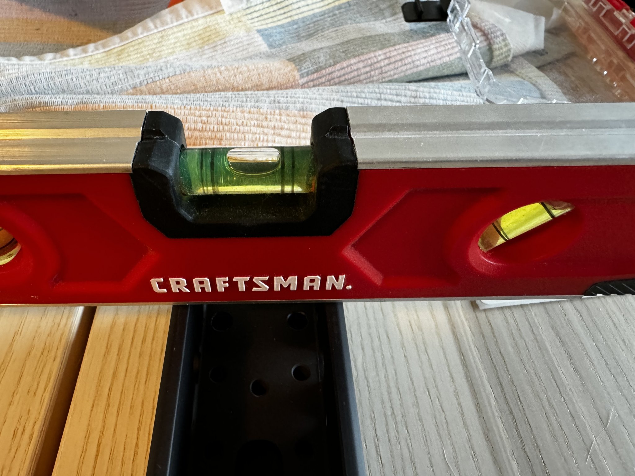

Yeah, the backbone, but also the forend and them combined seem twisted as in my original post. It would be helpful enough if you can measure them combined, no need to set them apart. The twist can be seen by naked eye from the difference on bubble position.
Tbh, this all start by misalignment on barrel tunnel between spigot and backbone, which is pretty observable by naked eye without any instrument (like this torpedo as you said lol). The issue on twist is just a side product when I try to findout where's exactly the issue.
example:
Rear (bubble within line)
Middle (bubble touch the line)
Front (bubble cross the line)

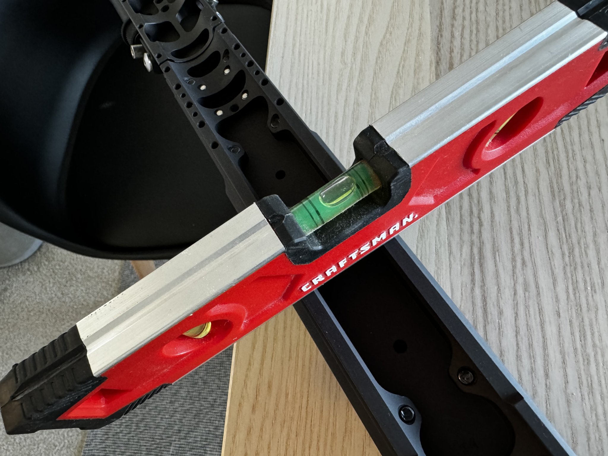

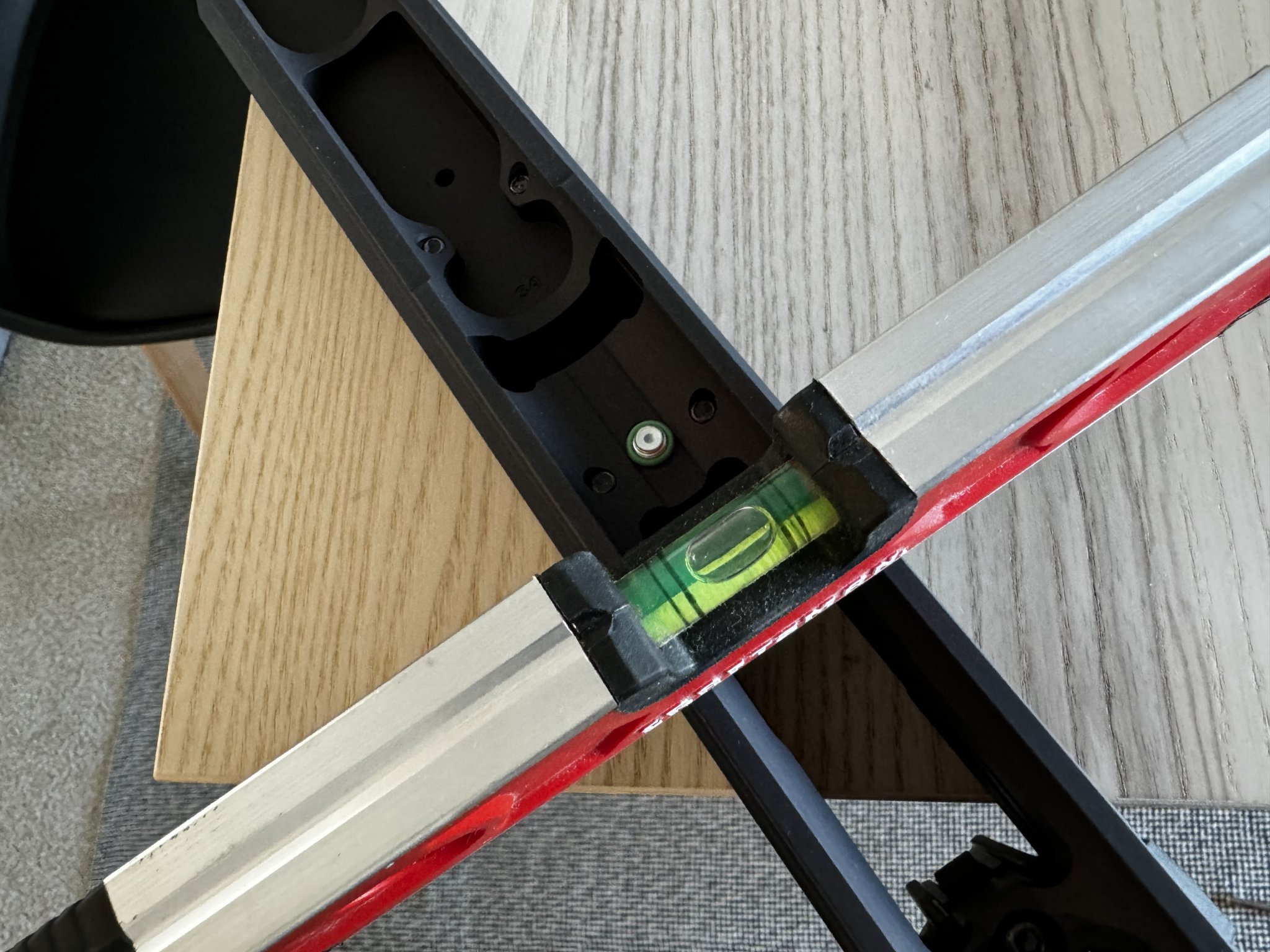

Just gotta ask, did you check with the bubble level on the bottom of the backbone? Also, you should check the wall height between the left and right. The "twist" could be non-existent and it being a factor of height.
Damn! You're the genius.
Just measured it, if upside down and measure on the bottom of (the forend), the level reading are pretty much the same. But just as you said, it's the issue on the height of the wall.
I took measure of forend + backbone combined:
  • Left Front: 1.544 inch
  • Right Front: 1.558 inch
  • Left Rear: 1.648 inch
  • Right Rear: 1.644 inch
seems the issue here is more of the wall height on the front. @moosemeat in his post mentioned +-0.05 so it seems not that bad tho.
If anyone want to measure theirs to verify, you're always welcomed.
