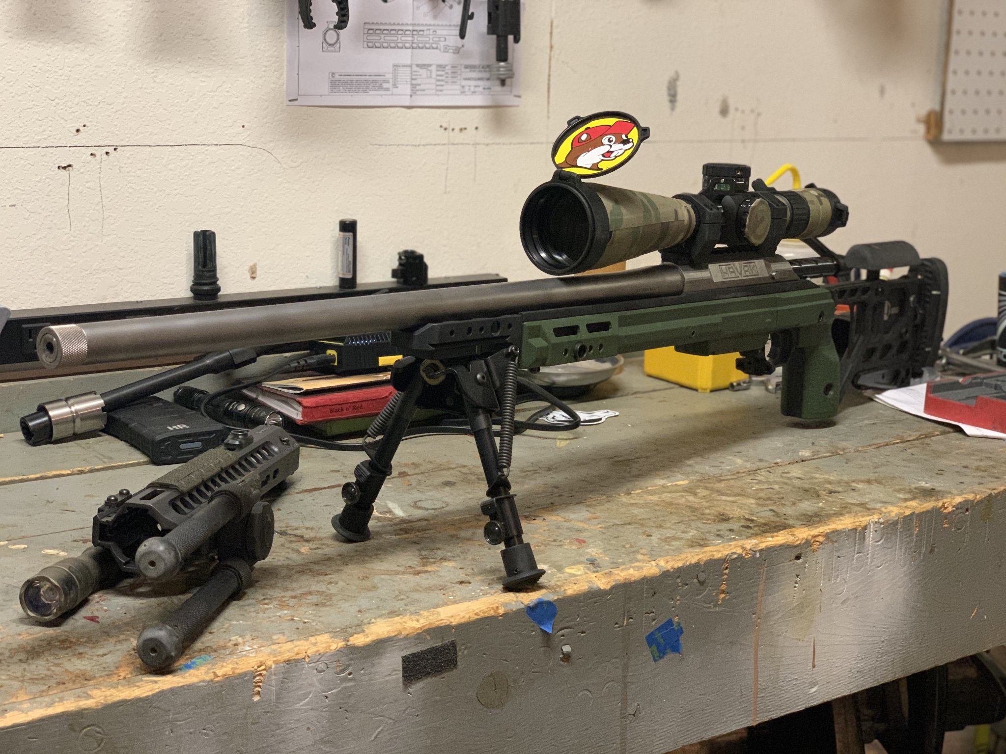

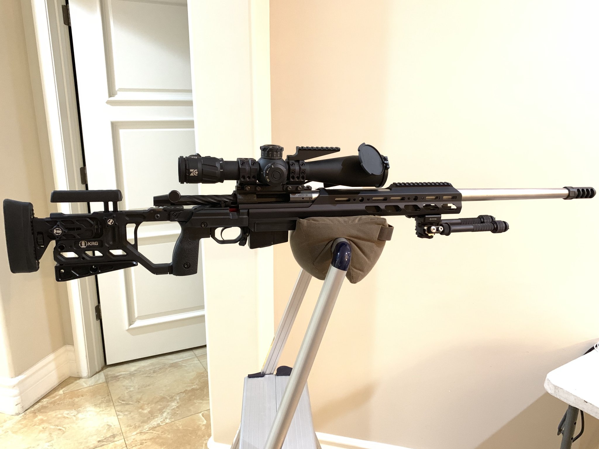

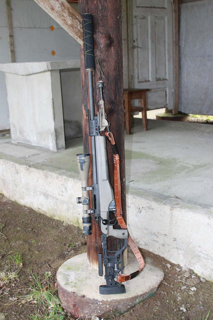

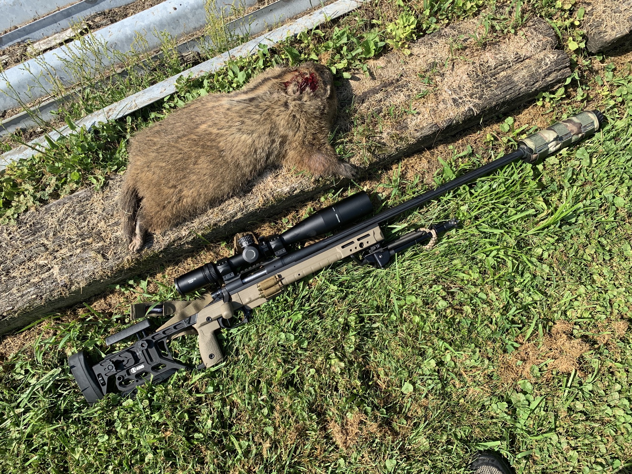

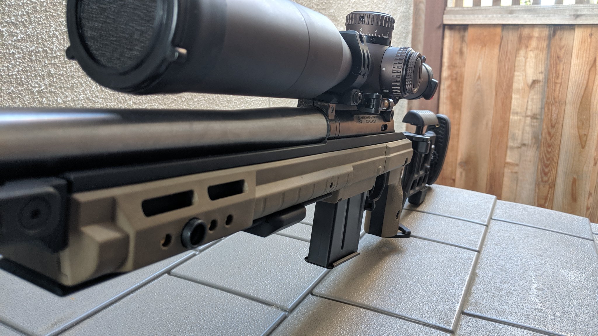

Another enclosed forend. Got it last week and took it to the range today.
It is crazy stable, and moving the bipod forward is never a bad thing.

The only thing I had to do to the rifle was to cut the front part of the scoperail of, so it clears the first part or first loop of the forend. Other than that, the scope is in the same place I have ran it since day one. I must admit that the main reason for me to get the new forend was that I had the slim one from the X-ray and did not like the looks of it, I also liked the idea of the added lenght to get the bipod more forward. And frankly, I think it looks cool. I dont have a clip on night vision as of now, the laws for hunting with one just changed here (Sweden) so now it is atleast an option to use one. I might get one in the future.
Thank you!
Reactions: Massoud

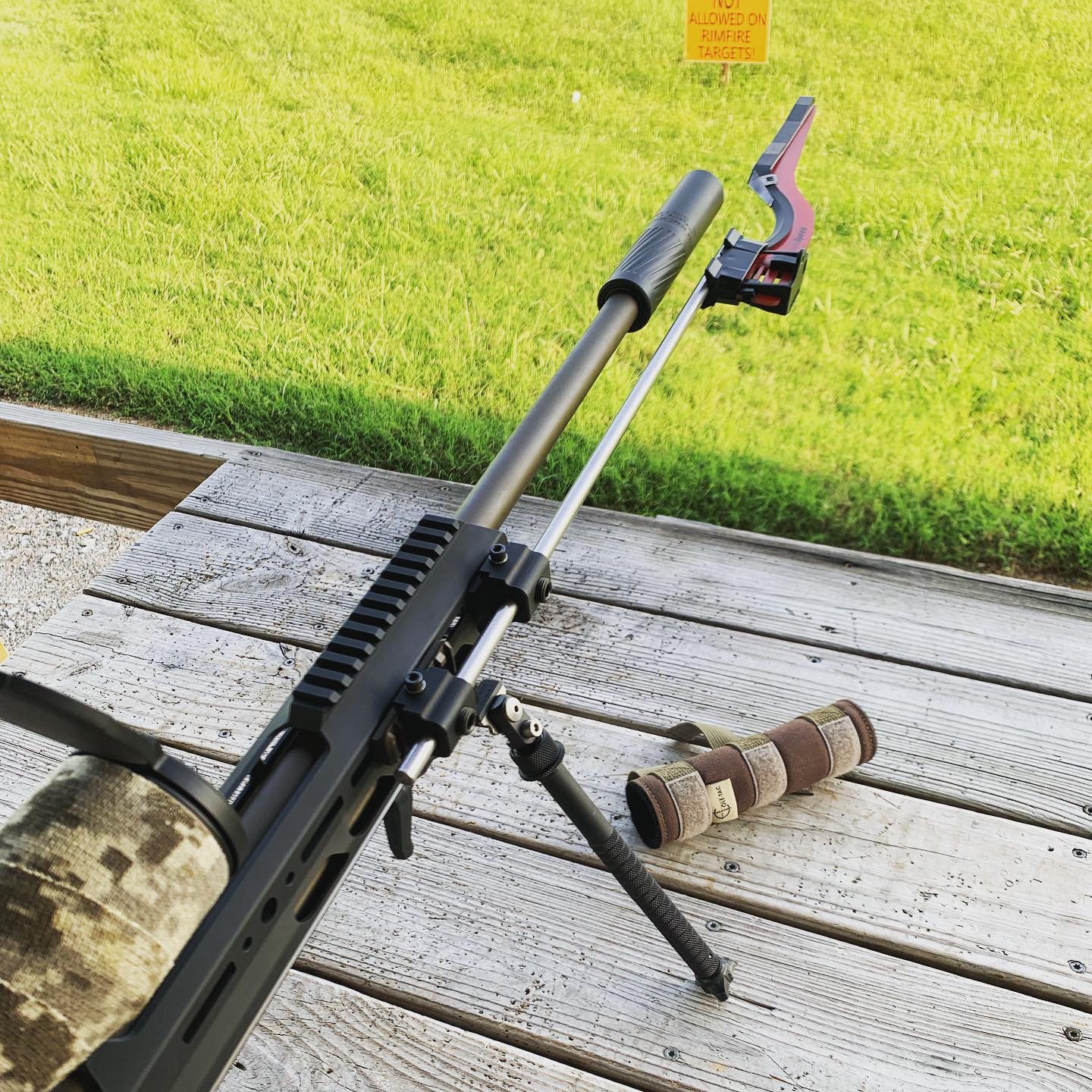

I added the enclosed forend for several reasons. First of which was to allow a spot to grip the front for baracade work with my support hand.
Secondly was to added stiffening to the system and improved magazine support . The lengthened mag well really takes all wiggle out of the Accurate Mag lockup in the chassis.
And finally - it's just badass looking. You gotta have a cool bangstick ?

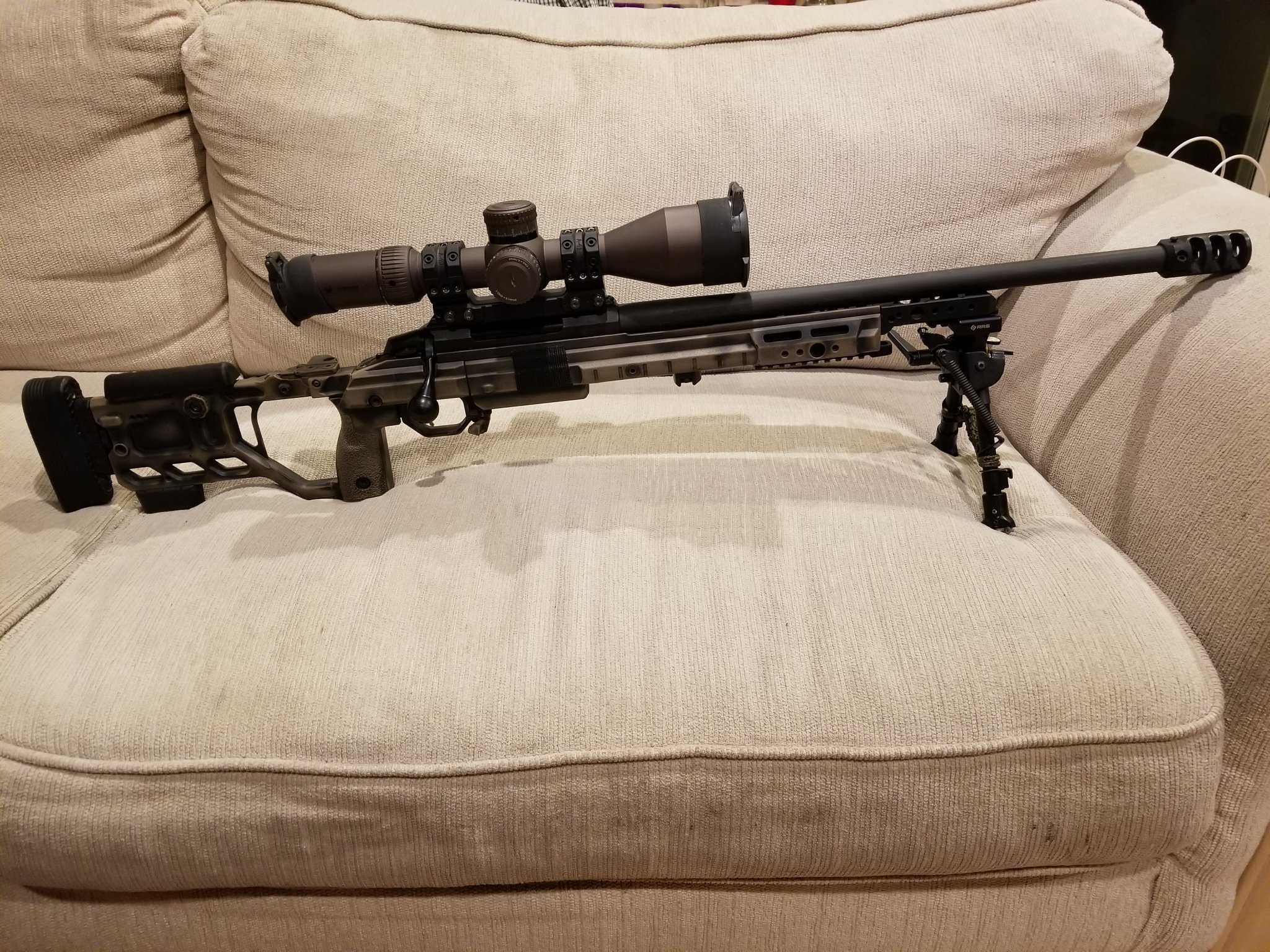

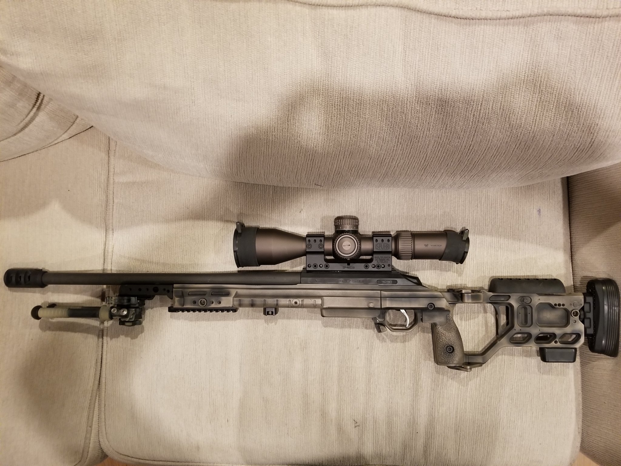

@Massoud For Remington footprint actions, are folks using 2 washers for the front?
I have my Nucleus tightened down with 2 washers up front and 1 washer for the rear. Rear looks good.

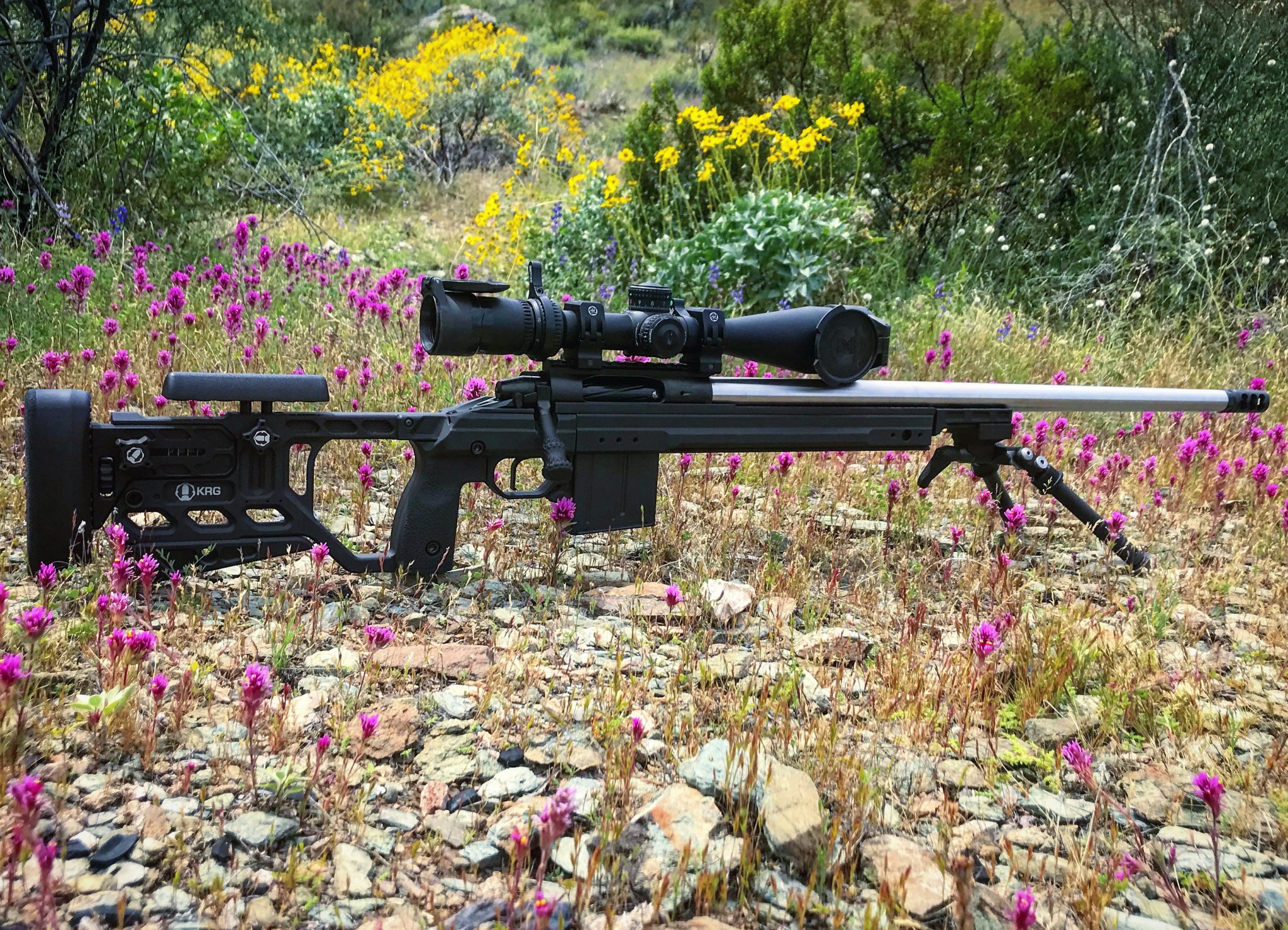

Amongst the gently waving purple mountain flowers, @SonoranPrecision finished his photo shoot with that hott blonde in the tiny yellow bikini and immediately threw down his KRG W3 for a quickie.
Or vice versa.
Reactions: Massoud

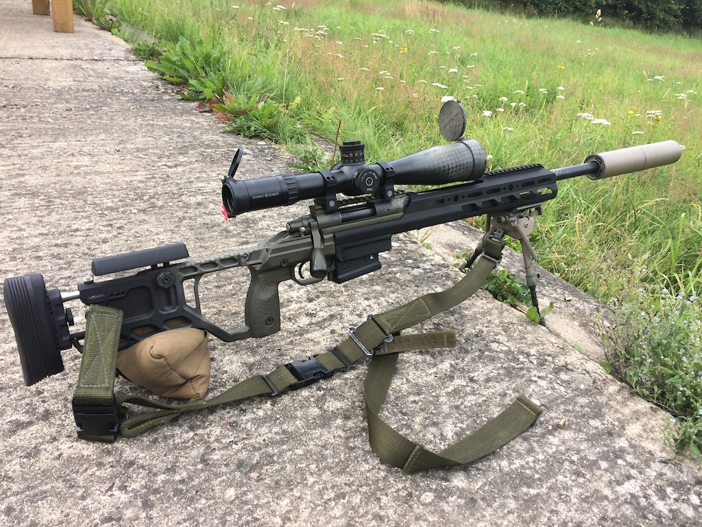

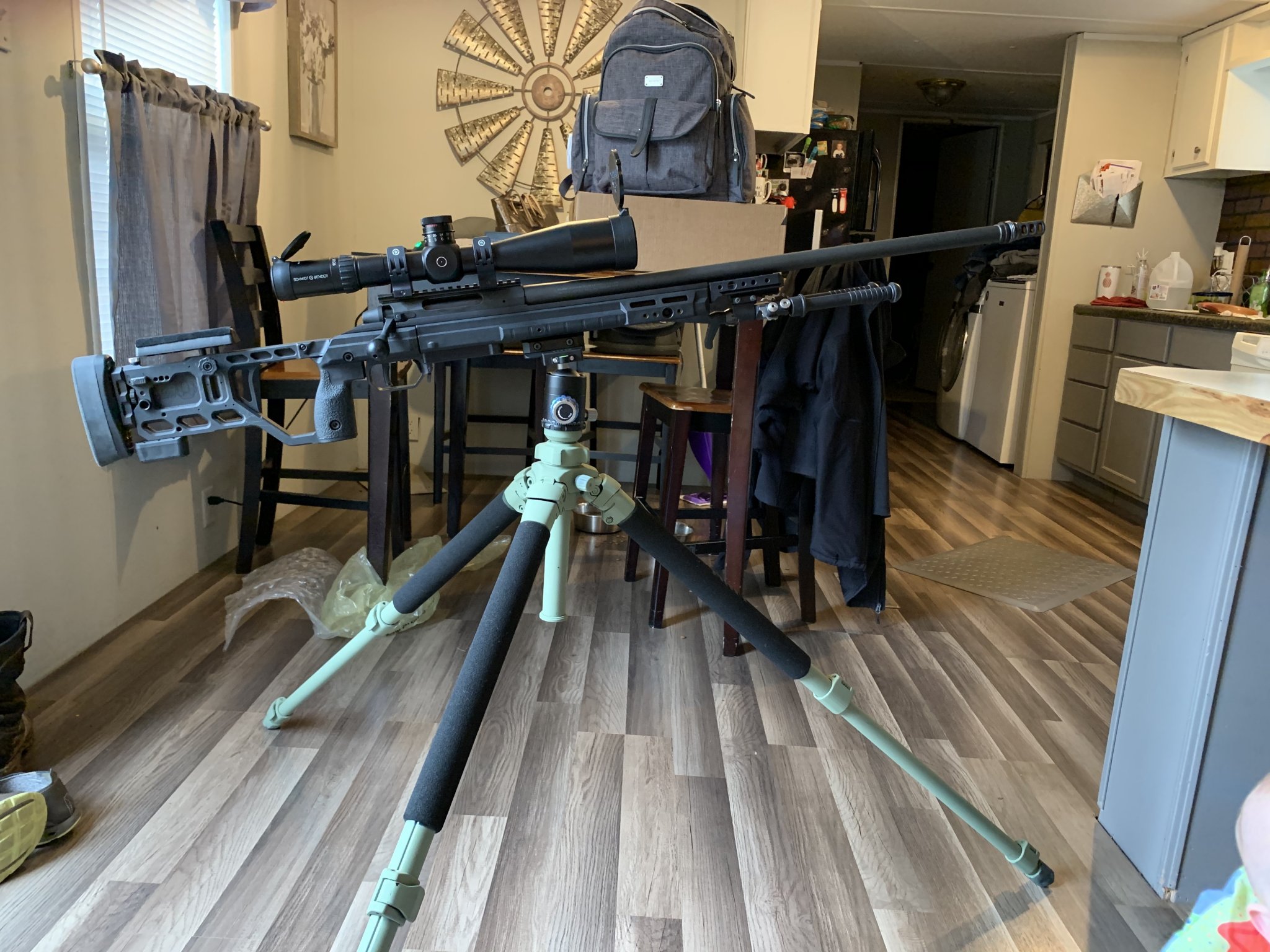

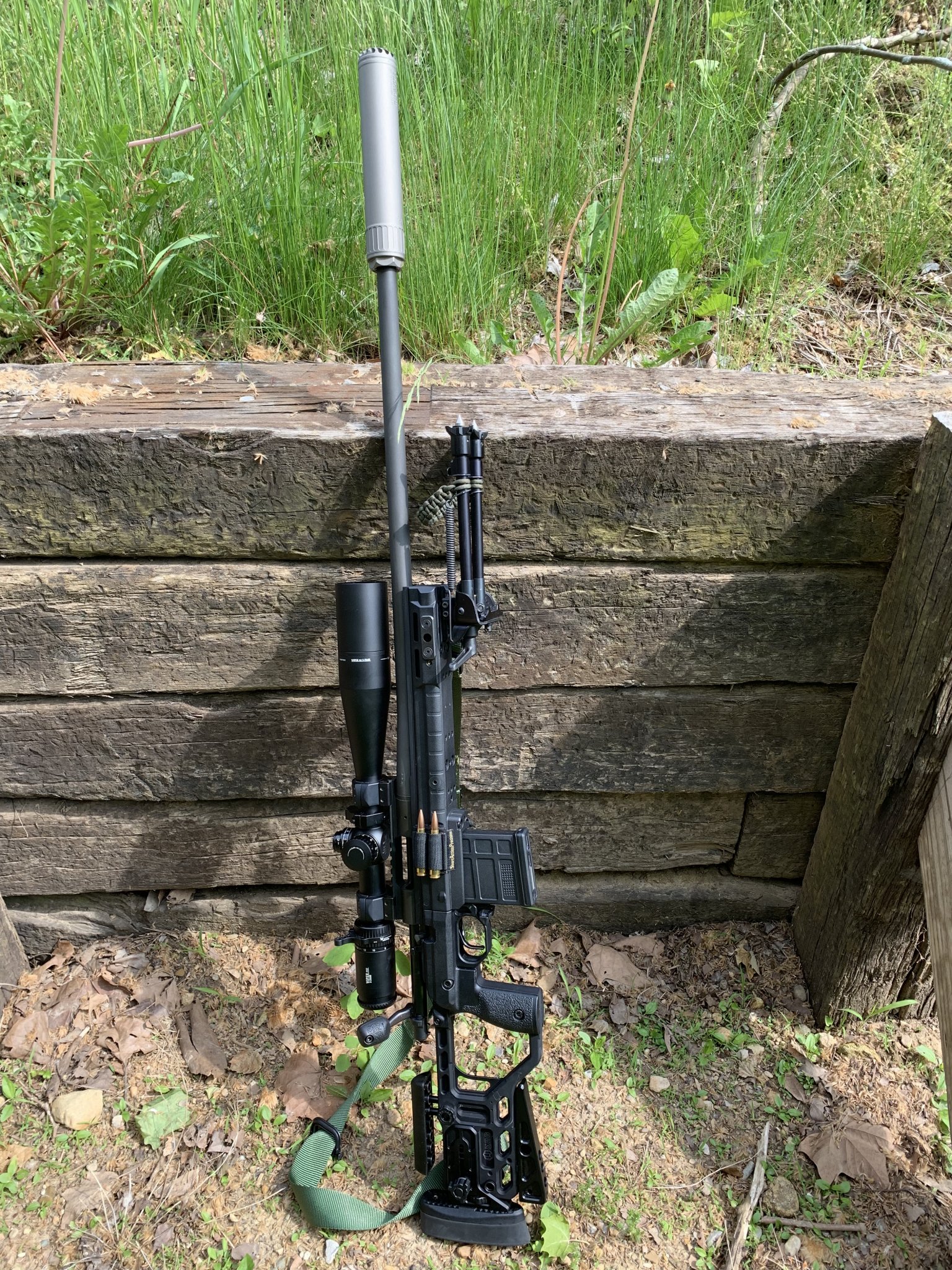

Back is a Stiller Tac30 - 22" Proof Sendero/ 6.5 Creedmoor 1-7.5tw
PVA Jet Blast Brake
TT Diamond
Gen5 Whiskey 3 folder, arca rail, minimalist spigot, and backbone NV mount
ARC 1.38" mount with 4-16x42 Atacr

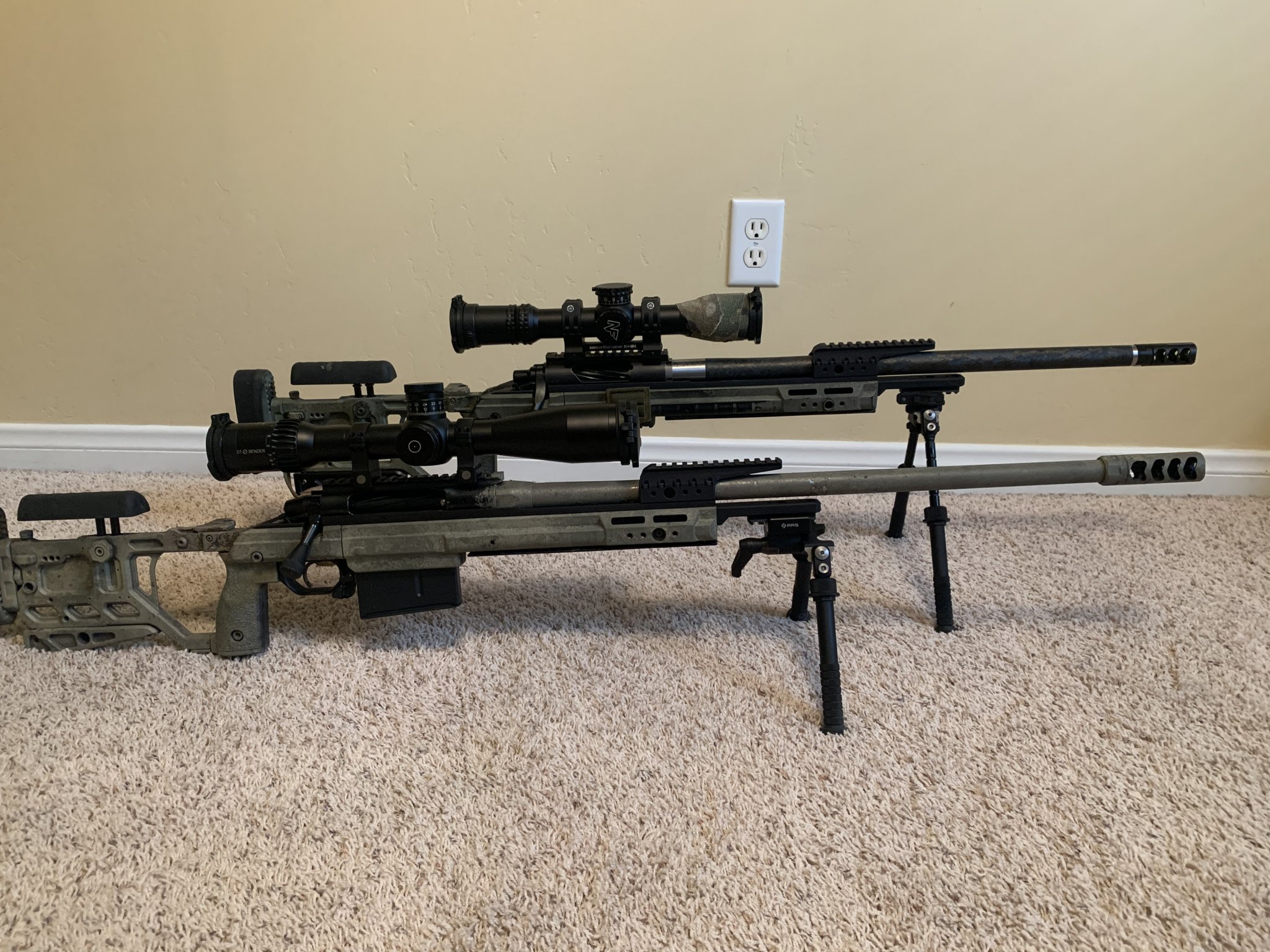

Front is a Bighorn Origin - 24" Xcaliber Prefit/ sendero contour/ 300wm 1-9tw
PVA Shockwave
TT Diamond
Franken W3 folder, arca rail, minimalist spigot, and backbone NV mount
1.375"NF Ultralight rings and a 3-20x50mm PMII

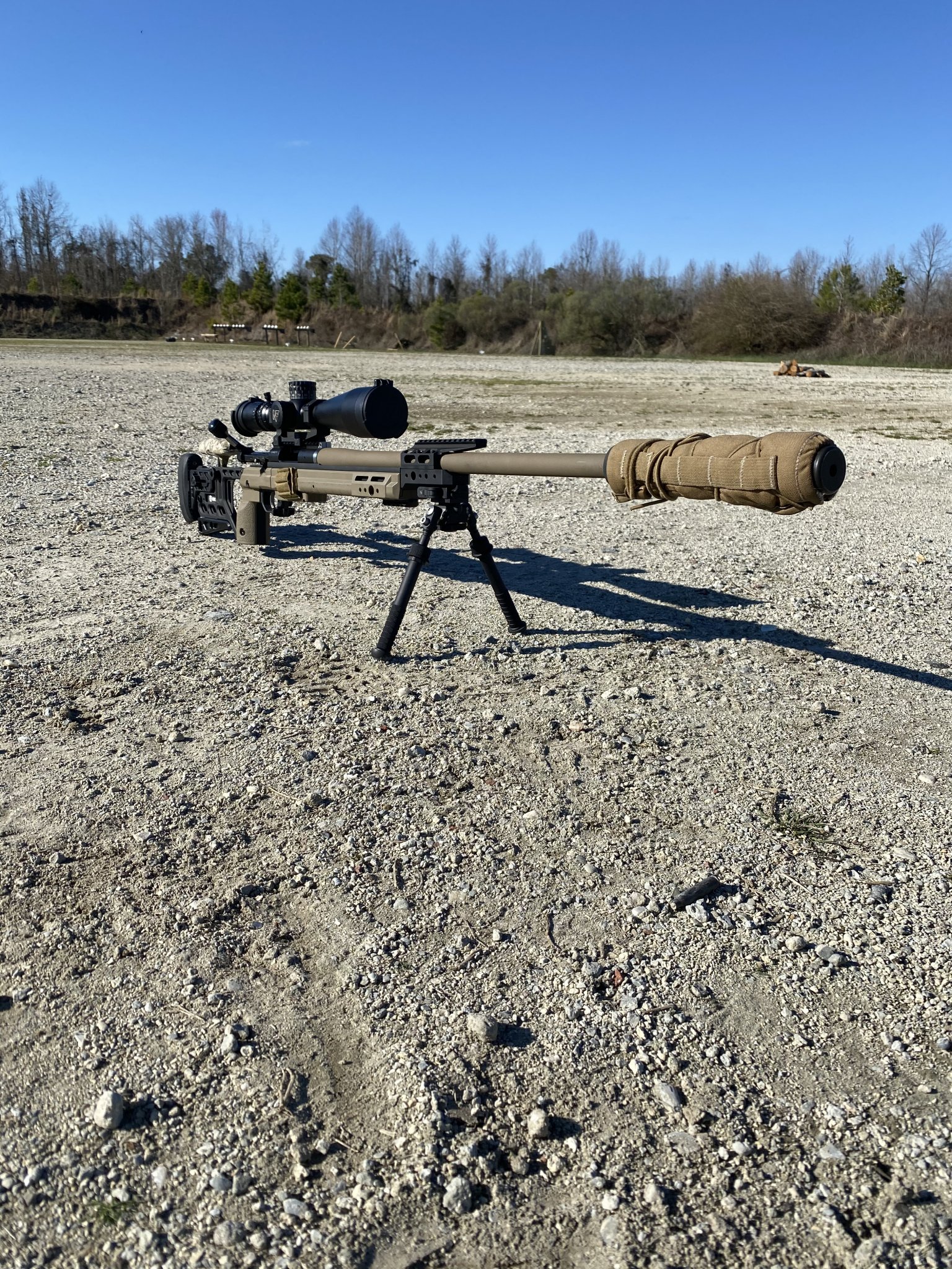

How's that OSS can?!?
Excellent! I have OSS cans on both rifles.
Where OSS really shines is in the gas guns. I did a form 1 QB direct thread can for a bolt action rifle that previously wore an OSS.
That OSS can is going on an AR-15 Pistol that I am building. Hopefully, everything will be here within a few weeks and I can start playing Legos again.
If you’re going to suppress a gas gun the OSS cans are made for that. None of my AR-15s get any dirtier nor do I have gas being blown back in my face with every shot.

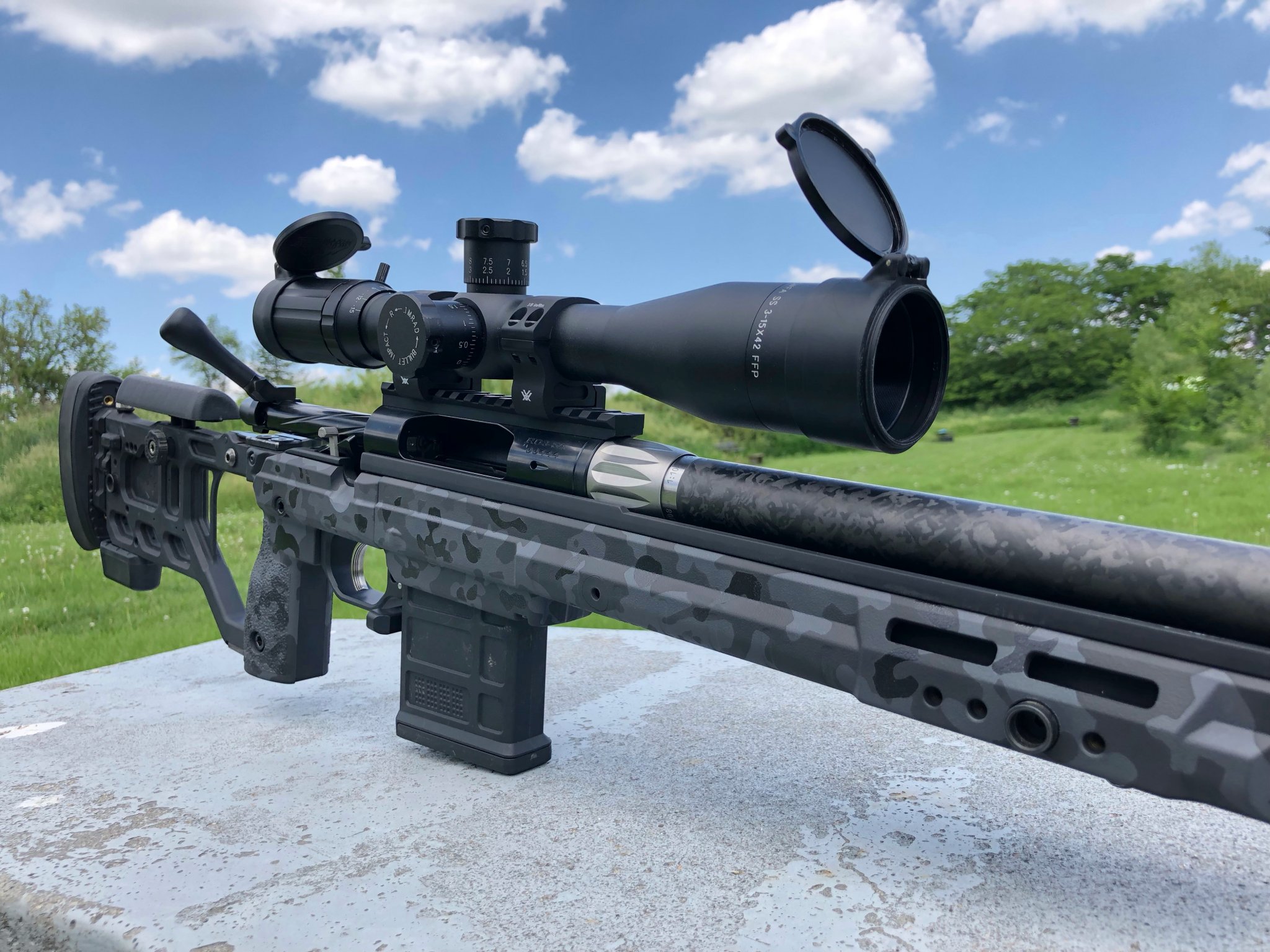

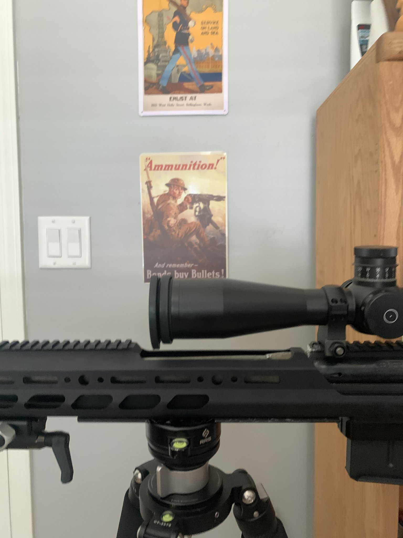

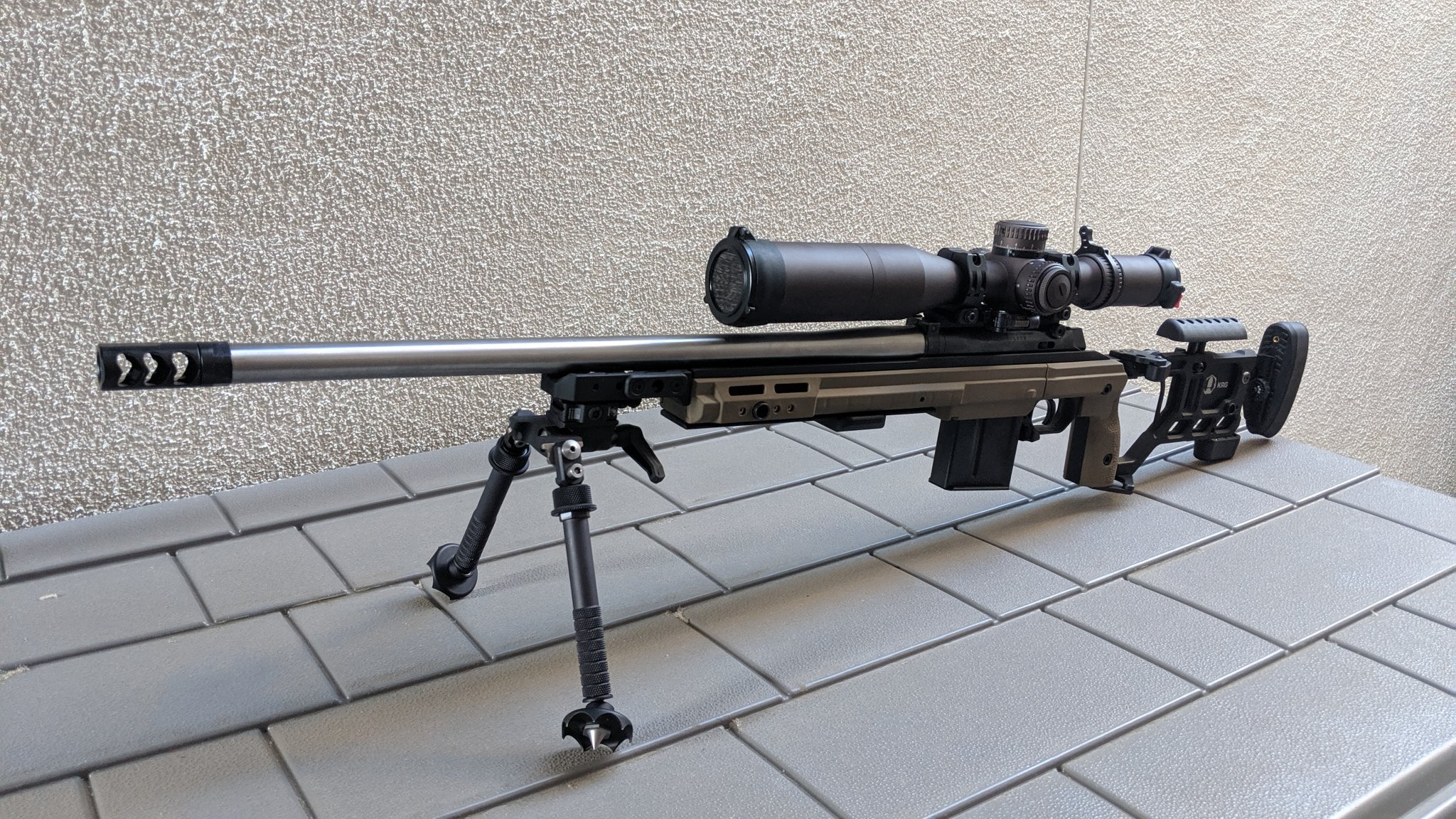

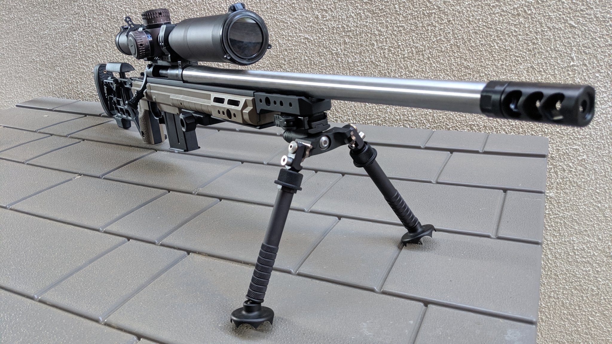

Anyone have experience running the enclosed forend with a Gen 2 Razor 4.5-27 using ARC medium (1.1") rings?
I ask because @Bandit31 mentioned in the below thread it wasn't working for his Minox.
https://www.snipershide.com/shooting/threads/krg-whiskey-3-enclosed-forend-vs-spigot.6908950/
Other question I had, I have an Origin with barrel nut, anyone having any problems with the enclosed forend on one of those? @Massoud ?
Thanks for any info.
My 300wm in my post above has a PVA barrel nut and now an enclosed forend and it fits. I had a short action awhile ago as well with a Bighorn nut and it also fits.
I'm also running a 3-20x50mm PMII in 1.375" NF rings on the 300wm above and my cap comes in contact with the bridge on the enclosed forend.
Reactions: IowaGeologist
Thanks for the info. Looks like the S&B is about 15.2" while the Razor is 14.4". Assuming I'm not running the shade I should be fine then.
