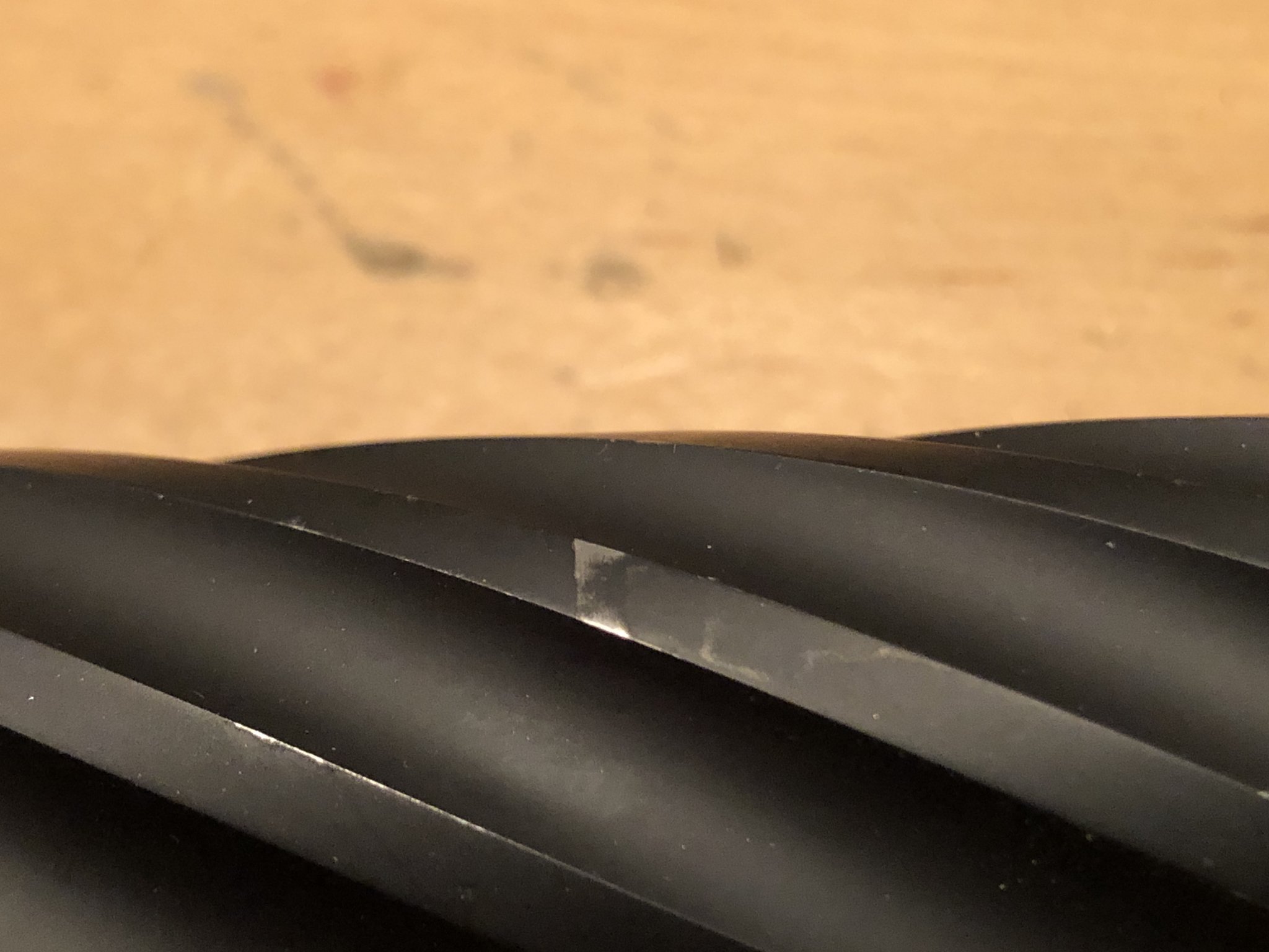

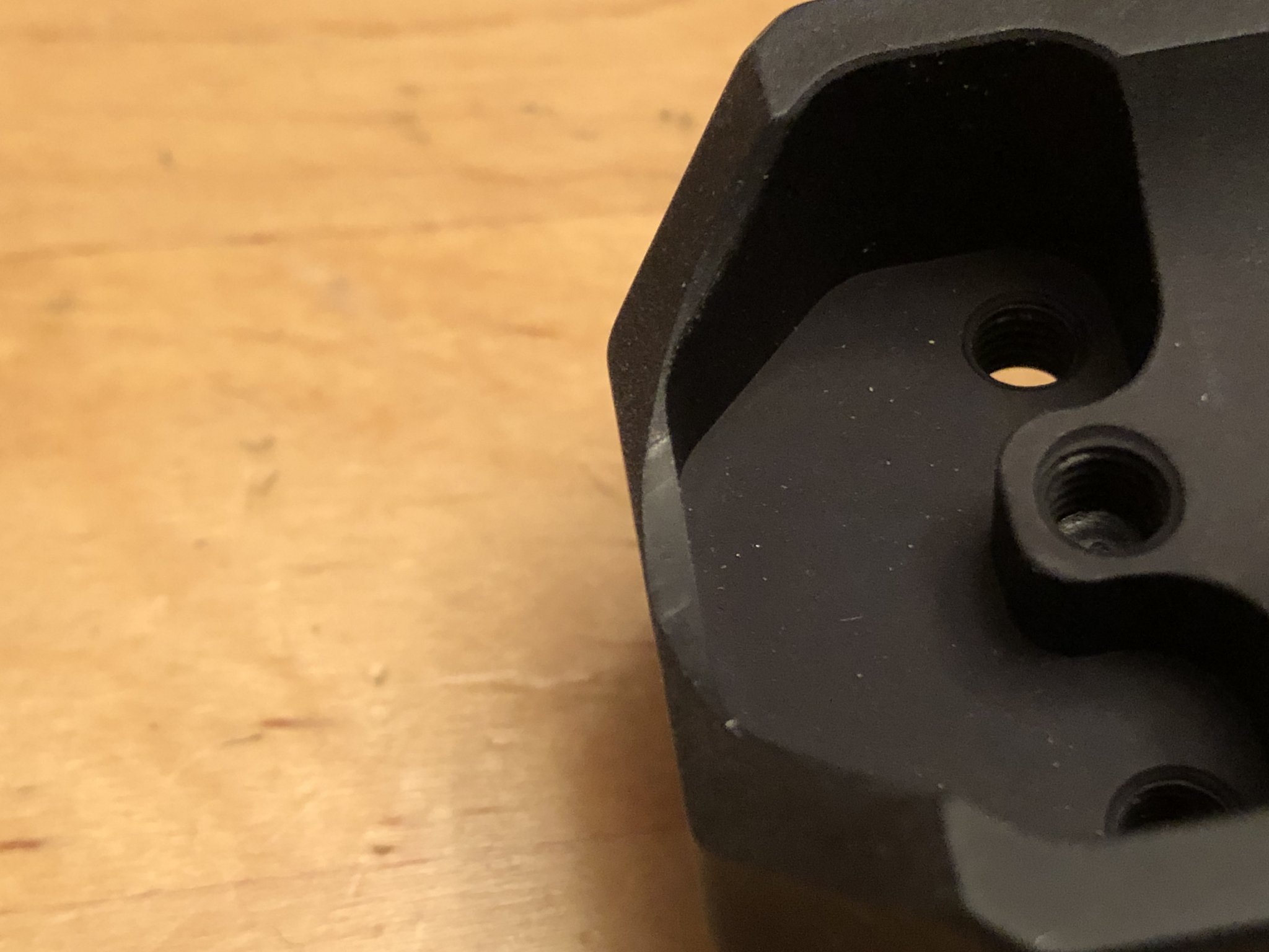

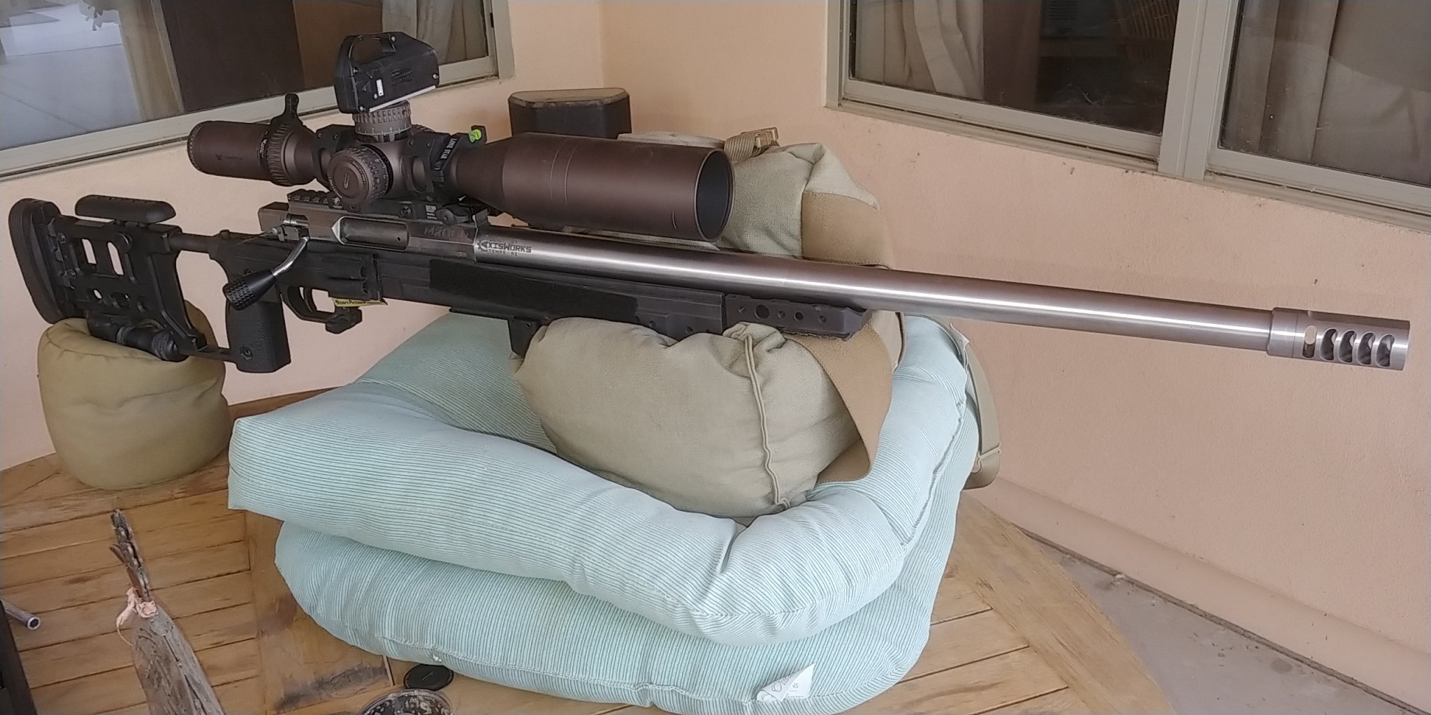

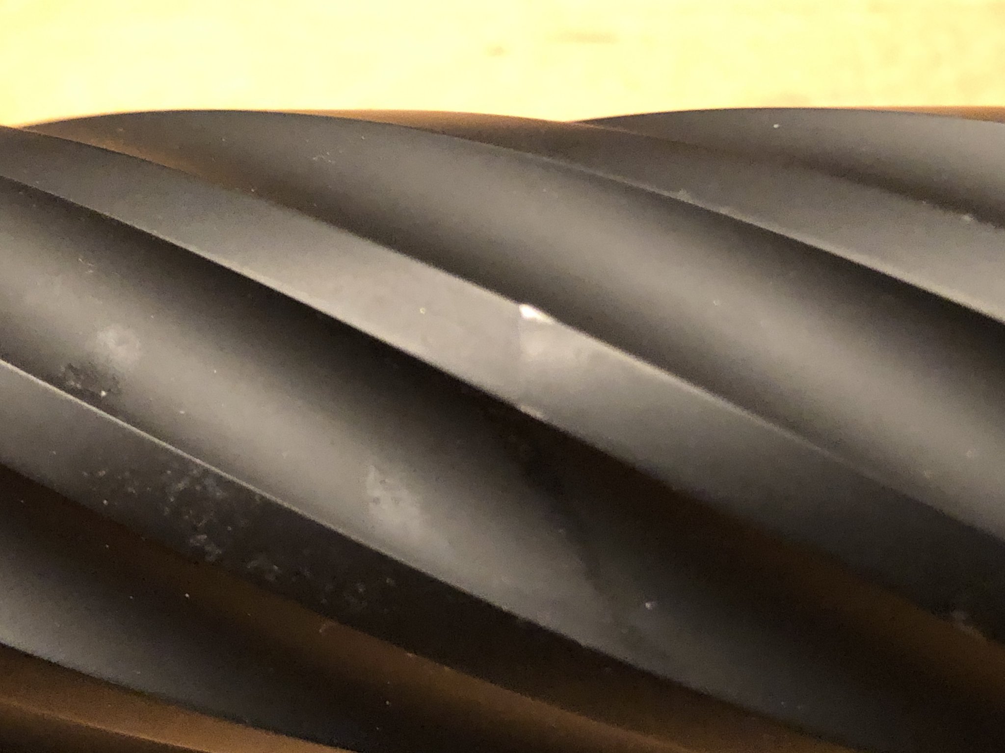

Hey fellow Whiskey fans! I have a question for you. I'm getting marks on the barrel from the barrel hitting the spigot mount. I also got marks on the barrel after removing the spigot mount right at the end of the front of the chassis. The barrel is a LRI prefit for the ARC Long action I have mounted in the chassis. The barrel is a Heavy Varmint contour and it is spiral fluted. Has anyone else had this problem?
The barrel appears to have enough clearance, well, no more or less than say a Manners stock has around the barrel. Seems like the barrel would have to flex quite a bit to hit it. I'm kind of at a loss here and I'm getting some inconsistencies and not sure if its my shooting or the
The first picture is of the contact with the spigot after a couple hundred rounds(actually a small dent in the end of the spigot mount from the barrel) and the second picture is after removing the spigot mount and shooting 50 rounds. Any idea? Contour too big? I see others using the heavy varmint contour and have to seen any post about contact.
On the KRG website they state the barrel contour should not be over 1.200" to the end of the aluminum chassis (not the spigot}. It is under that.

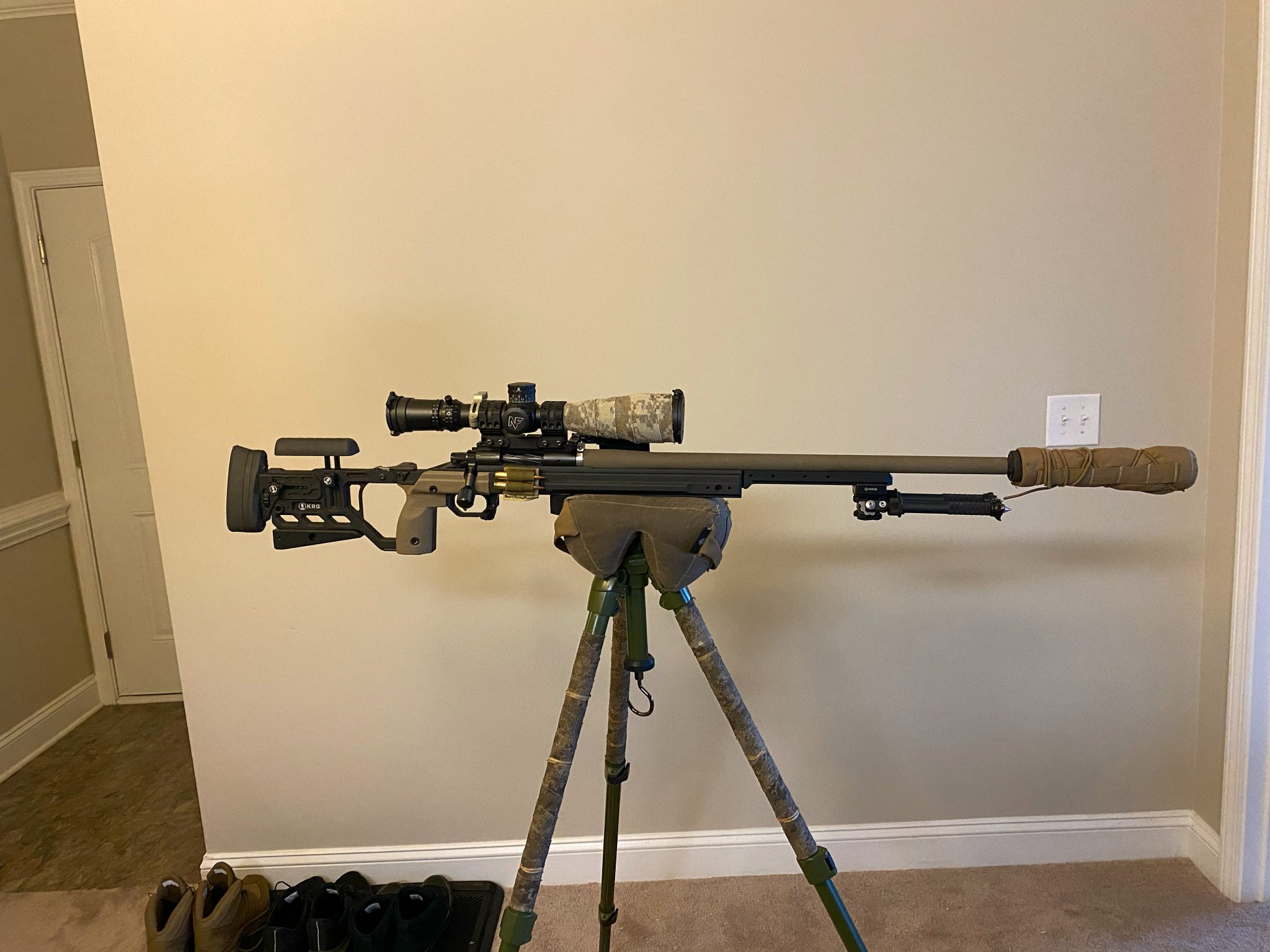

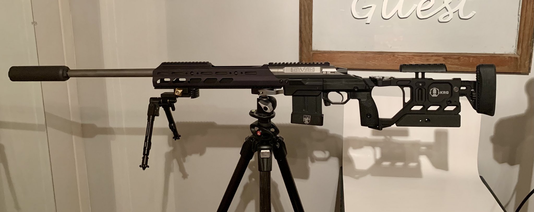

I've been wanting a W3 folder for years. Watching the PX, apparently I'm not alone. These things disappear fast when they go up.
The ergos are much better suited to me than those of my McMillan A5 with an adjustable cheek piece. I don't know what's up with my face, but I really need some elevation on the cheek piece to get my eye lined up while prone.

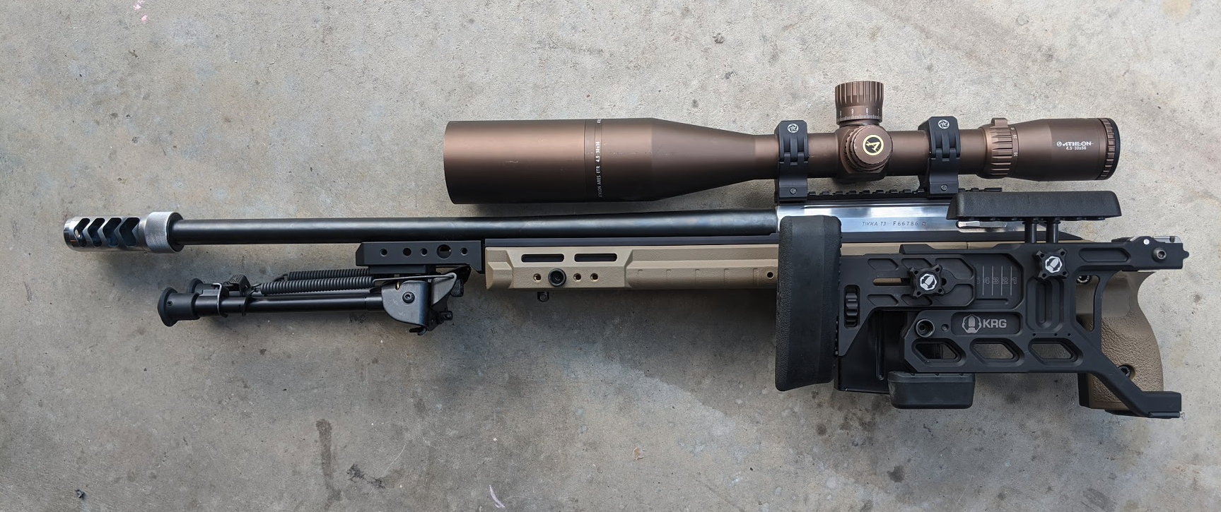

Specs:
Tikka receiver from a T3 Lite .270
Tikka CTR .260 20" barrel bought off the PX
Area 419 Sidewinder
Harris S bipod
Athlon Ares ETR 4.5-30 MRAD
Mountain Tactical trigger spring
Sterk bolt handle
Nightforce 20 MOA rail
ARC M10 Rings
KRG Gen 6 W3 Folder
KRG Spigot and Bipod spigot mount
View attachment 7413746View attachment 7413747View attachment 7413748

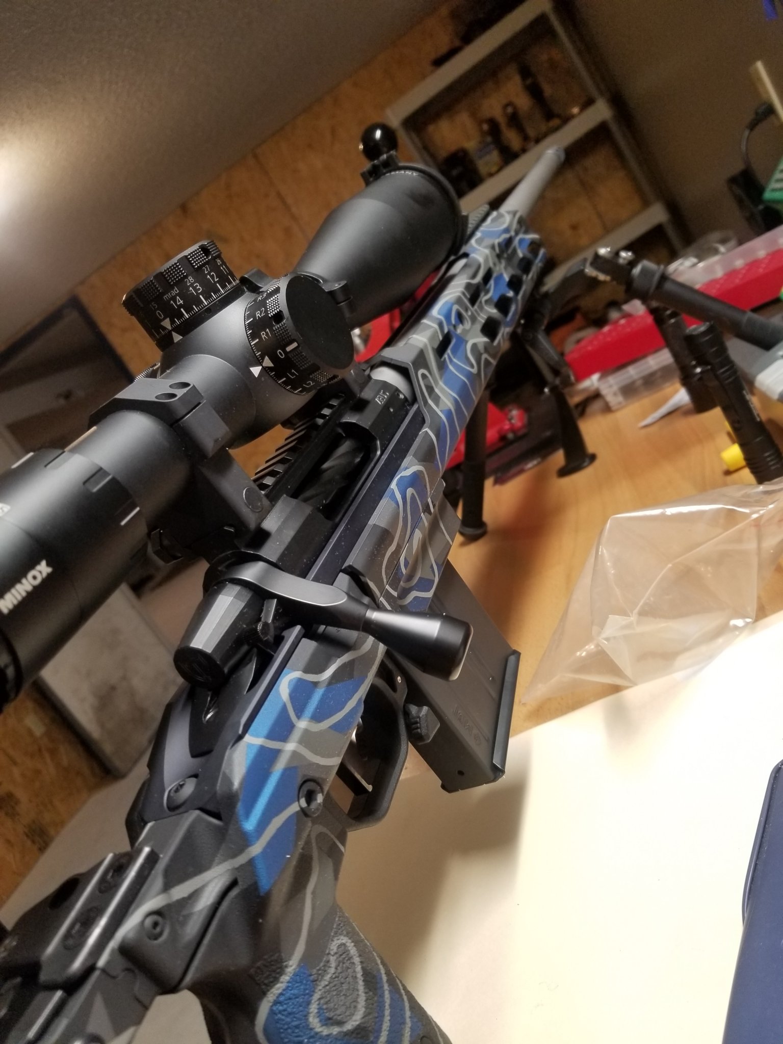

I’m considering making a switch to AW mags. Is anyone running AW’s in a whiskey 3 and TL3? What, if any, modifications did you need to do? Mag catch height adjustment? Feed lip adjustment?
The mag latch will probably need about .010-.020" milled/filed from the top, otherwise the mag may sit just high enough it may interfere with the bolt face. It's a 5 minute job. KRG sells replacements if you ever need to roll back. If you are filing, secure the latch in a vice and take even swipes across the latch top so you don't create a curved top.
As for feed lip tuning, if you find the round doesn't get release soon enough for the nose to clear the barrel breech, the very front of the feed lips should be opened up. It only takes a very small adjustment, so much so you don't think you made any change. Because the AW are true double stack/double feed, the right and left feed lips work independently. So, test and adjust rounds feeding from both sides.
In my opinion AW mags are the smoothest feeding mags to be had. They are well made, compact, and can be topped off from an open bolt (which means you can correct a double feed without dropping the mag).

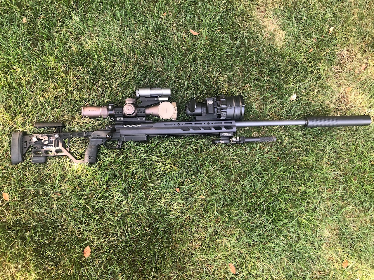

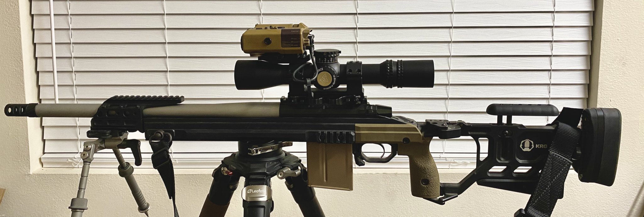

Small update, treaded my enclosed forend and went to the arca forend and the new XL Spigot and I love. I think the NVG will really tie the room together. (If anyone is selling one pm me)View attachment 7489090
why did you opt to trade the enclosed forend for the Arca? I have the enclosed forend with full length Arca and like it a lot but I’m always looking for new/better stuff
So I like the enclosed forend but I always like the spigot and NV mount looked, and with the new XL spigot I have much for flexibility. Also weight!! the way the rifle was before I was 17lbs now as you see I’m at 21.8lbs. In the forend is a Raven Rock weight and a few KRG weighted accessories. Now I can easily go from a PRS style match were weight is your friend to a Mammoth type match were having a 20lbs plus rifle isn’t gonna be fun to ruck with and everything you need for 3 days. So it came down to being able to add weight and have a longer ARCA set-up.

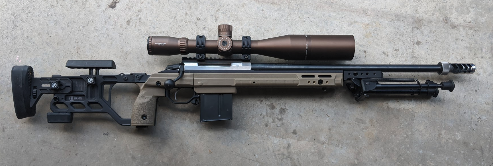

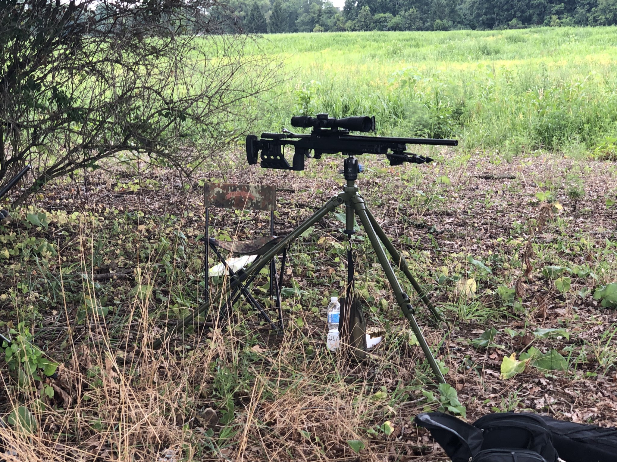

Seekins Havak in .260 REM
KRG folder with enclosed forend and full length ARCA
TBAC Bipod with Area419 mount and Barricade stop
Craigslist/eBay tripod setup Manfrotto tripod with RRS BH-30
Spuhr Mount and Leupold Mark 5 7-35 on order
