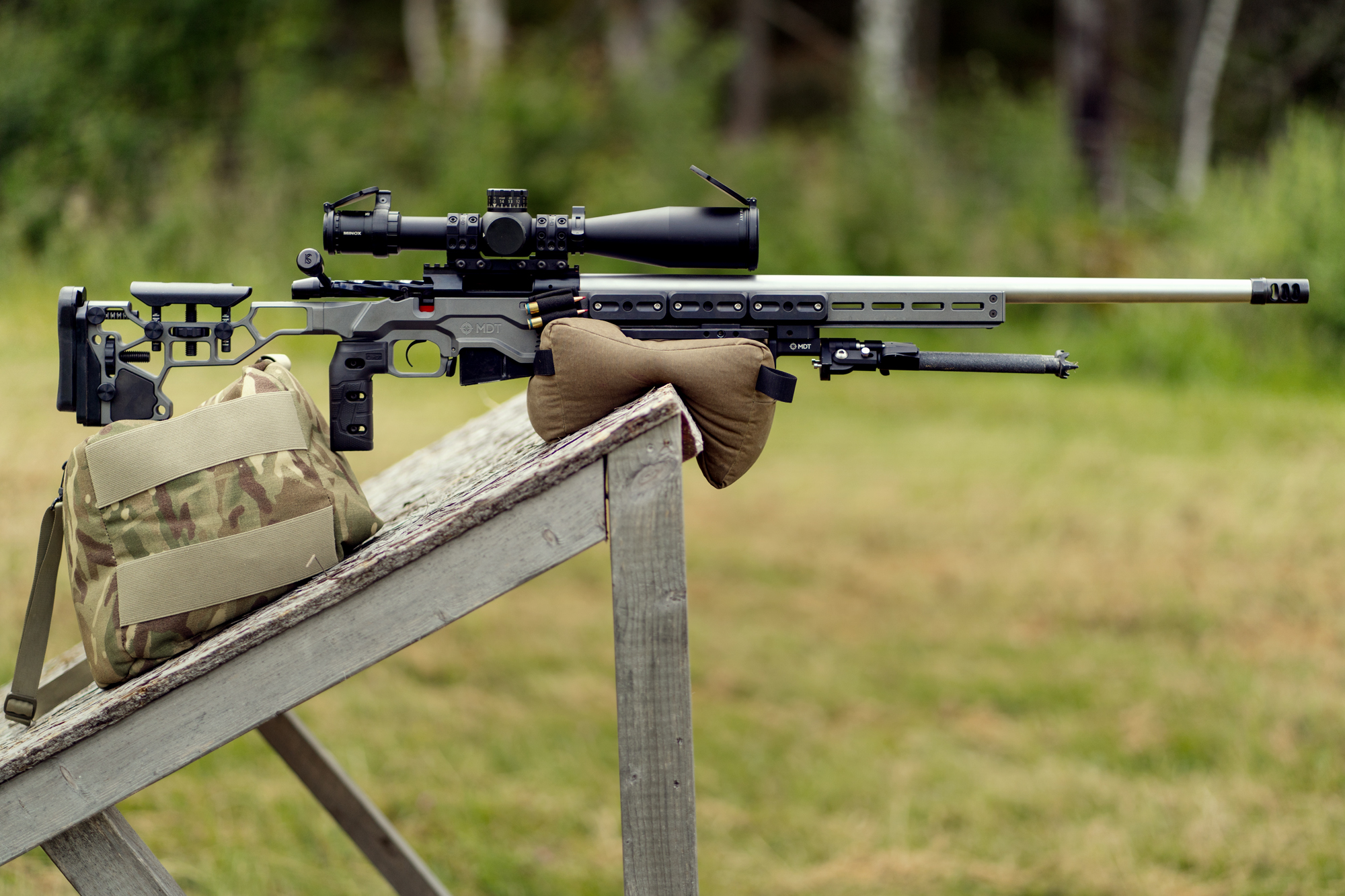

I have a KS arms SAR in 6 Dasher, KS arms wolverine in 6.5 CM and a KS arms wolverine LA in 284win.

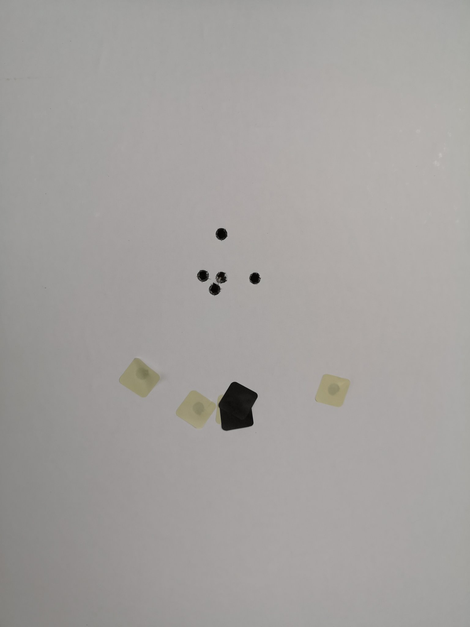

This was prior to my last 2 day match. 10 consecutive shots in two 5 round groups, yes I pulled one.
Gen1 3-lug action, KS barrel and chambered by Karl at KS. Shot at 100m.

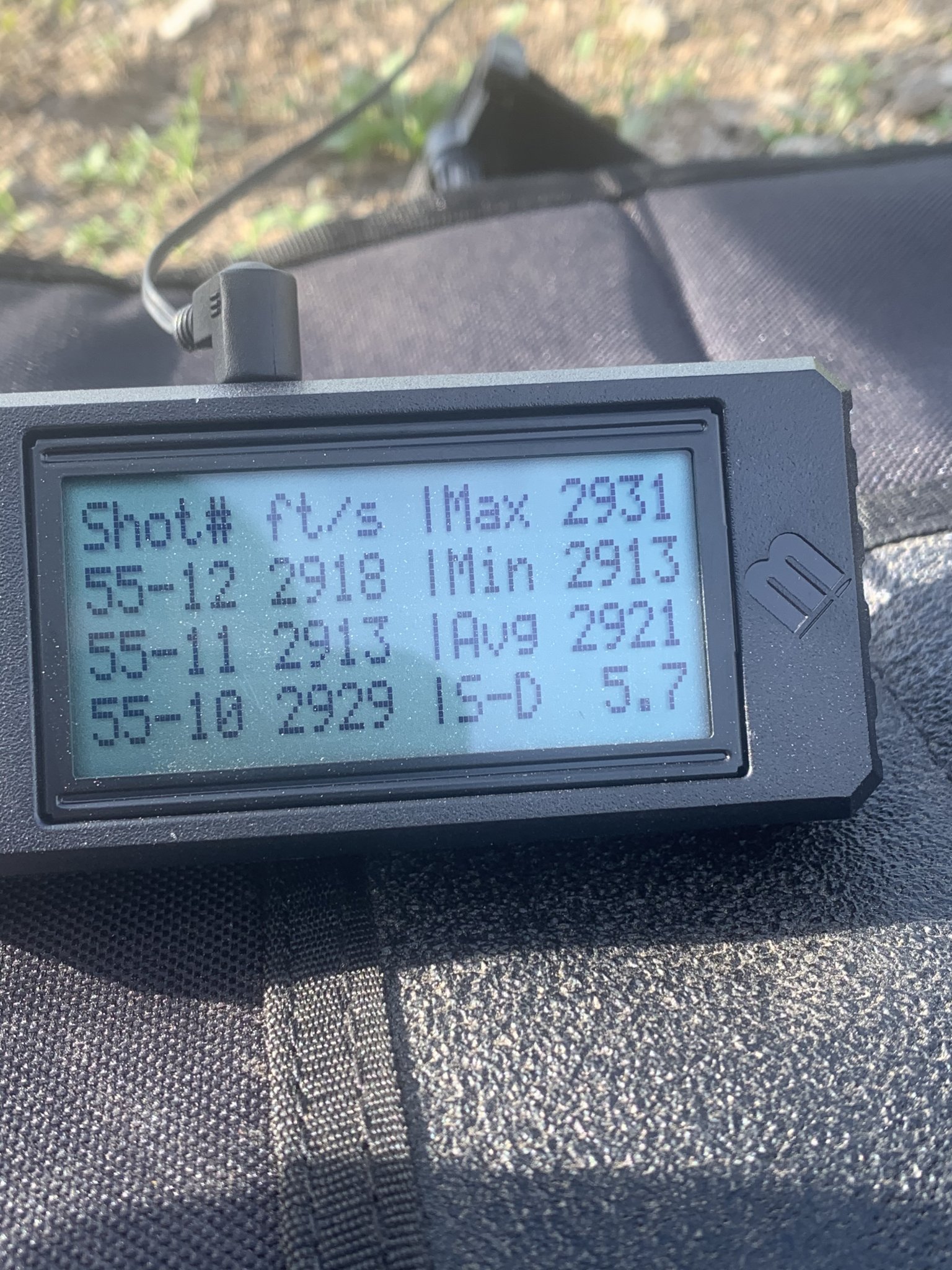

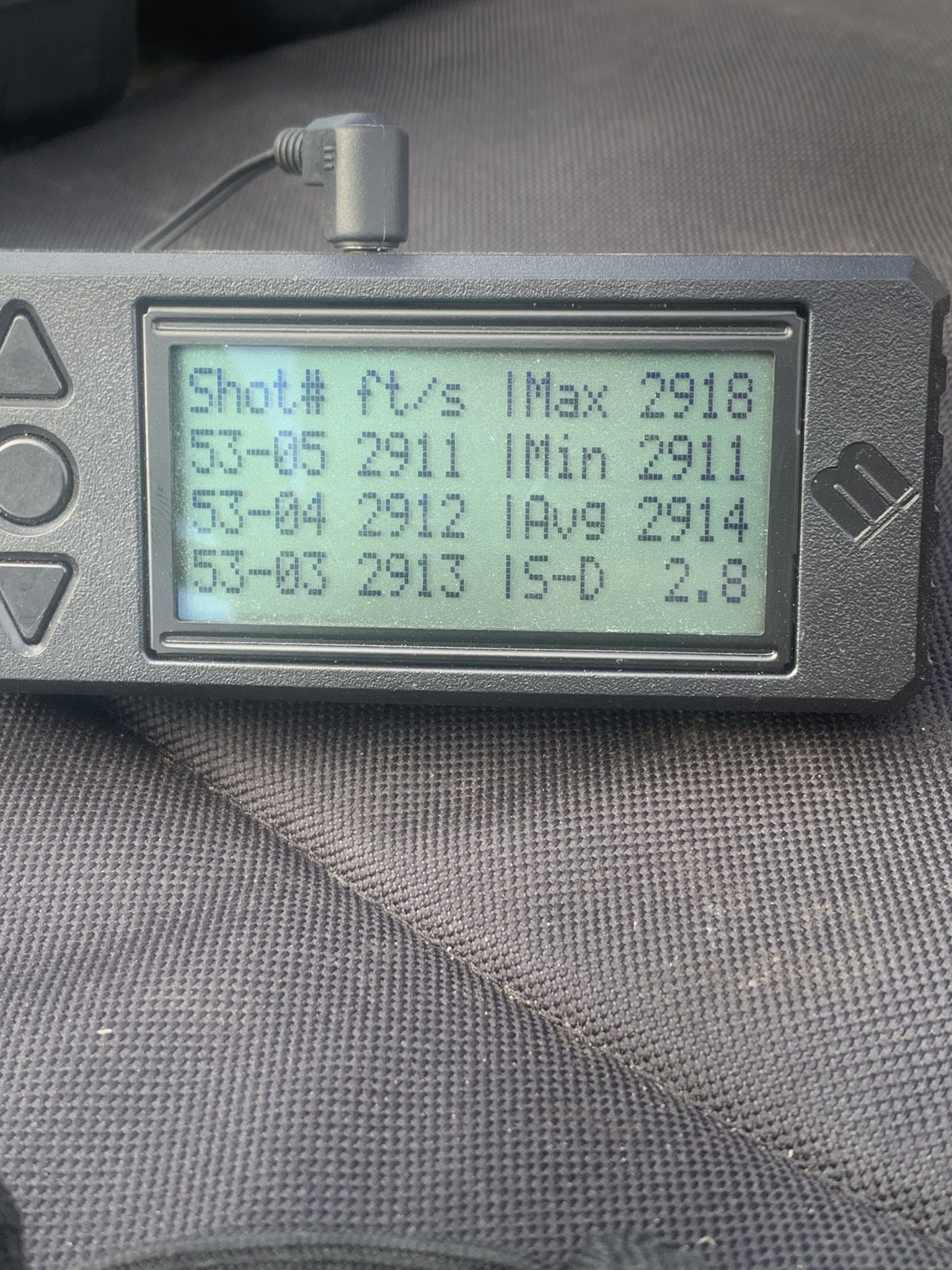

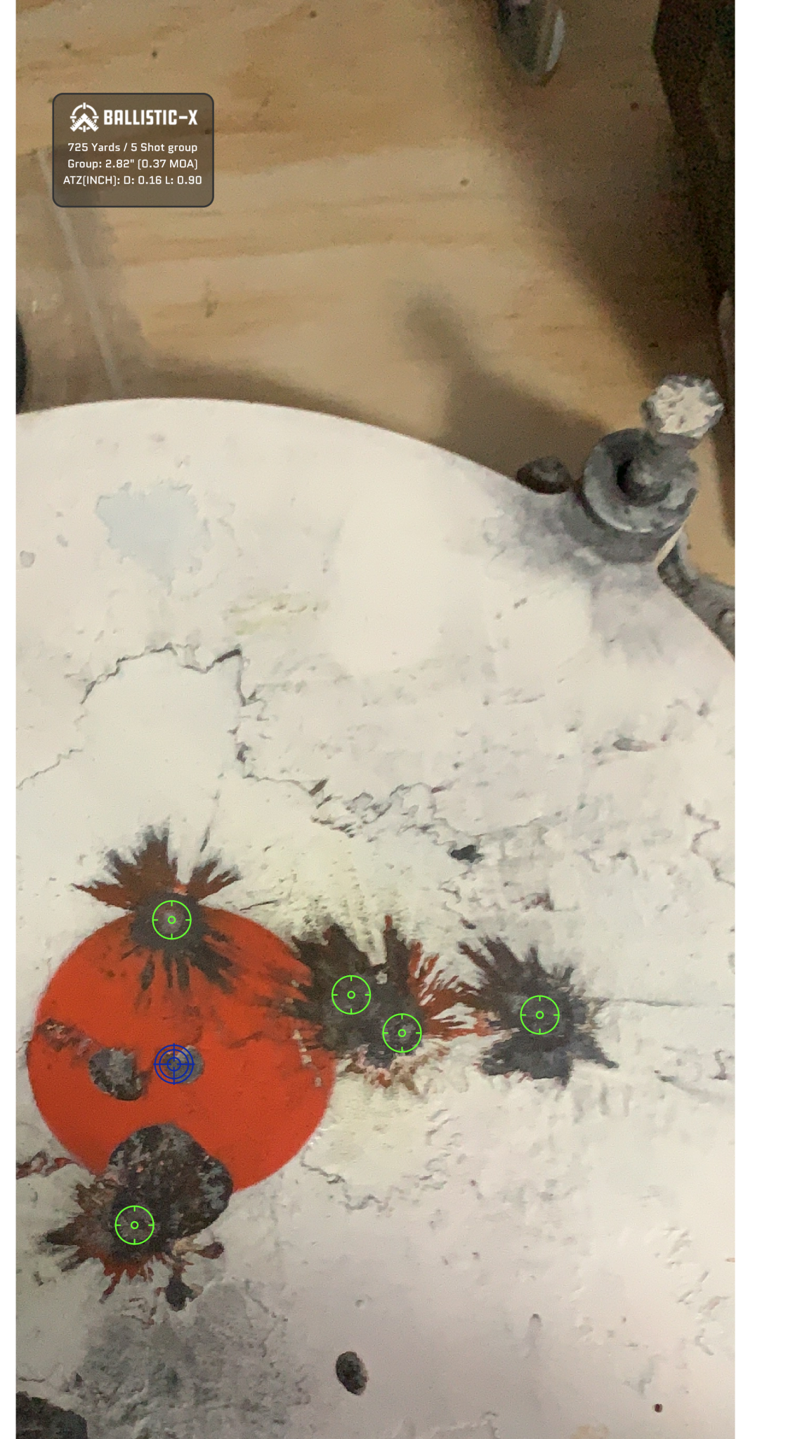

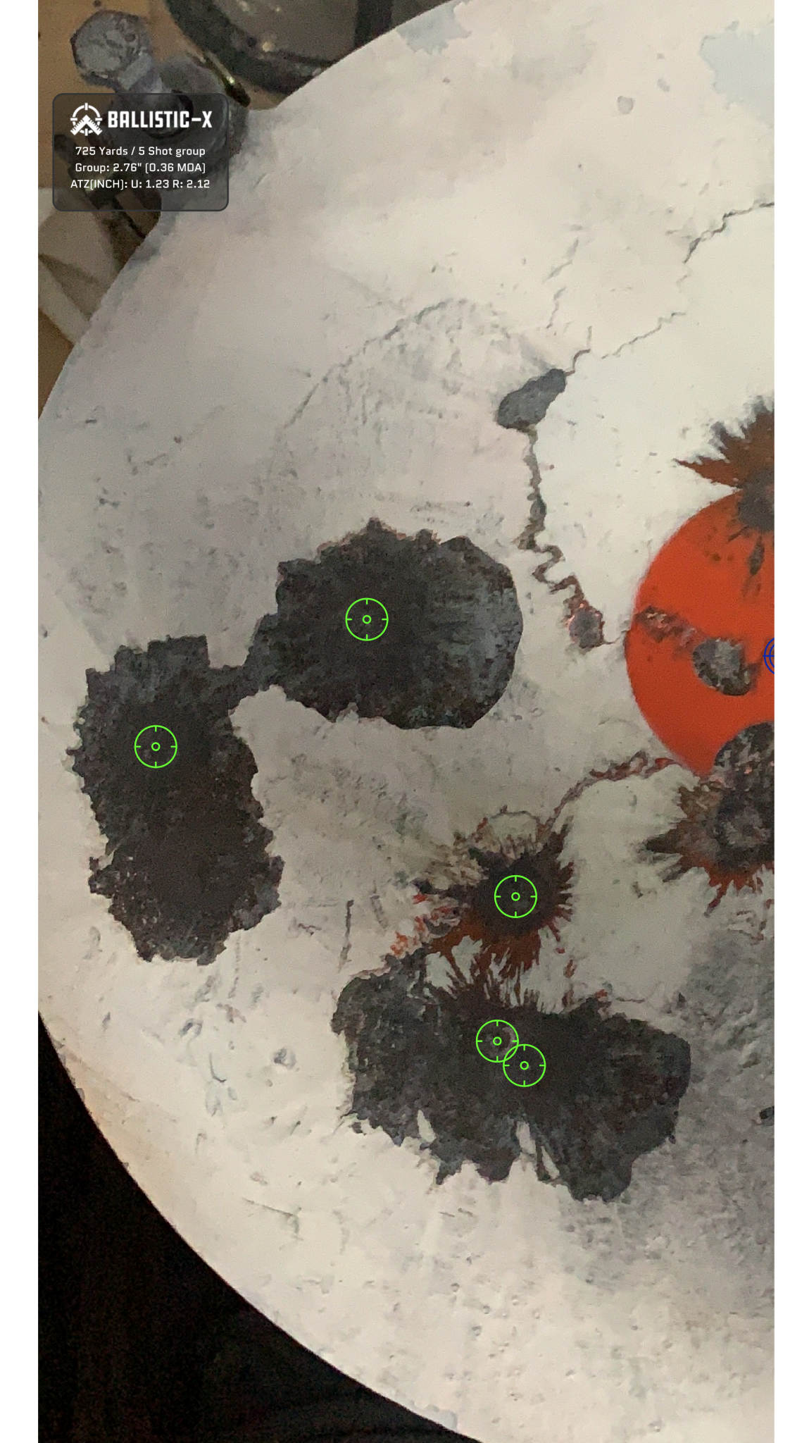

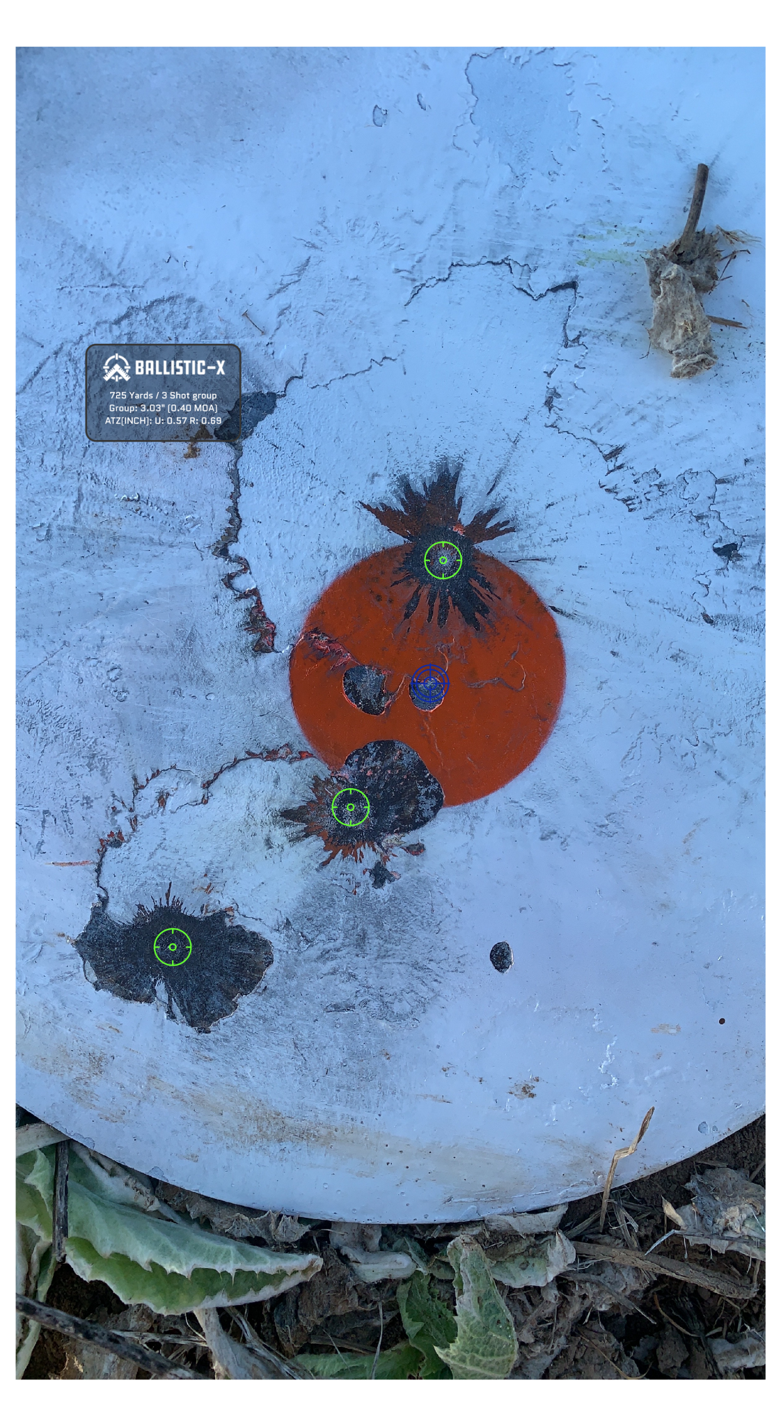

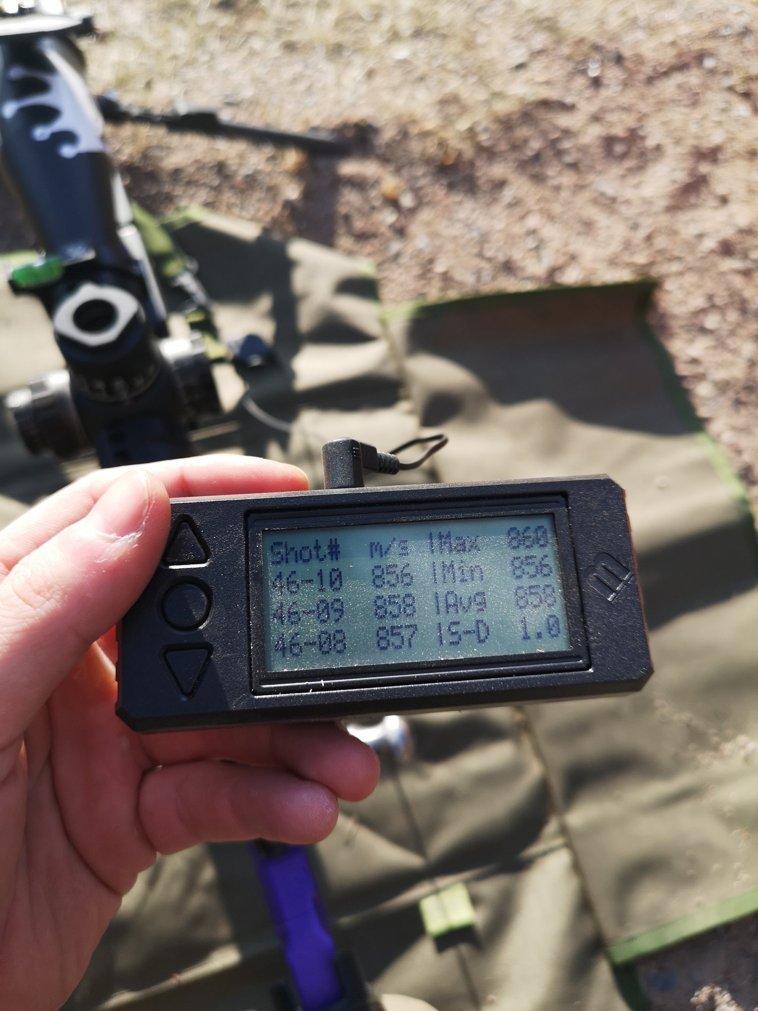

I own 1 ks barrel in 25 creed! Barrel has been super easy to clean, broke in fast, doesn’t seem to walk when ran hard and hot, easy to load for. Average groups are .4-.6 at 100 during load development but at distance they seemed to do better. Was able to shoot much better then that but I’d say that was about average. It was super easy to get to shoot well. Never had any group larger then 3/4 moa I don’t recall! I believe that is more of the bullet then barrel as ive seen many say that about the blackjacks shooting better at distance then at 100. It seems to shoot in the .3’s-4’s out to 750 the furthest I’ve taken it. Will order another for a 6bra build and would assume it to shoot slightly better just based on caliber alone.
Also have there latest gen 3 lug sar action on its way for a 20 tactical build. Hoping it should be here in another 2 weeks and build should be assembled in another 3 weeks past that. Will be testing them against defiance, zermatt, terminus, Curtis, kelbly and stiller. Very excited to try there action! Been a long time debating

Very nice groups at that distance! Are you using Peterson brass?
Reactions: Matt_3479
That is alpha brass. I would have to check my load but If I recall it’s 41.4gr’s of rl-16, alpha srp brass, cci 450, and 131 blackjacks. Barrel is a ks 1:7 twist 25 cal medium Palma. Been extremely pleased with the barrel. Ordered another in 20 cal to go with the ks sar action. Eveehthing is at the smith. Would of had ks do the chambering but they didn’t have the reamer

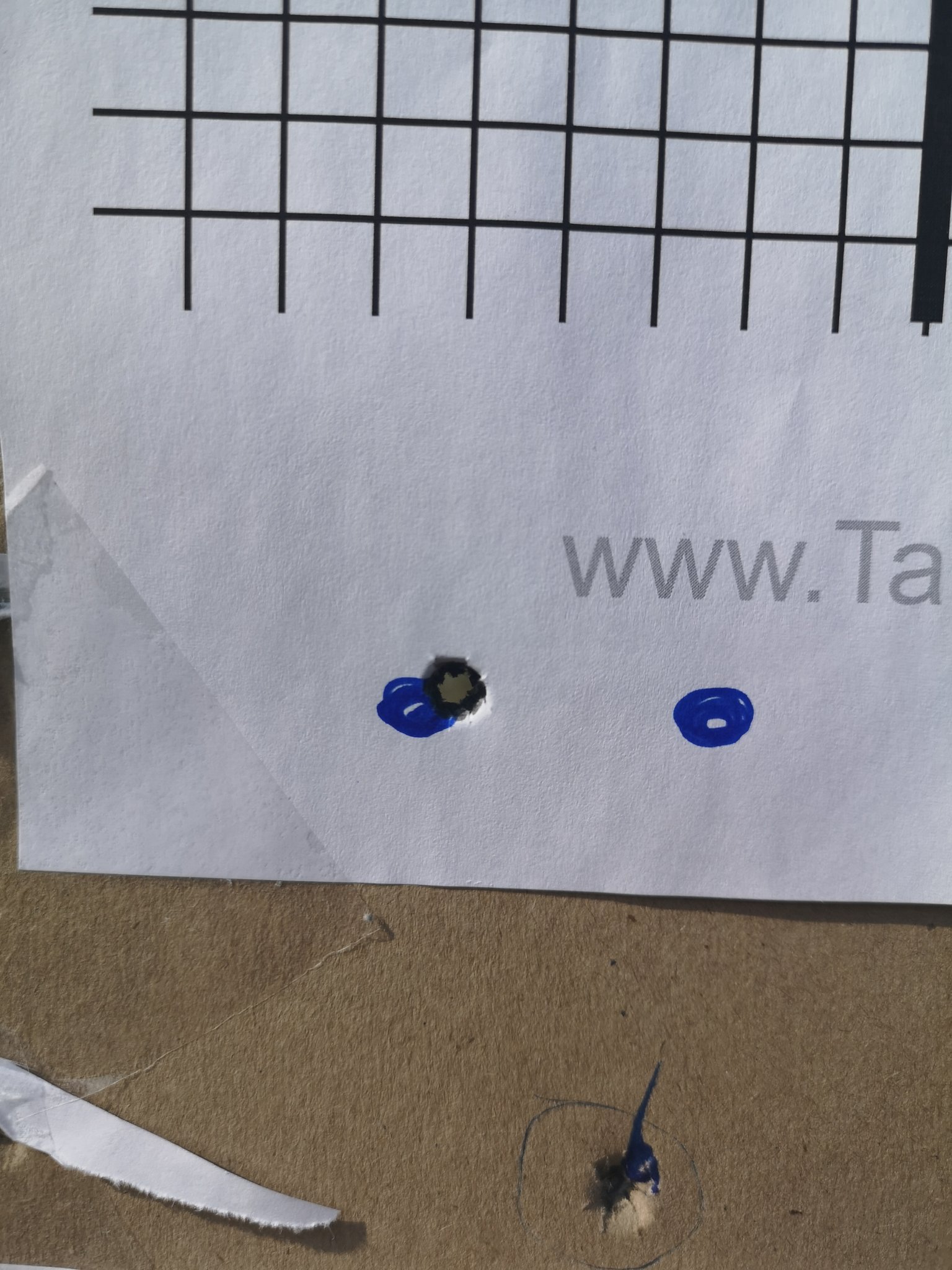

This is a 5 shot load development group at 200 yards with only 45 shots on my K.S. Arms gain twist 6BR barrel on my Nucleus. Shanked the 5th one pretty good.
I let a friend who’s more of a dangerous game hunter than a precision rifle shooter shoot a few at 200 as well. 2 on one and 1 on the other. He held in the box rather than the diamond. When we collected the target he said to me, “that is without a doubt the most accurate rifle I have ever shot. You’ve build yourself something very special there.” He’s in his 60s and been shooting all his life in the Australian outback. Lives in Canada now and goes on dangerous game hunts in Africa. We had just finished sighting in his custom Mauser in 404 Jeffery.
Now we’re coming up on 1.5 years since it was 2 weeks to flatten the curve, we’re in our third draconian lockdown, and all the ranges are closed. Barrel has a 100 rounds on it, and is now screwed onto an Archimedes action that hasn’t been fired yet.
