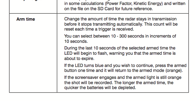

Why is it that when I arm the radar the light turns orange and then it starts blinking orange instead of staying solid orange

Also, as noted in Post #5, the arm-time is programable, and the orange light will begin to flash to let you know that the unit is about to go from Armed back into Standby in 10 seconds. Check to see how long yours is set to stay Armed.
