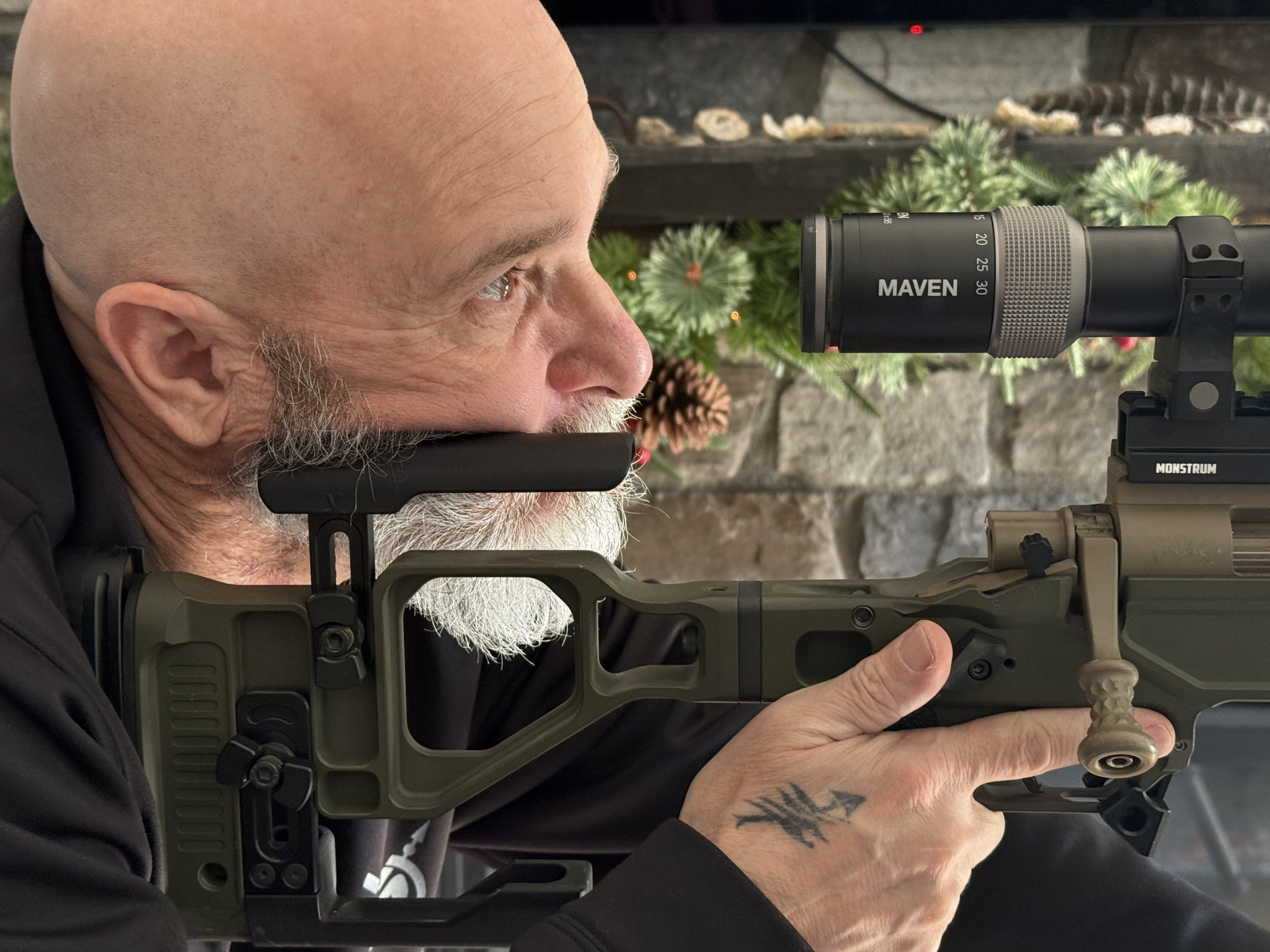

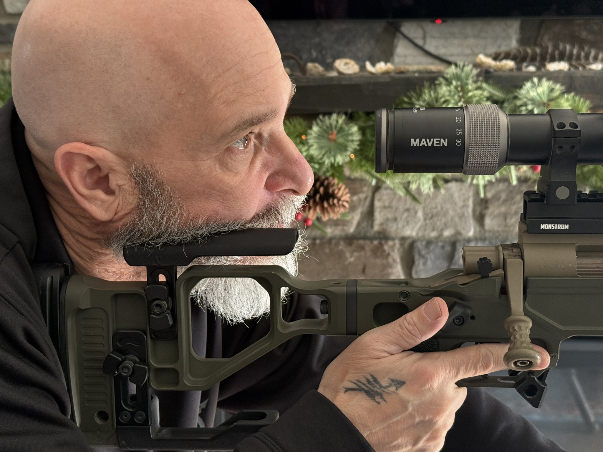

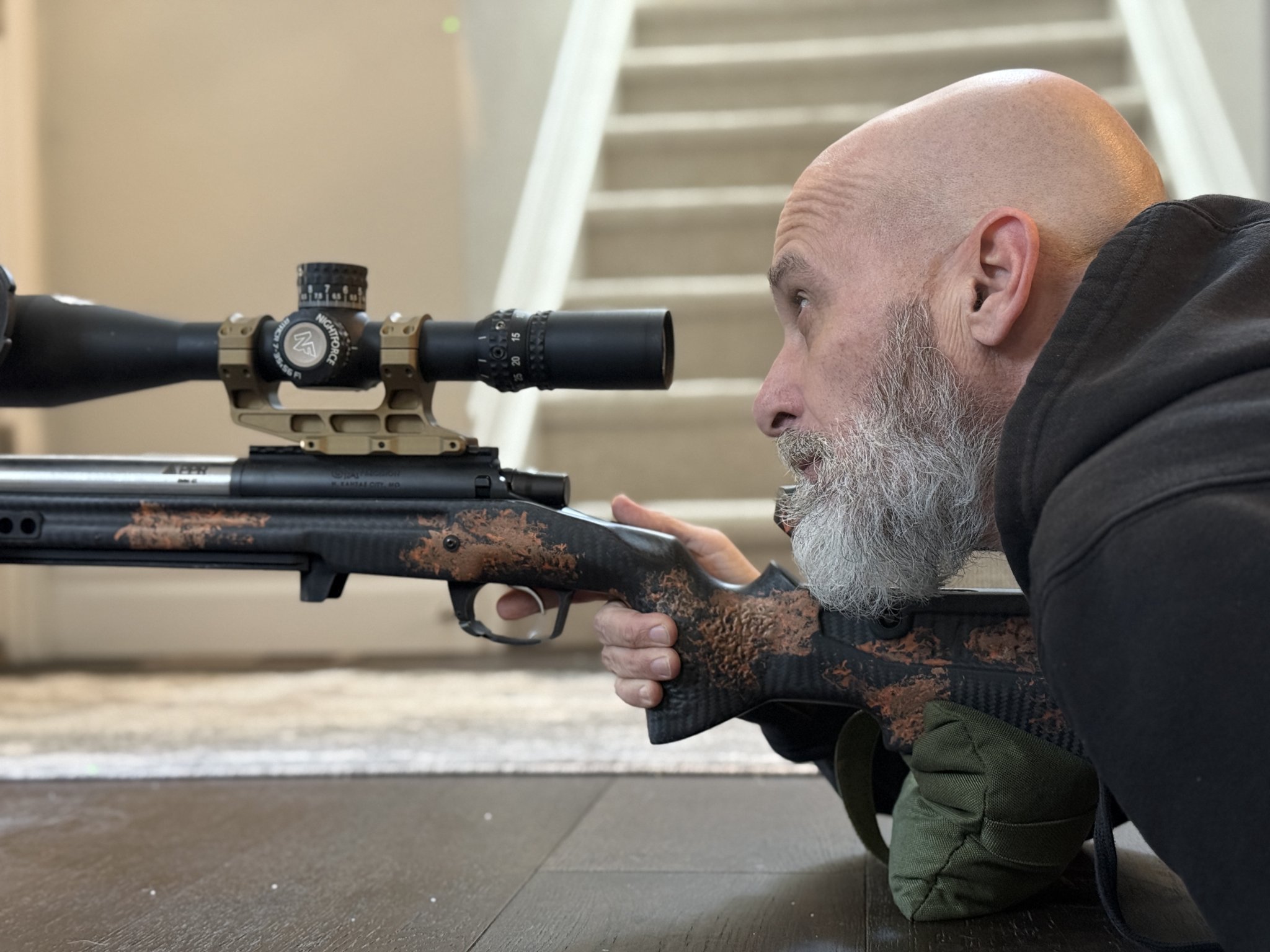

Karma Shooter, Looking at our Body Position
Here is prone, the house sucks I wanted a better image, I might need a slight tweak but I’m not laying in the snow for this

Is it an artifact of the pic or did you have to crank your head back a bit further in the prone than in the the earlier pic, above?
I'm not arguing that this approach is inherently flawed...not at all. And, we seem to agree that I (and others) just need to pop that riser on a rifle to really understand and see how it works.

@Lowlight are you raising your buttpad as well as the cheekpiece?
It looks like by raising the optic height it is also effectively lowering the bore height in relation to how you shoulder the rifle, making the rifle recoil in a straighter path (less muzzle rise)?

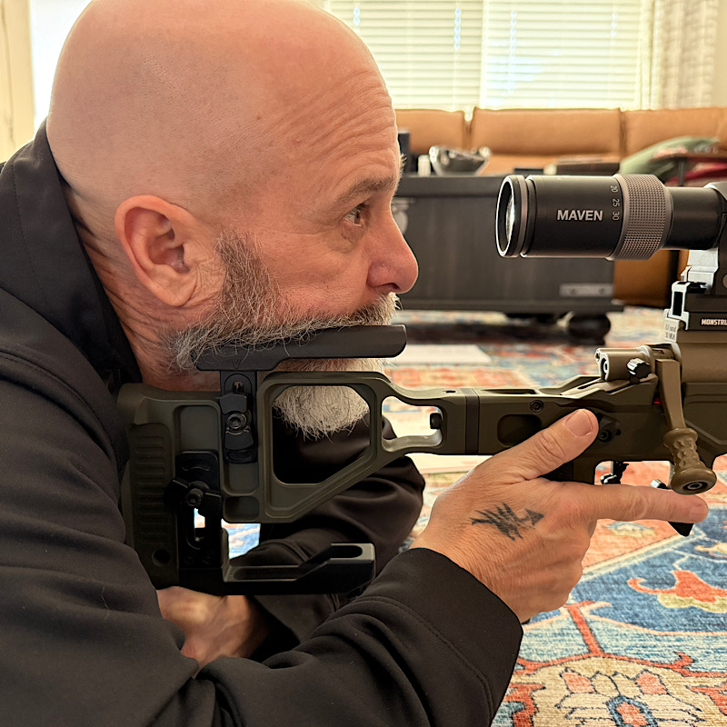

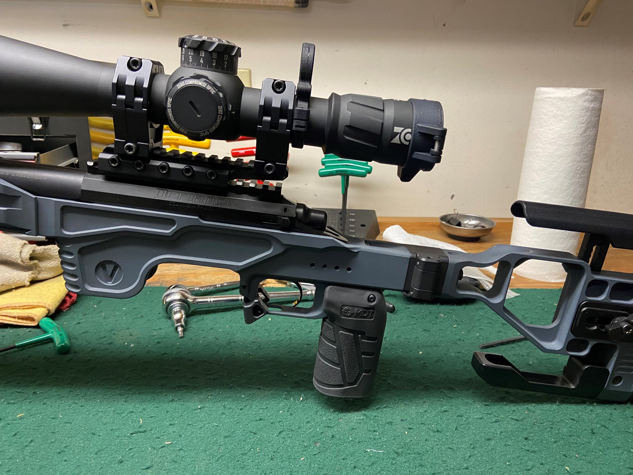

Hi Frank - Well, I gave it my best shot...and failed. lol

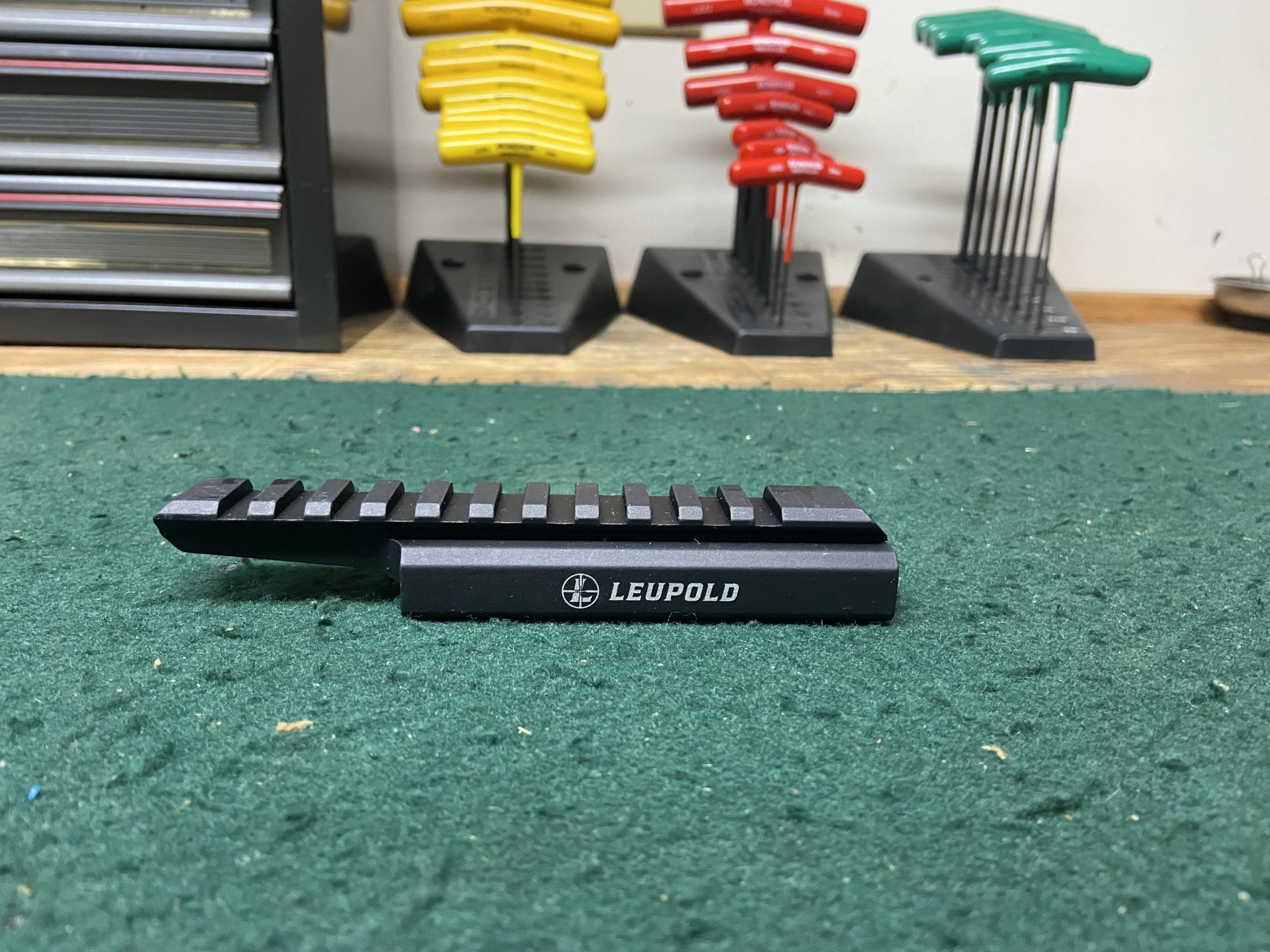

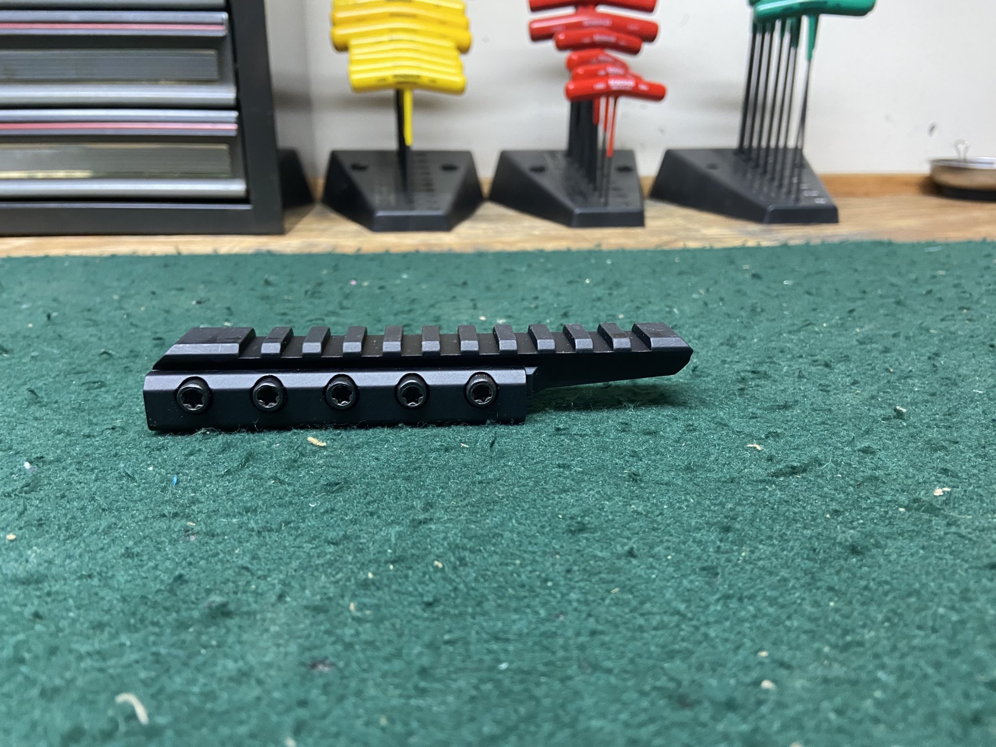

First, you had asked earlier if I had a pic of me prone on the gun but from the right side. Well, here is me with 1.42" ARC rings that I currently run. I adjusted the bipod as I normally do for prone for targets at the same level (Atlas CAL with legs on the second notch up). I built a bridge, put a bag under the butt, and this is what I look like (except I do float my thumb and my finger is more perpendicular to the trigger shoe...I just wasn't worried about that for these pics).
Then I put the Leupold AR Riser on the gun. the riser is .6" so that brought the scope up to 2". but even in the Vision I could not get the comb high enough to get me in the exit pupil. Short maybe a 1/4"? The JAE wouldn't have even been close.
Now, I do want to emphasize that this is ME and my facial structure...may not have anything to do with anybody else. And I do know with the MDT ACC you can get from them a set of the LOP posts (they are the same as comb posts...just longer) and use them on the adjustable comb. It won't be able to go down all the way as the posts will bottom out on the lower part of the butt stock, but we are trying to go up, not down, right?

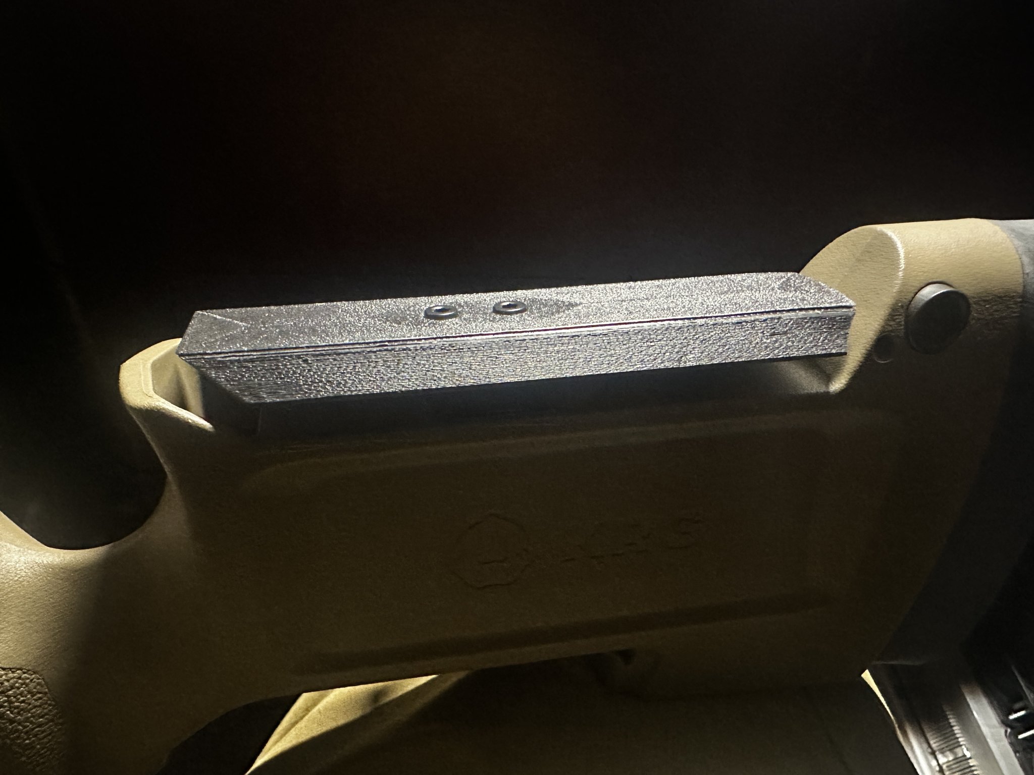

This is the rifle with the riser on it. And yes, I know that the riser should go on the other way but there is a sort of large lug at one end and I couldn't get eye relief except this way.
The 2" may work well for others...and it may work well for me if I could get the comb high enough (eh, like put a pad on the comb for a bit of added height). Dunno, couldn't get there. But I did confirm that with the 1.42" ARC rings and in prone, this is about as far as I can flex my neck and lumbar and still be somewhat comfortable.
ALL - @LuckyLuke80‘d for the riser first so it’s his. Thanks guys
this riser was given to me by @stanley_white (who is a GREAT guy, by the by). He gave me permission to pass it on to somebody else if it doesn't work for me...and it doesn't. If you want it and are willing to send me $15, I'll mail it to you in a small priority mail flat rate box. The riser is free (and they are $79 from Leupold plus shipping and tax). If you want to give it a try, PM me. First come, first served. Its actually a very nicely made piece.

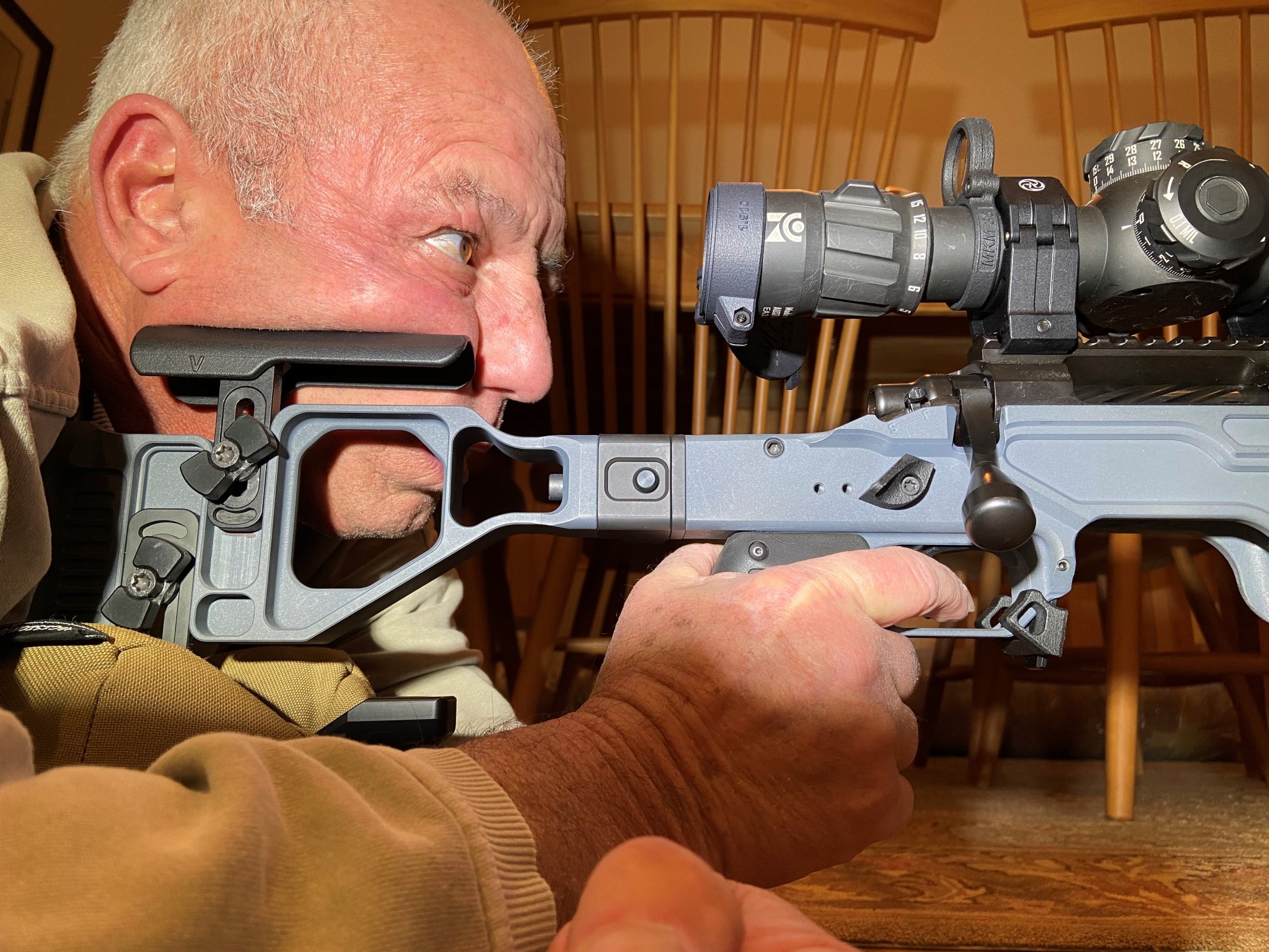

@Lowlight
Hi Frank, I was wondering if you saw any changes to the drop data on your Kestrel?
I changed my bore height on my Kestrel from 2.5” to 3.5” and my 200y data changed from .4 to .24. I was able to true my drop from 300 to 800 but I couldn’t get my 200y drop to line up.
@Lowlight
I think you and Chris have a winner. I haven't tried it prone yet. From a tripod, it is better. My eye is perfectly centered in the eyepiece. There is no shadowing, and my head is more upright. I don't have to add any pressure to the cheek weld. I can't wait to try it prone.
I am using a Badger 1.54" mount with a Bobro riser that adds another 0.625" for a total of 2.16". A tenth of an inch lower would be better but this will do.
