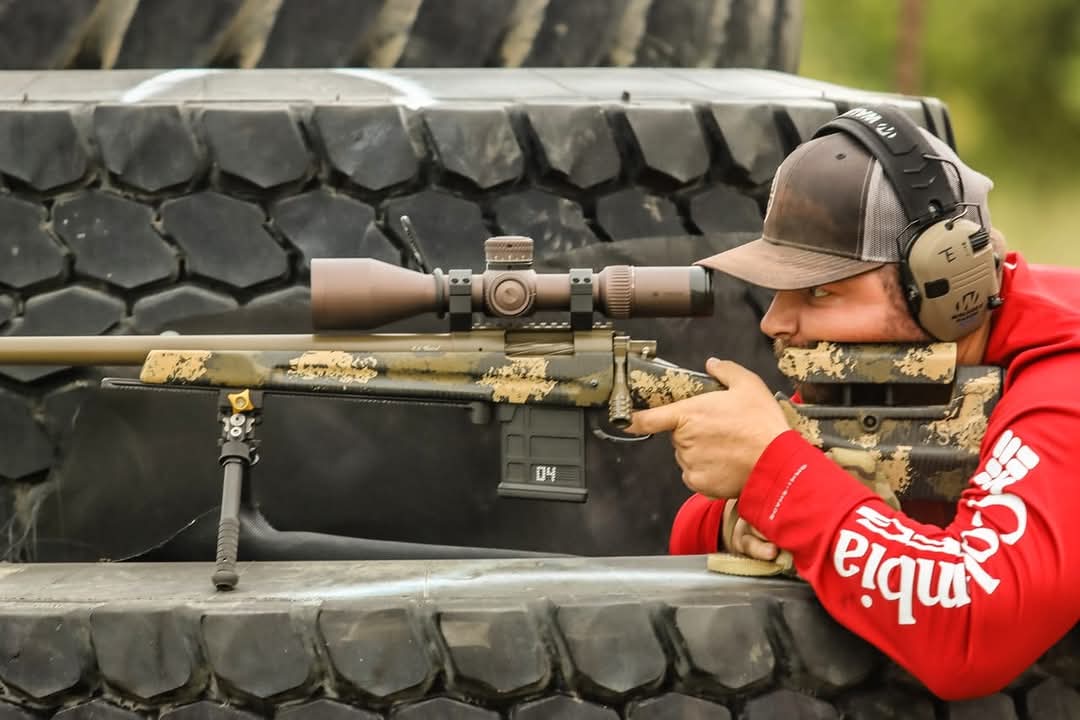

When I was new to precision rifles and PRS I did this crap thinking it was the right way. Cheek piece cranked up and smashing my face down. My recoil management and my POI was very inconsistent. Lost target in the scope on the regular and missed shots high on the regular. Soon as I lowered my cheek piece and put light face pressure on the stock I saw positive results and my recoil management was super consistent. The rifle tracked straight back instead of bouncing all over the place because I had so much down pressure on the rifle system. Now anytime I shoulder a rifle with a high cheek piece it feels so awkward and I'm fighting for a natural sight picture.
This does not work for everyone. Facial structure and neck length differences guarantee it.

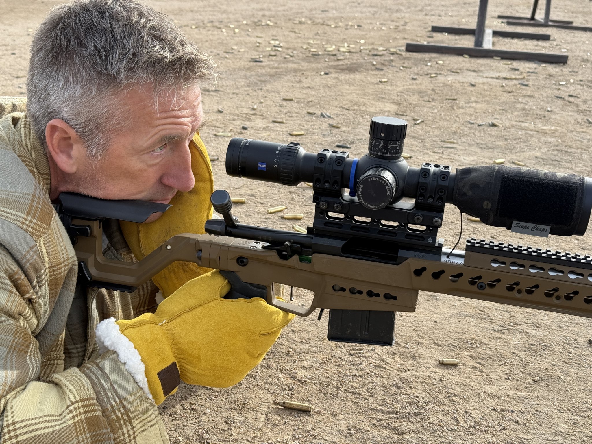

Reactions: Aftermath
Let’s argue about those shooting gloves 😂
Ok, but tread lightly, no-one has had the nerve to make fun of my sexy shooting gloves so im impressed with your bravery and will honor your challenge. My only guideline/rule moving forward to our arena is dont attack my lucky shooting underwear (and yea the bells are for grizzly bear deterrence not anything weird).
I am more curious about that coat…
-Stan
I think it depends on who you ask…
I mean, depending on what one is doing, does it really even matter?

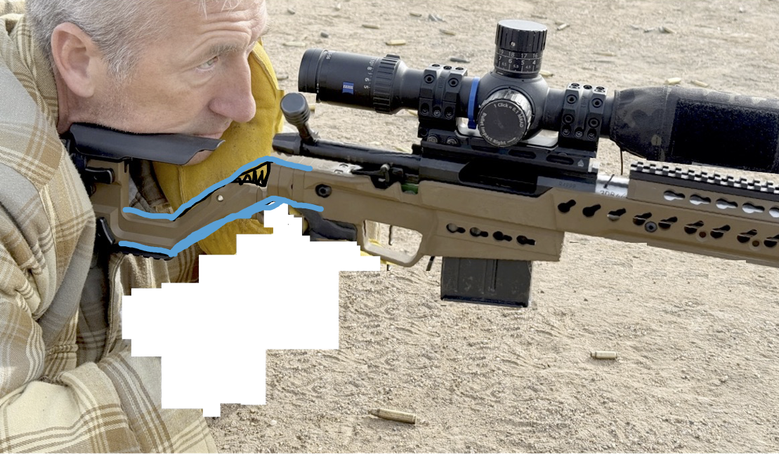

Here's the question being discussed earlier in the thread...
IMHO its not clear if the rifle barrel needs to be elevated rather than rings being put on a spacer...
Pic shows simple re-positioning of the barrel/action in (relative to the back end of) the chassis.
Glass is in the same place as the OP, to get the correct result OP intended for ergonomics...etc
ETA - note zero change in cheek position, head position, etc.
and there no issues with bolt clearance
Pic to save 1000 words.

Revised pic of a modified chassis vs a modified optic mount. This 100% the same ergonomic position the OP had identified at optimal. The only difference here is the mechanical support for the barrel'd action has been revised. As you can see from the picture (by omission), the only ergonomic modification is the hand position, not the head vs optic, shoulder-pocket vs rifle stock.

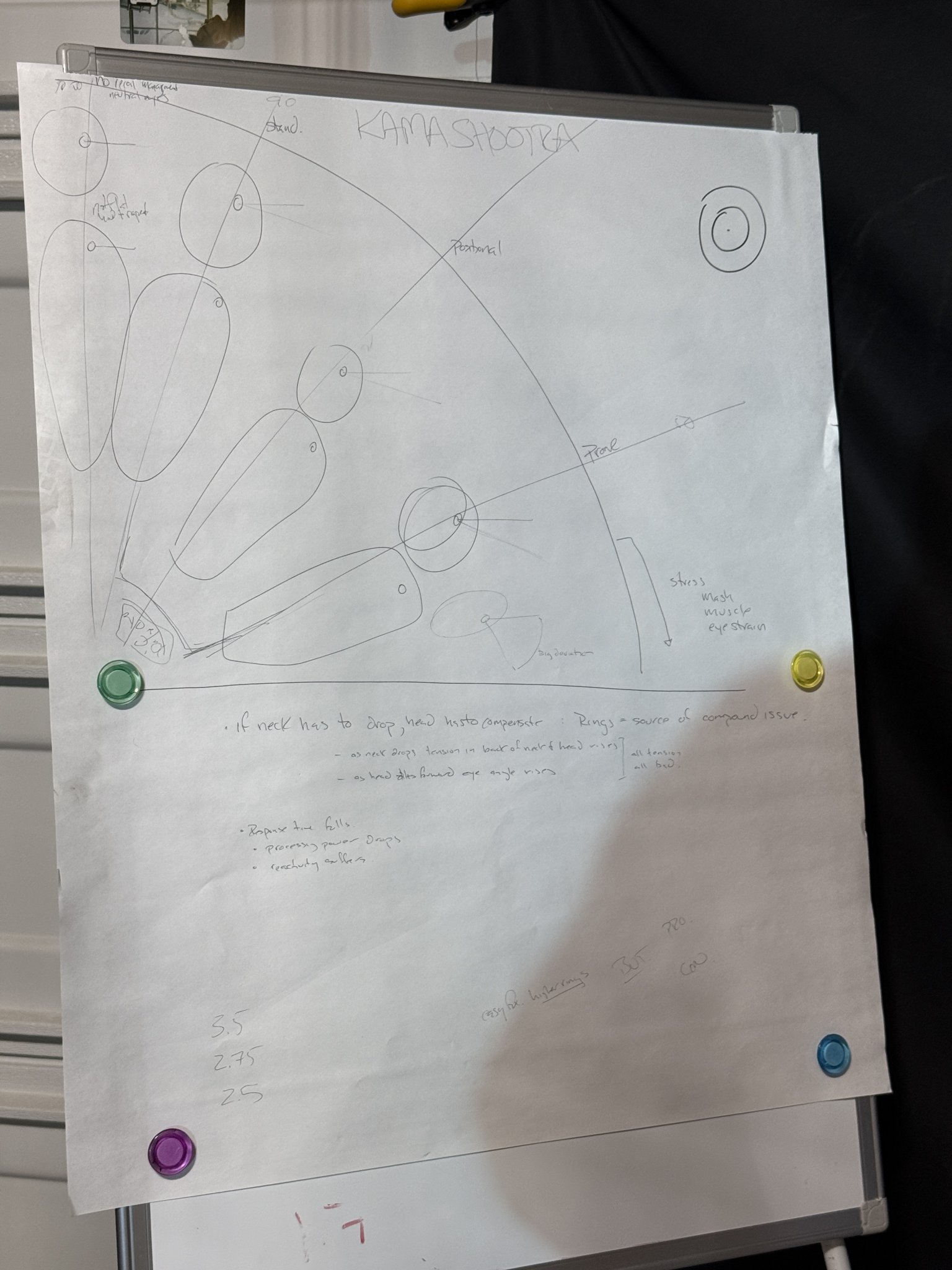

Okay we did a live on this topic as this is something we are looking at more and more. We already know we are going to higher rings. The AR15 world has going to higher Risers and now the bolt action world should follow. For a while now I have been taking about 1.375" to 1.55" as the rings I look for today. I don't go low, I stay high to keep my head up. Well saying this repeatedly has lead to Chris getting a 1" AR Riser for his bolt gun.
So this week I jumped in to look at this and felt it was better. My biggest concern was prone, and prone even for me was very comfortable.
I wanted to talk about this, today Chris and I jumped on a LIVE and recorded our thoughts.
The graphic Chris drew is a touch light on the screen, so here is the image.
For reference:
Measurement for Chris was 7"
Measurement for Me was 5"
The Rifles averaged 3.75" with the Knights being the lowest at 2.75" scope over bore height.
This is a thought, an experiment, so we want to your opinions ... we know the immediate negatives what are some we might have missed ?

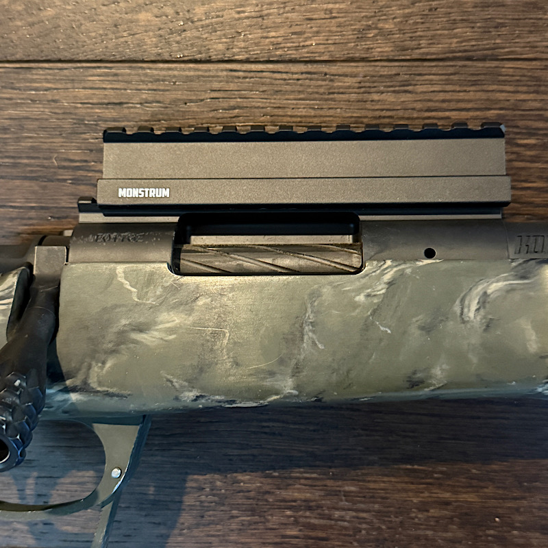

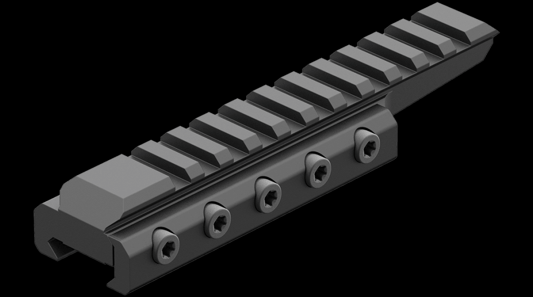

What brand / model of riser is that?

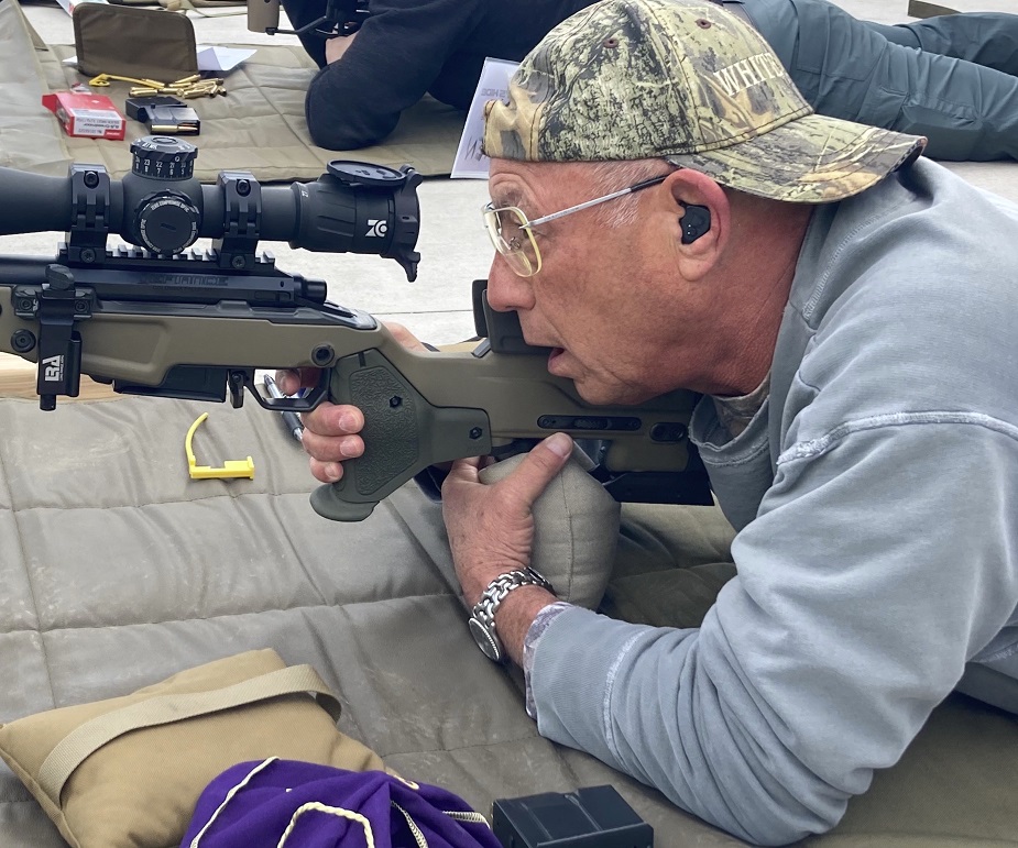

lol...ok, I'm wrong again. haha But this is why I attend to clinics and you teach clinics! 😜 :ROFLMAO:
But, in fact I actually still don't really understand. Take this picture again...yeah, my old ass at Mifflin.
So, if the rifle stays exactly where its at...and no higher...then wouldn't my torso stay at the same angle to vertical (which I think you touched on in your post to me) to meet the butt pad, etc?
And, therefore, if all we do is raise the scope height over bore (and adjust the comb height commensurately), then does not all the additional eye height needed to get back into the scope have to come from arching your neck further back?
haha..yes, I rode the short bus to school...have pity on me. lol

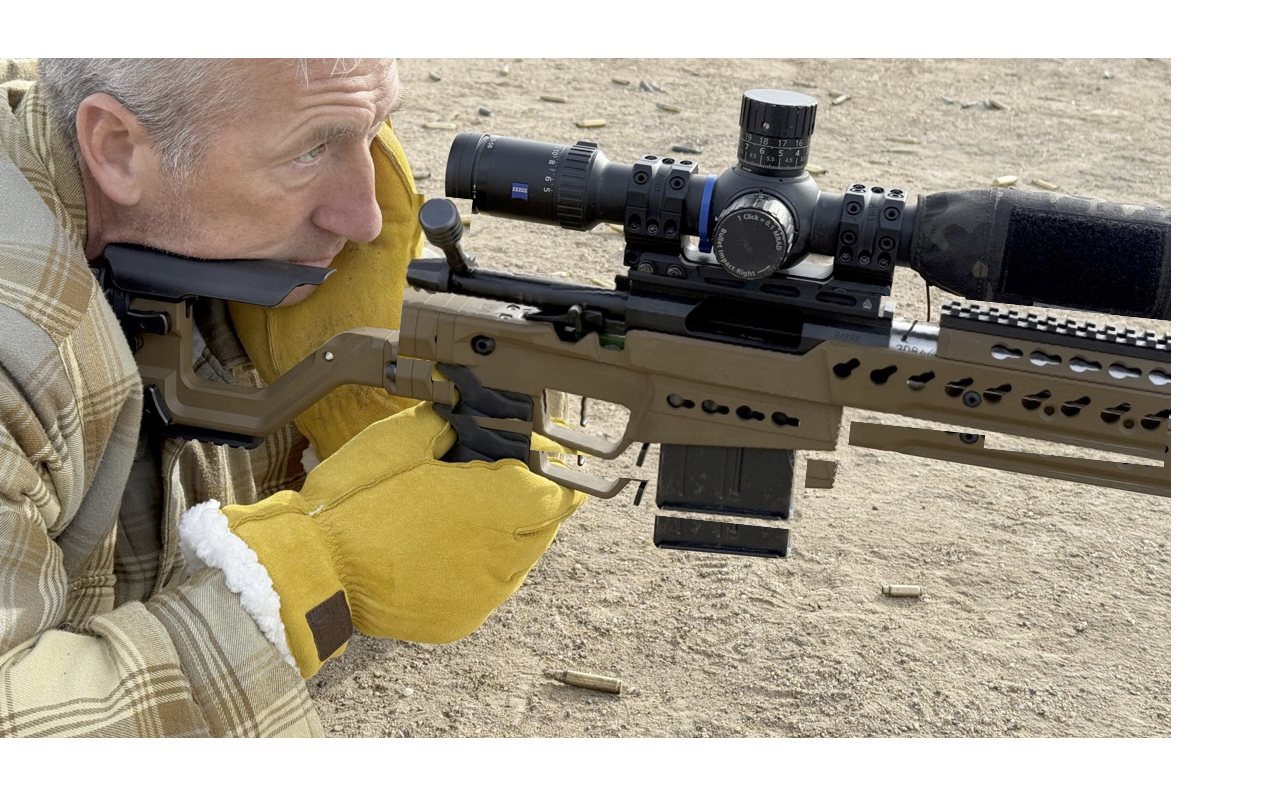

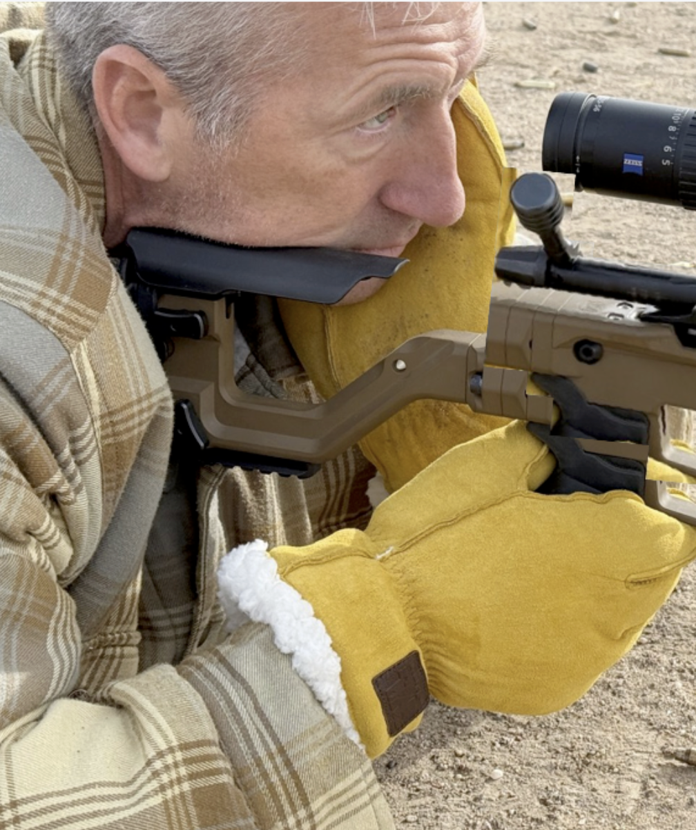

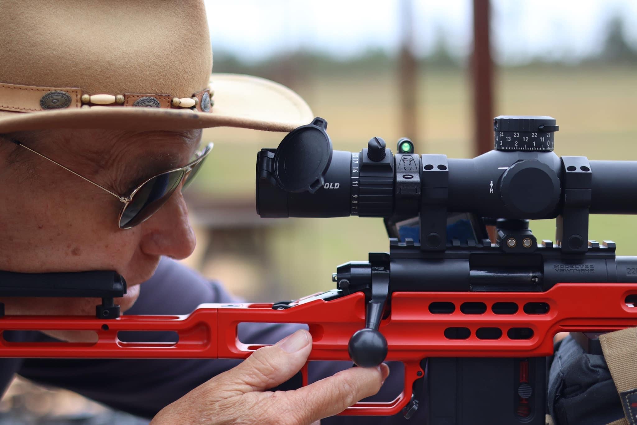

Steve do you have a picture like that from the other side ? I want to highlight something I see.
The difference in the position for you to understand is your eyes
That position above your eyes look high, they are looking up into your scope. Changing this angle like I am saying will straighten your eyes to be forward and not up ⬆️
I had a different picture but can’t fine it, but look at his eyes what we are seeing,
Guys are lower, they look up into the sight picture bs straight into it
Reactions: obx22 and Jscb1b
No Frank...wish I did. Marc took that pic but its all I have. I should make a point of having a friend like @GBMaryland take some more shots of me in position. Would be very helpful.
That is absolutely true. I do look up to a fair degree and not straight out in front...at least from prone.
Oh yes, I get that part. If I raise the scope height (and comb) then my face will be more vertical and my eyes will looking more straight out and not up at my eye brows.
But if I don't raise the angle my torso with a higher bipod/rear bag, then the only way I can see to get my face more vertical is to roll my head back on my neck. Now, I might actually be able to do that...dunno until I try it.
And I'm not trying to be argumentative....just trying to understand. And as I said, in a week I'll have an Leupold AR Riser and I'll give it a try. I'm sure actually trying it will clarify all of this for me.

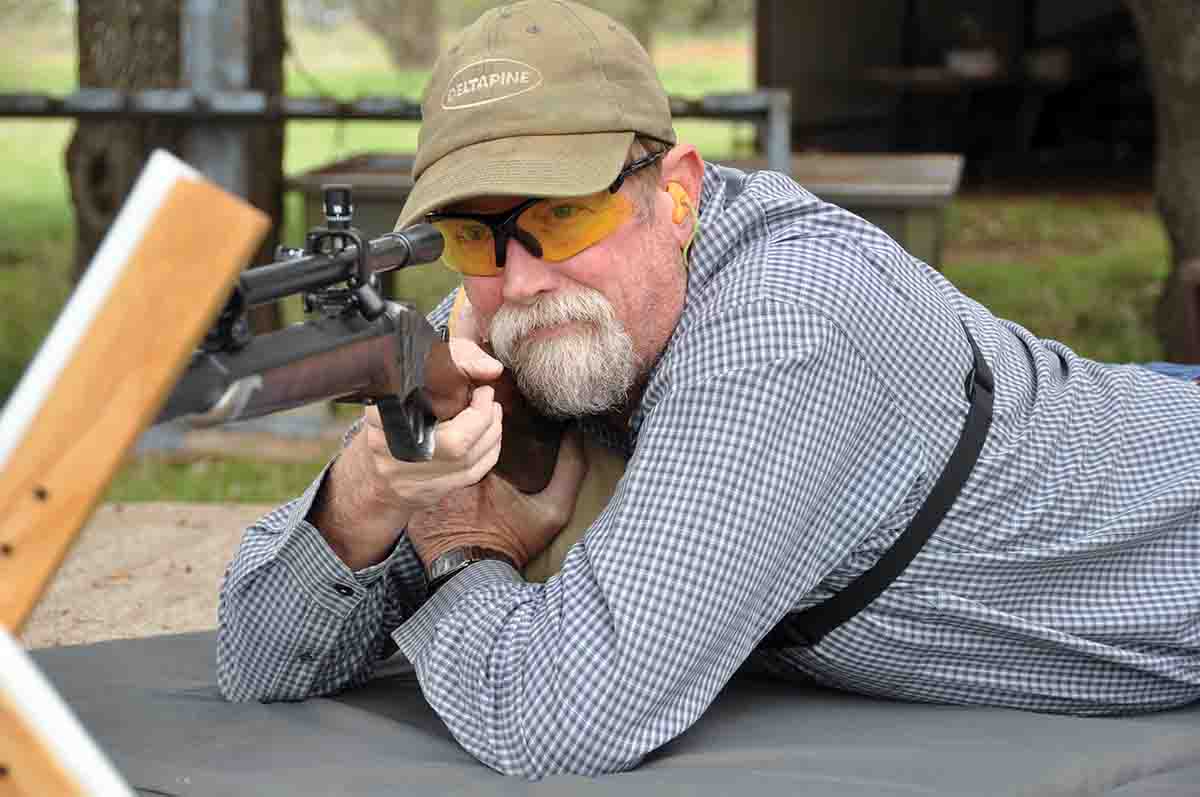

Just for clarity, if you use your left hand to support your chin and your right hand to squeeze the bang lever, what is controlling the rear of the rifle?
I can see a need for 2 new pieces of gamer gear...the Armageddon Gear Sex Pillow ($495.00) and the Midwest Industries Chin Crutch ($295.00)...to free up the off hand to again be used to control the butt.
The above prices are accurate
It’s the funny part of the picture, his hand on his chin. At first I was like WTF, then I realized, he was talking about my head in your hands height example. So he was trying show the little kid position.
Laying on the floor chin in hands, that’s the height and head position. If you think about it we never teach kids to lay on the floor and watch something. They can do it for hours, we all did it. That’s the position, now slide the rifle into there without moving your position, that should be the goal.
