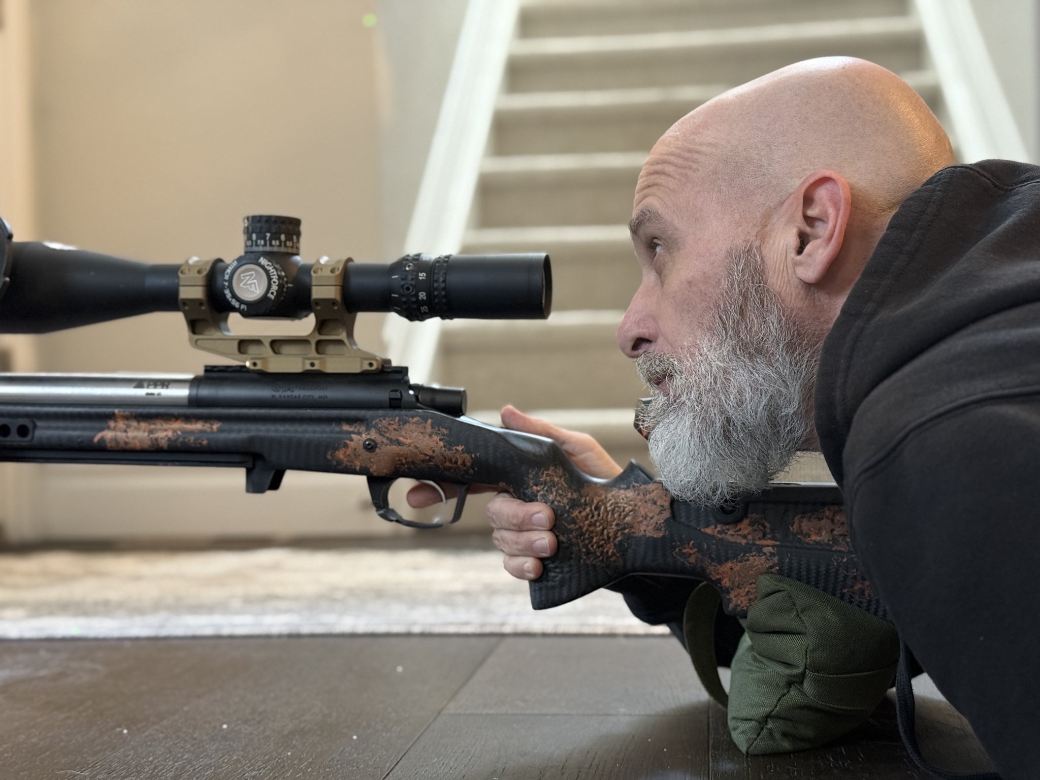

It’s the funny part of the picture, his hand on his chin. At first I was like WTF, then I realized, he was talking about my head in your hands height example. So he was trying show the little kid position.
Laying on the floor chin in hands, that’s the height and head position. If you think about it we never teach kids to lay on the floor and watch something. They can do it for hours, we all did it. That’s the position, now slide the rifle into there without moving your position, that should be the goal.
I understand the concept.
Is controlling the butt of the rifle no longer a concern?
I think that could be the test...lay flat on the floor with your hands under your chin or cheek bones. If you can do that for more than a couple of minutes, maybe this is ok for your body structure. I tried it and was in excruciating pain within 3 minutes. I put a sexy pillow under my chest to help change that torso/neck angle and I could make it a little longer. I'm better off looking up, sorta, so that my neck remains more aligned with my torso.
This holds true when I am shooting offhand, kneeling, off a tripod...I need to not bend my head up very much and tend to shoot sort of looking straight forward. I accomplish this primarily by using a pretty short length of pull. For example, most of the collapsing butts on my AR's remain fully collapsed.
I doubt I'm the only one with a fucked up neck.

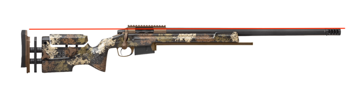

IDK? Seems like scope height is the missing spec in all the "pro shooter rifle build" articles I've seen... Frances's scope looks pretty low in the recent pics/vids I've seen, not sure about Slade/Baker. Buschman uses low rings and he doesn't suck too bad lol.

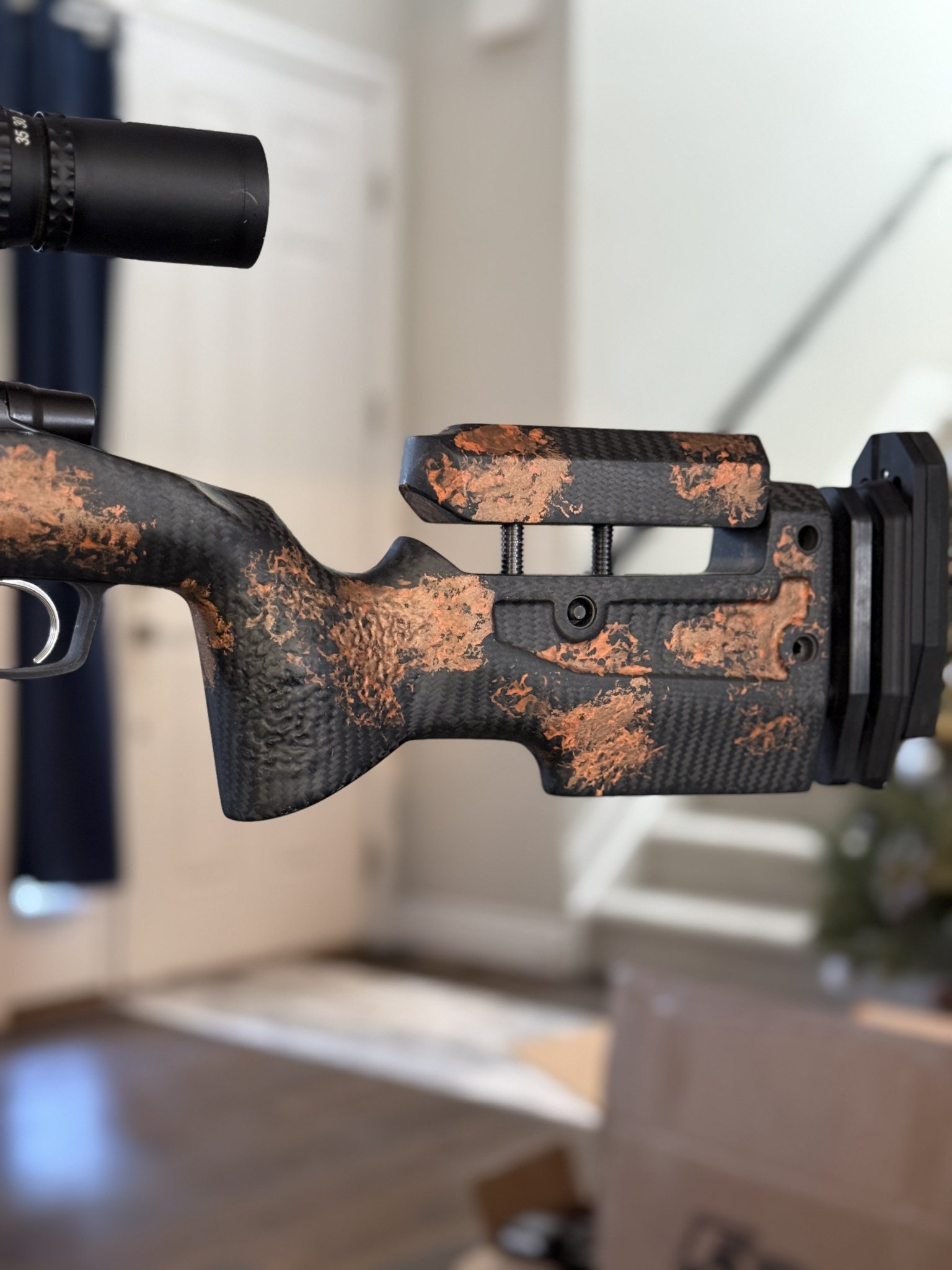

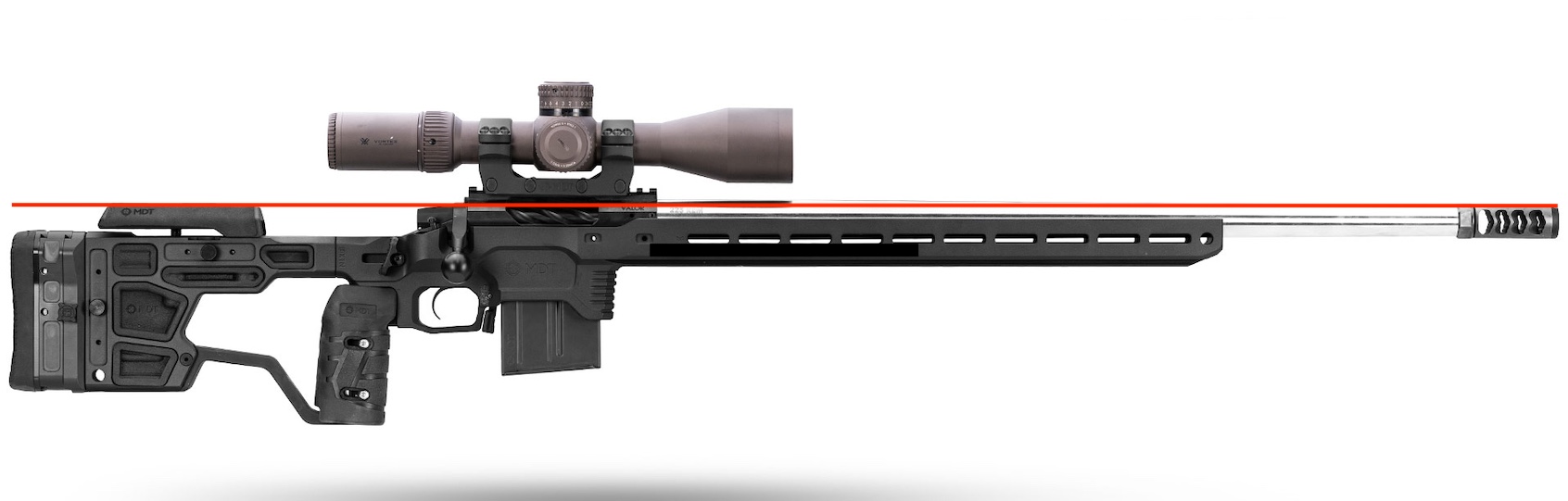

One thing I will add, I think in addition to optics height one can also take into account buttstock / cheek piece width.
The wider the buttstock / cheek piece the more the shooter has to cant their neck to get their eye centered in the scope and this can also add unneeded cheek pressure to the rear of your system.
When I ran the Vortex Gen 2 Razor 3-18x with its extremely forgiving eye box I mounted an Accurate Mag Sport Tac Lite buttstock with the cheek piece removed / a chin weld to my MDT ACC Premier chassis and it worked amazingly.
When I switched to a USO FDN 5-25x with its tighter eye box I could no longer use the same stock as the scope required a cheek weld / cheek piece to avoid scope shadow.

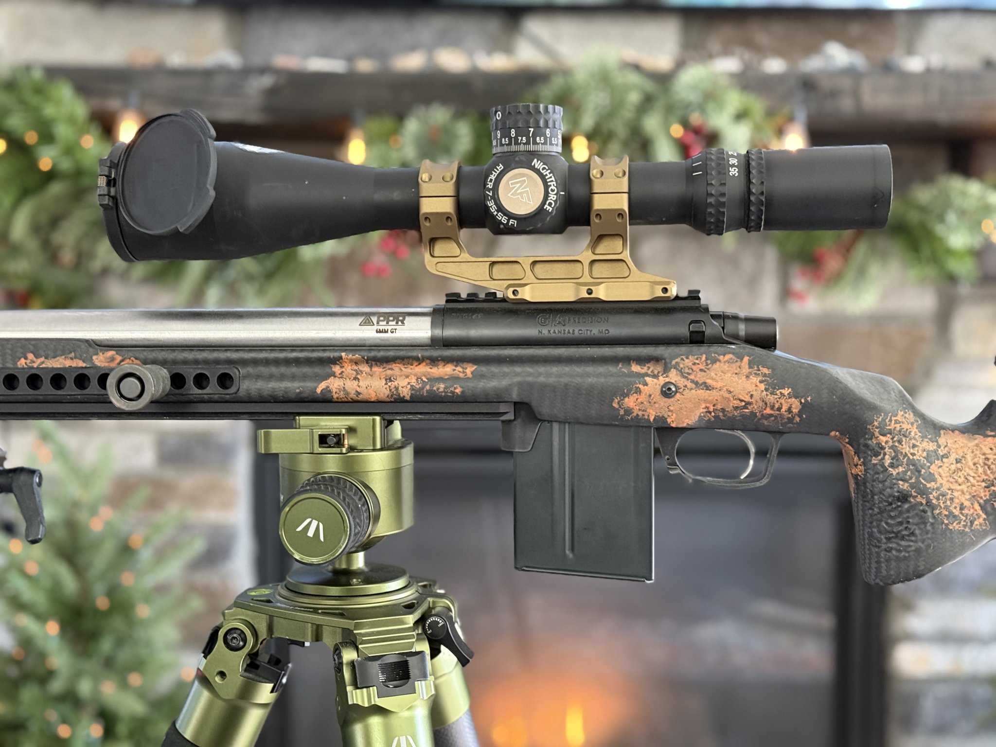

Here are pics of my previous setup;
Here is a link to the stock if anyone else wants to experiment:

IDK, I’m the type that goes back and forth between not wanting to mess with my rig/gear so I can have enough consistency in place to actually concentrate on working on improving the shooting part, but at the same time feel like you can teach an old dog new tricks, so I’m open to experimenting a bit and trying new things too.
I went to a 1.5” height mount for about a month a little over a year ago, and decided I didn’t like how my gun felt/handled that way. I didn’t feel like my rig would plop down the same way onto a bag as easily or as good as I was used to with the taller mount and never really got comfortable with how it tracked differently under recoil while spotting shots so I went back to a 1.25” height mount…
That said, at that time I was running a fat pig G3 Razor which was a full diet Coors of weight up top more than the scope I’m running now, and maybe a month and 4-5 range trips wasn’t enough time to acclimate to the change after being used to what I had been used to.
I think I might get another 1.5” height mount and give it another honest try, but IDK if I would want any taller than that now that I’ve figured out that lowering my cheek piece is so much better and makes a whole bunch more room for my melon behind the gun and keeps me from mashing my face into the back of the rifle.
Isn’t the critical measurement the height difference between cheek rest and scope Center? Doesn’t Francis run a very small cheek rest set quite low?
Reactions: lash
Adjustable combs are quite common on clay target shotguns and yes, they not only move up/down but also side to side so as to keep the shooter's on-eye directly behind the rib without rolling the head.
Mr. Cross' Loggerhead comb hardware also provides side/side adjustment but this is for stocks and I haven't see such on rifle chassis (but I'm more than willing to be corrected on this).
I think its an important ergonomic adjustment and would love to see this in chassis butt stocks as well as traditional stocks.

The point is, I think, a neutral head & eye position aligned to the center of the scope. A position like the kid who watches TV with his head in his hands.
When I look at photos of me shooting prone, I see what they are talking about. 1.54" rings on my AXMC with the riser set at its lowest aligns with the lower part of my eye. My scope needs to be higher. If I can get that to happen, my head will be more upright. My eye will align properly, and my cheek weld will be better. Recoil management should improve to reduce the vertical jump when the shot breaks.

Are you prone in that pic, Frank, or laying out on a table to simulate?
