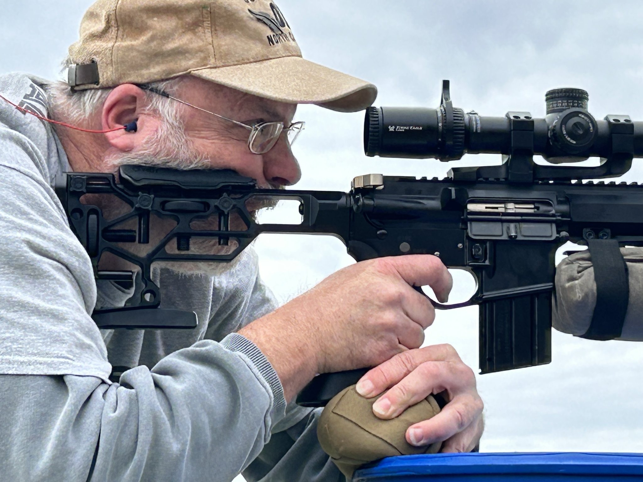

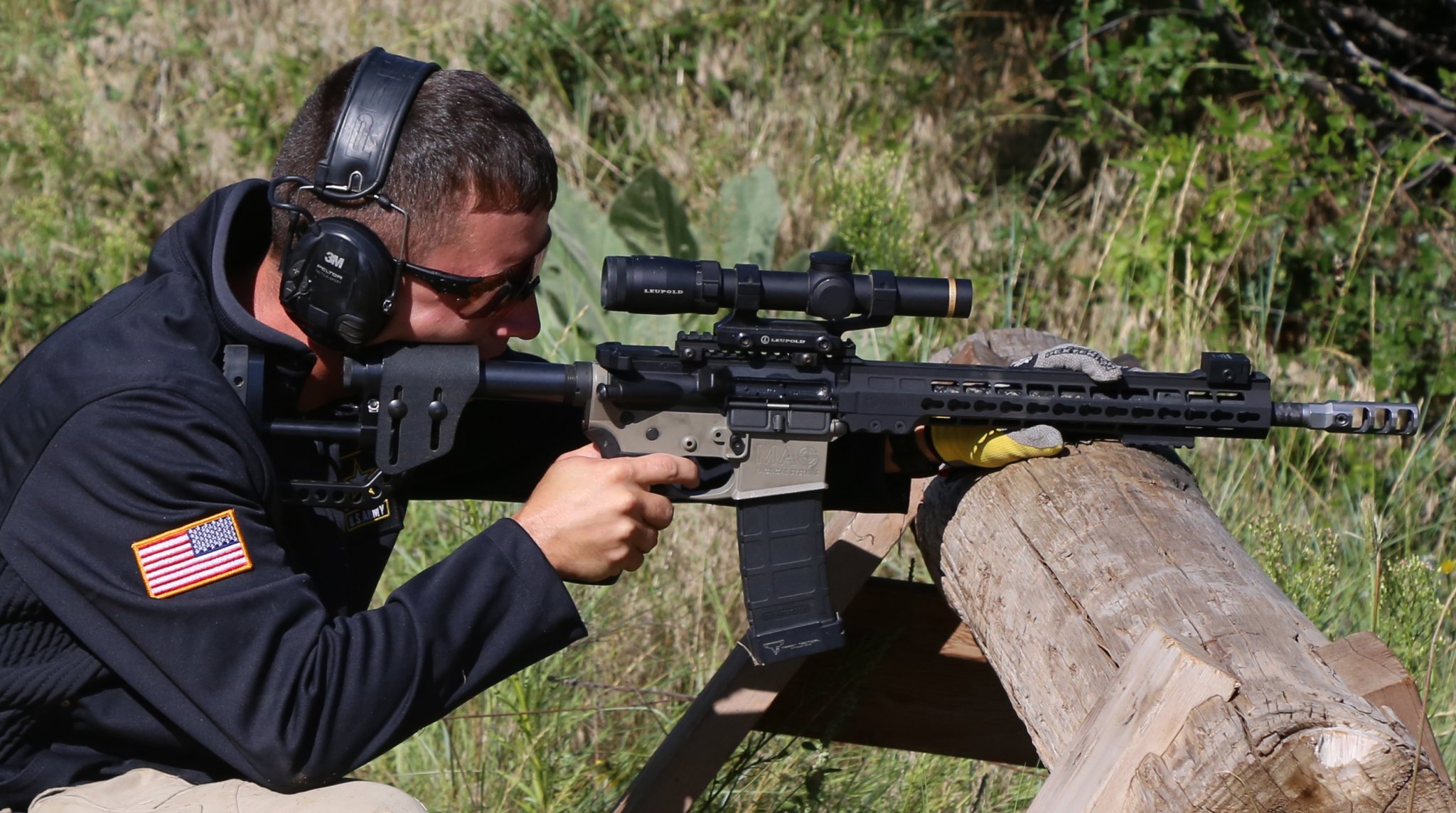

I mean, this guy's rings look pretty normal and it doesn't seem to be holding him back. Heads up, looks pretty relaxed to me. Maybe some of us just suck at shooting and need to practice more lol (I know I do)?
(Whether one hates PRS or not, you've got to respect dude's gangster as far as managing recoil like a boss and making a plate at 400 yards look way too easy lol)

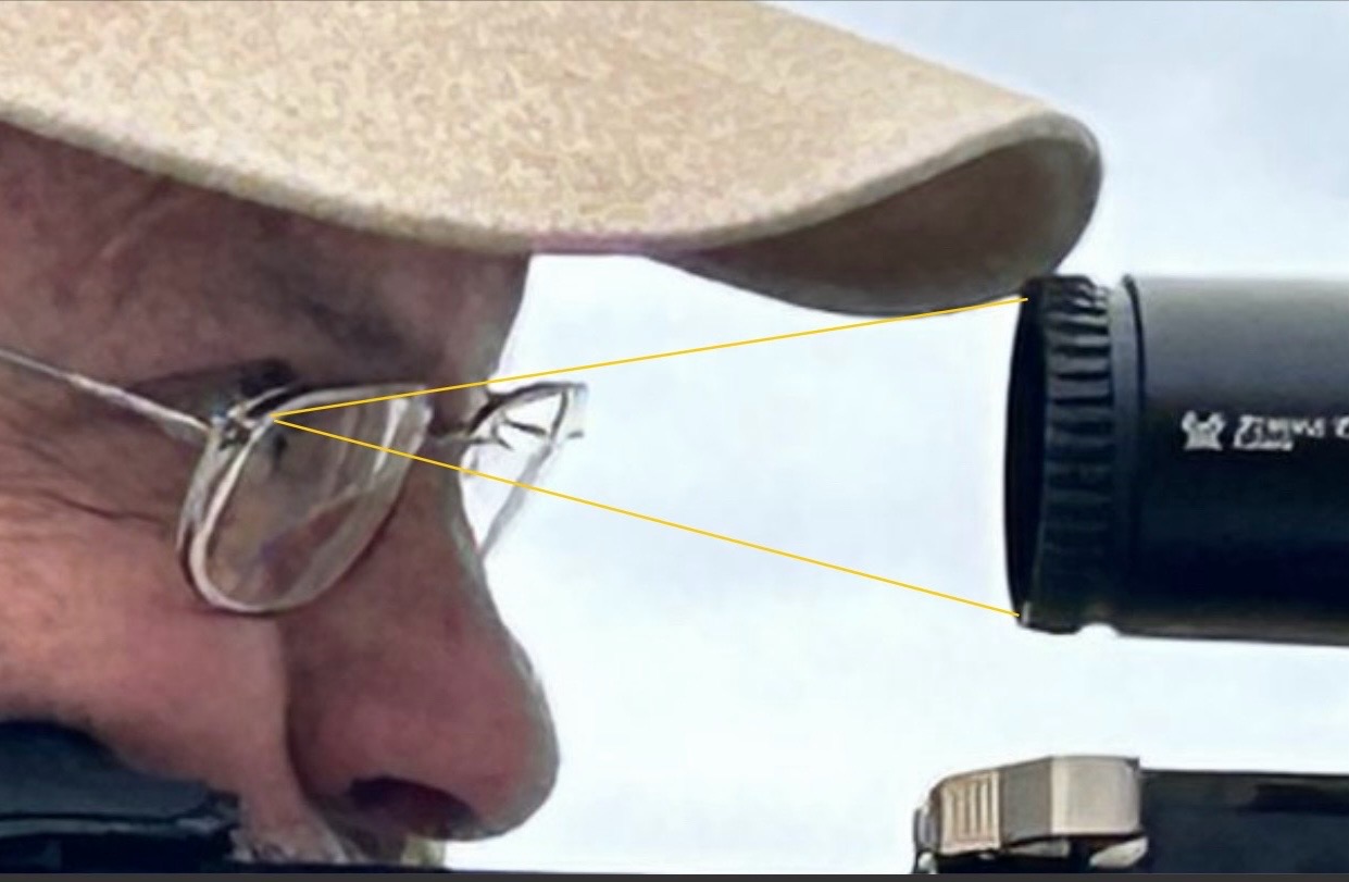

His head is rolled over and his pupil is it at the top of his eye socket.
It’s Ben Gosset he is a kick ass PRS shooter and a great general shooter. But what if he raised his scope and got faster? Or was able to spot at 150yards his impacts and process information faster?

I think the why is the head and shoulders as well as the brain.
1. No roll the head is neutral
2. The rifle CG under recoil is lower, or at least the same. The scope is just to see, it doesn’t have a controlled explosion. So moving it from the head changes the brains perception
3. Index, vs Anchor, look at every picture of a shooter, they anchor to the cheek. That is downward pressure.
that’s my why

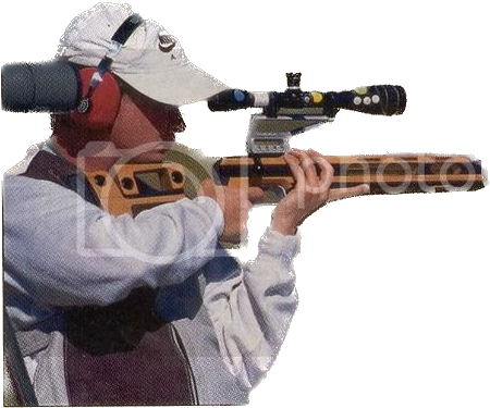

Opinionated jerk here, so take it with a grain of salt:
You are not raising the scope, you are lowering the rifle.
Stay with me here:

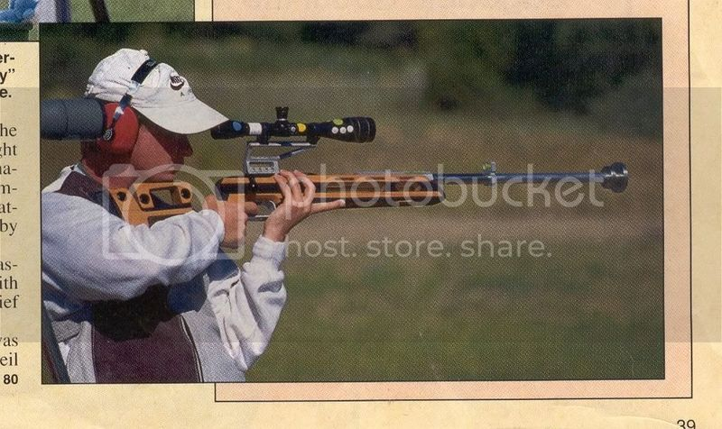

If you view pics of Olympic shooters, they try to keep the eyes level in all their shooting positions. Level eyes (visual cues) and level ears (balance control) translates to the ultimate in steady aiming.
If you study their gear, most are running sights on tall blocks, and often they are canted over to align with the shooters level eyes (gun to shooter, not shooter to gun.)

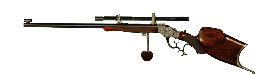

Look at silhouette shooters, which went crazy with ladder mounts-scopes jacked way up and rifle lower to the shoulder, again all about balance with level eyes/head.
Now we have the barricade rifle/shooter system. Viewed from the side, the sighting system, grip, foreward support, and buttplate. The shooter’s eye, grip/trigger finger, support elbows, and shoulder.
If the barrel/trigger is the fixed point in space- aiming at the target, then the first variable is the height the bore is above ground (for now I’m discussing aiming at a target the same elevation as the barreled action).
Since the human element comes in such a variety of shapes and sizes, the rifle cannot be a “one size fits all”.
Likewise, and what I think doesn’t get enough consideration:
The height the rifle has to be above ground (obviously supported by the shooter) dramatically impacts the angles the shooter’s body is in, as well as the best “form” the rifle should take to yield the best shot.
Look at it another way-
The most comfortable shooting position is from a bench. The rifles weight is fully supported- fixed in space. Now you build your position behind the rifle with grip, shoulder, cheek. If the bench and rifle is too low, you are hunched over. Now your eye is closer to the scope, so you drag your face back, kink your neck, who knows with the length of pull whether the buttplate is even touching your shoulder pocket, is beneath it, or dead pressed in so hard it’s ridiculous. So- rifle and bench height are important, but so are the rifle adjustments.
If the rifle can not be moved, now you have to rely on adjusting what you can to make it interface/ fit your body properly for the best results. That’s just from a frikken bench!
You start prone, ok- what is your optimal shoulder height above ground level?
What height and angle is your head to give the most comfort, but also the clearest vision (yes, the angle your eyes are looking out of your skull effects your vision/clarity/and amount of induced strain.)
Think of your shoulder and eyes as the fixed points in space: Now the cheekpiece and buttplate must be adjusted to fit this ideal.
What distance from your shoulder places your grip/trigger hand at it’s optimum for both elbow angle and support, but also grip control AND trigger control. Wait,(that hand) it’s also pulling the rifle into your shoulder as well.
Throughout rifle design the grip has largely been an afterthought, yet it controls EVERYTHING!
Sooo much to consider…
Now, if you are not going to reset your rifle adjustments for each different position, then one logic would be to lock it into an “average” so while it would never shine in any position, it won’t absolutely suck in one particular position. Ok, what if you adjust it to best fit your worst/most unsteady position, and then let your body compensate for the rest?
No, I don’t have all the answers, but I do have a boatload of questions 😉

Anyone remember DTubb's chin gun? I think yall are doing good stuff, and I've found taller mounts to be advantageous for myself. Just sharing this because every now and then something will pop up that makes me say, "damn, David's always been decades ahead...."

Yes More, look at your face it's anchored to the rifle and you are looking through the top of your glasses ?
it almost appears the frame is in the way ?
Reactions: Tx_Aggie and obx22

The next stage, perhaps, is the elimination of the stock where the head would ideally go. This would remove any necessity to angle the head at all.
The stock, from the grip on back, could be curved around (or under) the head, with movable supports to help line your head up. Like an articulated and angled/curved cheek rest that comes in from the side.
Sort of like the David Tubb pic posted earlier. That would be an example of a “curved-under” stock…I could see moving the bore closer to the scope a bit, however, especially for the bench.
Like the Tubb chin gun, I sort of think someone has already been down this road before and we just aren’t aware of it.

Before the interest in the buttstock being in line with the bore to manage recoil, the Schuetzen rifle seemed to have it all figured out.
-Stan
Reactions: Baron23
-Stan
To be fair, it’s for an entirely different discipline that anything the are discussing here. Iron sights were the primary sighting consideration, scopes on blocks were secondary which is why the butt to bore has such an offset.
Used to be you would hook the butt under one arm and shoot across/parallel to the body entirely under body support, now all the rage is for the shooter being square/perpendicular to the rifle and not supporting the rifle itself at all.
Aka, offhand vs prone.
Understood.
Thank you.
I will submit there is a middle ground between the Schuetzen and the straight-line we see now that is likely worthy of exploration (or returning to).
-Stan
Reactions: Modoc
