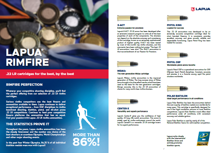

It's not clear that Polar Xtreme remains in production. On the Lapua rimfire products webpage, Lapua notes the following: At current, Lapua offers the following .22lr rounds: X-Act, Midas+, Center-X, Polar Biathlon, Pistol OSP and Pistol King.
See https://www.lapua.com/products/rimf...filter_caliber=22-lr&all_products_filtering=1
In the "Lapua Product Catalogue 2022" pdf, the table of contents lists the rimfire cartridges on pages 6 - 7, the contents of which are shown below. While the familiar varieties of X-Act, Midas +, Center X, Pistol King, Pistol OSP, and Polar Biathlon are shown, Biathlon Xtreme does not appear.
While Biathlon Xtreme is included in the 2021 catalogue, it doesn't seem likely that Lapua simply forgot to include in its 2022 product catalogue a rimfire cartridge that is in current production.
In any case, when Polar Xtreme is/was available, it appears to have the same bullet design as Polar Biathlon as well the same nominal factory-rated MV of 1106 fps -- the faster of the two nominal factory-rated Lapua .22LR MVs (1073 and 1106 fps in rifle barrels).
As always with match ammo, reports of accuracy and chronograph information will vary by lot and by rifle. MVs can be expected to be within the same range as other Lapua 1106 fps ammo. No one should ever expect that a certain variety of match ammo will behave differently by virtue of name alone.
