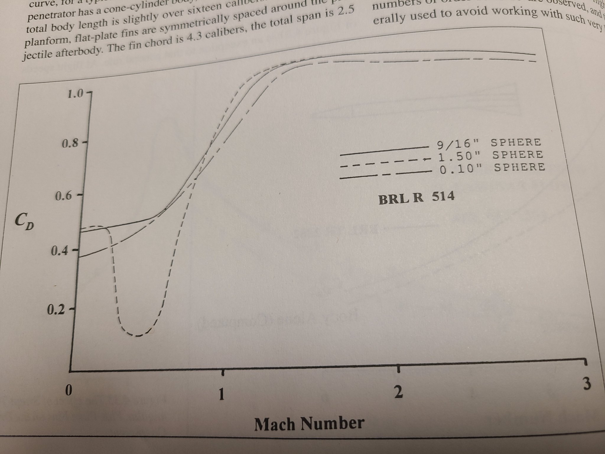

If my memory serves me, subsonic bullets are affected by forces acting on the bullet surface in the laminar flow area. Which also happens to projectiles under water.
I've been doing some reading on this. This is really interesting! When a projectiles leading surfaces break from laminar flow to turbulent flow, it goes through a dramatic decrease in drag that McCoy describes as "anomalous". This does not happen with conventional bullet profiles but it does with certain size spheres at certain speeds.

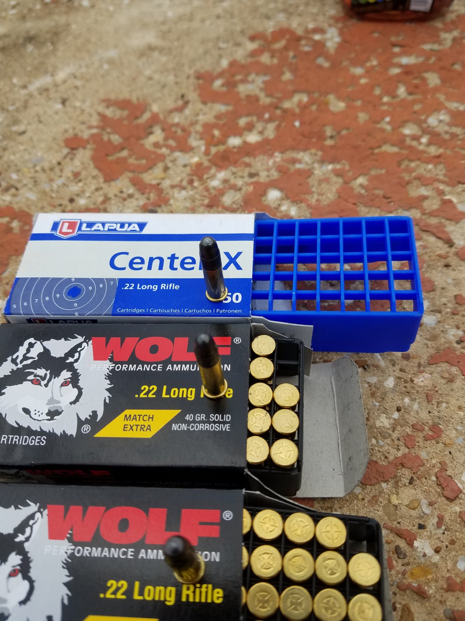

I did a extreme test yesterday I made a precise tool to the center-x indent. The test conditions were horriable! 9 mph steady wind 430 at right shoulder 12-15 gusts enough that the empty casings and my readers were blown off the bench. What better conditions though right? The ammo of choice to modify was Wolf match extra. 10 rounds were altered see photo 1 bottom to top modified wolf,plain wolf, center x as is. I zeroed with wolf unaltered on my iron bison I was 4.9 moa right for wind still needed 1 moa connected 3 out of 5 at 320 yds. My range layout is tough to shoot its across a valley and at the 220 butt you get wind that's similar to the bench wind but it pushes down some coming off the hill. In photo 2 at 220 you'll see a cluster of orange feathers at the end of the rod is where their tied there being blown from 3 oclock proably 5mph in the distance you see the 320 butt. In photo 3 you see the 320 butt notice the flag snaking back to 4.30 this butt is on a high point and the north east wind cuts through here with ease. Creating sudden shifts even though the bench wind is steady , so when the flag lays down you gotta send lead fast. Loaded up the WOLF MATCH EXTRA SUPER DUPER X I got 3 off waited got 2 off wind whipped the flag to 3 just as number 2 went down, got 4 in a row off fired final shot . All ten shots in about 4 minutes. Photo 3 shows group still a little left and low 5 in a 3x3 3 up all 8 in a 7x10 1 way up center and the one I knew was gonna be right at 3 these are all in pink. The group, ie strong across the top in yellow unaltered wuf wuf that's how they shot 6 hits outta 10, I will conduct this test on a more favorable day before reaching conclusion , but at current it certainly seamed to remove alot of horizontal error. This last pic is from bench across range.

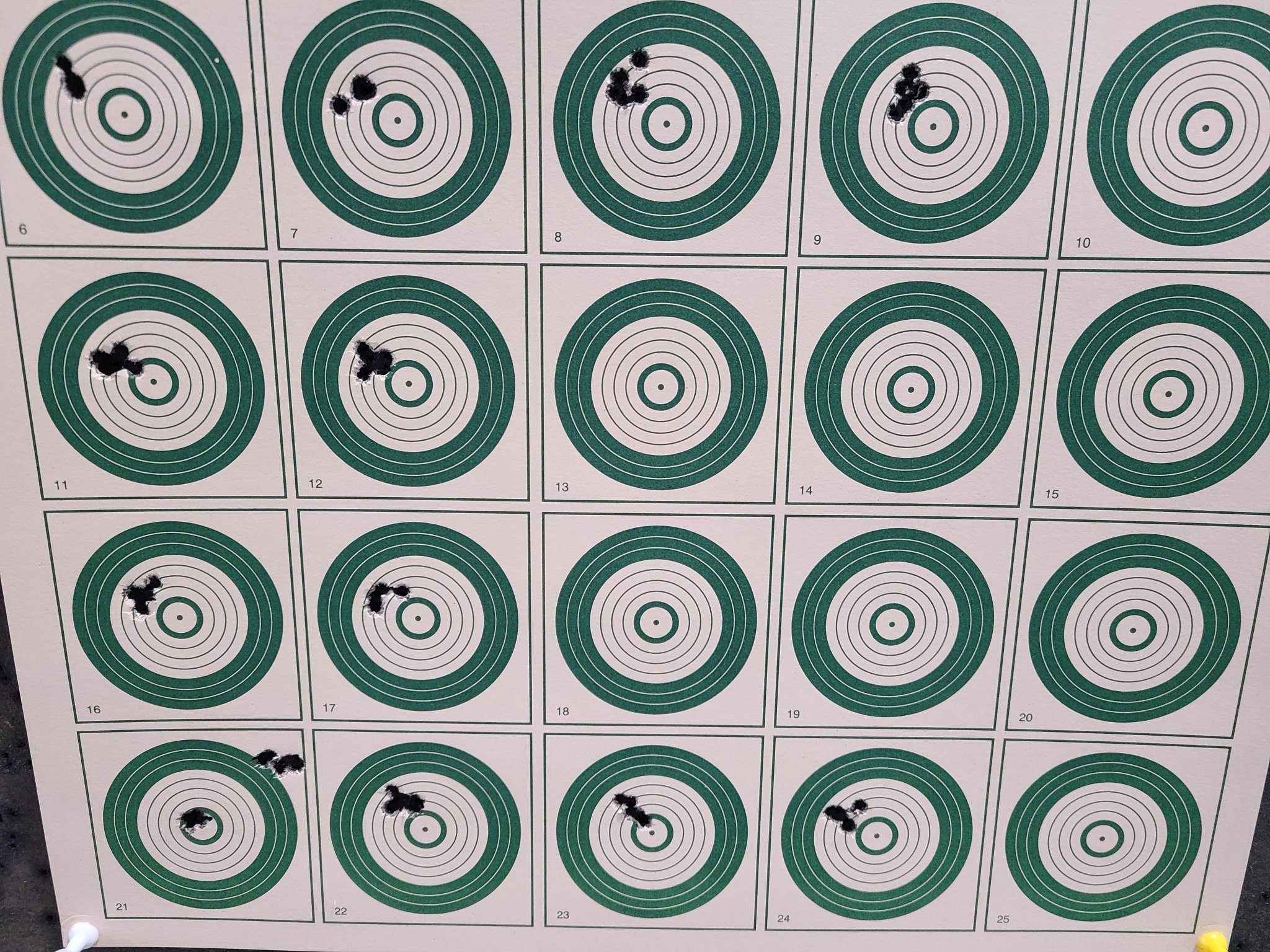

This may be relevant to your accuracy testing in that CZ barrel. Several of us bought the 457 varmint trainers and are testing them on an indoor 50 yard range. Full benchrest setups with no wind.
My CZ happened to be the worst shooter of the bunch. The borescope wasn’t showing me any obvious problems so I went to slugging the barrel. The throat to about ½” down was very tight compared to the rest of the bore except the last ½” at the muzzle was also very tight. After pushing the slug past the tight spot, it would fly down the barrel with no resistance at all till it hit the muzzle end.
First step was to cut the tight spot off the muzzle end. Group testing showed some improvement but still not what I was after. Next step was to order two new MTU “Match” barrels. Out of the box I slugged each. Both had the same tight spot in the first ½” of the bore. One had a bad tight spot at the muzzle. Group tested each and the barrel that was not tight at the muzzle shot on part with the other better shooters in the bunch. The barrel with tight spots on both ends shot poorly with wild fliers.
Having a better barrel on hand, I went to hand lapping the original barrel with the muzzle cut back but tight on the chamber end. I focused on lapping that tight spot and ended up with it at least reduced and left a taper on down to the muzzle. I can’t tell you the dimensional changes but there was a dramatic difference in feel while slugging with resistance on the slug all the way down the bore now.
I’ve only done one group testing session with this barrel but it has shown a dramatic improvement. It is now at least on par with the best shooting rifle in our bunch. Here is my test target. Each group is 5 shots and each row is a different lot of ammo. The bottom three rows are Center X and Midas +. The top row is Eley Practice 100. Note the two groups top left put four into less than .100” The largest group on the target measured about .390. The bottom left group at 1 o’clock was the first 5 out of the freshly lapped barrel. That row was Center X and the worst shooting lot previously in this barrel. That lot would throw groups double the size you see here.
My point regarding your test, from what I have seen on these CZ barrels, if you have a tight chamber end like I have seen in each of the small sample I tested, wear would most likely improve its accuracy. On a high precision custom barrel, I would seriously doubt the first 1000 would help unless there was an issue that needed ironing out.
